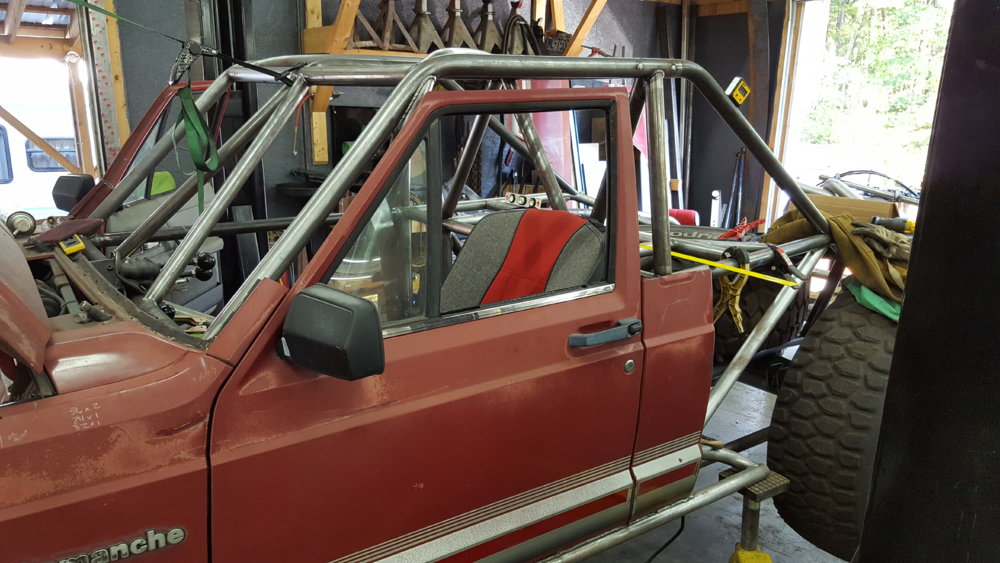

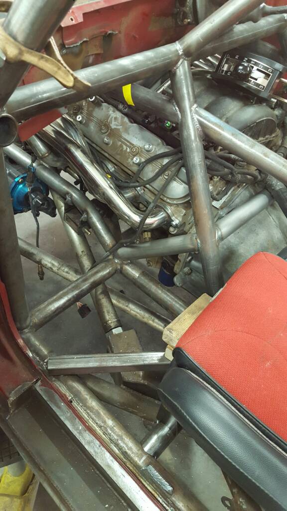

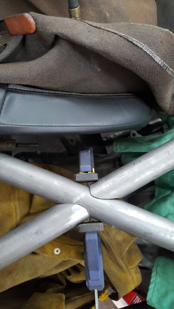

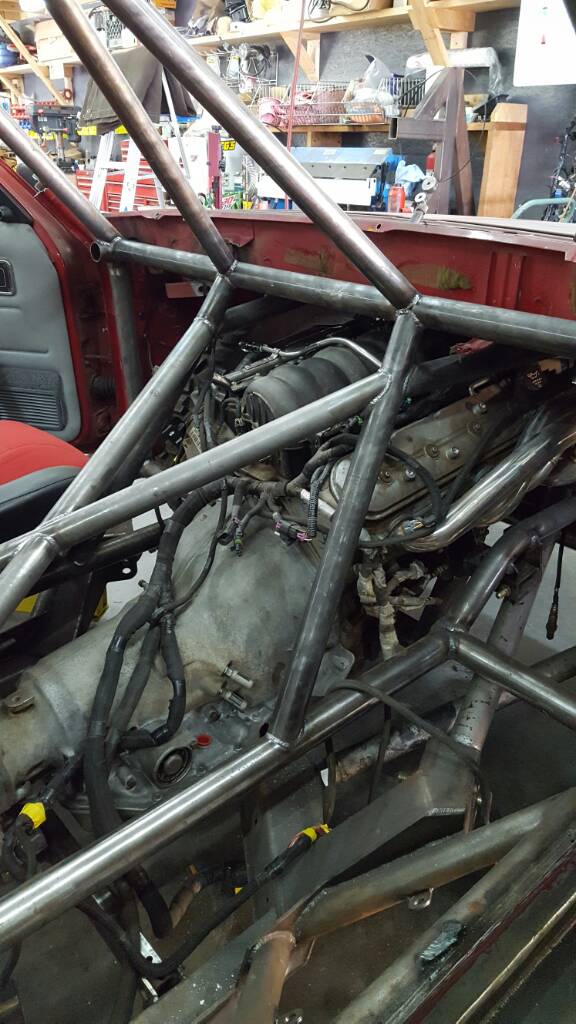

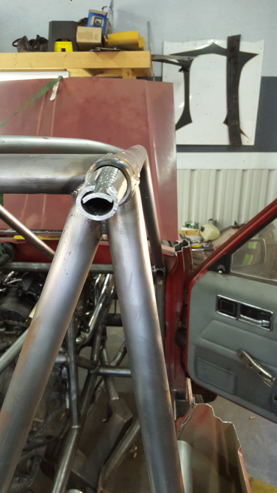

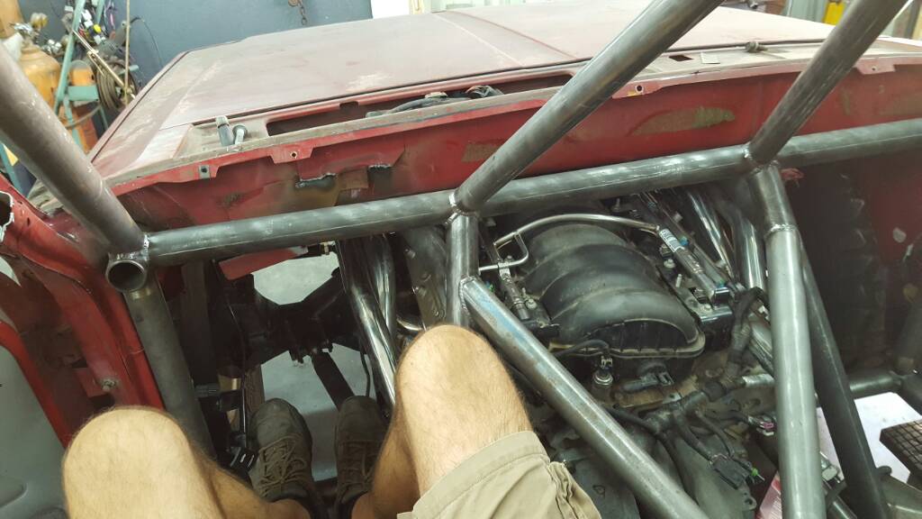

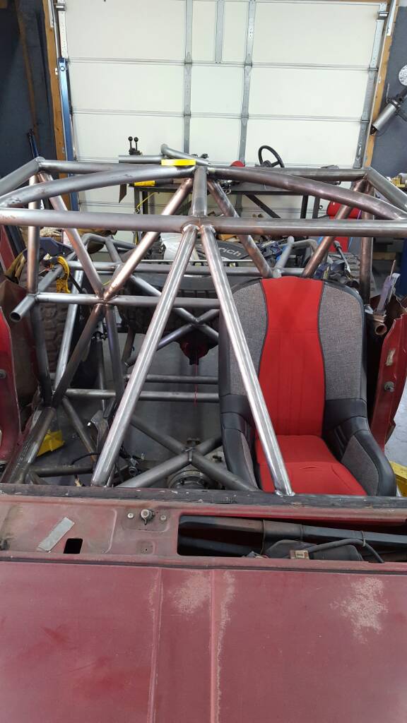

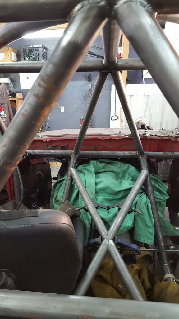

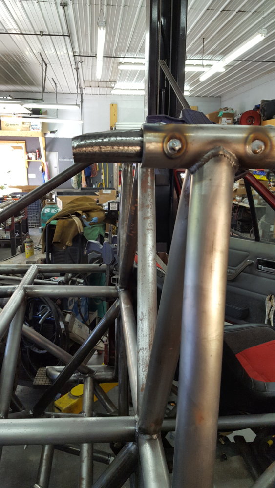

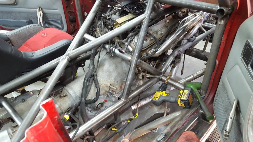

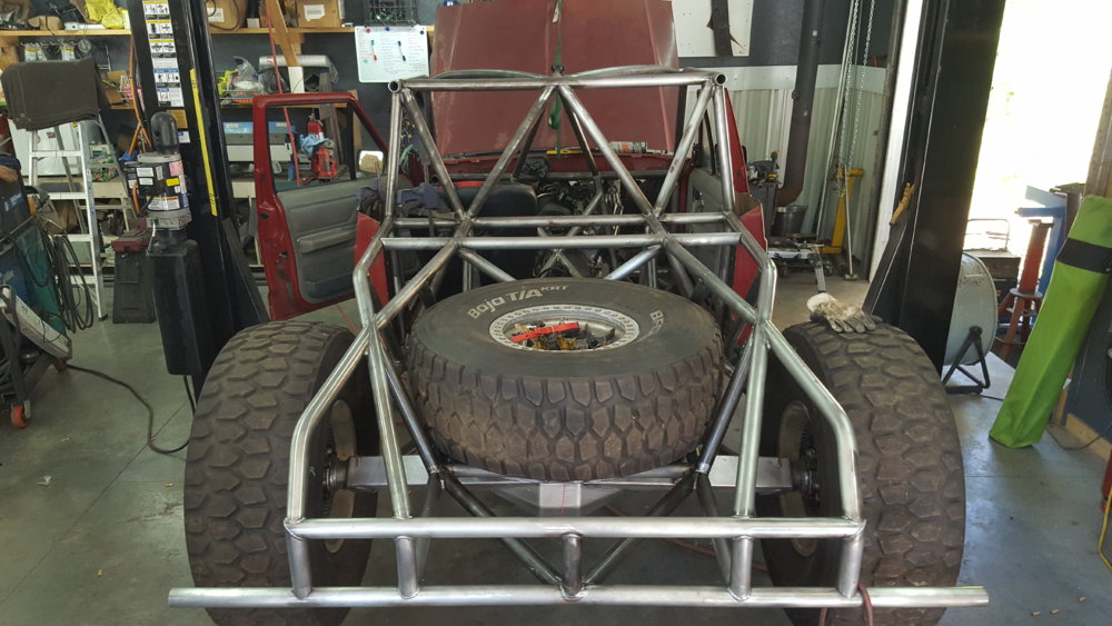

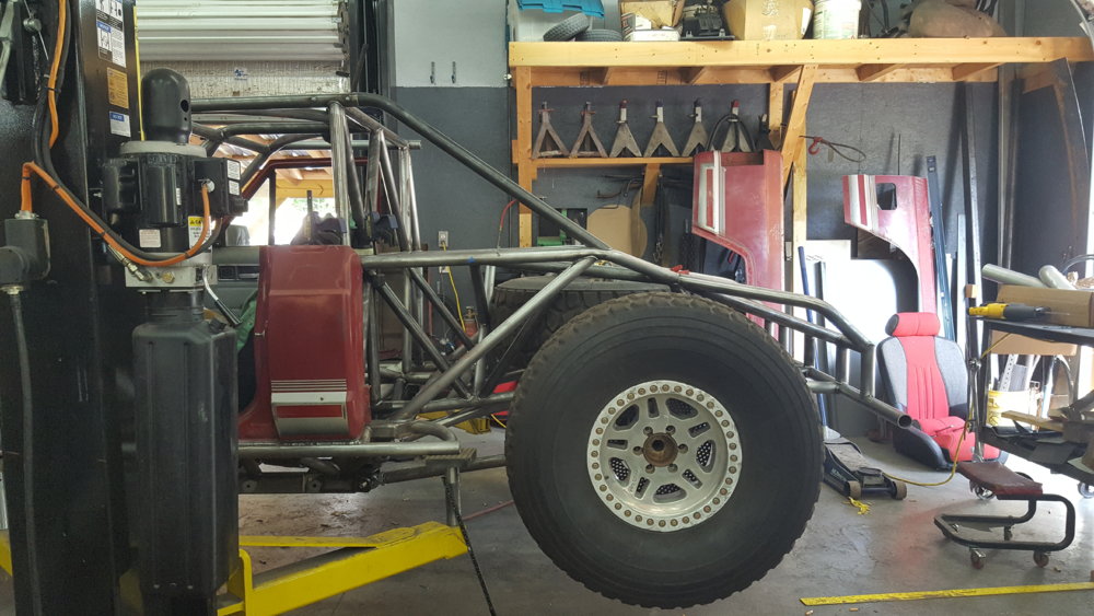

Interior tubing close to being done. Got the dash and windshield V installed and tied into the front clip. Still more diagonal bracing to fit. Few more shop days this week...hope to have the roof back on by end of the week.
Matt
What are your plans for heat in the cab? It's going to be hot. By the way awesome fab work.
Drive faster....[emoji41], if that don't work I'll take a break in the shade sitting on the tailgate with a cool beverage.
Don't think it will be any warmer than my buggy was. I've got a line on some great firewall insulation that @NC-V told me about. Typically I don't wheel much in the middle of summer, I'm a fall-winter- spring wheeler.
Matt

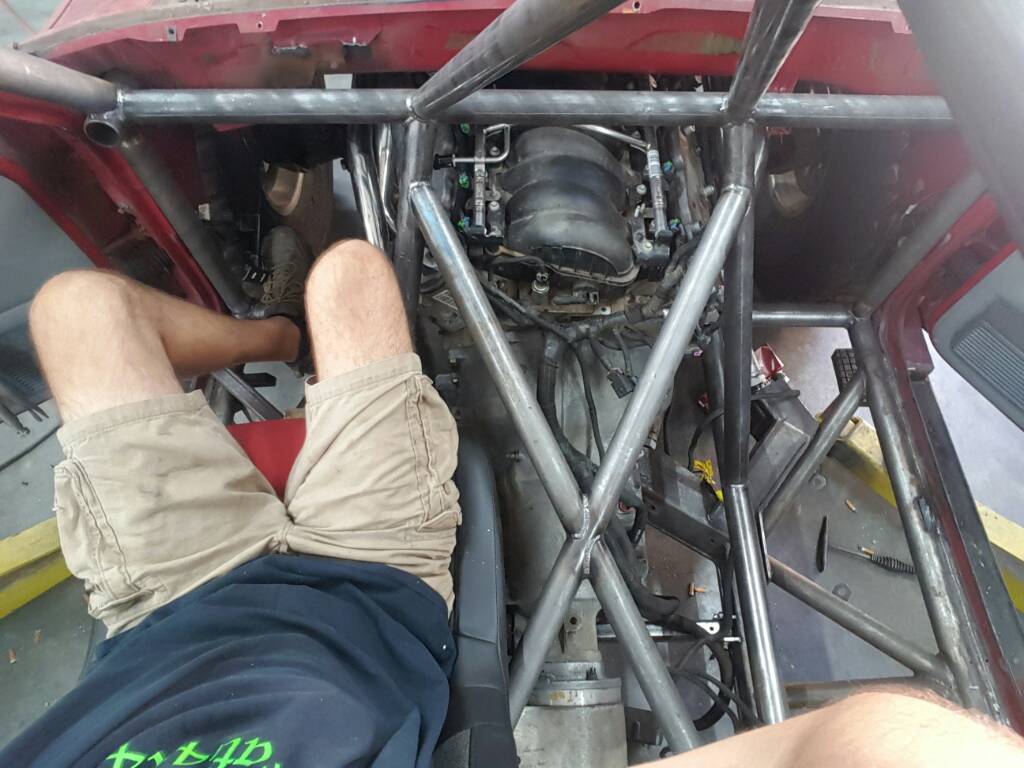

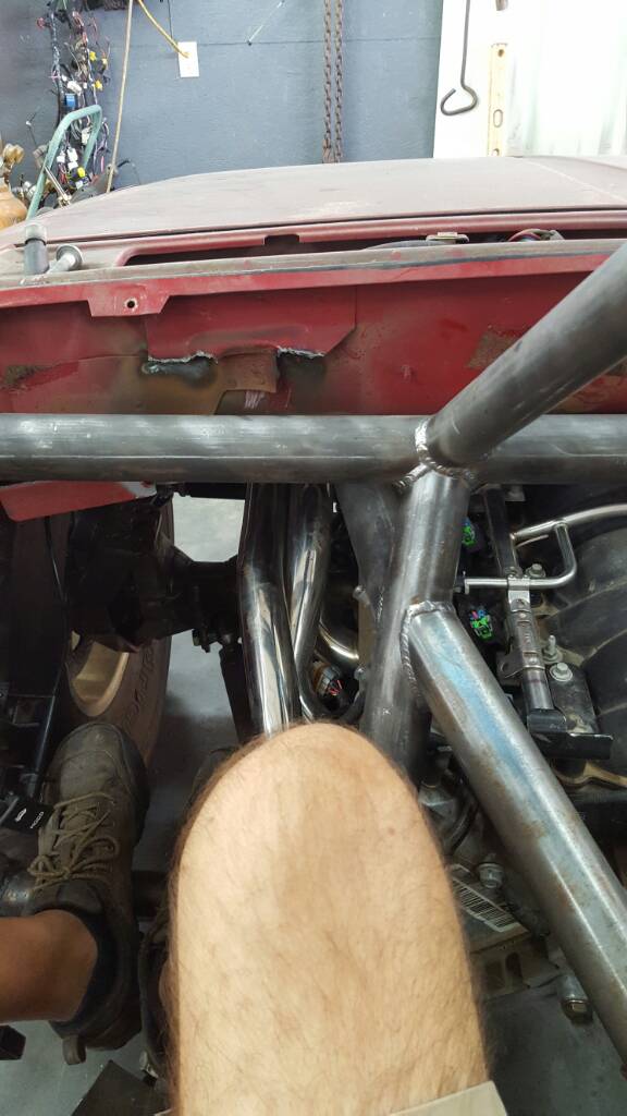

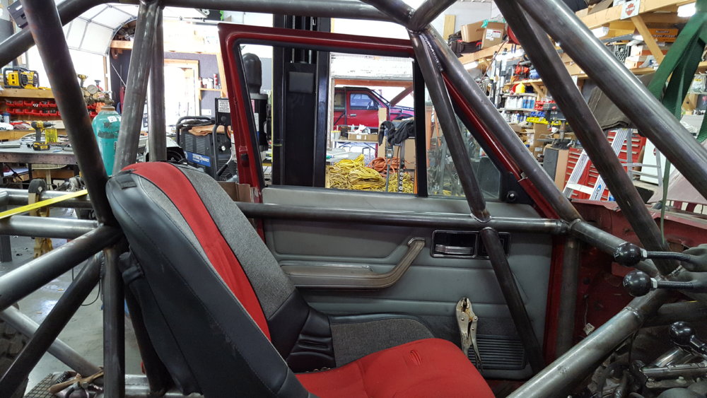

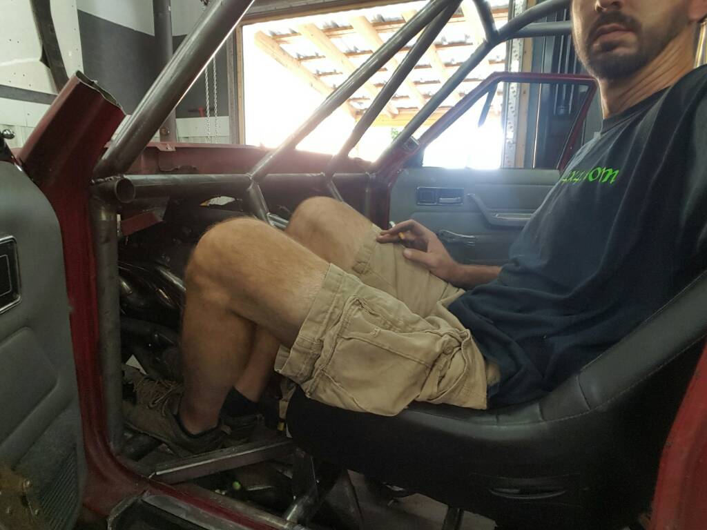

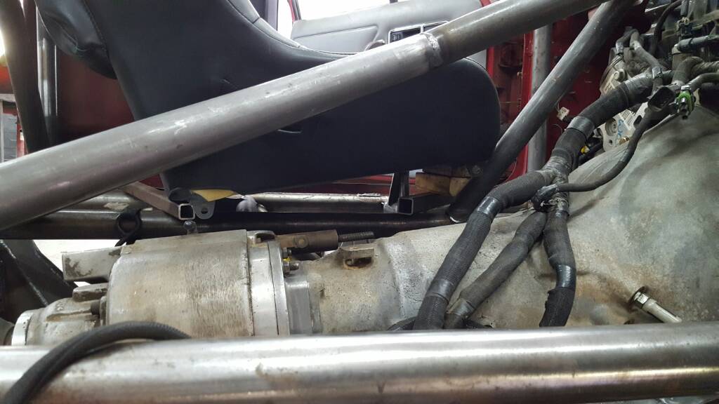

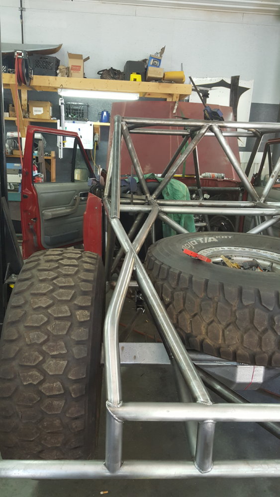

I really think that would bother me to not have more foot room than that, but then again, it's not mine!:smokin: Killer work, this thing is a work of art.

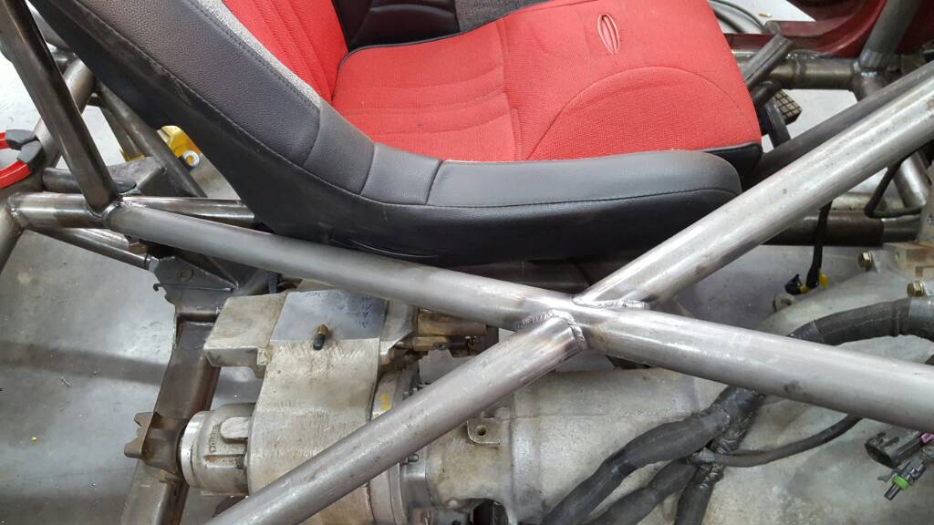

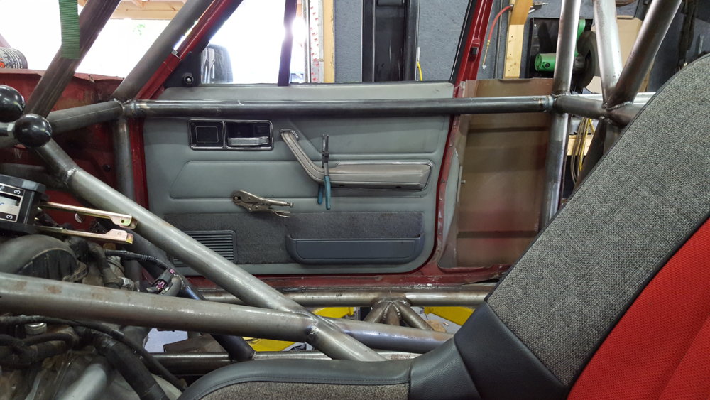

It would me too if I was going to drive cross country, [emoji12] . It's actually more foot well than I had in the buggy (left to right) but I did have more length in it, and the engine was even further back in the buggy relative to the front axle. It's actually quite a comfortable position in the manche. I repositioned the seat from original mount, lower on rear mount, and turned the seat about 10° towards the A pillar to point my legs at the pedal better. In the buggy, my legs sat cock-eyed to my torso, which could get uncomfortable on long tail rides.
Thanks jeepin
Matt
Edit; I had to remove the headrest to lower the back of the seat, I will add a roll bar mounted unit in its place.
Alot of Kevin Carroll's buggys at red dot engineering are built like this. Some of his look like more than 10 degrees though....
Yea, just a guess on the angle. It certainly gives me more room with full doors, and allows me to see around the B-pillar better.

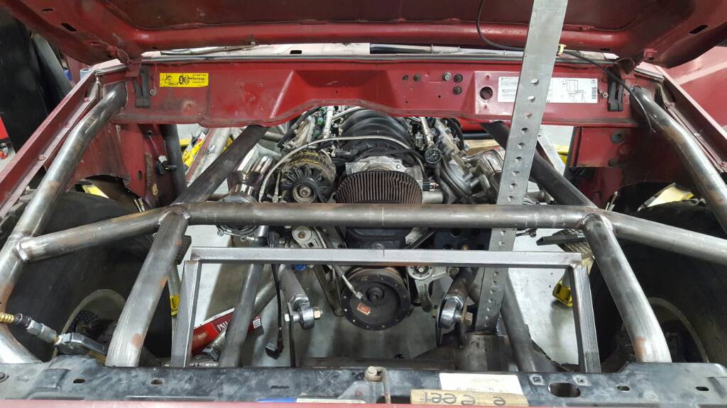

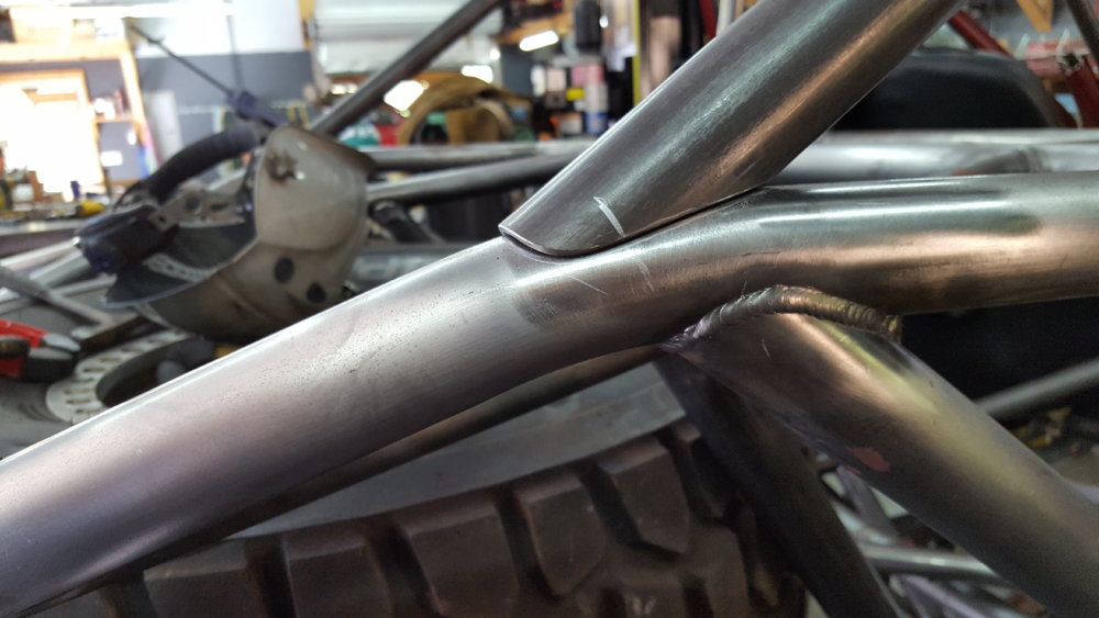

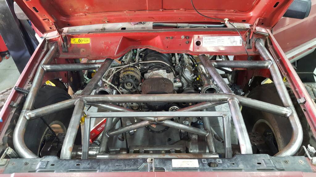

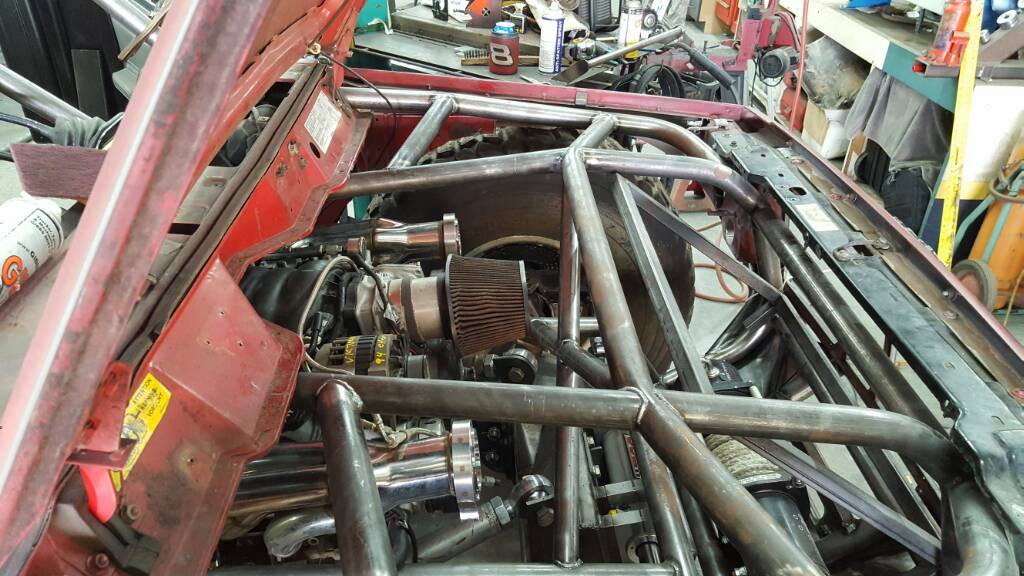

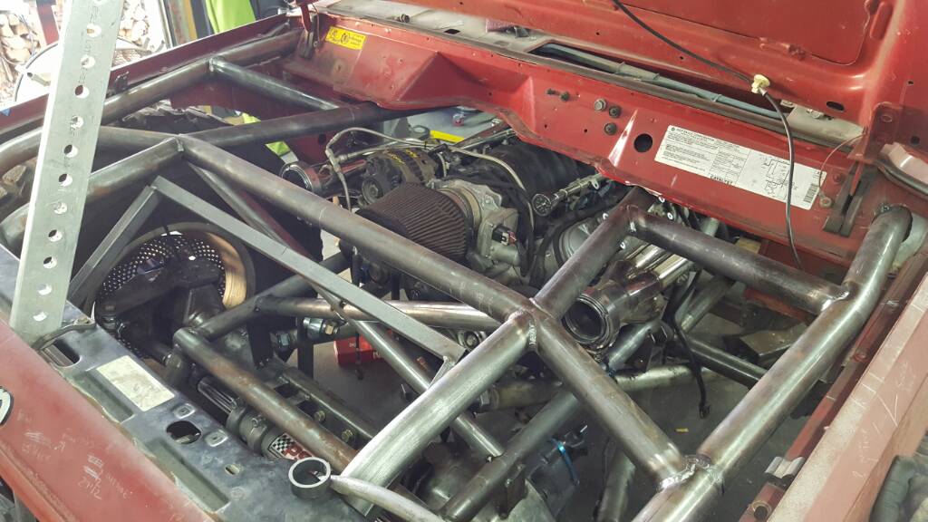

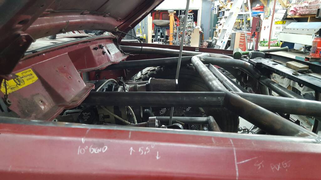

Had to get out of the interior today. Trying to sketch and imagine interior paneling and dash/ plumbing/ wiring layout has exhausted my brain power the last two evenings. Hung 6-7 more tubes today. As far as I can get under hood til radiator arrives.
Matt

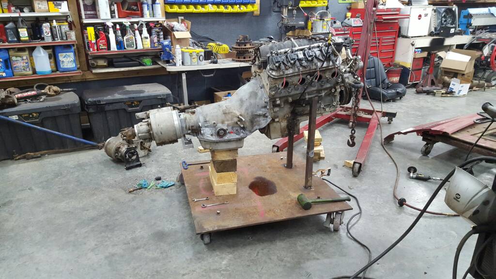

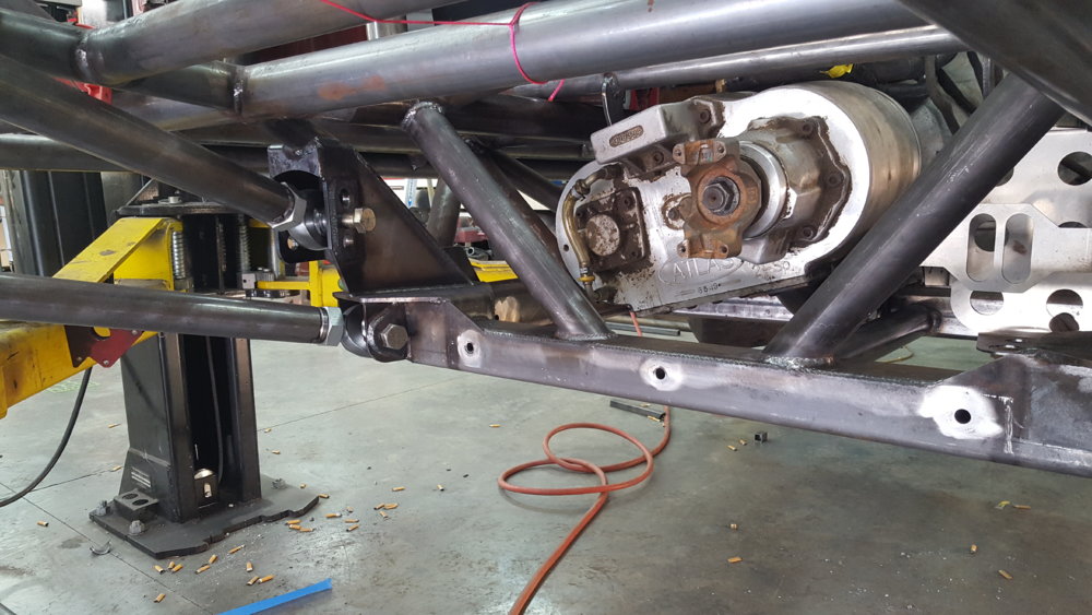

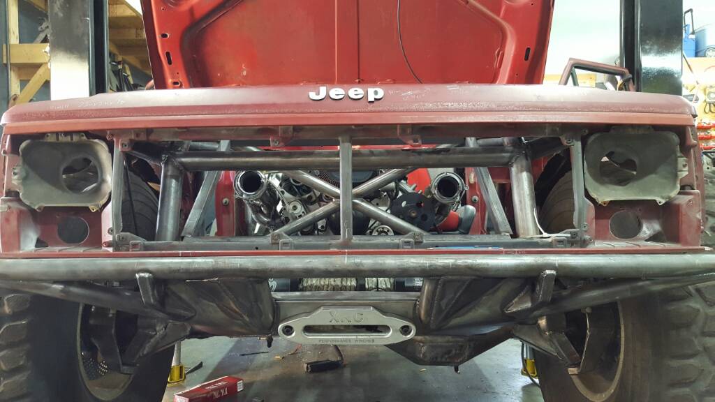

Just curious but what do you do when you need to do engine work on it? Looks like it's in there for good......
Pull the front axle, exhaust, headers, driveshaft, drop it like it's hot.....onto this little stand I made, then roll it outta the way.
