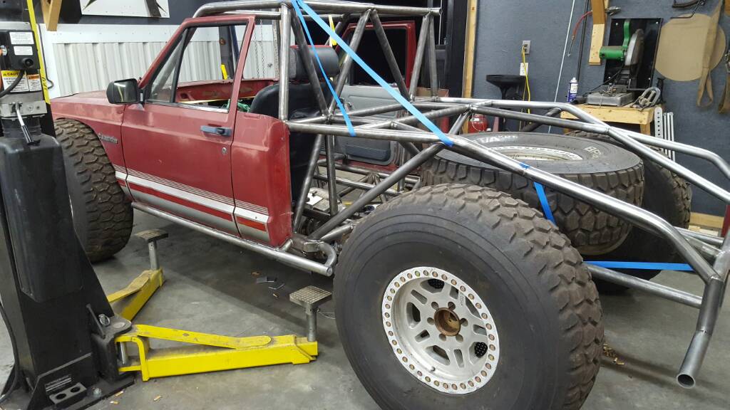

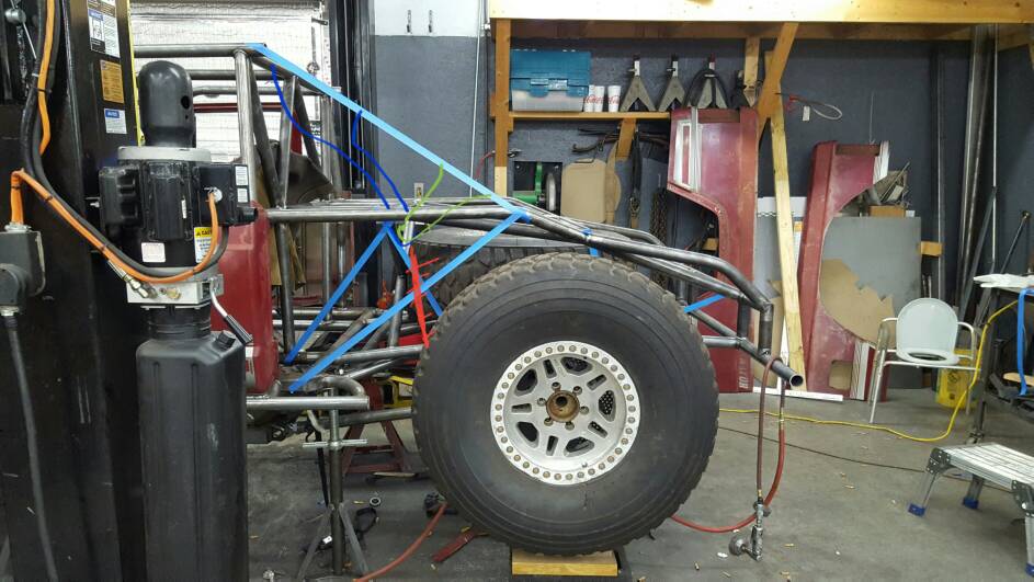

90's throw back.....Manche build

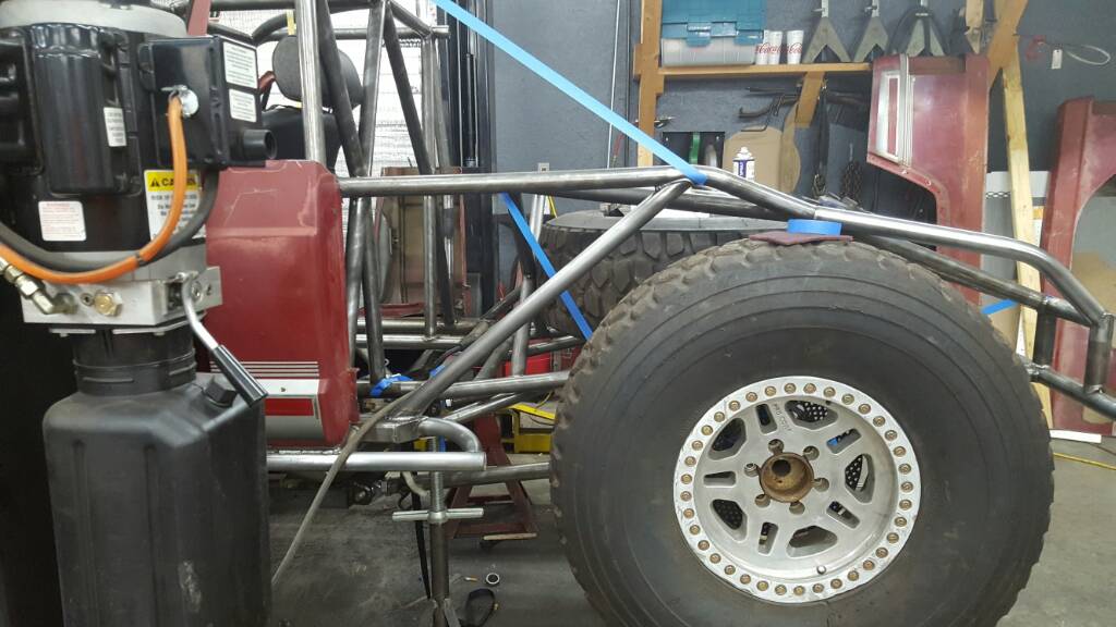

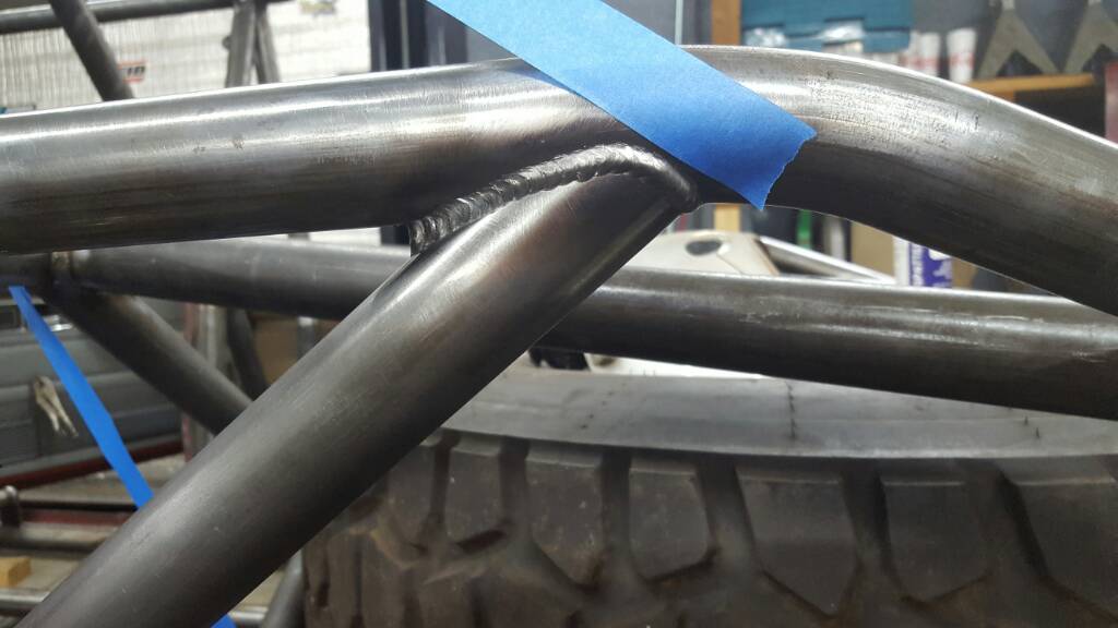

Yes the blue tape, I am guessing that most of that tube will be visible with the skins on
Exactly right. Only visible tubes will be front and rear bumper, rockers, and that c pillar.
Matt

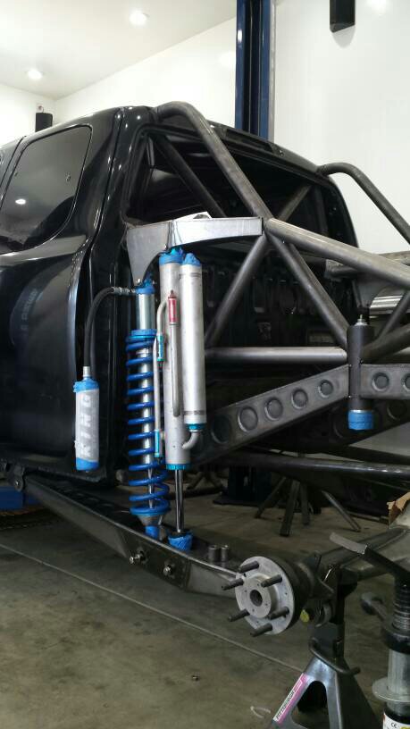

How about making it a double b pillar, then coming off lower than where the tape is now, and blending it in with the bend at the other end of the tape?

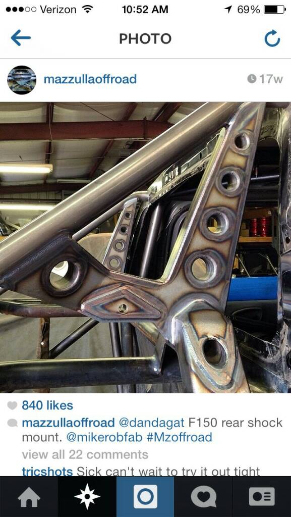

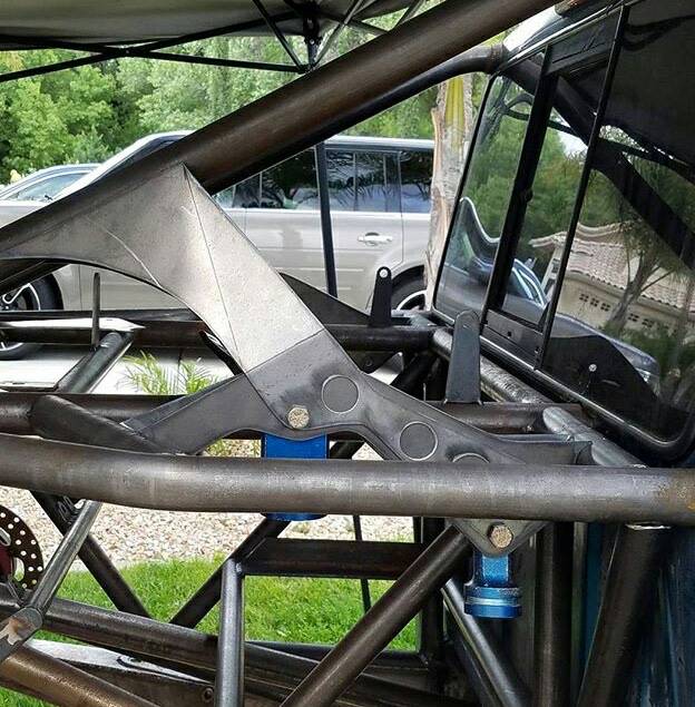

Pretty rough sketch, but you get the idea. These shock supports will be .125 plate, laminated and will tie in at the slugged joint at top of c-pillar and the other end on hip tube at that bend.
Here's a couple better examples.
Matt

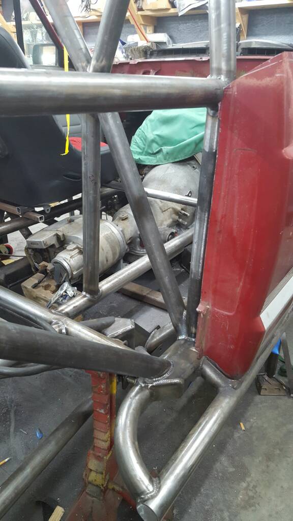

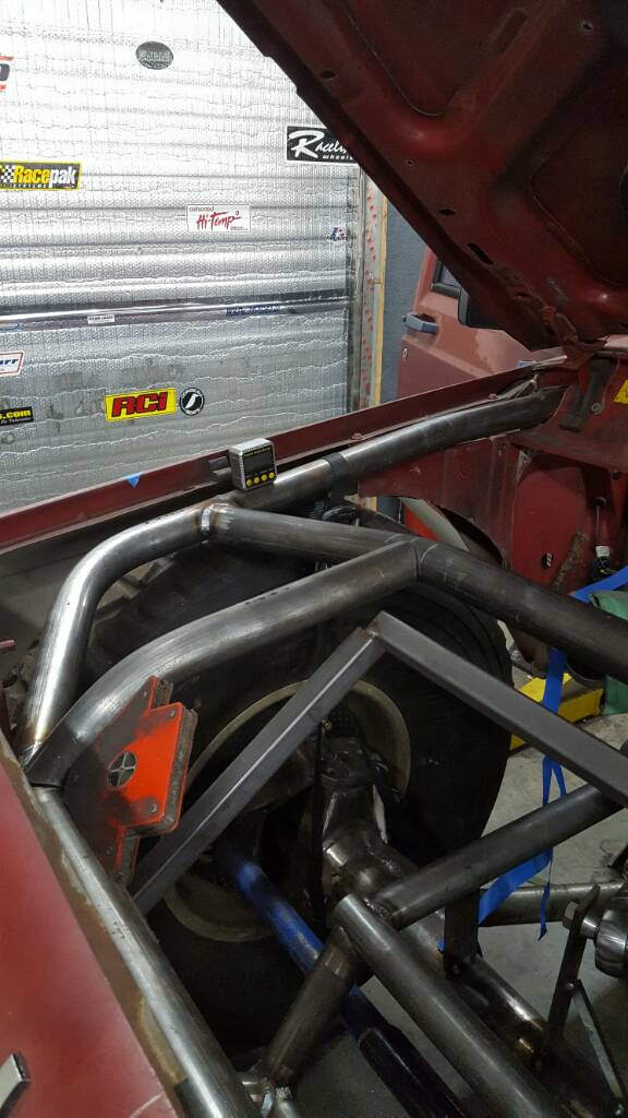

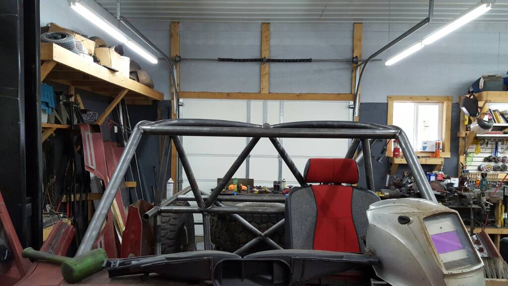

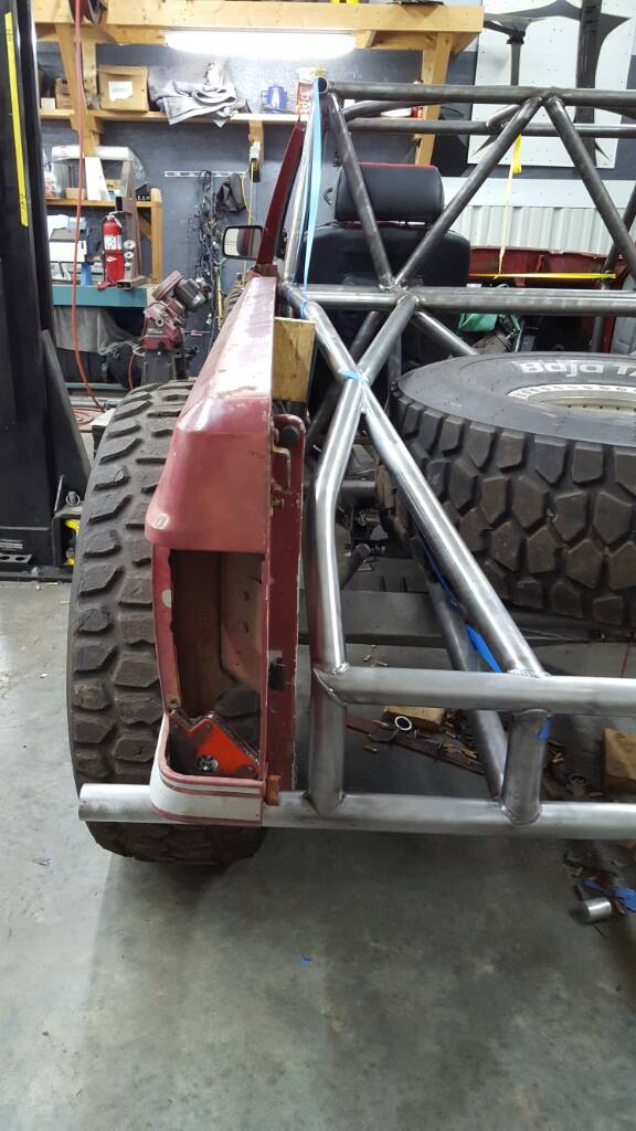

More progress last night. Only 2 pieces of .120 tube left on the back end, (at bump stops), and of course the bumper area once the skins are in place.

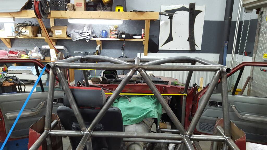

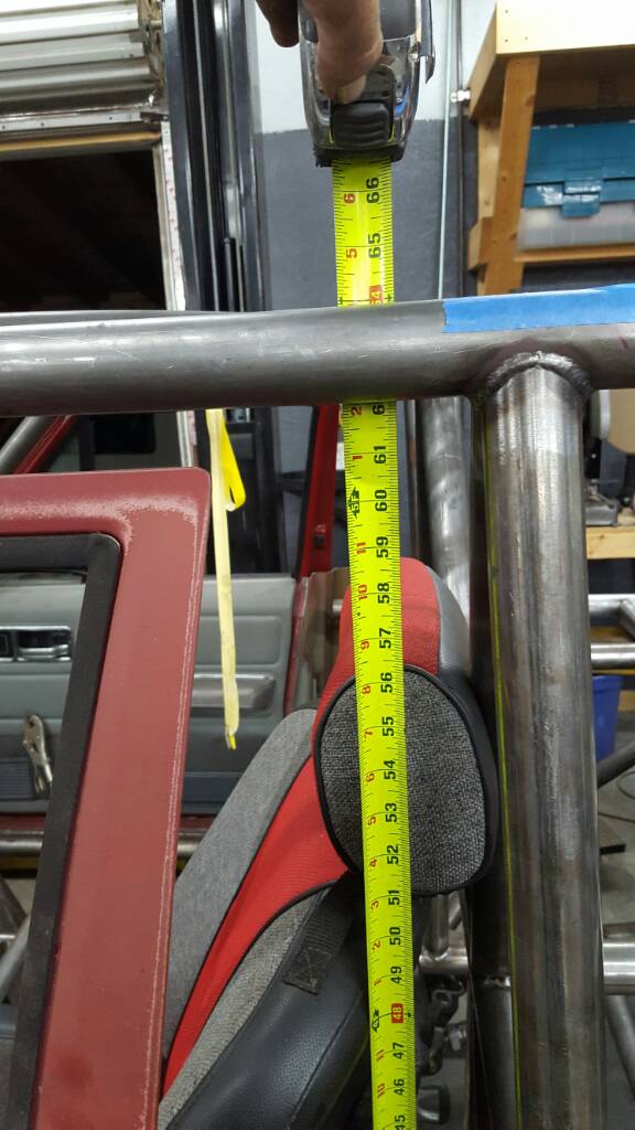

B-pillar x's are done. C-Pillar lower diagonals in. Roof diagonals are done. I put some roll in them to gain an inch more head room. Then got back to the front...
Only a few gussets, and a small attachment for seat belt shoulder clips, then the roof can go back on.
Matt

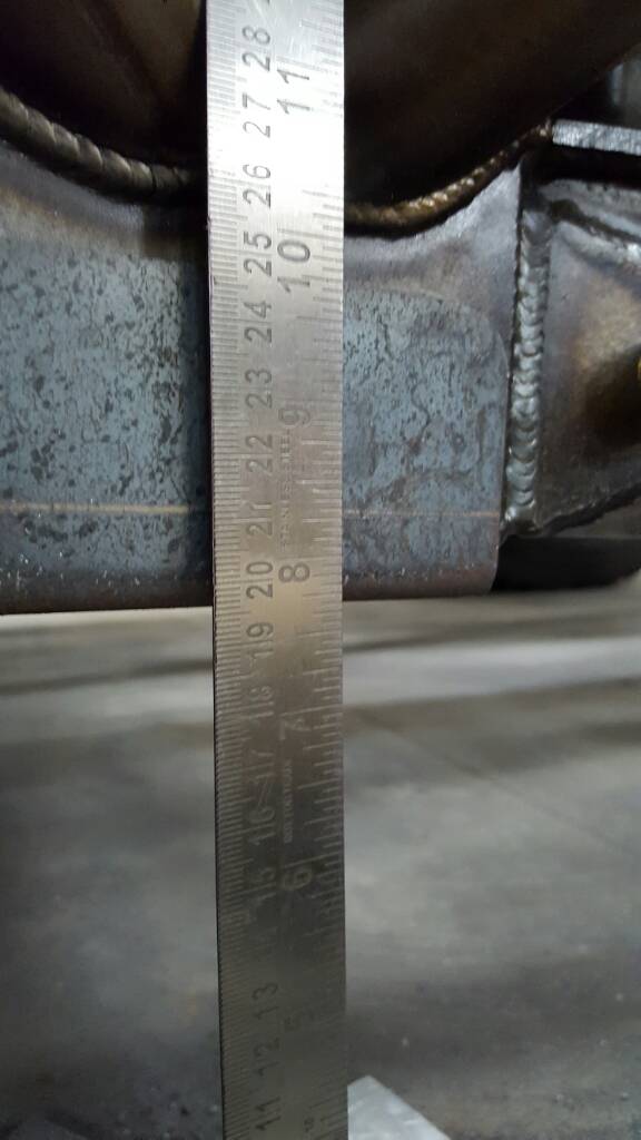

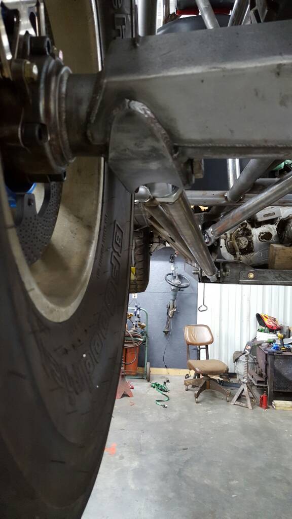

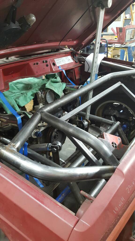

Just some miscellaneous progress tonight. Biggest hurdle was finally burning in the engine crossmember so I can have a near rolling chassis. Just the trans to mount, and waiting on two more shocks and bumps.

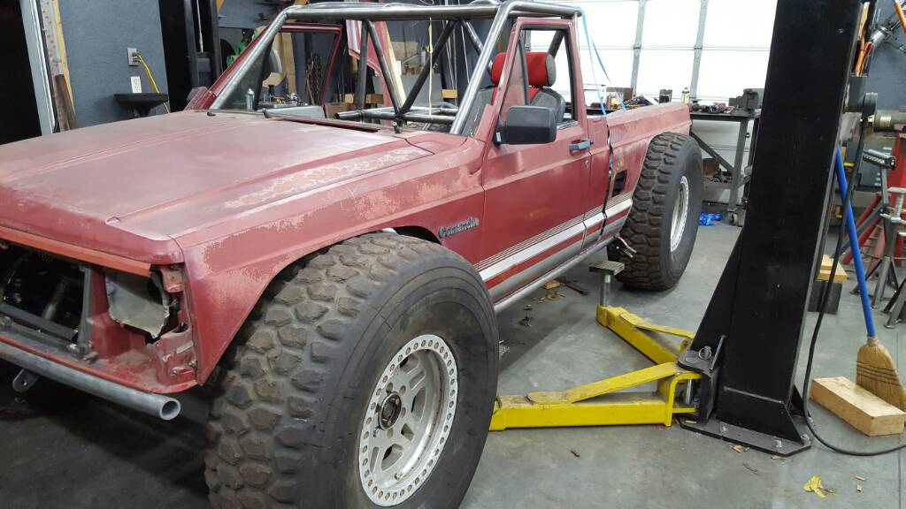

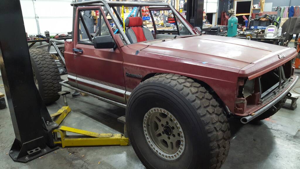

Few guilty pleasure pictures, (and motivation). Finally on the ground at full bump and rolling around.
Still approximately an inch to top of roof
More tomorrow
Matt

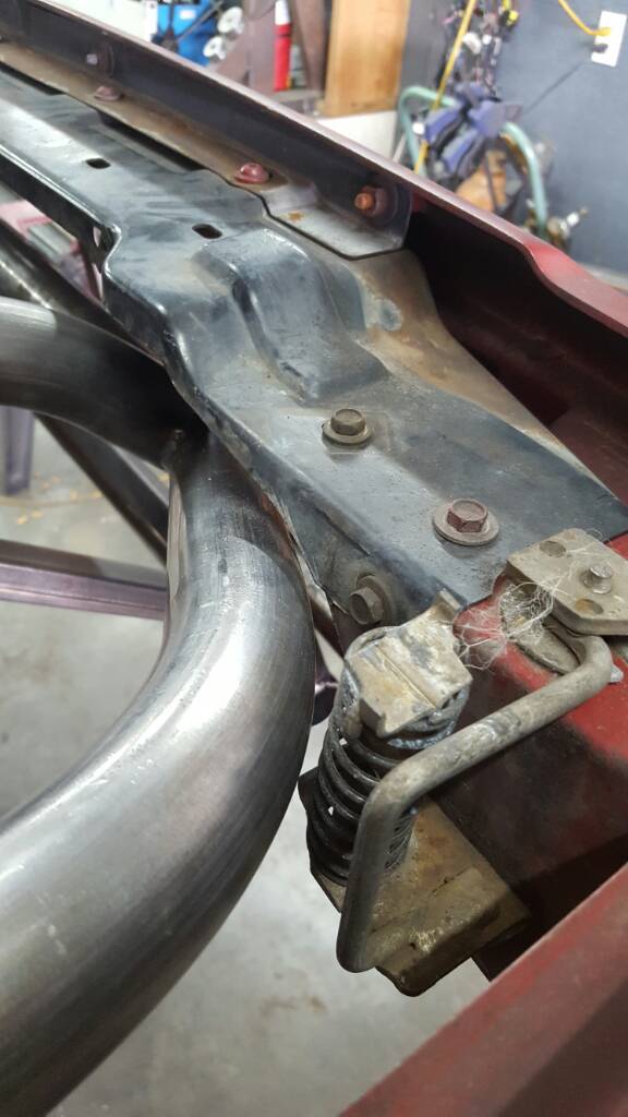

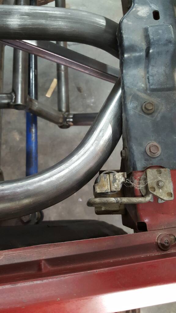

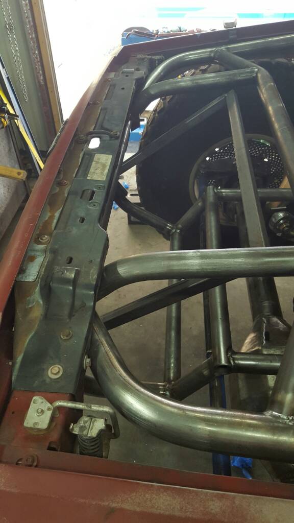

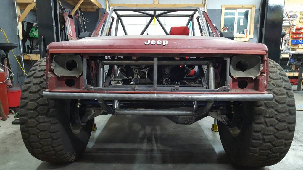

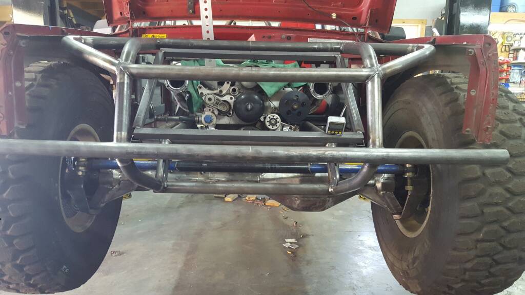

Tight fit on the grill support. No hood pins in this build...functional hood release and secondary latch. There will be an air dam, over radiator to grill support, to ram air to the radiator, and attach said support.
Naked front end tubing
More tonight
Matt

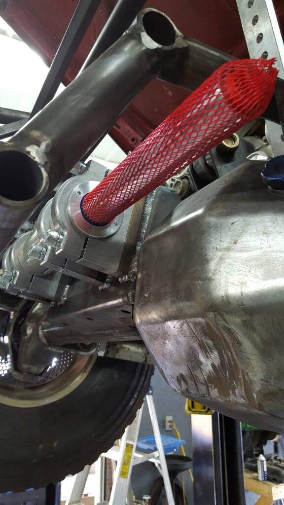

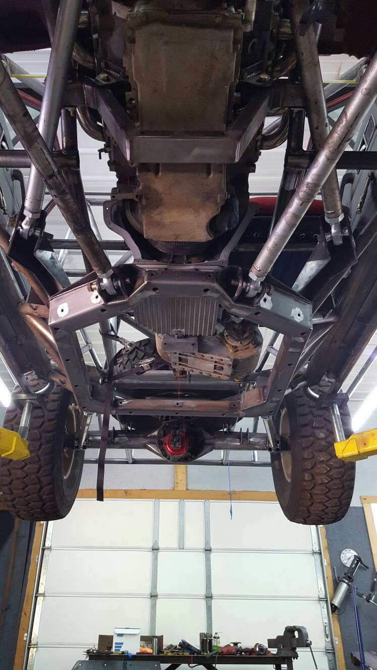

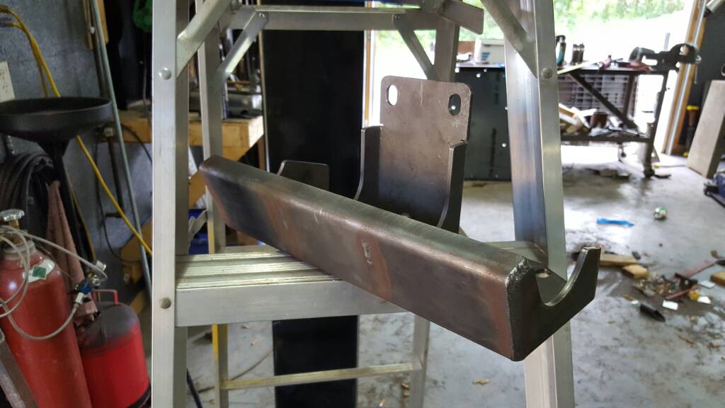

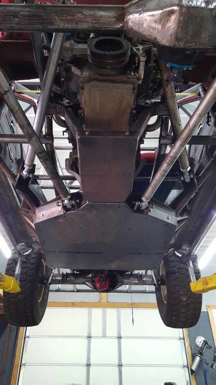

And did a little work on the trans/tcase mount

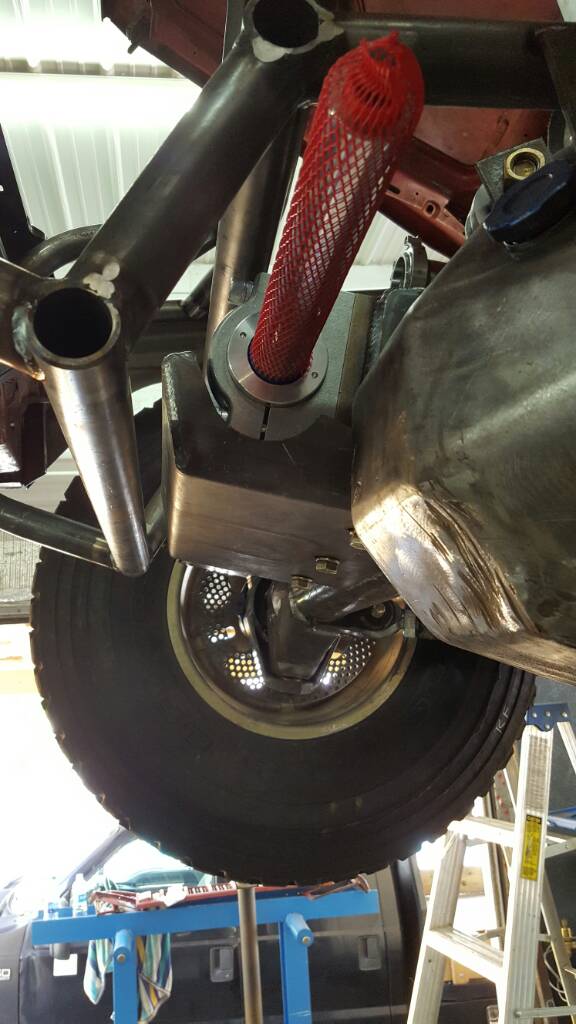

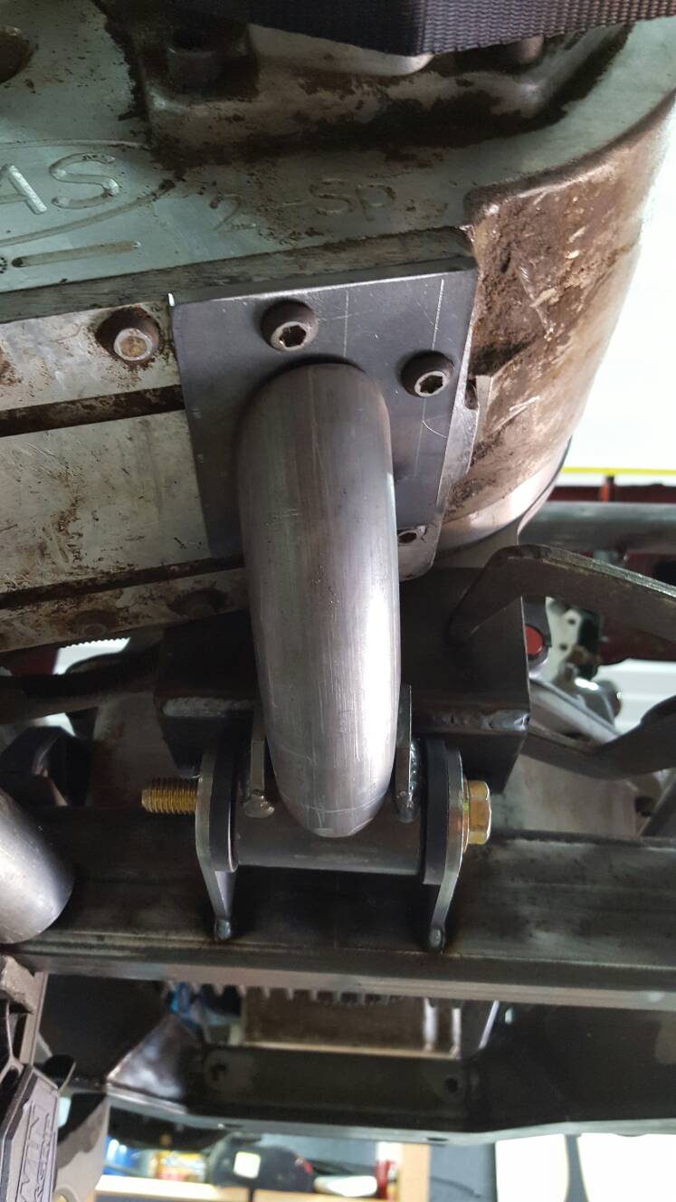

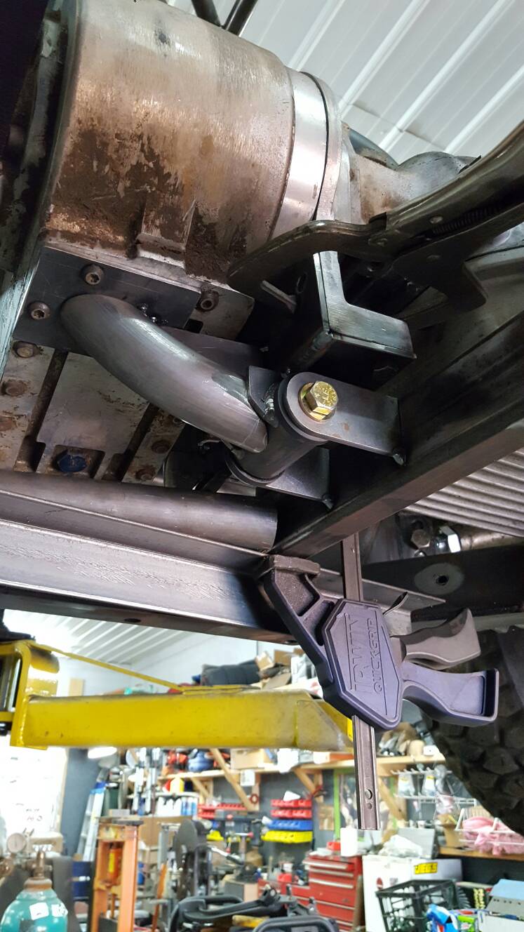

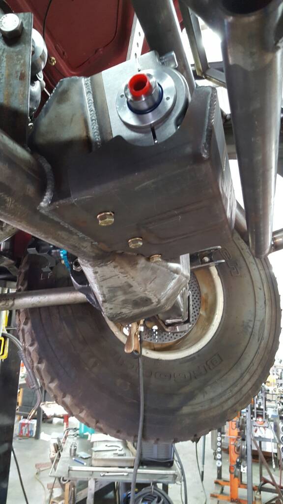

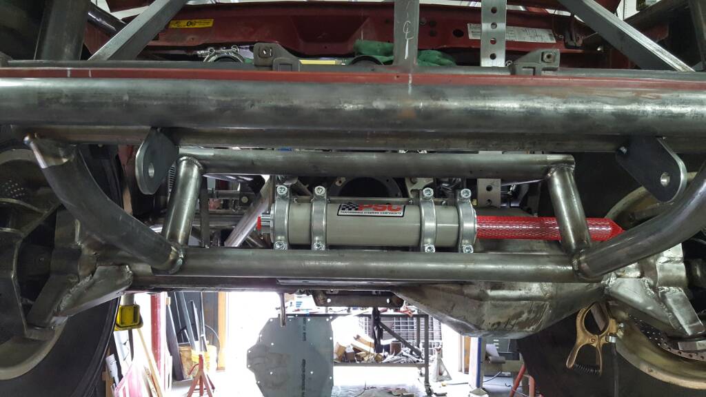

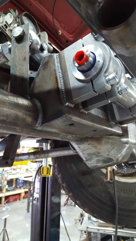

Minor progress today, yet time consuming. New ram mounted with the Goatbuilt assembly. Nice piece...
With removable skid

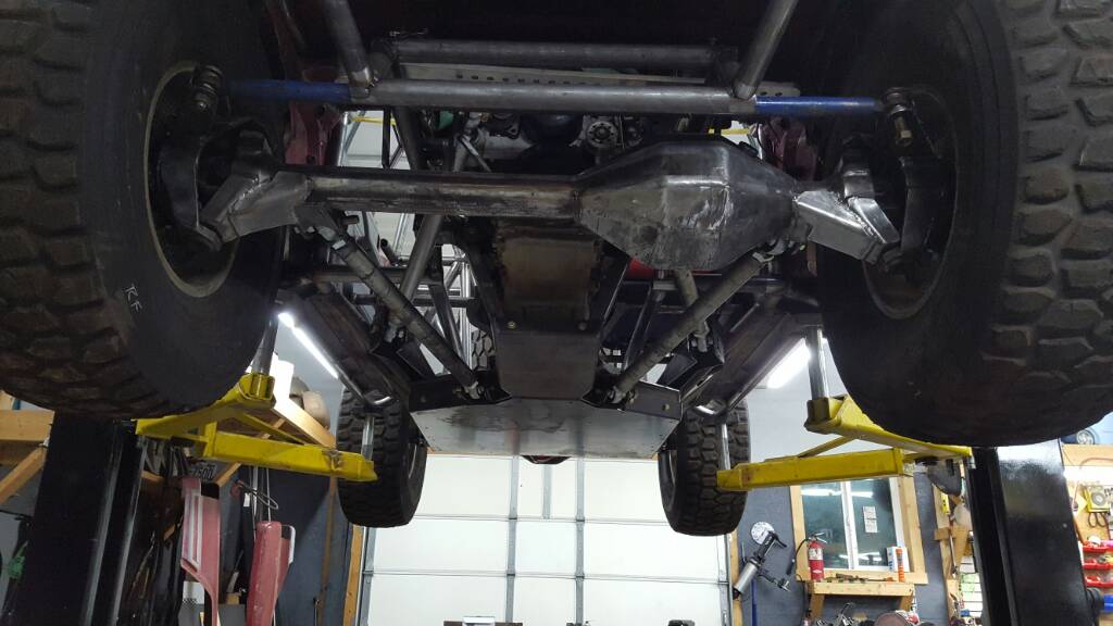

Also finished trans mount. Everything underneath fully welded. Hope to have all supporting tubes and gussets underneath finished this week.
Matt

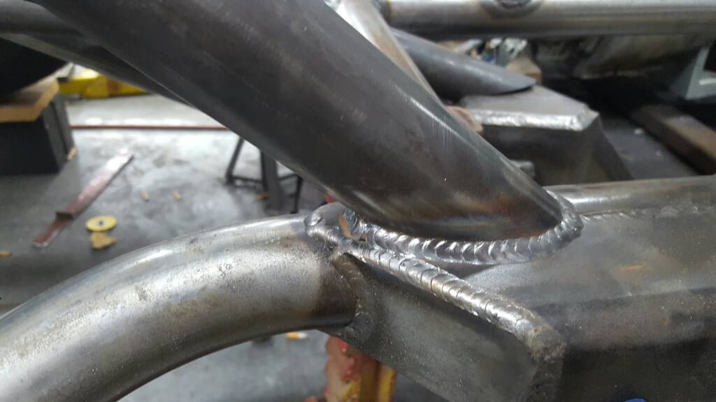

One is that steering column on the wall in good shape and available cheap?
Two is that clamp method how rams like that are mounted? Wouldn't they slide when pressed into a rock wall? Or does hte ram have a lip or something that stops that?
Three Is that mig or tig welds on the tube?
1, column going back in the truck.
2, the rams are machined for the clamps, no slide.
3, all the welds so far are mig.
