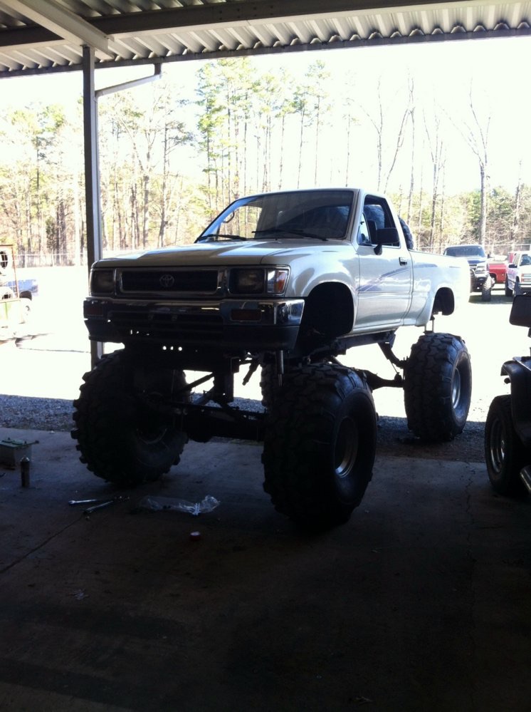

I have yet to see a pic of this truck before it was torn down for the build. You got any pics Hunter?

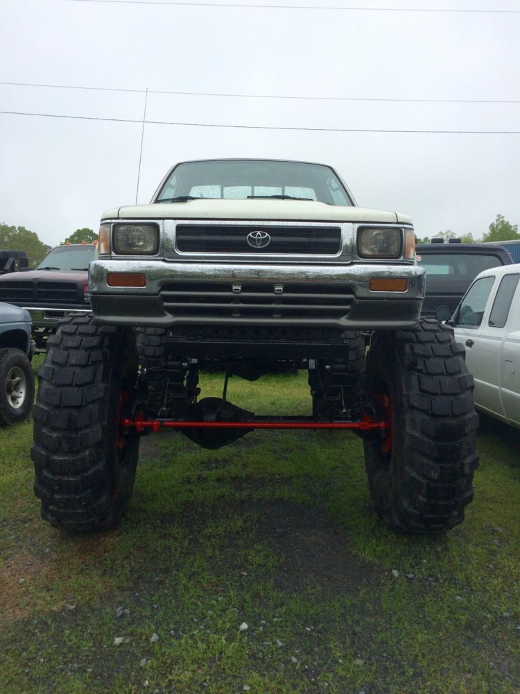

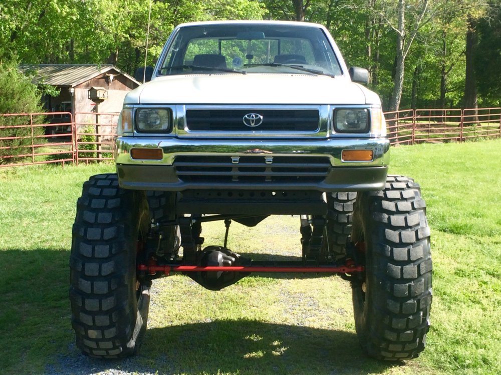

Almost done, just a few kinks left to be fixed and double check everything! Couldn't be more impressed!

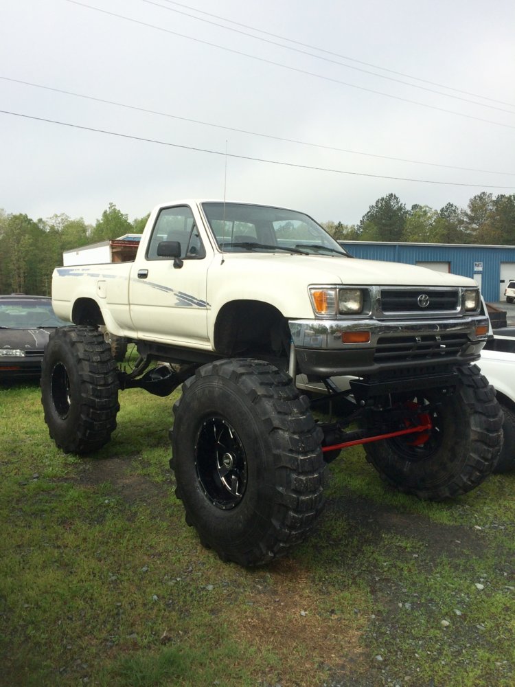

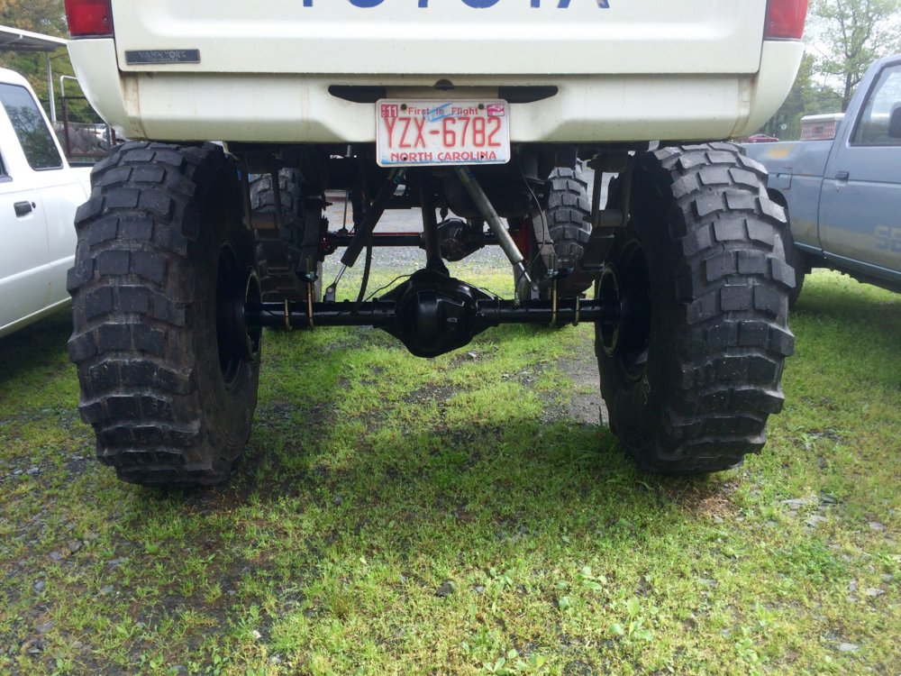

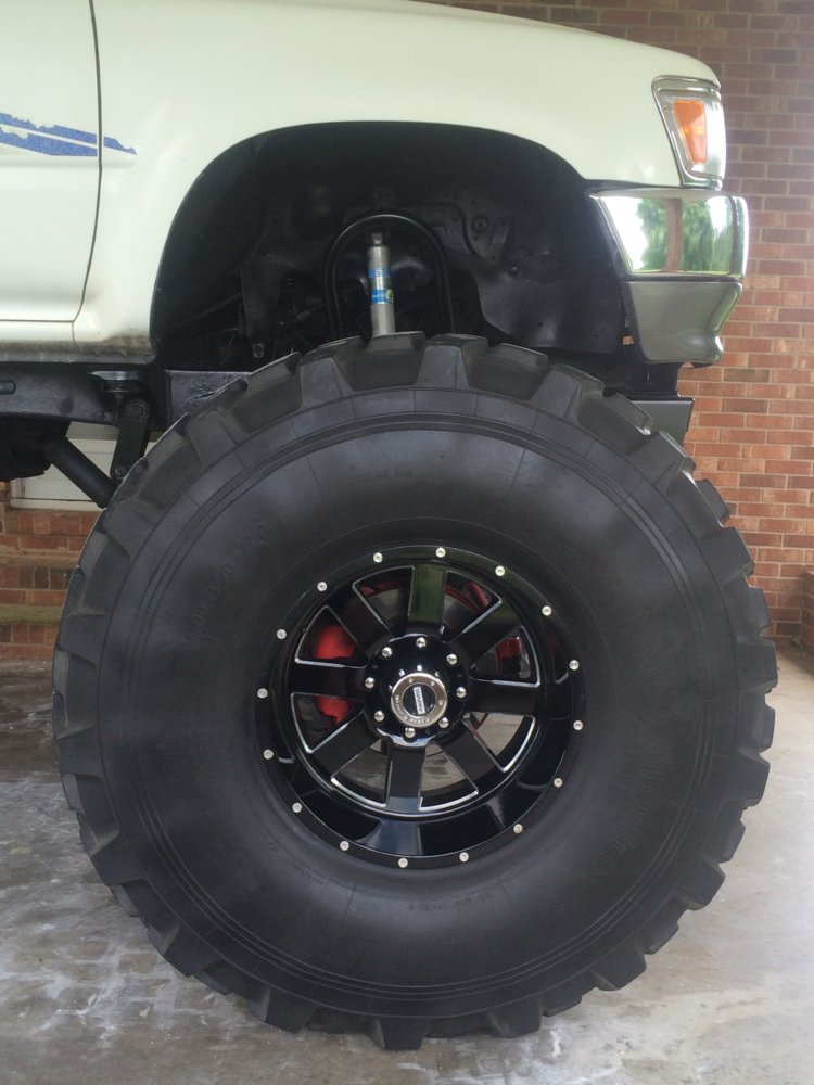

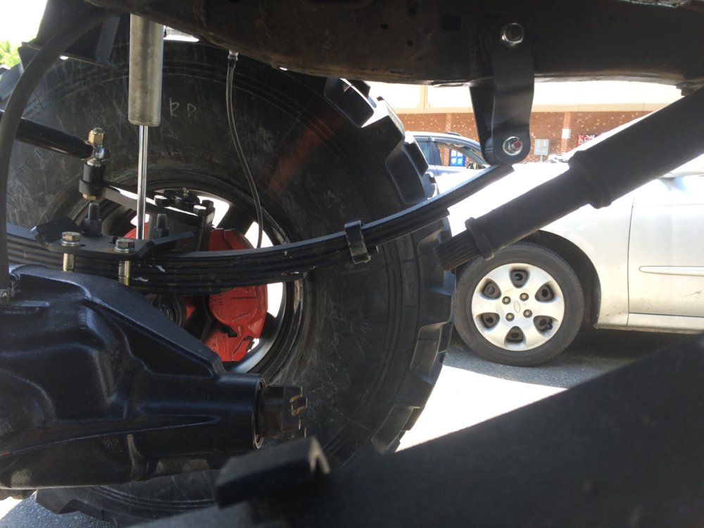

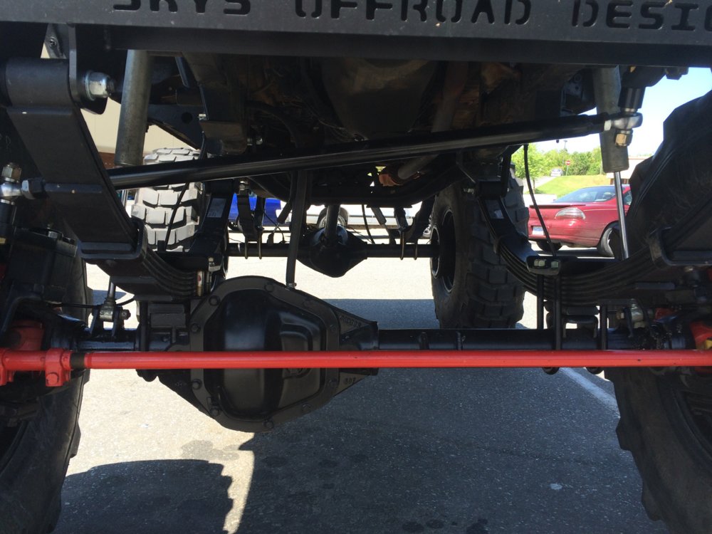

More pics

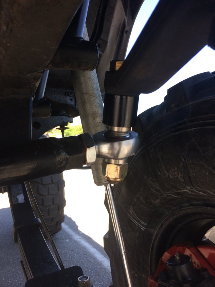

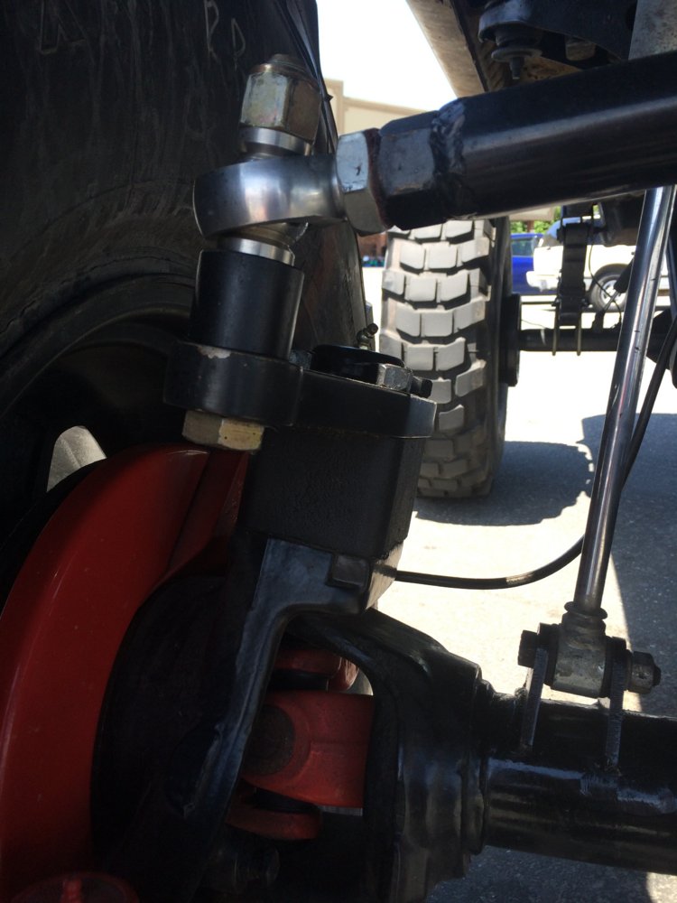

I'm not one to leave a negative comment on a persons build thread, so I'll leave a constructively critical one: Your steering is going to suck. The angle on the heim joints is nothing short of scary and if that suspension sees any down travel at all, it will break bolts, kingpin studs, spacers, and/or rip the steering box straight off the frame. That much lift is never good for anything and what could be a functional truck is now not.
No hard feelings but someone had to say it.
Would a high clearance steering arm help any? I've had it back for about a month now, nothing has happened yet and I pray never does. As for down travel, it sees quite a bit.
The only logical solution would be full hydro. There's a huge debate over whether its street friendly or not. Legality is another thing. I've never personally ran it but if I had to I would give it a whirl.
