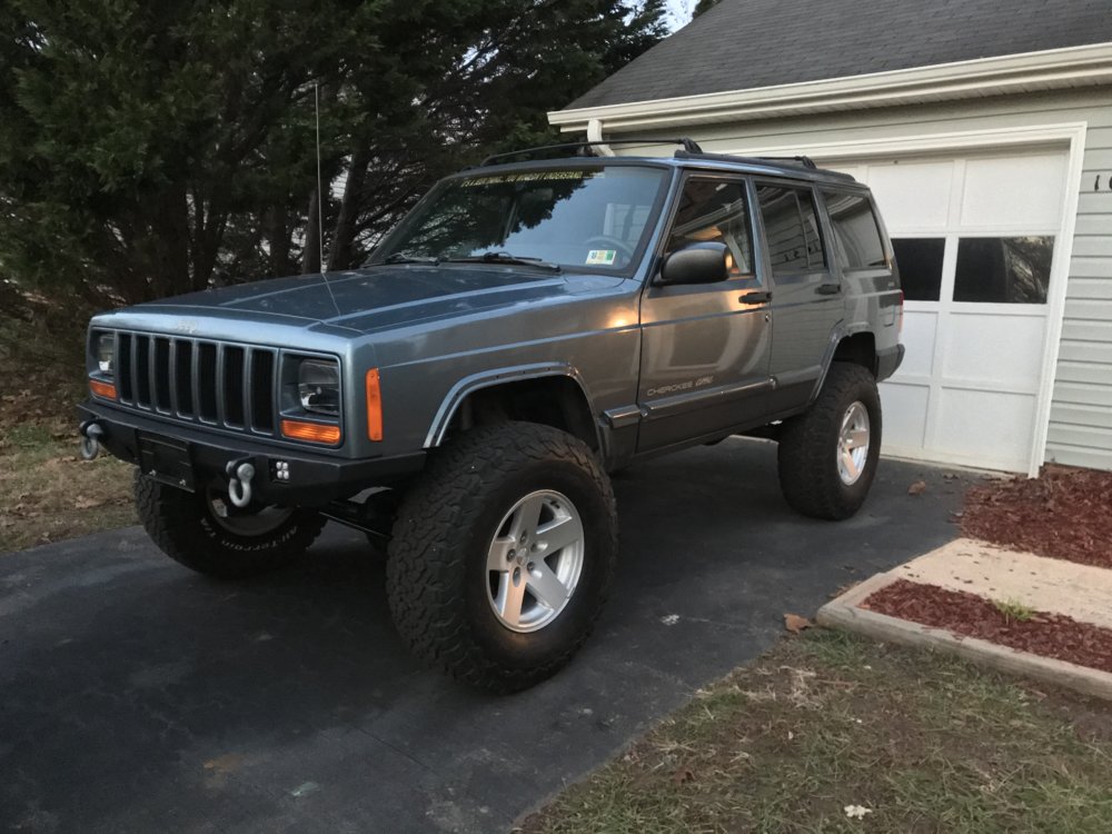

Here is the ride, nothing crazy. 3” lift with 31s and a set of JCR bumpers.

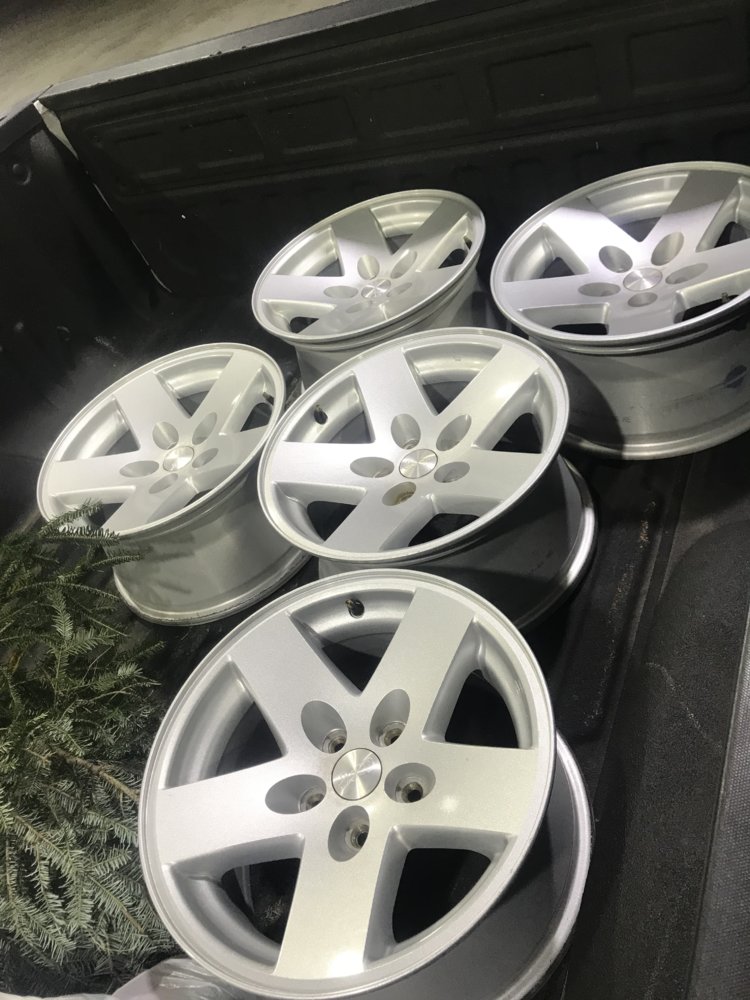

Picked up some pristine TJ rubis for $225. Older lady said her wife almost threw them away.

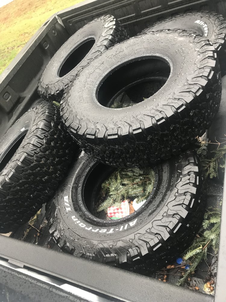

Snagged some 285/75s with less than 5000 miles.

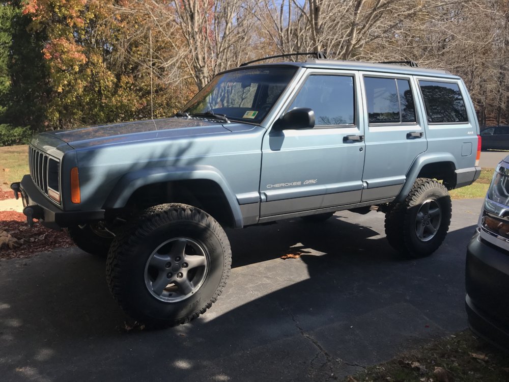

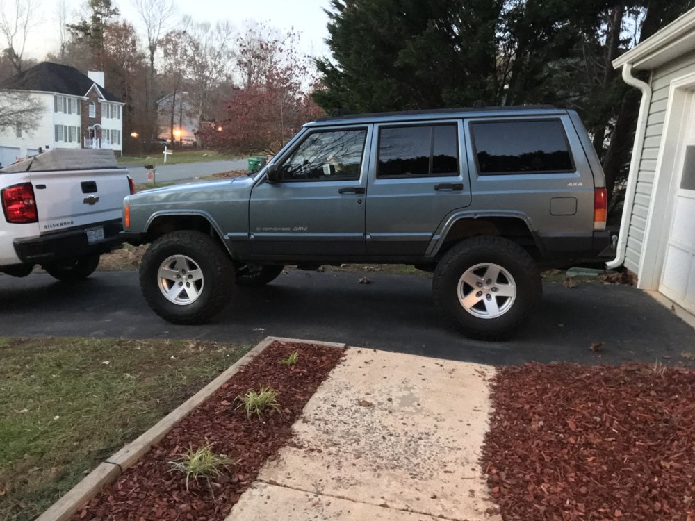

I managed to get the tires mounted and the flares removed before my daughter lost her marbles last night. She is getting her 2yo molars and my wife works from home...it’s a war zone. Good news is, no rubbing anywhere on the test drive without any trimming.

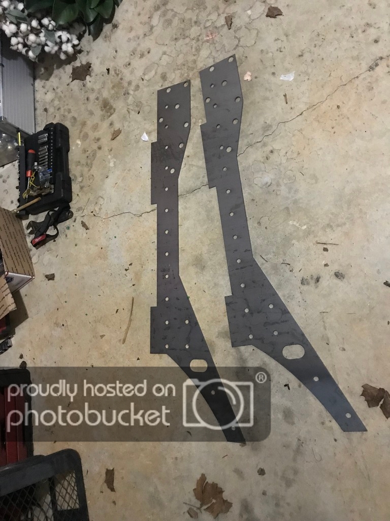

Finally got the front frame stiffeners in from HD Off-road, still waiting on the steering box brace from Ironman4x4, and meeting up with @NickMaul to get his axles on Sunday. Next weekend should be a busy weekend!
Are you taking your carpet out to weld them in? Im going to be doing some myself soon
The mids and rear will need the carpet lifted. It’s a crappy job but it is worth it! Can’t wait to keep seeing progress!
It should a good time! :beer: Thanks man, me neither, I just want to take it riding.
