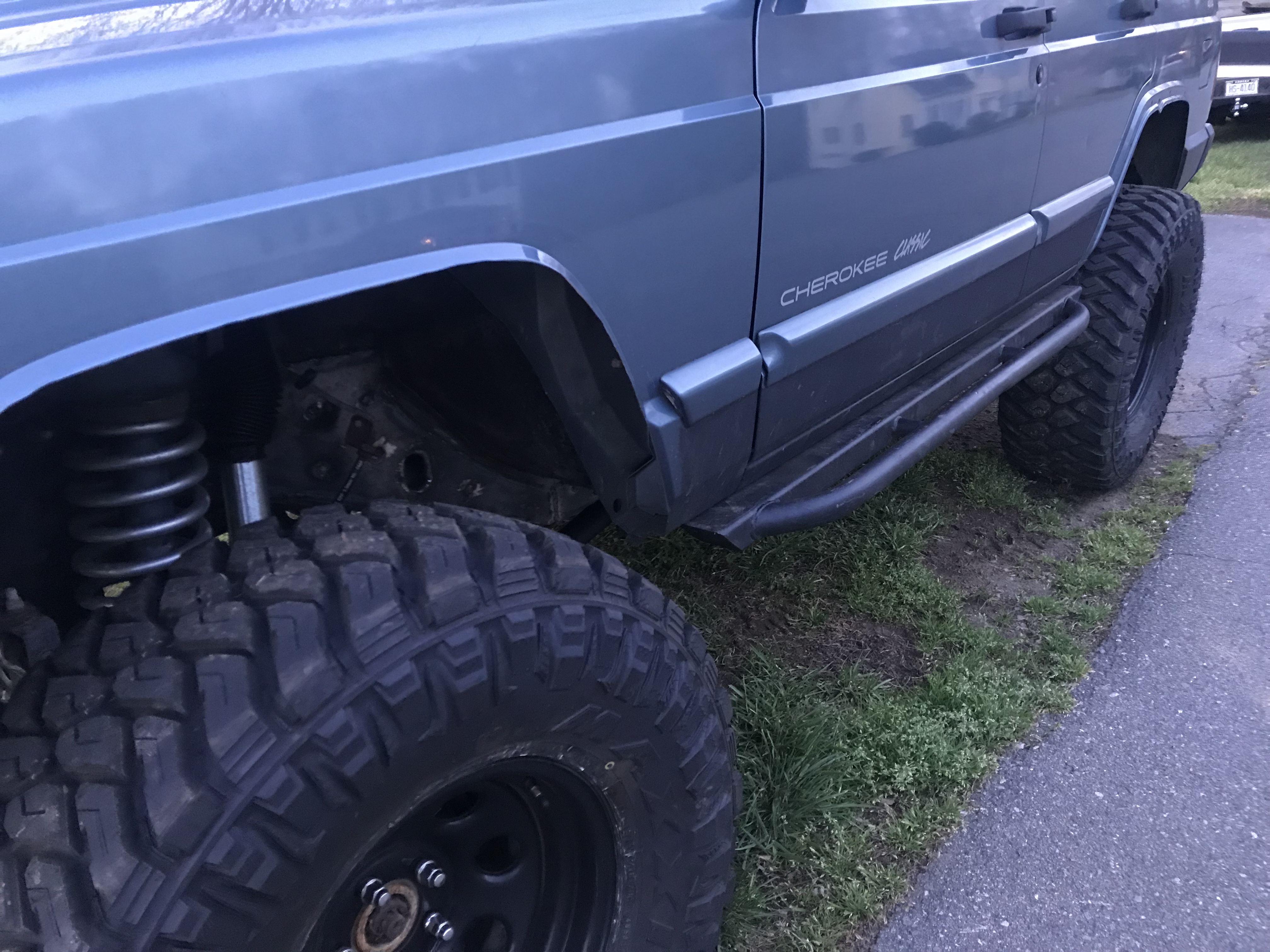

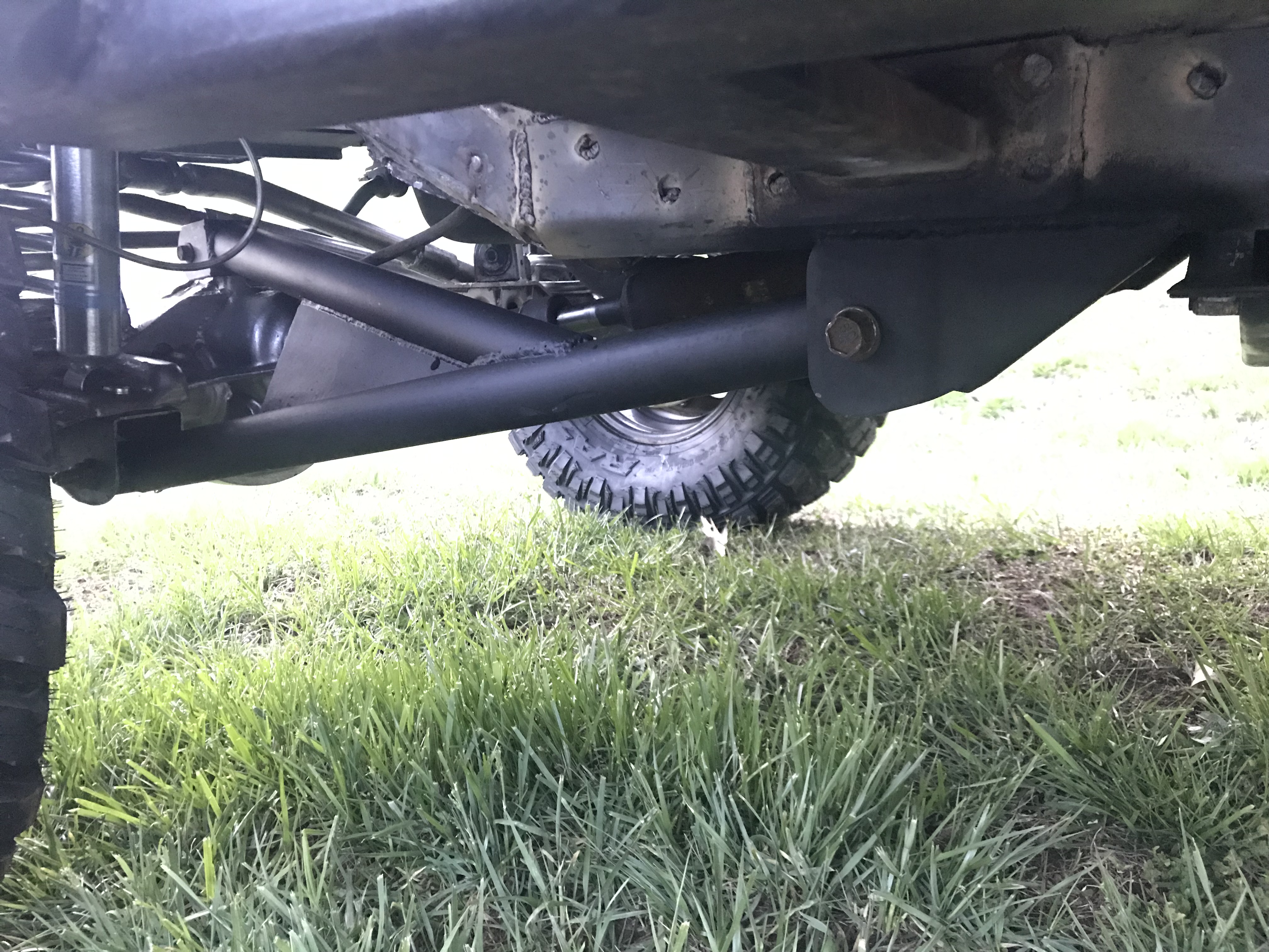

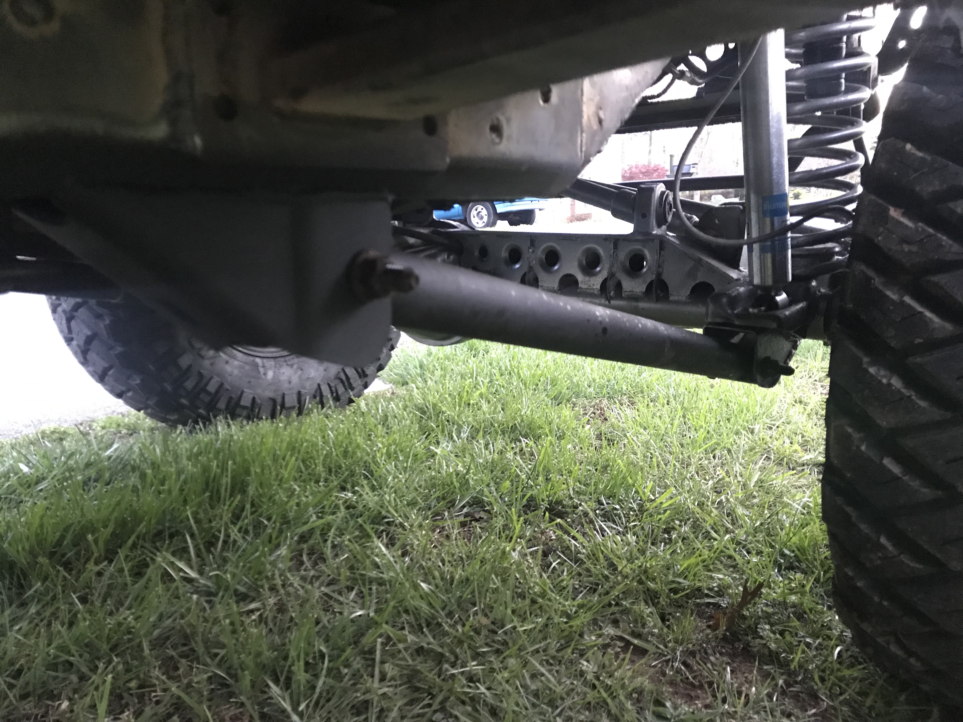

Been a little bit since an update but some good stuff going on. Picked up some sliders and mid stiffeners a few weeks ago and hooked up with @marty79 to help weld them in. While I was out there he noticed the sh!tty position my axle was in. My coils were resting on my bumpstops o_O We talked about the best option for now and we went with a version of the IRO kit. John is a great dude and does some awesome work!

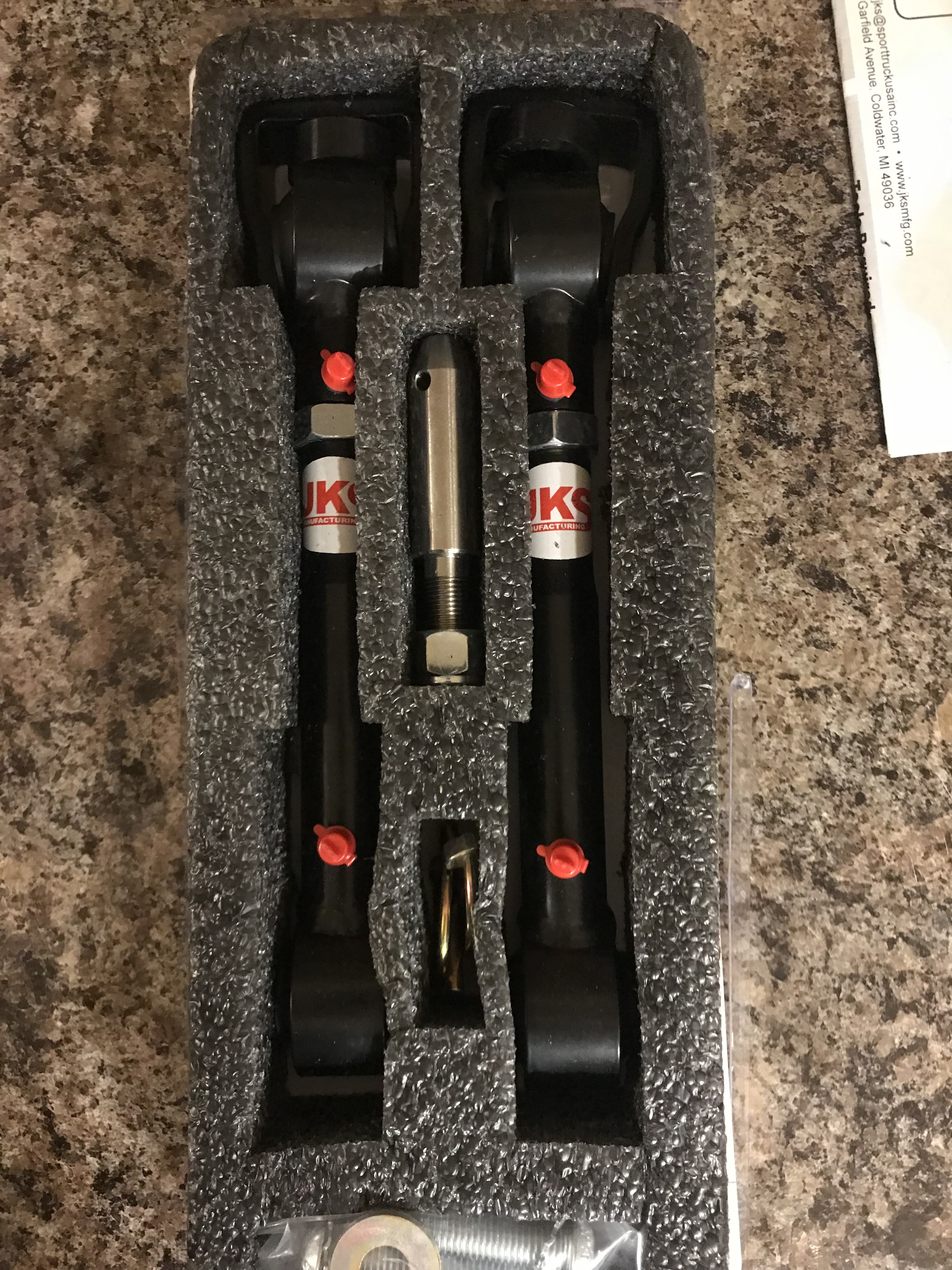

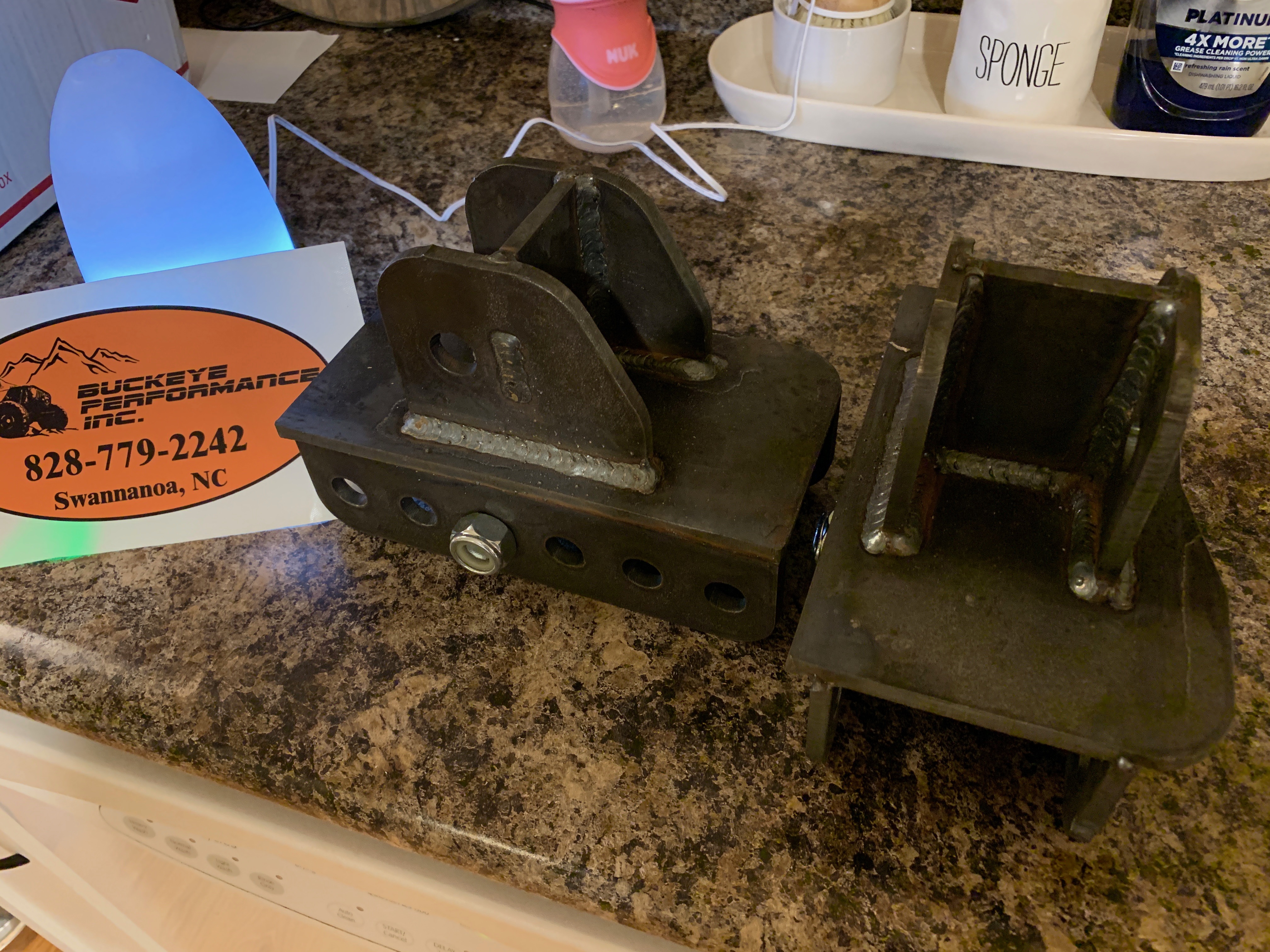

Also picked up some shackle relocation boxes from @BUCKEYE PERFORMANCE INC. (they are very well built) and sway bar disconnects.
I wanna see some articulation with those sway bars disconnected (should've done it here haha). Glad to hear it drove so much better and very blessed to make a new friend.

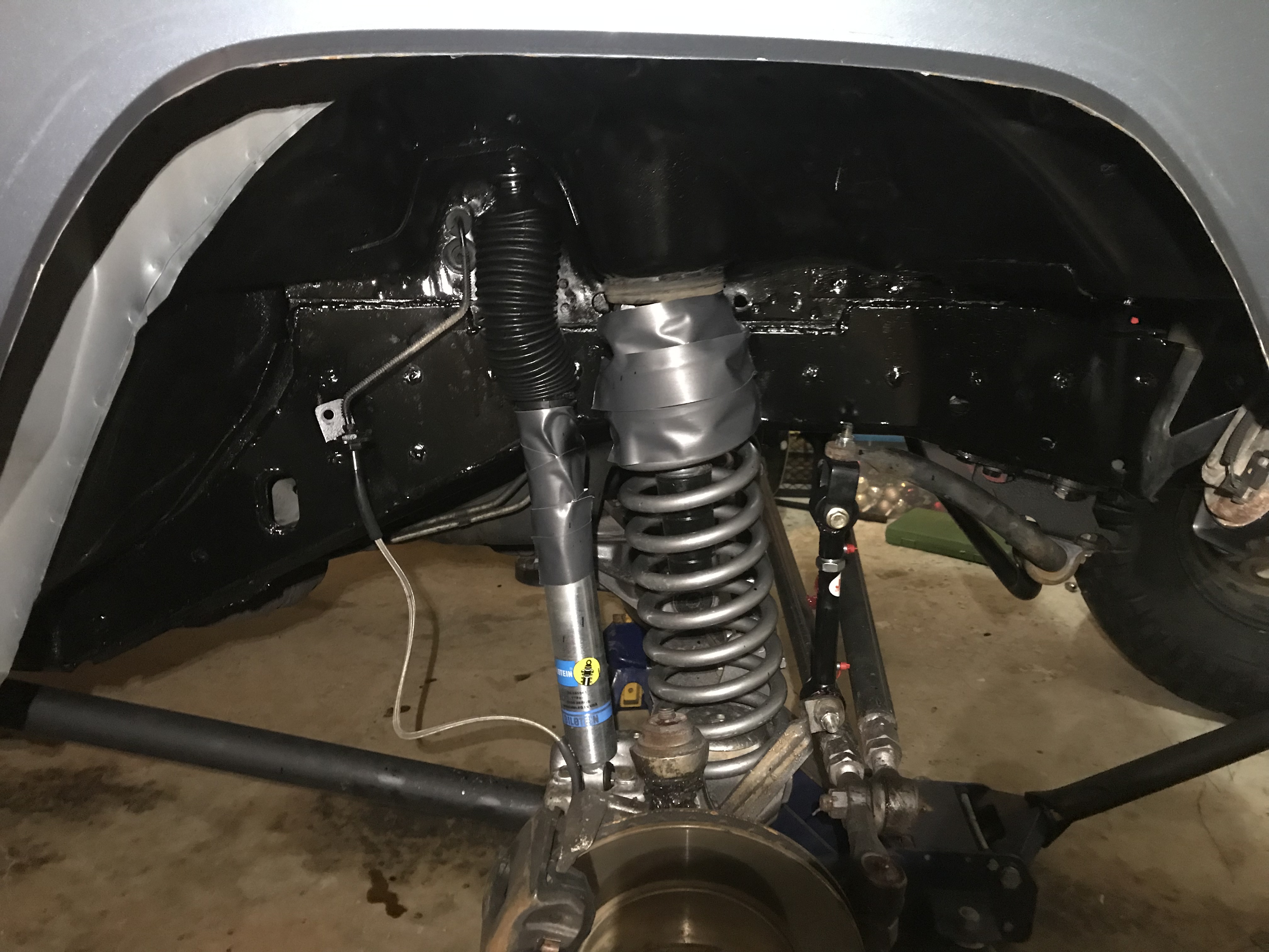

Not a whole lot to report on. Got the the relocation brackets and disconnects installed. Painted inside the front fender wells and stiffeners...it came out pretty good. Not much left, sold off my bumpers and have some new ones being made, pretty stoked for them. Looking to make a day trip somewhere to see how she does. Anyone down or have some recommendations?

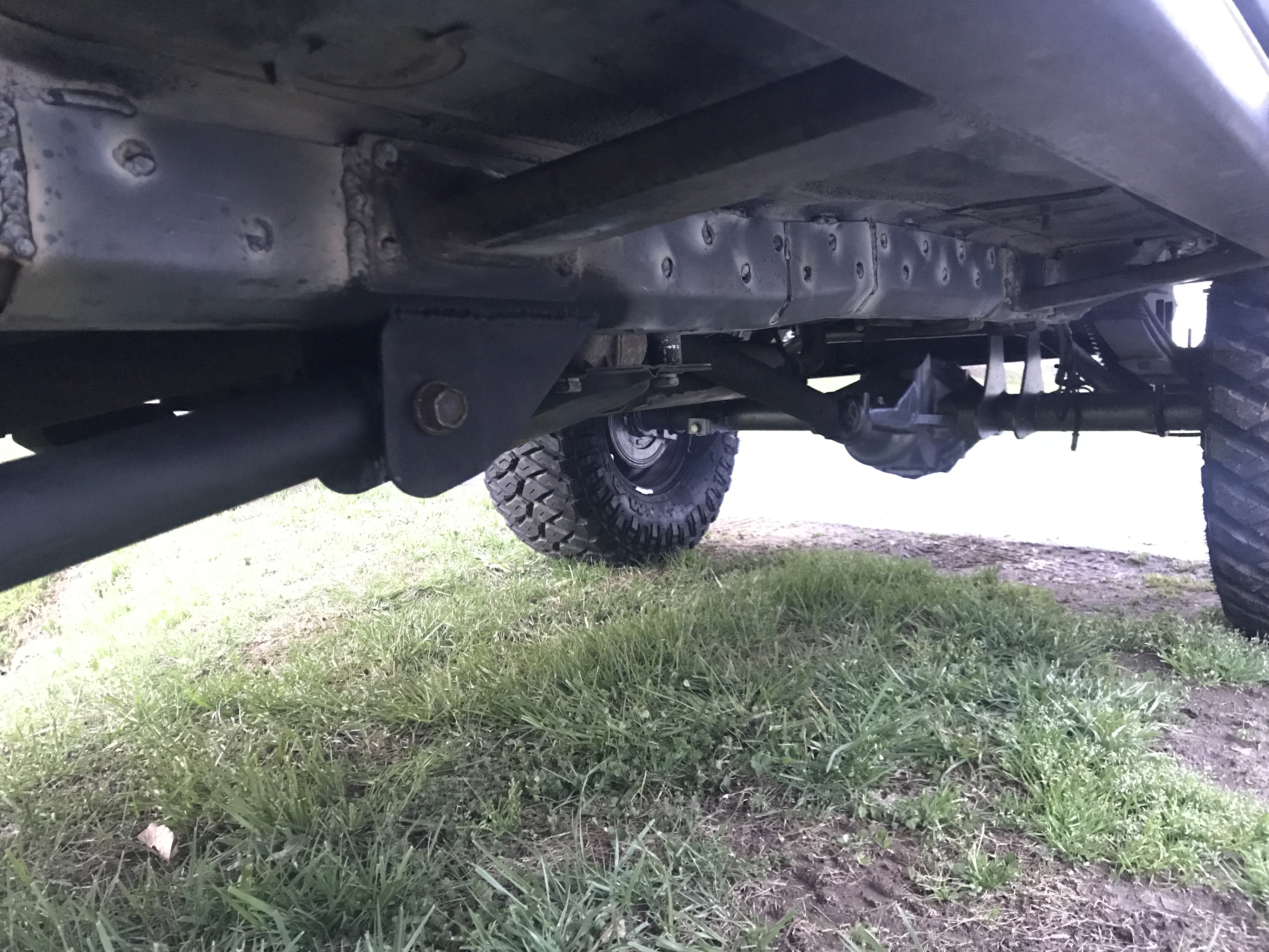

Am I the only one that welds up the entire rosette on frame stiffeners? Those need more welding in my opinion.
No, you are not. and they need much more weld.
The reasoning was being nervous for heat distortion with the uni and I read somewhere intermittent welding was good for stiffeners... do you guys recommend hitting the whole perimeter? I am definitely not an expert in welding LOL.
Fill the rosettes and double the welds on the edges. From the pictures it doesn’t look like you even have 50% of the edges welded
