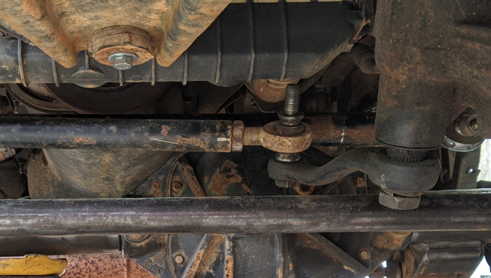

Flipping the tie rod to the top of the pitman arm would help some, but probably not going to buy you enough room on its own. Swapping to a forward-facing pitman arm might be the way to go. It saves you the difficulty of fabbing for an outboard box, and saves the heartache of wondering when it's going to let go.
Make sure to do your homework on whatever TREs or rod ends you want to use for the drag link. I wasn't able to find any that actually make the angles needed when the passenger front is drooped out.
Yeah, I’d gain a bit of up-travel clearance right there. The draglink TRE is every bit as close to the tie rod as it looks like in those pics and makes contact for sure. I’ve got another TJ pitman arm here to flip as an option.
TRE angle is definitely a concern. Those ORI’s drop out a ton. I’m gonna try to stay away from heims in the steering but may have to go that route.
I'm sure I have notes on it somewhere, but my recollection is that the "Chevy 1 ton" or whatever TREs would only do about 15-18* of misalignment. A 3/4" heim with misalignment bushings was about 30*. If you buy the good teflon-lined (FMX??) joints, they last several years before they start getting loose. All I know for sure is that I drooped out the passenger tire and tried to hook up the drag link with TREs... it wasn't happening, couldn't get there from here.
Oh, and if anybody does opt to go with heims on top of the stock pitman arm, be sure to check the radiator clearance. It's really tight when turning right with a 1.25" body lift. What size joint and which misalignment bushings you can use will probably be dictated by that clearance.

The radiator is the problem. If you take the stock pitman and just put a heim on top, you end up within about 1/2" of the bottom hose and tank.

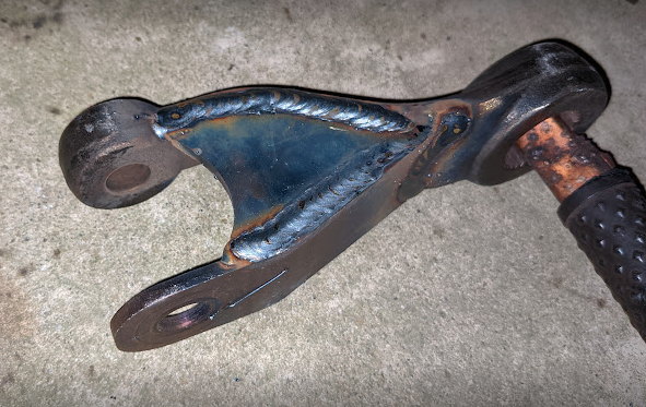

Modifying the pitman arm to capture the SRE is no big deal:
I put over 20k miles on all heim steering and never really had a problem. They wern't even baller heims, just 15$ Barnes heims. I always kept a right and left in the glove box but never needed them. I would have no fear of running heims on the street with steering.
My LJ currently has all heim steering on the aftermarket "high steer" on the D30. It has horrible geometry and drives like hot garbage due to bump steer, but the heims are solid. :laughing: I will be staying with heims once I get the tons swapped in.

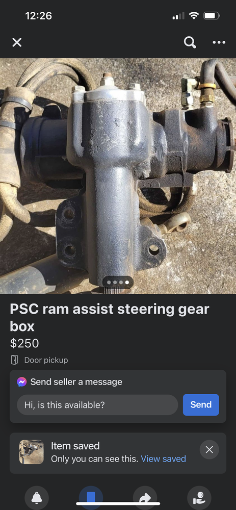

Heck of a deal on what appears to be PSC Scout II box. Outside frame mount, forward swing. Parts might be hard to come by if you ever needed to rebuild it though.

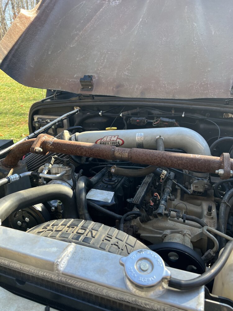

I ended up with a couple of the big Ford boxes from the 78/79 Broncos. I think that’s the route I’m gonna try to go. It looks like it’ll fit between my shock tower and the grille. I need to cut the existing pan hard bar bracket off to really tell if it’s gonna work though. It’s coming off to get reworked anyway so I just need to dedicate a couple of days and chop stuff up.

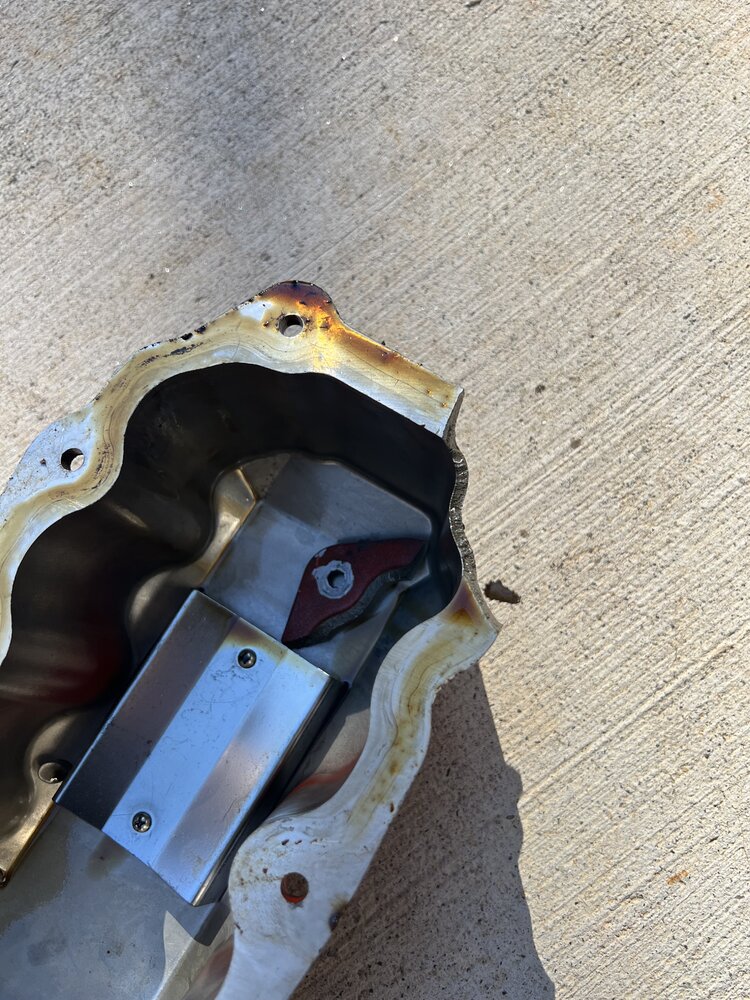

Might have finally fixed the oil leak from the back of the engine. Now I can hopefully degrease and pressure wash the rest off of it and not get filthy working on it. I had replaced the valve cover gasket when the body was off but still had a leak. After driving this thing down to my parent‘s house in SC a week or so ago, it was pouring oil underneath it. The back corner of the valve cover was broken off. JB welded it in a rural king parking lot to get it home and then swapped the “fancy” valve cover that was on it for a factory stamped one. I let it idle for a bit after changing the oil and it’s still clean underneath it. Next up is the trans pan that’s seeping around the gasket.

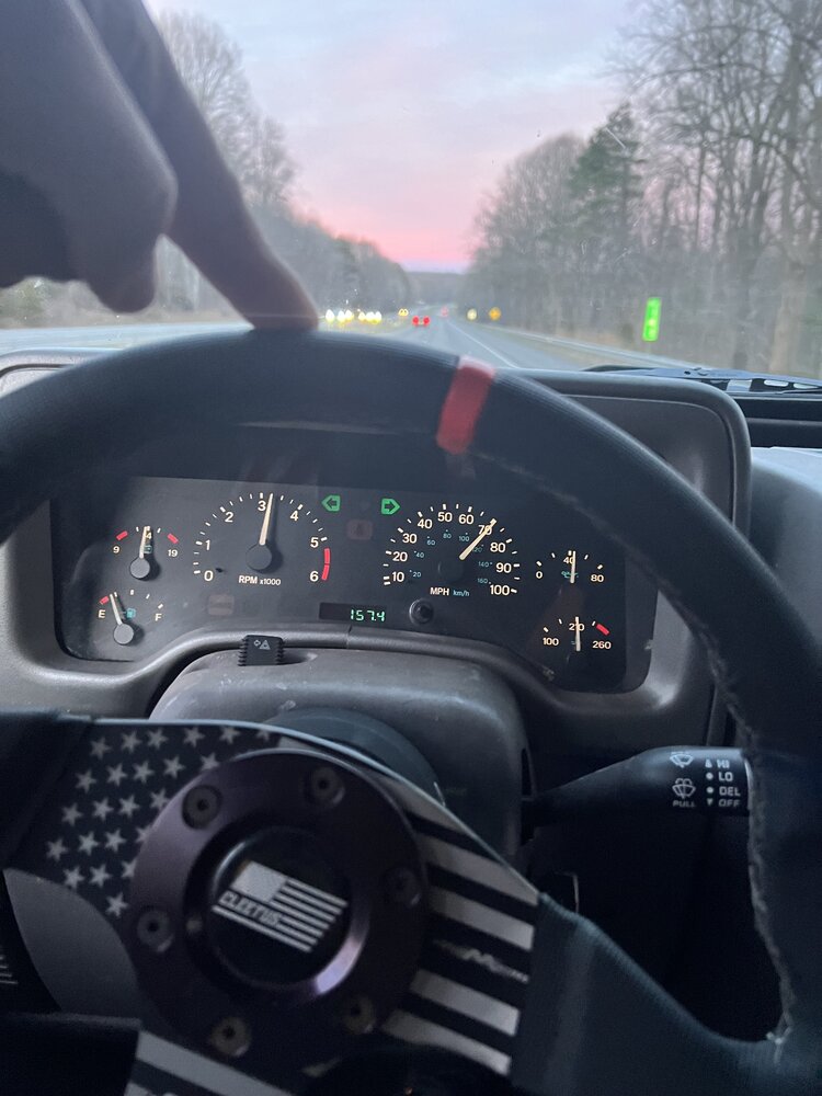

This is the crappy side to the front suspension in this thing. In the couple inches before everything hits everything, it drives really nice. That’s 70ish mph down I-40 with no swaybars and other than setting the toe and centering the rear end, it’s not really aligned. It’s actually impressive how nice it goes down the road.

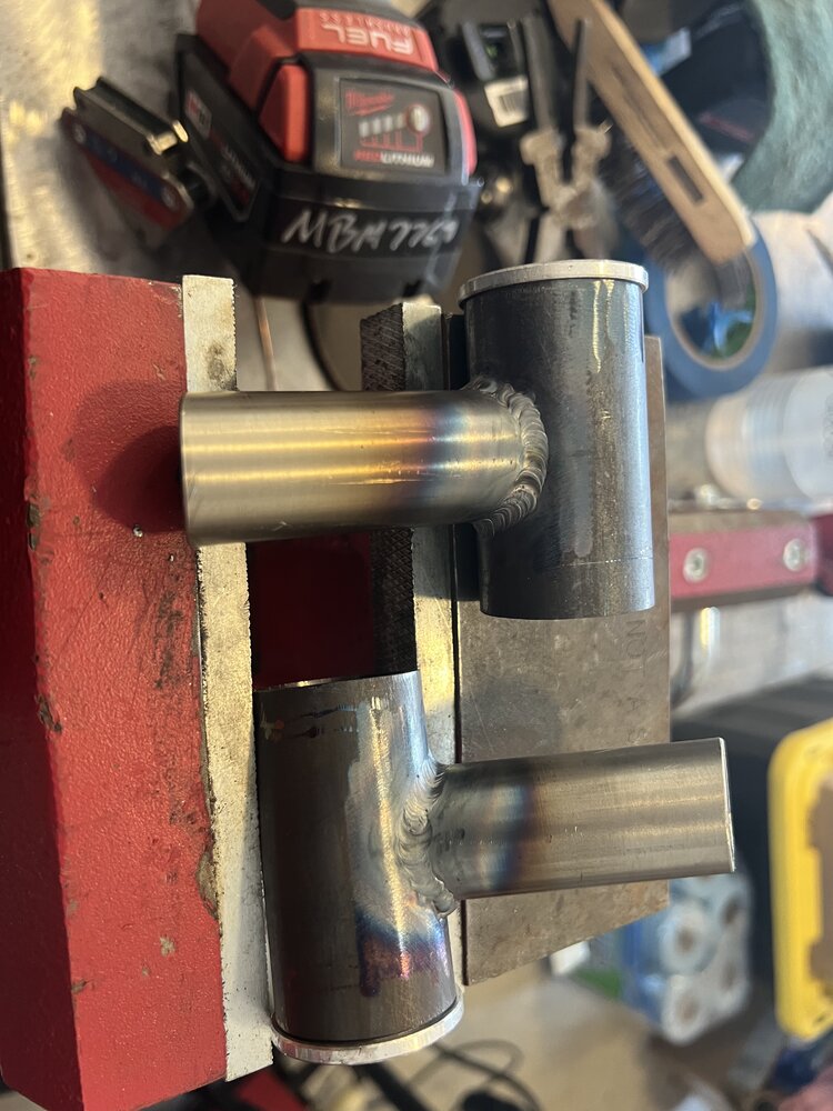

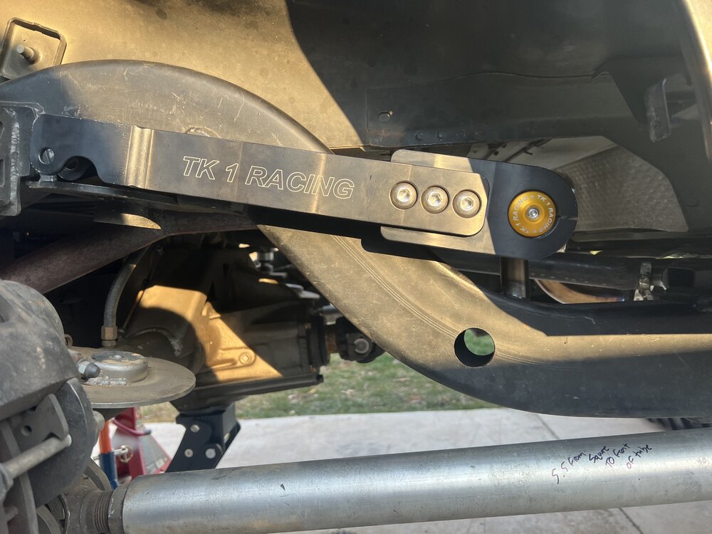

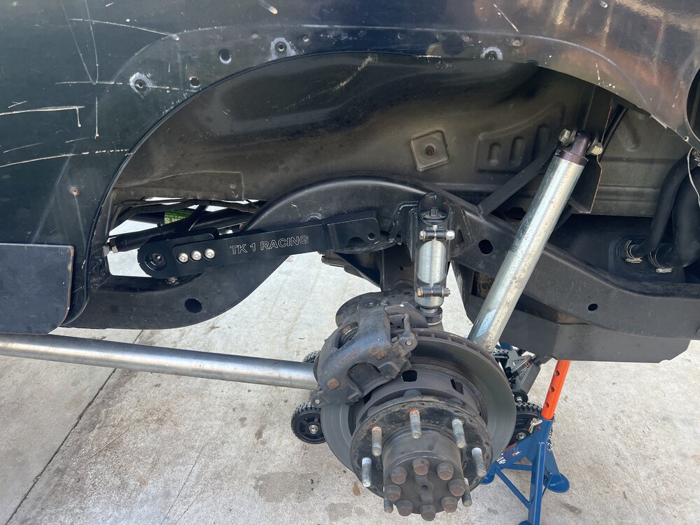

I got started on the rear sway bar yesterday. Pulled the springs and put the axle at full bump to figure out where I could slip the bar in. I’m using a TK1 Racing “Rockcrawler” kit. Super nice stuff. I’ve got the mounts I made partially in place but still need to add a tube brace or two before it’s done. I also need to bend the arms a bit to clear my coil mounts on the frame. I talked to Tony at TK1 and he told me how he bends them. I’ve got the stuff to make a version of his bender. I got all the steel to make the sway bar mounts and bendy tool from Stock Car Steel for less than $20. The “drop” rack is what’s up for random bits. Lots of short lengths of dom and 4130 tubing.
