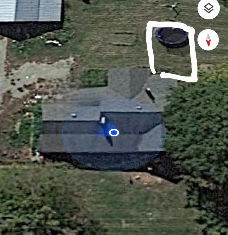

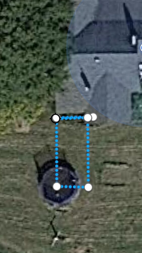

Edit:here's a couple pictures and a concept of where we want to put it.

This is a slight concern. Only logical spot to add on is off of the dining room. Not ideal.
