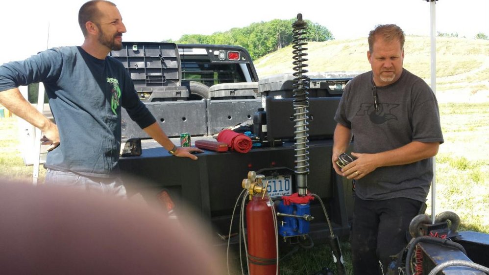

I brought everything; shims, tools, oil, rags, n2, extra springs, impacts, torque wrench, micrometers, jacks, plywood, stands, because i knew he was flying out without tools. Only thing I forgot was a drill bit & set screws for modifying bleed on the piston. Also don't forget red lock tight, like I did, in case the shock eye comes lose during shim change. If your real diligent, I was due to my OCD, bring a vise and soft jaws.

What an awesome day tuning yesterday with Wayne.

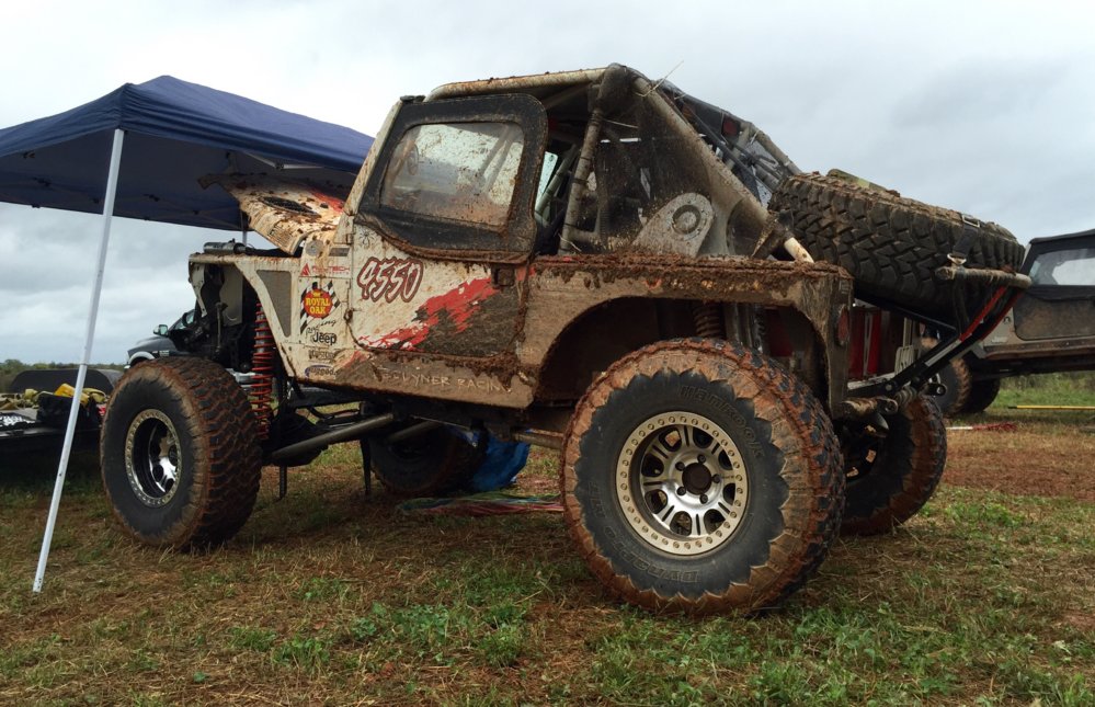

Had an absolute blast working on @karatejosh buggy making huge Improvements on the ride quality.
Learned a lot and had a great time hanging out with Wayne, Josh, and the guys from Matzell Motorsports.
Between My dad @moldman05 Russ, my fiancé, myself, and josh, we could pull all the shocks off in about 10 minutes.
Not sure how many times we pulled the shocks, at least 8 maybe?

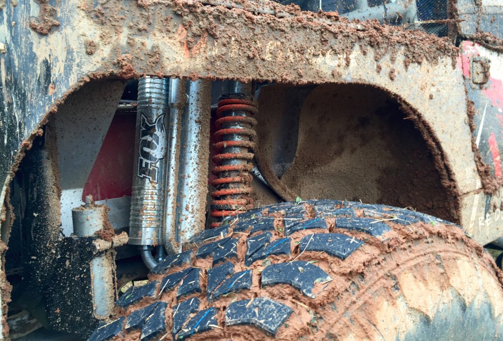

Wayne definitely is the man, not only can he watch the buggy and see exactly what it needs, but just listen to the exhaust note, when the buggy is out of sight, to understand how the throttle is applied, to know what adjustments to make.

It..... Is..... NASTY! Rained all night and half of today, but Wayne does his magic rain or shine.
Still out here:
