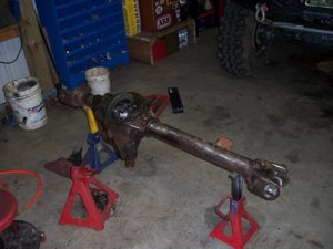

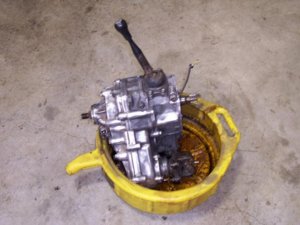

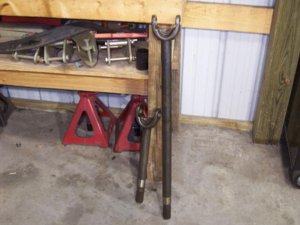

But got a little more done...The 60 is geared 5.13 now with a detroit. Got the 35 spline chromo inners in, and the 35 spline outters are on the way (Randy's Sent 30 spliners the first time accidentaly). Got the toycase a little bit cleaner. And now we are just waiting on parts from BTF. Thanks to Seth at Rock Monkey 4x4 for getting the parts from Randys. If yall need anything from Randys or Marlin Crawler then make sure to give Seth a call.

looks good Sam. When are you planning to finnish it up? What wheelbase are you going to have? i'll send you some pics of what I started on today! later
well i still dont even have a rear axle yet but I hopefully more sooner than later. After it is all said and done I will probably be around 102". Its about the same wheelbase I had and loved it except for the t-case skid hitting all the friggin time but that will be taken care of with the toycase. Havent decided on duel cases or 4.7's in one case yet. But hopefully should have my mind made up in the next day or 2 and get that stuff ordered. Its still got a long way to go but this week should get me motivated with the front axle being hung ect.

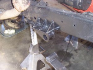

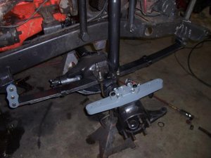

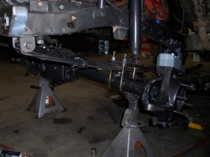

Got more done this weekend. The front is under with the YJ leafs and its looking pretty good. Got more parts including the bobby long joints that are PIMP. These things are strait beef and I see the 35 spline outter breaking before these do. Also got the knuckles back on and High steer arms on. The BTF arms are sick. The steering should be strait ridiculouse with the stuff Dan talked me into. :D Anyways on to the pics....

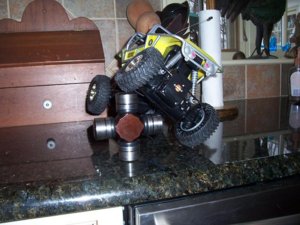

These are the bobby long joints and a wallyworld crawler. :D Gotta have something to wheel right?
