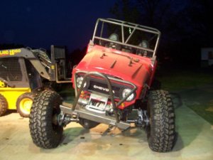

And so it begins....again....

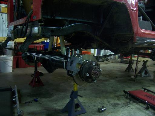

Got the rear axle back in yesterday all painted up with the shock mounts, traction bar brackets and perches all welded up. Started building the traction bar too but havent finished it yet. Here are some pics just messing around and flexing it out to check shock length and clearances.

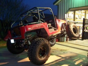

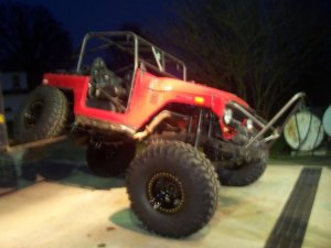

Little update... Steering is totally finished and welded - 1.75 .250 wall DOM. Traction bar is also finished and should work great! Waiting on a torque converter, the 5.13's for the 14bolt, and the twin sticks for the toy case. As soon as the torque converter comes, we will install the tranny/t-case, and build the driveshafts... :driver:

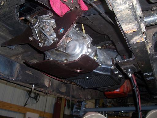

Ok here is a little update. Got some things done on Monday...Tranny and t-case are in and 14 bolt gears are almost done also worked out all my brakes for the 14bolt and 60. Tranny and t-case were a beast to get in but we finally got a system that made it easy. Its all the little stuff now...just got to keep pluging along.
attachment.php
attachment.php
