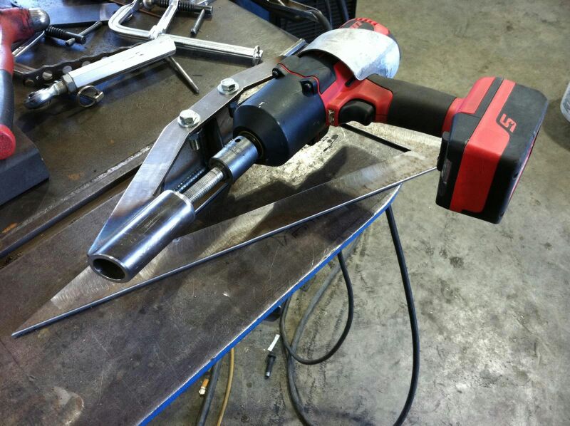

Skid done and tank mount started!!
hey guys, on the skid plate, are you adding a piece to each side to bolt to the factory holes in the frame too? or is that complete? reasoning? looks great! i'm just curious as I'm trying to figure out how to do the skid plate on my build.
Nope that's it. It completely protects everything underneath that it needs and simply attaches with 4 bolts. The crossmembers it attaches to are 2" .250 wall tube so I don't think it'll bend to easy. Simple and effective was the plan.
Awesome! It looks tough for sure. It looked like it covered everything nicely. I just wasn't sure. Wasted weight is no bueno for sure. Thanks for the reply.
