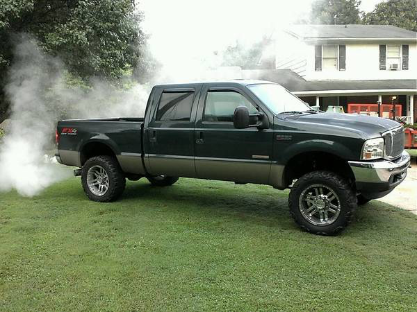

Every 6.0 I ever had, wound up blowing white smoke, but they were towing 5-10k daily. I’d imagine these days, if they haven’t blown white smoke yet, they’re not going to, or has already been bullet proofed.
A lot of the white smoke is due to running a ficm with low voltage and it hurts the injectors. Mine does a puff at start up but archoil helps a ton

I hear ya…all but one of mine that weren’t bullet proofed looked like this at all times inside of 200k. But I do know several guys still running stock, towing a boat or camper once a quarter, with no issues.
