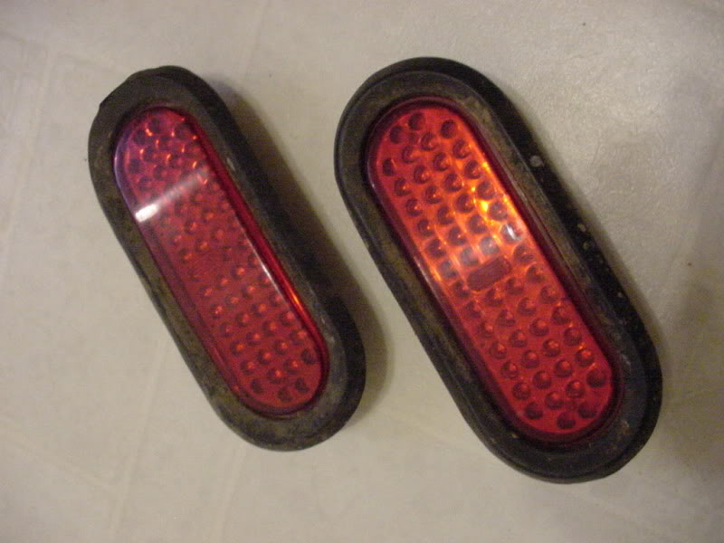

Got some sweet LED tail lights! These suckers are bright!!!

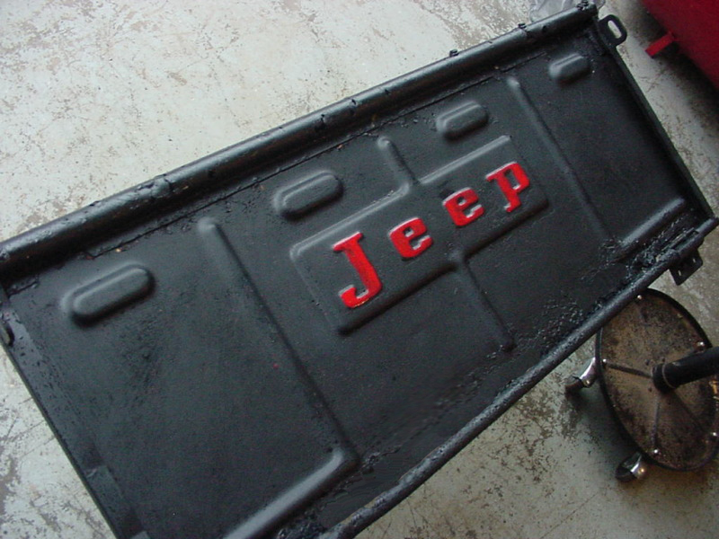

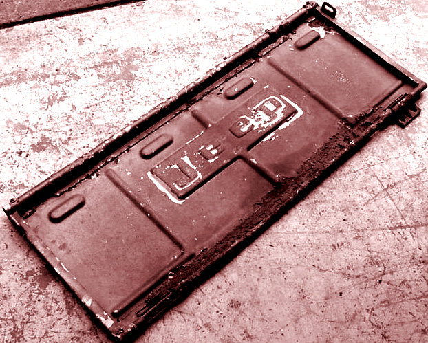

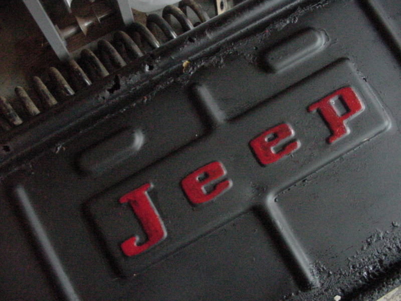

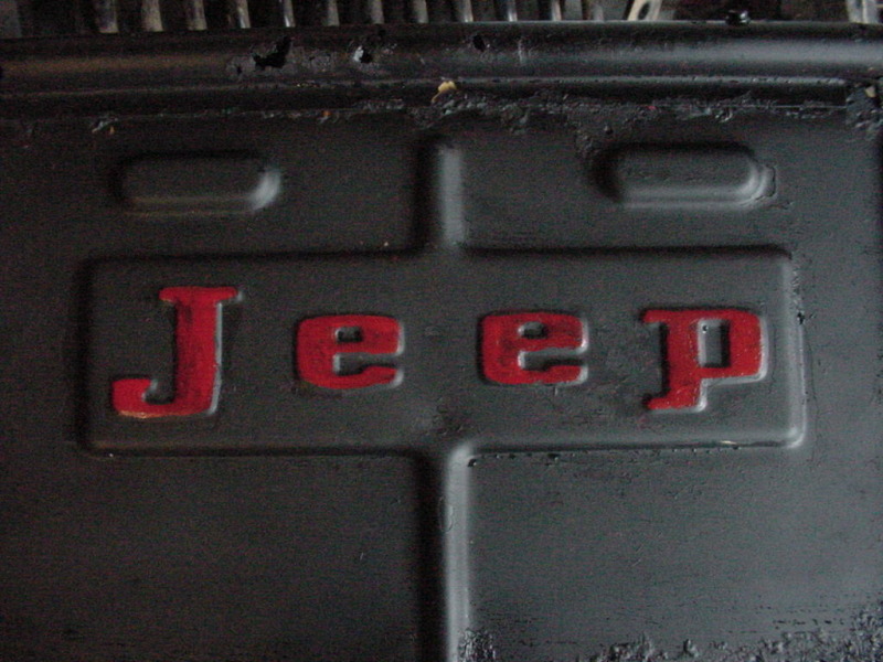

Got a cj5 tailgate to go onto the yj...old school metal!
Painted up the tailgate....
Thanks guys now I need to fab up some latches or chains for it.

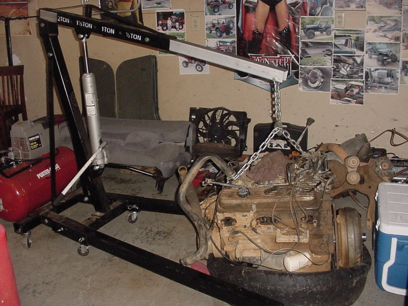

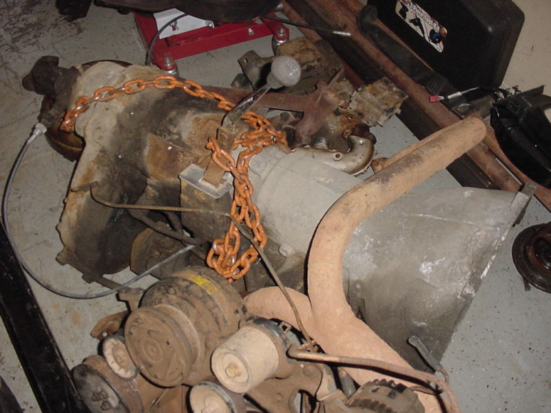

A few days ago I picked up a chevy v8 tbi motor, 350 auto and 203 t-case! Not sure if I'll have the room for a doubler but we shall see. Now I need to find a 205 t-case with 32 splines.

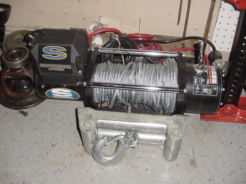

also got an 8500lb Superwinch to use on my trailer and jeep...
Yeah it's really nice having the winch to pull things up onto the trailer!

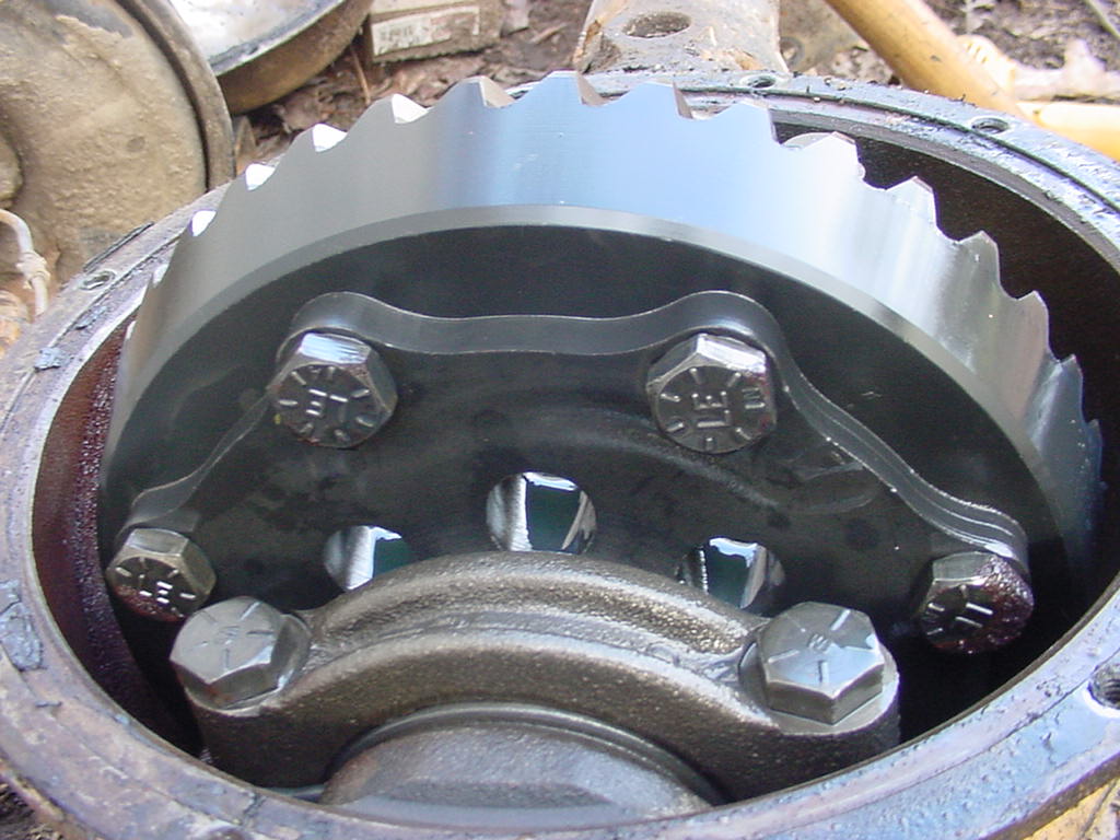

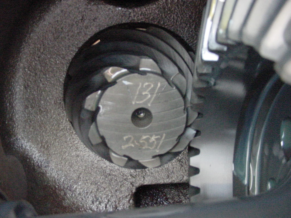

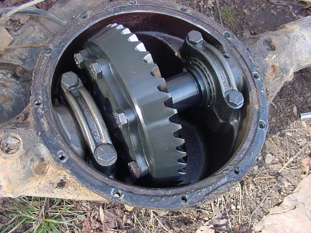

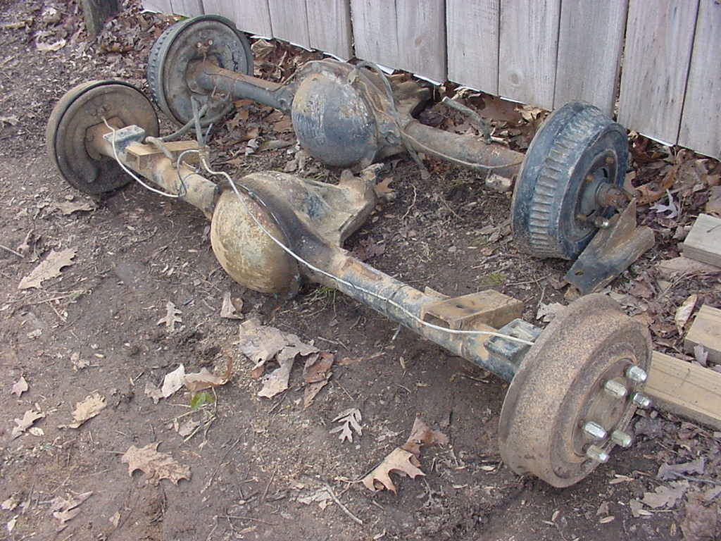

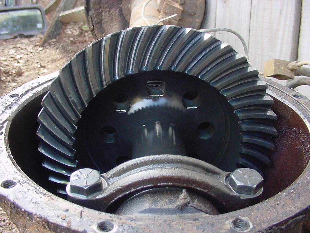

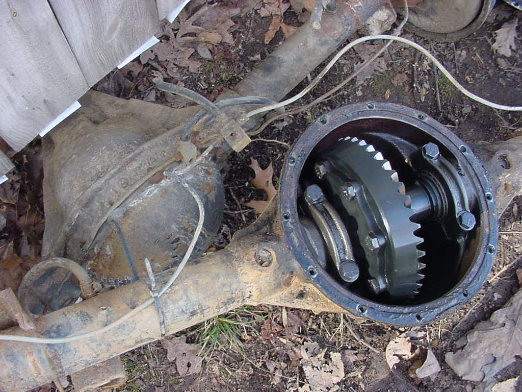

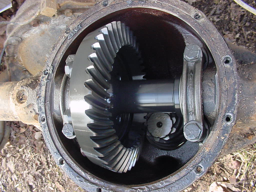

I got a j10 amc20 rear axle with 4.56 Yukon gears, chromoly shafts & full spool. Need to get some gears for the front now. It will be replacing my rear dana 44 axle. It was off set to the passenger side too far. The amc 20 is also wider at about 65" my dana 44 is about 60" wide so I'll be gaining a good bit of width and it will match the front axle!
gears look good!

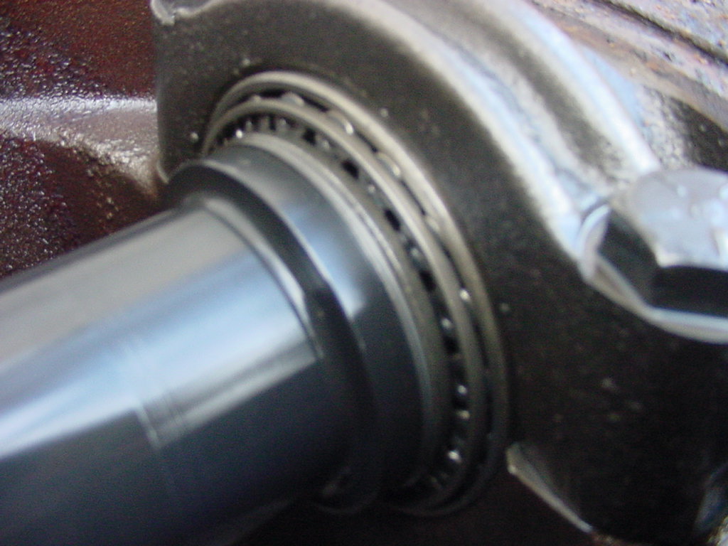

bearings look good...
cj amc 20 underneath with smaller tubes and weak two piece axles..
Thanks guys! The axle tubes are welded to the housing already so that's knocked out. I may also do a truss on it. It has an 8 7/8" ring gear on it! Not bad!

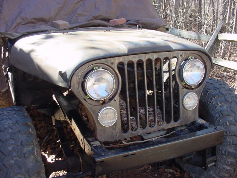

I did a cj front end conversion yesterday!
