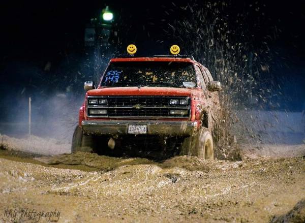

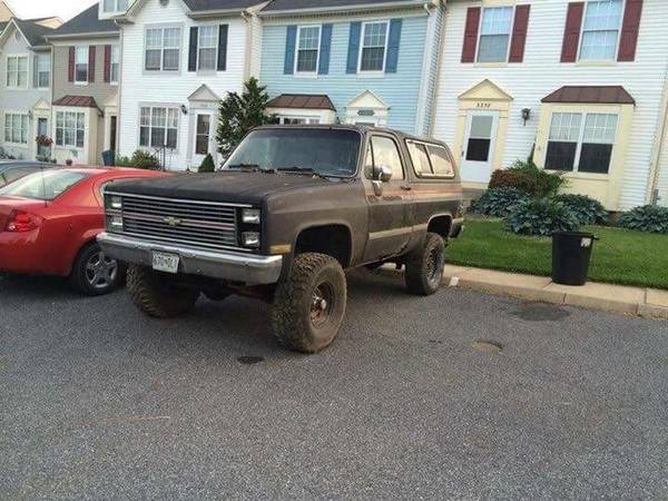

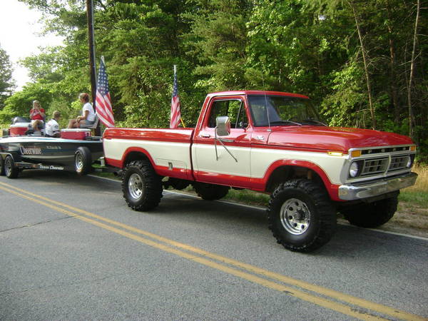

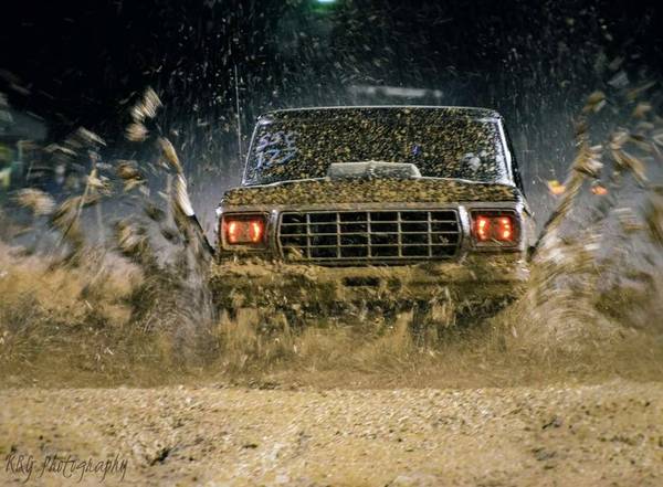

The one that got it started, George: Pretty standard 600hp 521 aluminum headed mud truck:

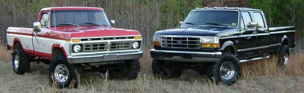

Project Shaw: Fully trimmed daily driver with 500hp 383:
Before-
After-

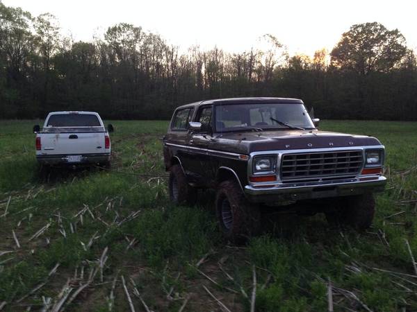

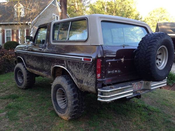

GMB (Get Motivated Bronco): 500hp 466 with iron heads, tows lawn trailers by day and races super street by night:

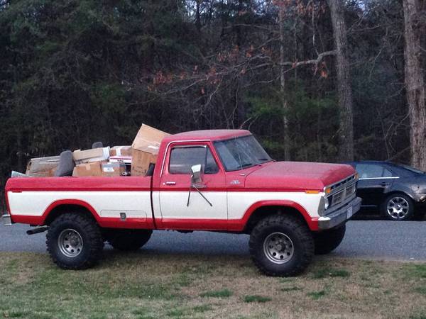

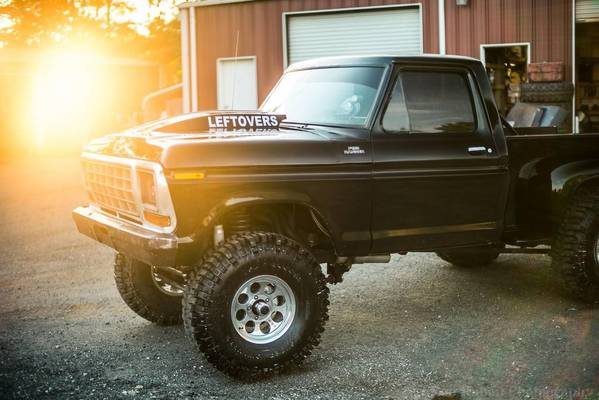

The current Pride and Joy of the shop, Paul's personal purpose built Super Street truck: Project Leftovers, 7-800hp 466, iron headed (heavily worked d0ves) and 14.7:1 running on c16 (currently looking for a set of D0OE-R's or ex 514's)
Before:
After:

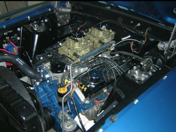

Numbers Matching 69 Boss 302 refurb...

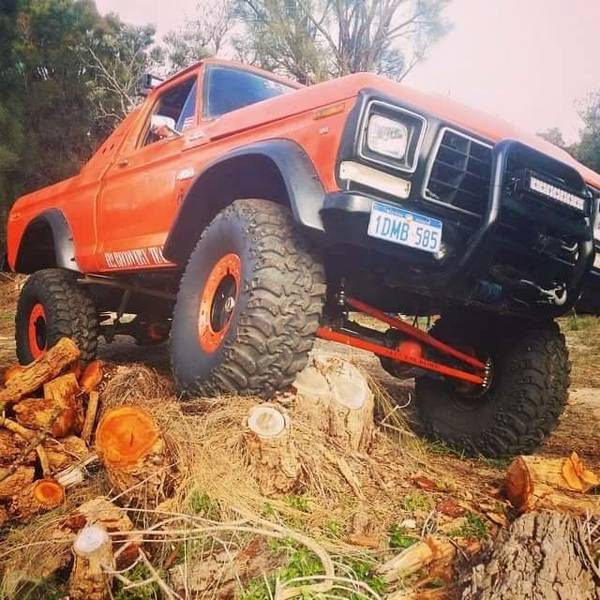

Steering links that made it all the way to Australia:

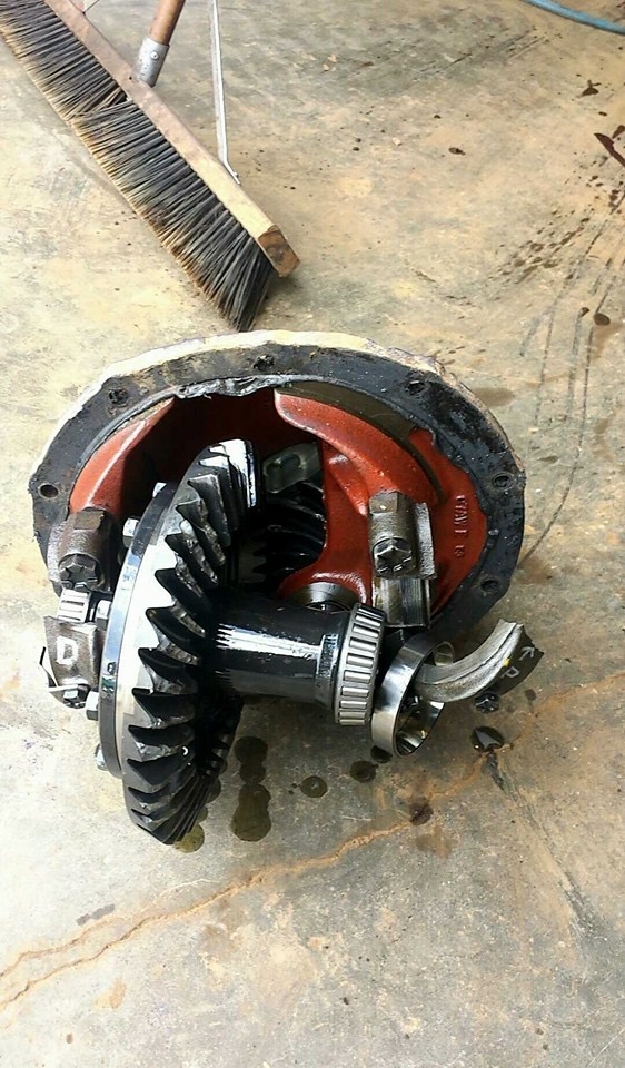

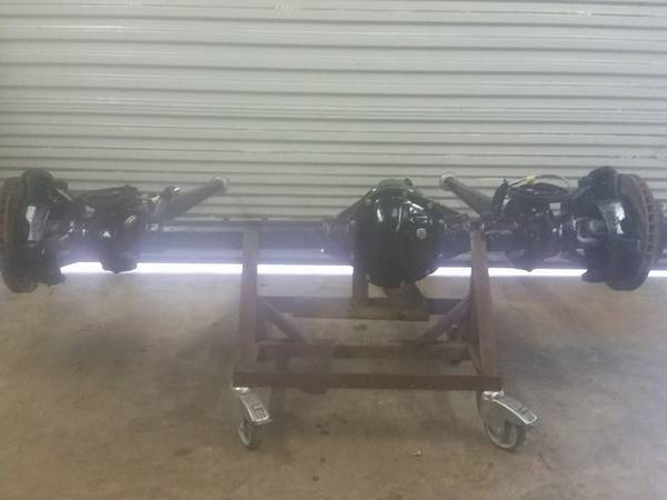

Random axle build:

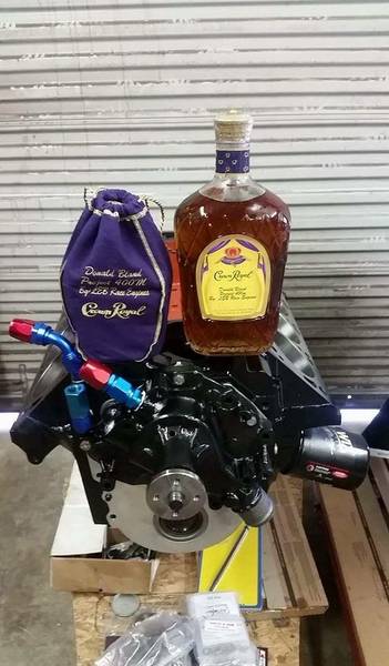

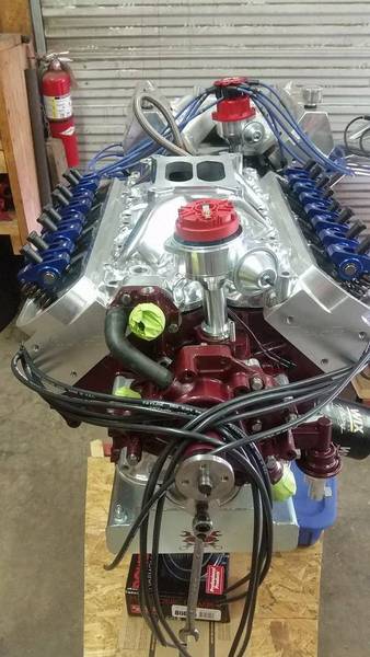

Now I hold this one near and dear to my heart because I'm a 400 lover. Even though the internet says they're boat anchors, this bad boy is going to be one of the baddest NA 400's that still has stock stroke:
And the complimentary customer service (yes I know, no M after 400, inside joke):

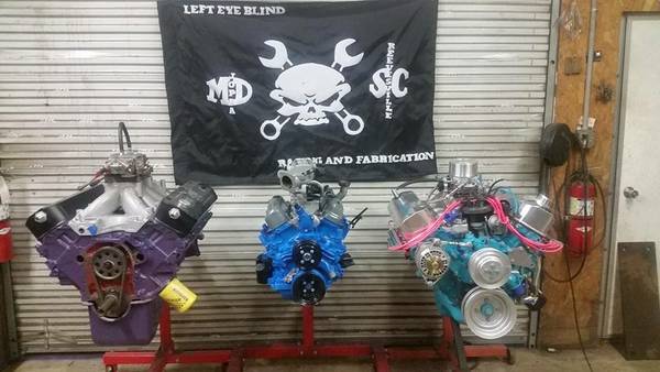

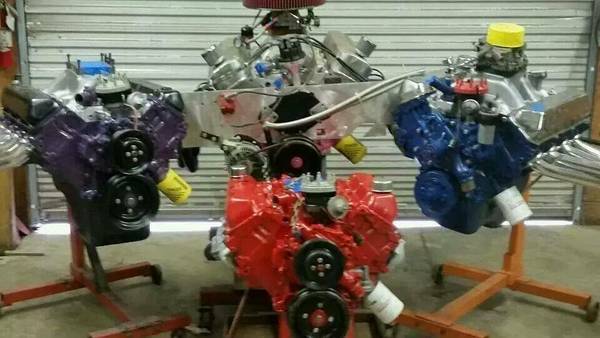

And a couple more...

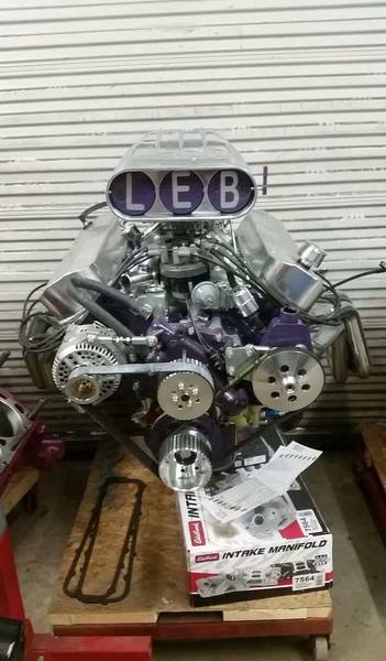

This 466 is headed off to Canada:
Pretty Secksy Weezy:
And a cute little 2.9 between my 460 and the beginning of Leftovers:

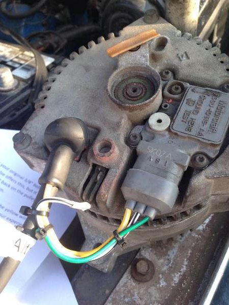

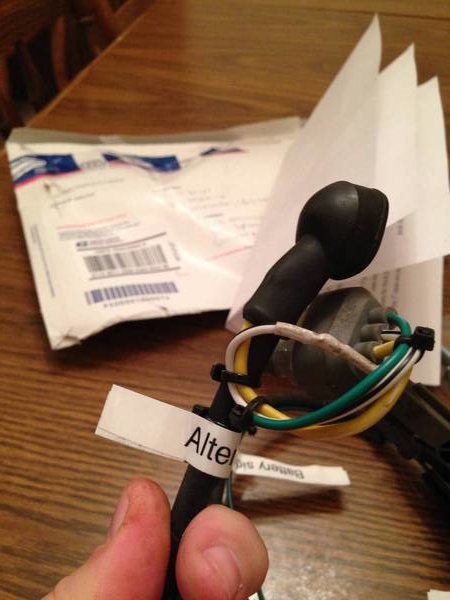

Crazy...just reminiscing now...very first product (outside of engine builds), very first 3G alt swap kit produced, that ended up going on my Bronco. We wrote up instructions and everything...

Just as an FYI, the dual turnbuckle alternator "bracket" isn't a great long term solution.
It was used and abandoned in circle track applications a long time ago.
Without going all "engineer" on you the linear single plane support does little to control fore and aft rotational deflection putting repeated stresses on the internal bearings and the drive belt.
Life expectancy of each is less than 20% of a rigid 3 plane mount.

I don't disagree, the product is primarily a clearance solution for the engines being built. Chances are pretty good our customer base will be going through engines quicker than the mounts, with annual tear downs. Or they're just looking for something 'prettier' in their show queen. If/when it fails...a $50 mount can be tossed in with a $20k build. But if there's a better alternative, I'd love to hear it.

You still see them in circle track, because they are such an easy tensioner to make and use, but (like you're saying) they are used with types of alternators that have proper mounting support and case pivots. If you're using tab pivots on the case of an alternator that's meant for plate brackets, it's going to move all over the place. You only see Heim brackets used with alternators that have something like long double-shear pivots along the axis of the alternator, with a bolt through the pivot (a 3 point pivot essentially) that gets tightened after belt tensioning. That way there is enough alternator case rigidity to support the belt/drive loads against the Heim pivot without twisting the case.
Of course, nothing at a high level in racing is used without being suitable for the intended purpose, and these aren't parts off of production cars that are being haphazardly adapted for race use. These alternators are designed to mount like this, and if the bracket design needs to be changed for some important reason, the alternator case design changes as well.
The alternator on the purple Canada engine is mounted with 3 points, but still marginal for rigidity because of the types of case tabs (and location) and bracket used, having them all on roughly the same side of the case. Hard to tell from the picture. I'm guessing that engine will likely not see enough run time to actually matter though.
Thanks fir the info and feedback. As you stated and I mentioned earlier, primary purpose is a quick, cheap and easy solution for guys that need some clearance. But there's always room for improvement, I'll see what can be done.
