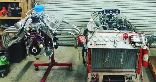

LEB's 1960 CJ5: Here you'll see 144ci of unadulterated fury tackling Rausch Creek. T90/d18 twin stick. D27/D41 with 5.38's and 31" Laredo's.

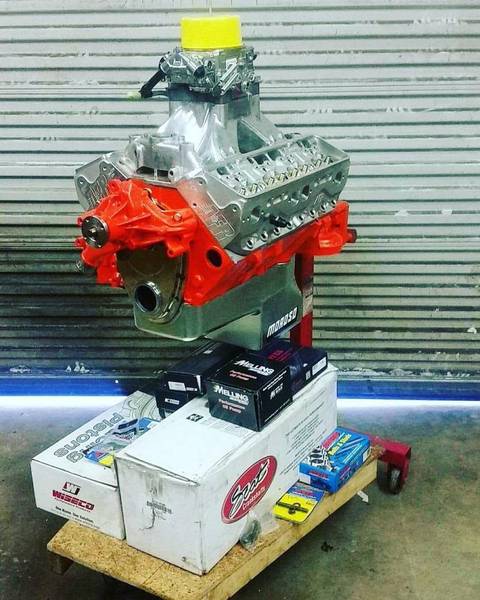

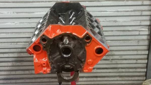

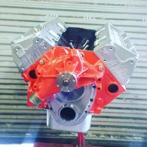

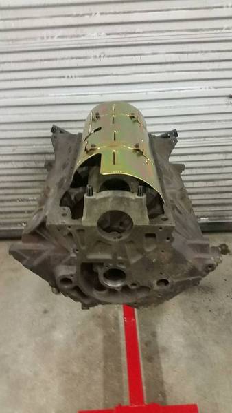

Starting to tear in to the pull truck 460 based 480. As mentioned elsewhere, should be in the 900-1000hp range N/A.

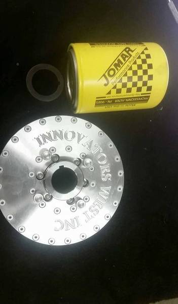

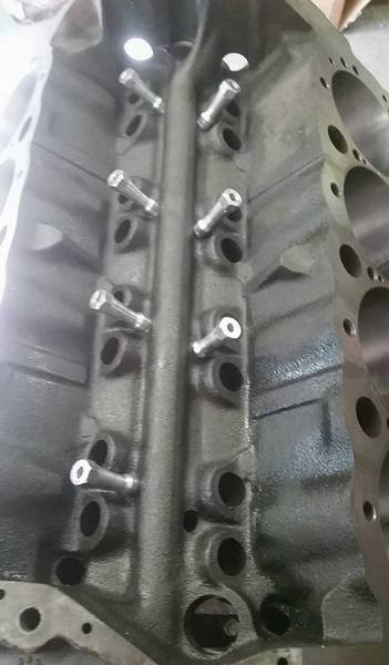

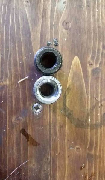

Even porting and chamfering oil adapters...haha.

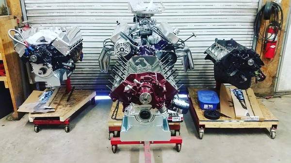

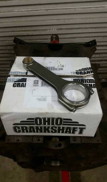

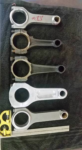

And I thought the rod comparison for a couple different builds in the shop right now was interesting:
1) Chevy 421 6.000"
2) 351W 5.956"
3) Stock 429/460 6.605"
4) Aluminum 6.800"
5) Aluminum 7.100"

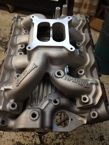

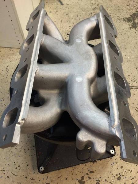

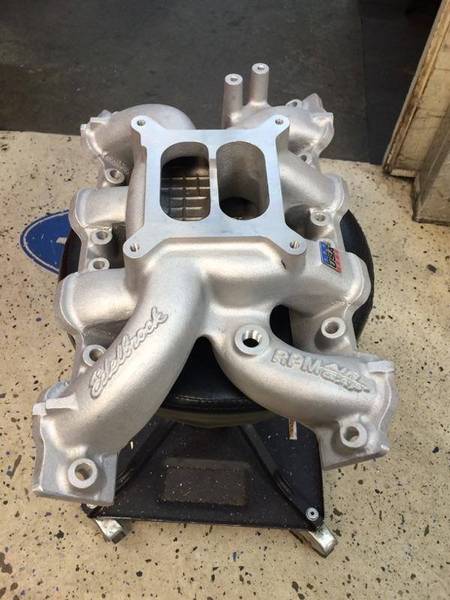

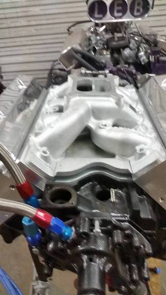

Started hacking the bottom off on an RPM air gap to give a cleaner 'spider web' look, like a CHI intake, without the CHI Price tag:
Had to get rid of that ugly double stack look:
Much better:

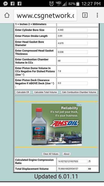

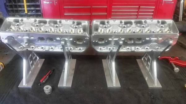

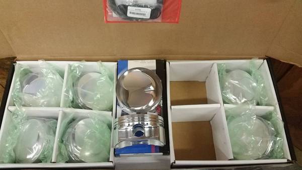

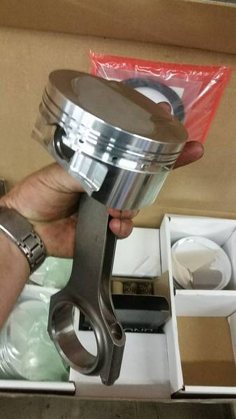

Another pull class build...should be the highest compression build to date:

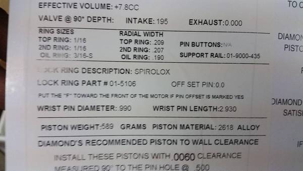

Custom Diamond pistons:
Mock up:
Quick math says 14.9:1-

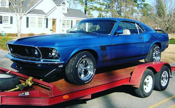

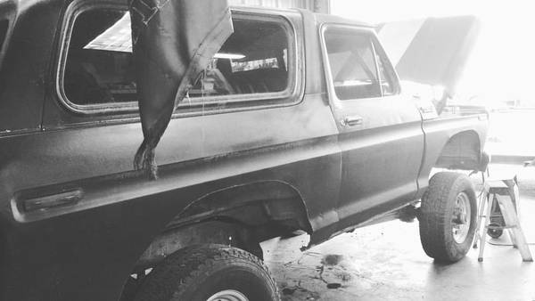

Anyway...fresh out of the North shop-B2, fresh sheet metal, paint and glass/tint:

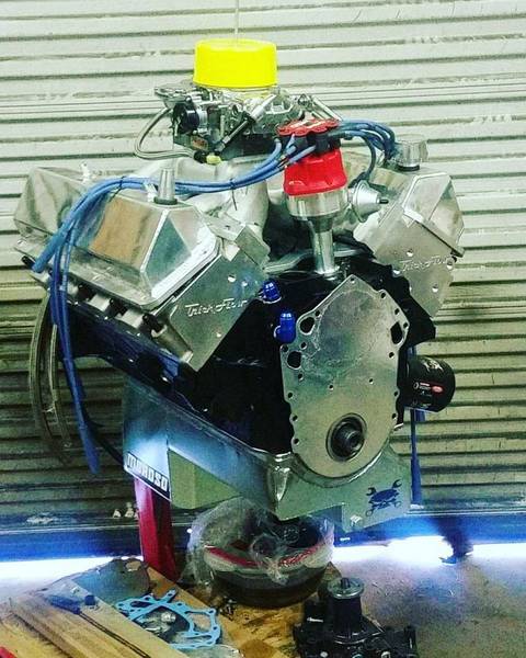

400 almost buttoned up and ready for the run stand. Desktop Dyno estimates are putting this thing in the 550hp range. Finally secured a dyno in the Wilson area (supposedly Robert Yates' brother in law):

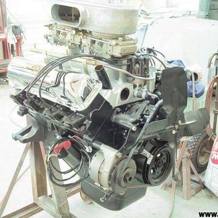

And last but not least, an FE build that Kris had a hand in building:
427 side oiler, 428SCJ crank, 12.5:1. Correct 64 high riser heads, Thunderbolt 2x4 intake, 660cfm carbs, NOS Thunderbolt air bonnet signed by Butch Leal (Thunderbolt #1 driver)
