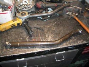

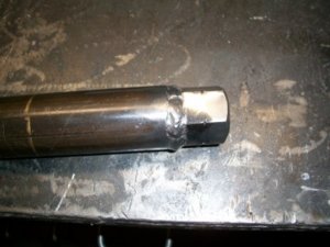

With the torch we heated up the .25 wall tubing for the trac bar and put two bends in the tube. Here it is cut to length with the threaded tube inserts.
One end welded up.

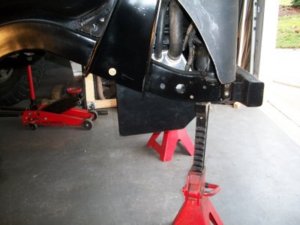

I also got the passenger fender tube bent and installed.

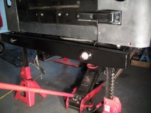

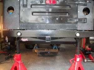

Cut the tire carrier off of the rear bumper and filled in the holes.
Here is the bumper painted and mounted. Also hooked up the LED backup lights.

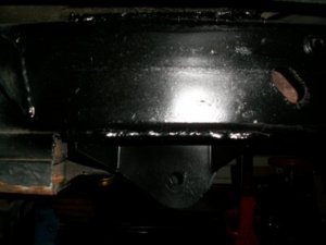

Burned in the rear frame control arm brackets.

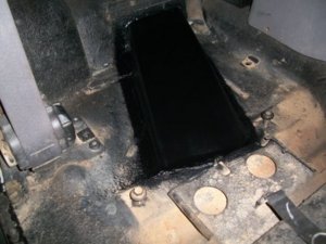

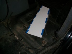

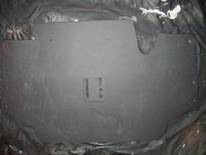

Worked on the filling in the holes in the rear floorboard.

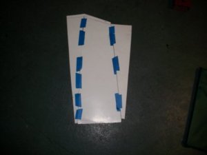

Here is the posterboard template in position.
Here is the template flat ready to be transferred to the flat stock of metal.

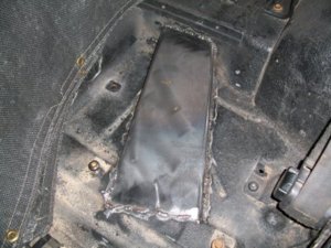

Here is the patch panel during welding.

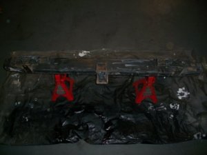

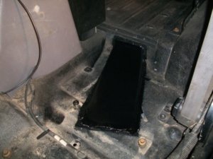

Driver Side- coated with spray on truck bed coating.
Passenger Side-

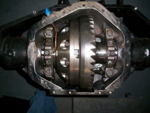

Last week, I dropped the 14 bolt off at East Coast Gear Supply. They installed the ARB the same day.

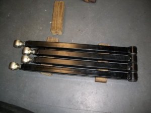

I burned in the threaded inserts in the rear arms and painted them.
What are you going to do for reverse lights if any? I need to figure out what to do on my bed.
If you look closely you will see my reverse lights in the rear bumper. They are white LED lights. I recessed them into the bumper and used a short piece of tubing welded around the outside for protection. They work great- very bright.

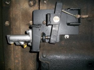

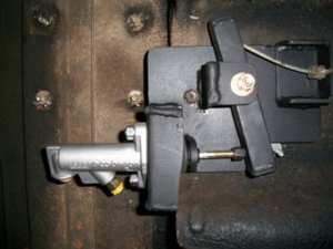

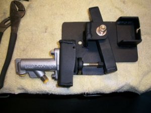

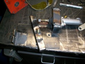

I built the rear parking brake bracket to use a Wildwood slave cylinder.
Beginning stages-
Further along-
Ready to be installed-
Installed in open position-
Closed position. The parking brake cable has a 1" throw. The slave cylinder has a 1.4" stroke. With the placement of the pivot point the movement of both match up great.

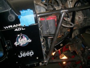

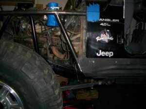

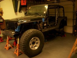

Today I worked on the front fenders.
Here is the support bar installed with the tire at full flex, full turn.
Passenger side-
Driver side with axle at ride height and rock rail cut to match.
Here is how the jeep will sit for a while.
