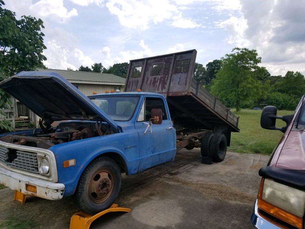

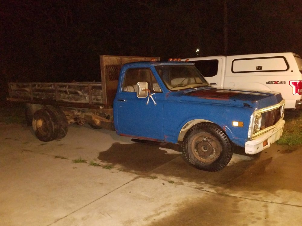

Big John: 1972 C30 2WD dually w/ 11' dump bed

Well, I got it running over the weekend!
Pulled all the plugs Saturday morning before going to a get together at the lake and added some Marvel's to the cylinders as well as what I could reach in the valve covers to let everything soak. Came back after lunch, pulled the plugs again and rotated the engine by hand ~10 times after checking all the fluids were there. Hooked up a battery and turned it over while checking for oil pressure (2/3 to 5/8 on the gauge). Emptied the boat fuel tank, added some new fuel, primed it and then got my dad to watch to make sure nothing leaked or went wrong. We put all the plugs & wires back on, poured some gas down the carb and turned the key. Took a few times (I flooded it once), but he finally came to life and proceeded to fog for mosquitoes for 10 minutes! Figured out the choke cable is broken, so dad was moving it under the hood. Once it would repeatedly crank/run, I decided to drive it around the property to have a little shakedown run. Went to shift into first & the clutch is stuck! Shut it off, cranked it in first & drove around the place 2-3 times with the clutch pedal in & bumping the throttle to try and break the clutch free. Finally called it quits so I could get cleaned up and make my birthday supper. When I pulled up next to the F250 and shut it down a puddle of coolant started pouring out. Couldn't see exactly where its coming from, but our bet is the radiator cap can't hold pressure any more.
Now I've got to try and convince grandpa to let me move the C30 into his hangar now that he sold his Cessna. That way I'd be able to get it out of the weather which would really help this weekend based on the forecast.

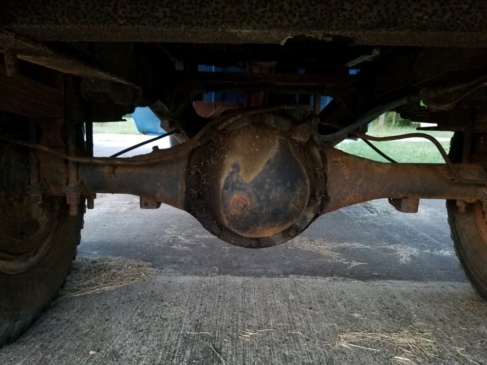

I also worked on/figured out some other stuff:

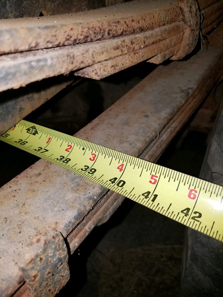

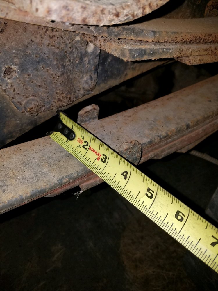

2.5" wide leaf springs, 40" on center
PTO hydraulic pump is not stuck, so that cable might be broken too?
Maximum size of under mount tool boxes is 40"Lx20"Tx20"D
Gear ratio is 4.56:1 (getting MPGs into the double digits just got harder!)

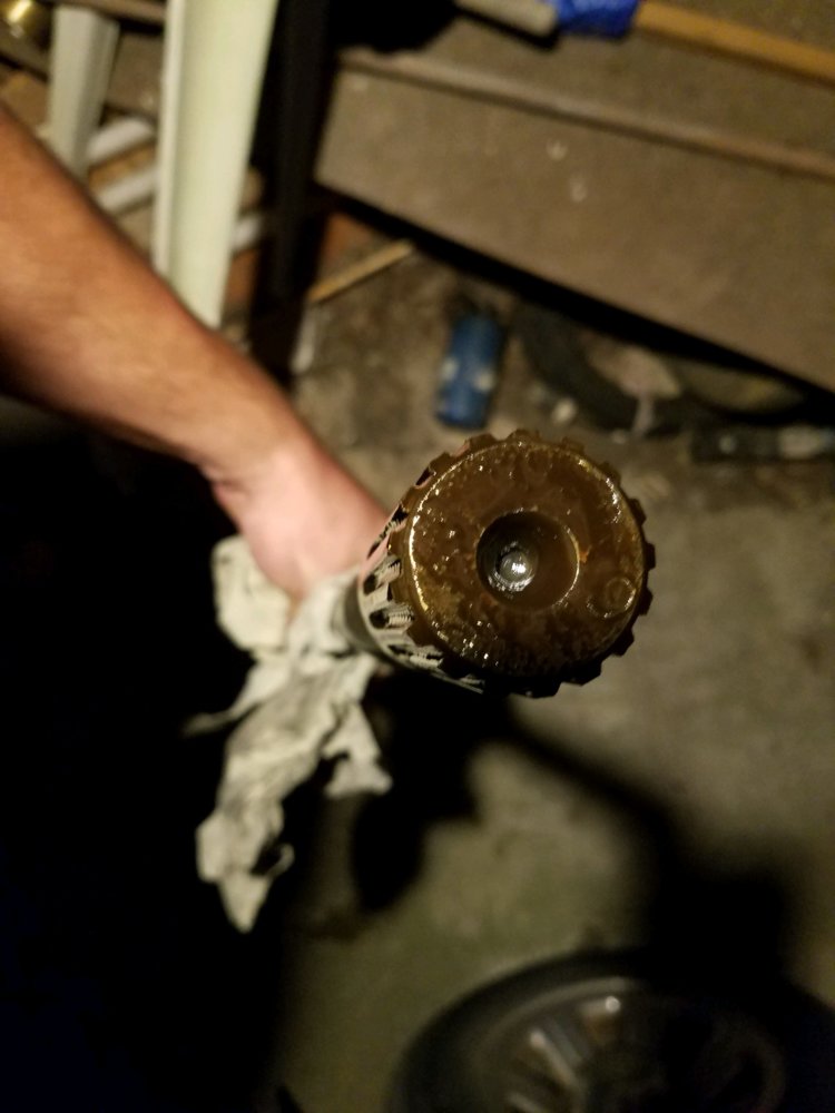

Axle shafts are 17 spline (@Croatan_Kid...we may need to talk if I don't swap rear ends)

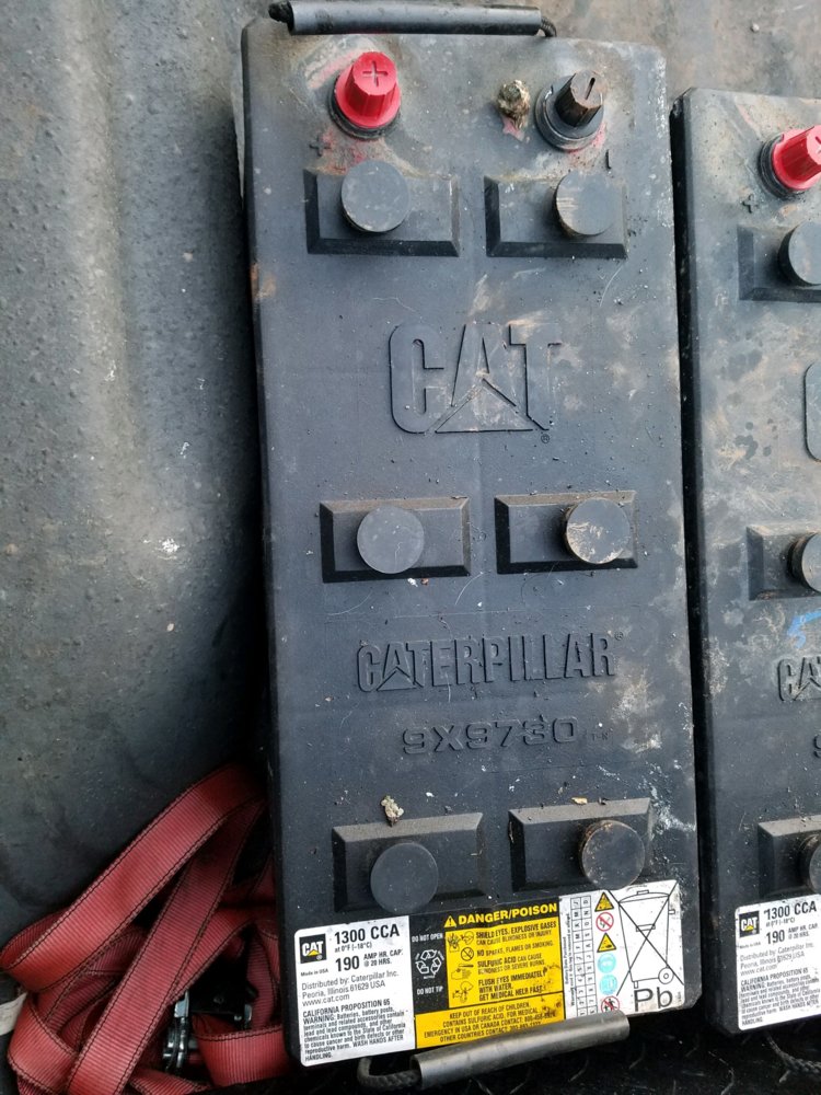

My F250 OEM battery will not fit the C30 (I use CAT 9X9730 batteries in my F250), so I may end up moving the battery or modifying the tray
20190602_210049.jpg 20190602_210134.jpg 20190602_211004.jpg 20190602_203646.jpg 20190602_203630.jpg
Yup, that is the good ole' HO72 rear!
I am pretty sure there was a NP540 transmission that should bolt up to a sbc bellhousing. They have overdrive and non-overdrive versions. They are not readily available, but neither are 4.10 eaton gear sets. I think the OD version would give you the best of both worlds, 6.05 first gear and a 0.82 OD. Between an OD and FI, you should be into 12v cummins MPG in no time!

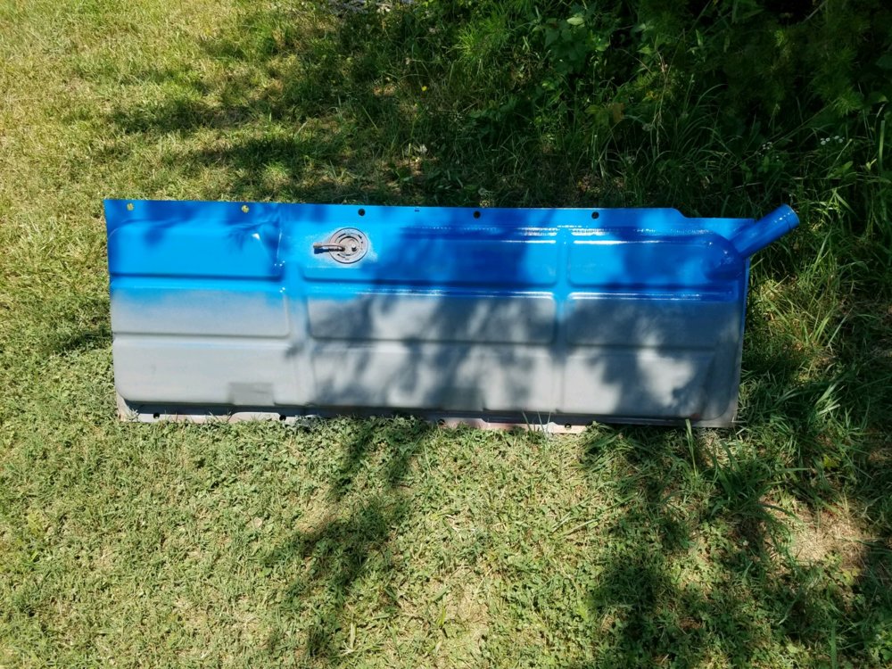

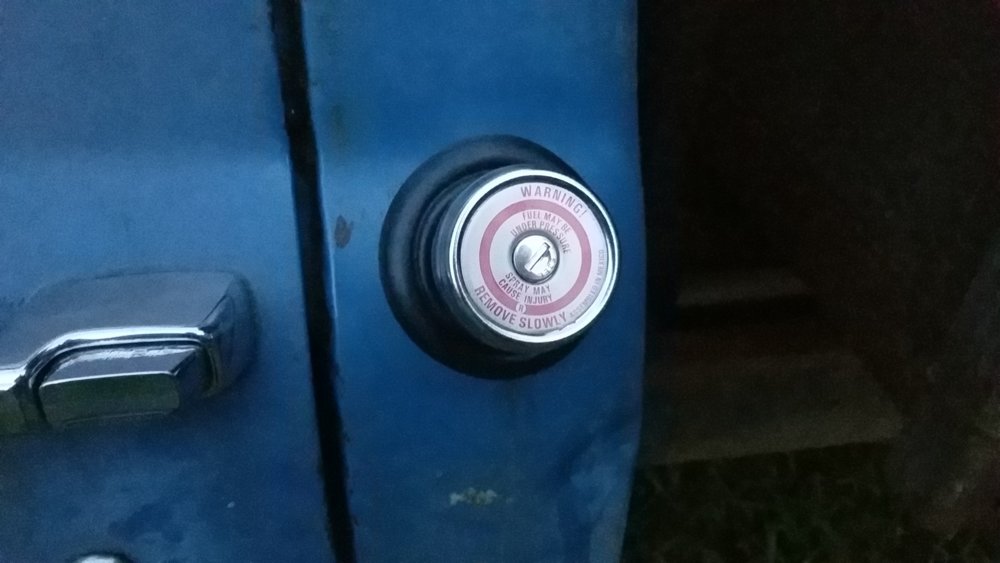

I also picked up a '67 C10 fuel tank at myrtle beach last week so I cleaned it up, primed it & painted the top portion in case anyone glimpses it and to test how close the colors are. Planning on sealing the inside before bolting it in place & hooking up the fuel line.

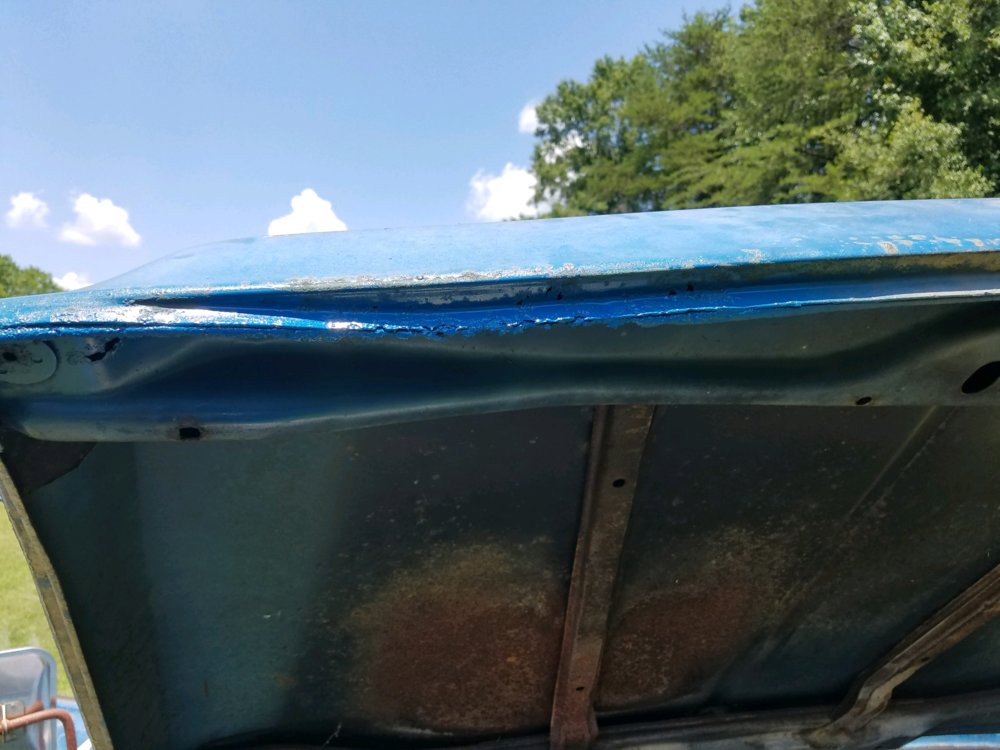

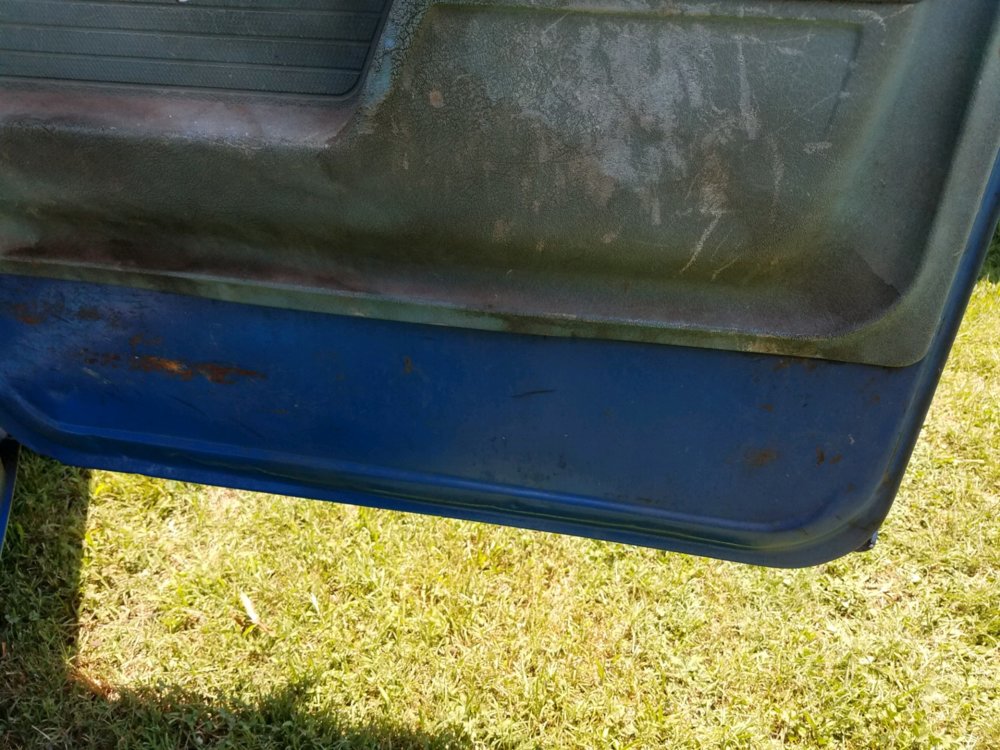

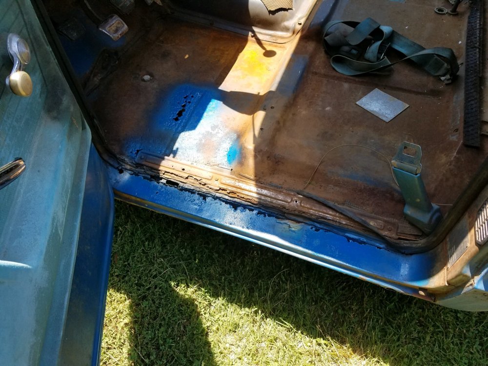

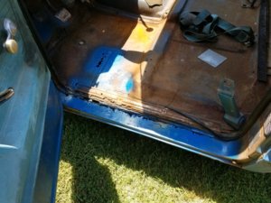

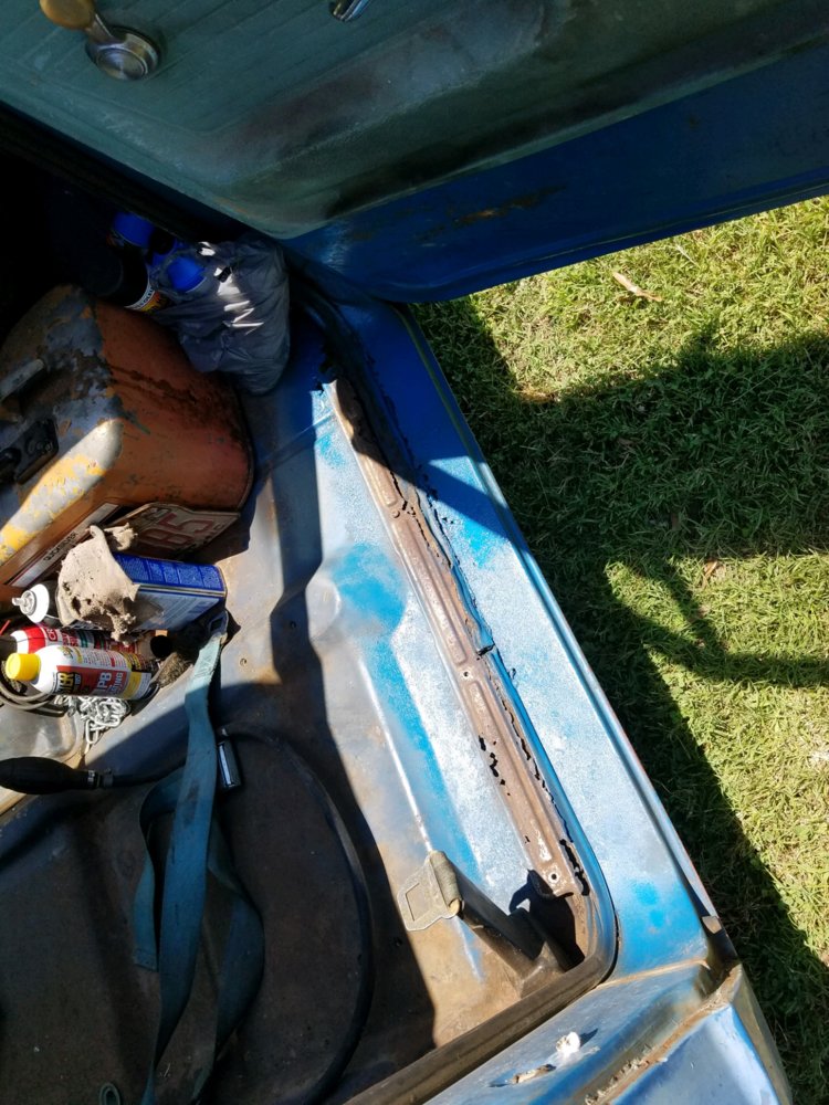

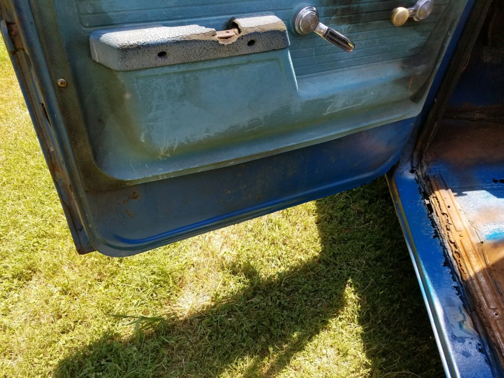

I also knocked down lots of major rust spots in the inner doors, rocker panels, floor and under the hood. Wiped down with acetone, primed & painted them...blue is a lot better color than rust! Planning on painting the floors with truck bed liner/undercoating, this was just to keep the rust from getting worse.
20190630_135501.jpg 20190630_135457.jpg 20190630_135518.jpg 20190630_135522.jpg 20190630_135511.jpg

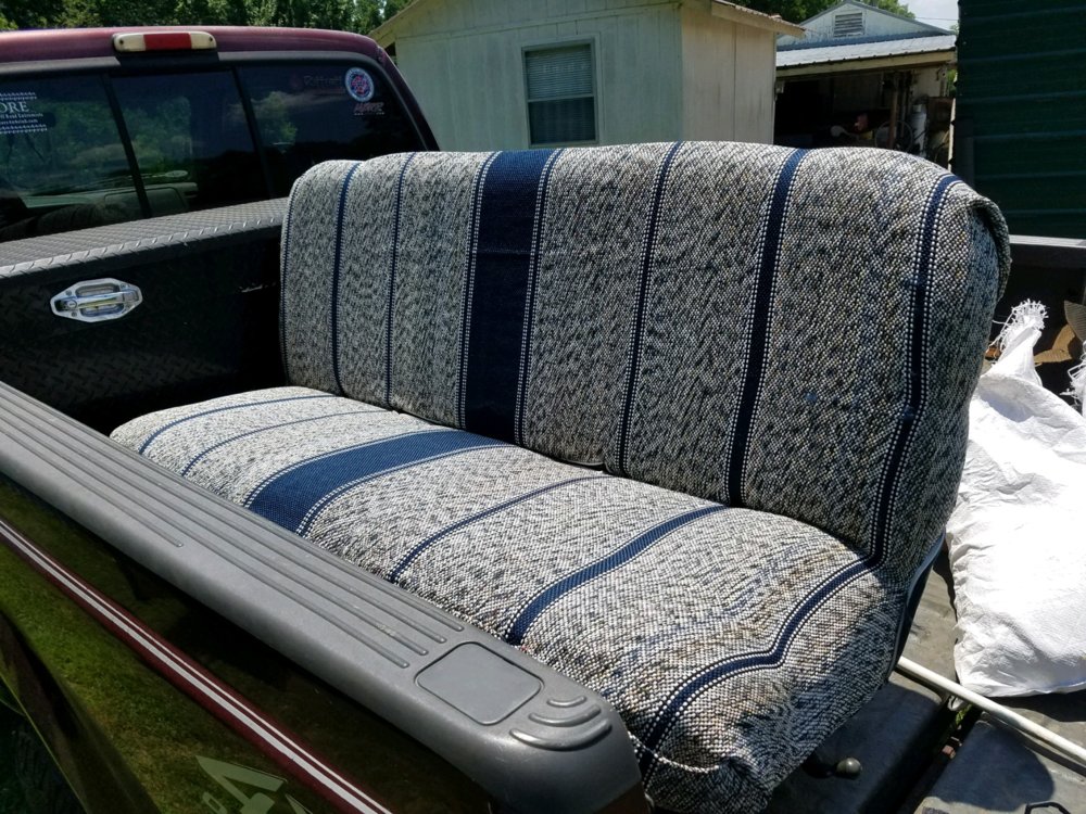

Also removed the bench seat, cleaned it up & put the universal seat cover on. I bought this one since they said it has pockets down the entire front (5-6"?) for phones/tools/snacks. In reality they're only 2-3" deep...bummer. Its missing some hardware that ties the two slide rails together. Wasn't planning on fixing that since I'm 6'6" I'd leave it all the way back, but if I ever need to remove the seat or access the fuel tank, sliding it forward would be much easier...one more thing added to the list I guess!

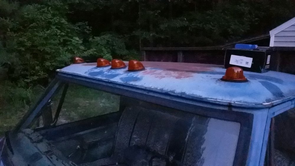

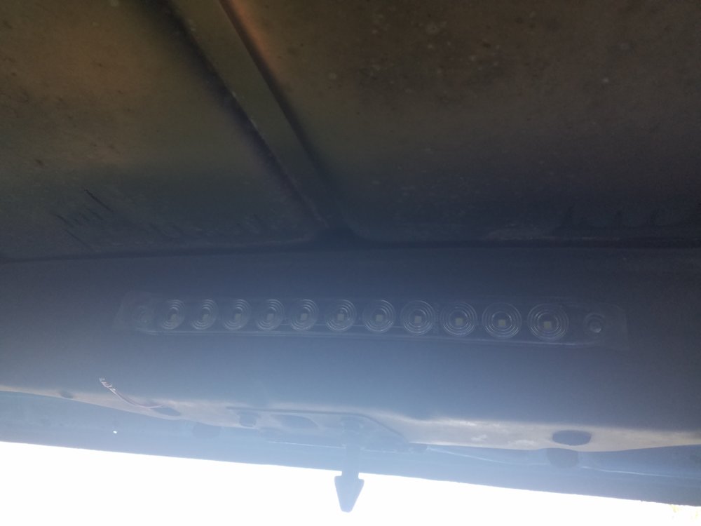

So I ordered several LEDs (tag, clearance, turn/rev/tail & side marker lights) & a back-up camera on amazon prime day...replaced the stock clearance lights & was laying out the side markers when it started getting dark. Decided to pull the C30 in front of the garage to get some light & I can't get it out of 1st gear & its not spinning over. Hoping the clutch is just stuck and its as easy to free as it was last time & that my jumper cables weren't making a good connection.

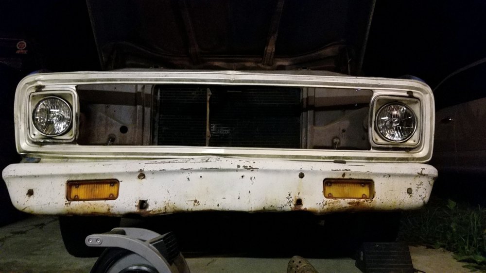

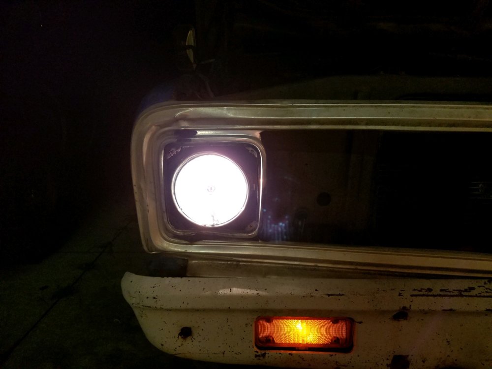

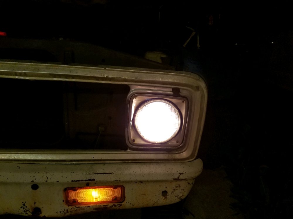

Pulled it over in front of the garage to pull sizes/part numbers off the belts/hoses & get some light on it. Swapped in the new H4 headlights & jacked the bumper up to try and get it back in place. Then decided to give it a wipe down since that's critical to getting it road worthy. Pics don't do the new lights any justice...
Halogen headlight:
H4 headlight:

Troubleshot/repaired the birds nest of wiring for the LED clearance lights and added dielectric grease to everything.

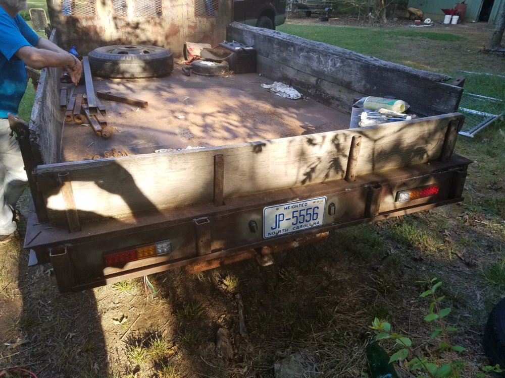

Started ripping out the lights/hardware/wiring for the old bed marker lights...rusted hardware & wire nuts suck!

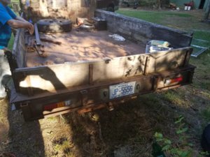

Decided to cut just over 6" from the vertical part of the bed & weld it to the rear for the tag & lights.

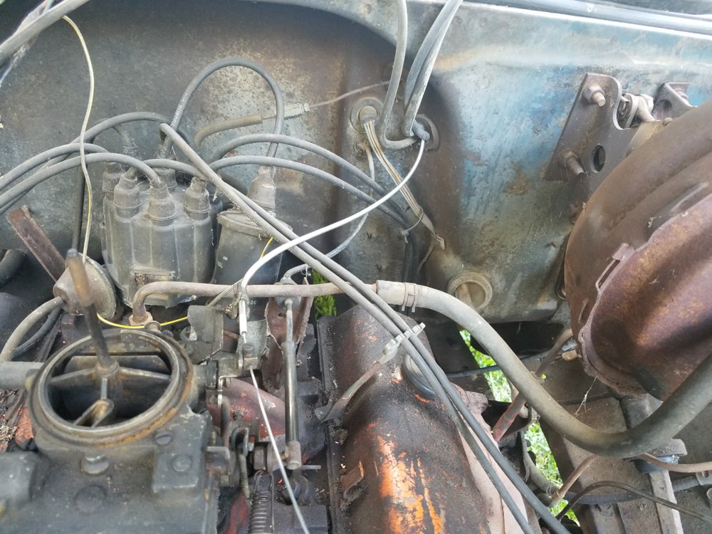

Adjusted the carb & installed new choke cable (needs a return spring):

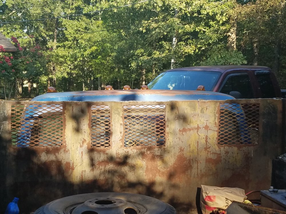

Cut the headache rack down to use as a rear 'bumper' (plasma cutter started acting funny & then gave up the ghost, I'll have to trim/straighten it with a grinder):
Tail/tag lights (tag light screws hit on a piece of angle, gonna raise them ~1/2"):

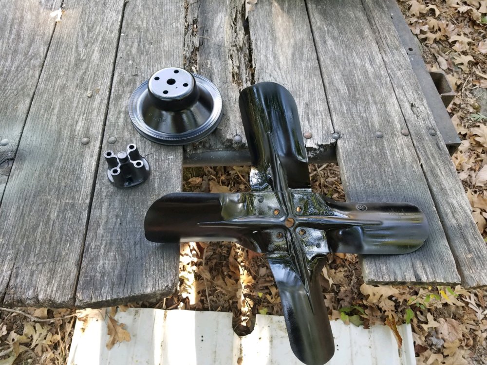

New water pump, hoses, thermostat & gaskets tonight. Figured while I was at it I'd treat the pulley, spacer & fan to a fresh coat of paint...makes the old block look even older! Also put some JB weld on the fan shroud since it was cracked, got rid of some rust under the radiator and primed/painted the good metal to keep it that way.
