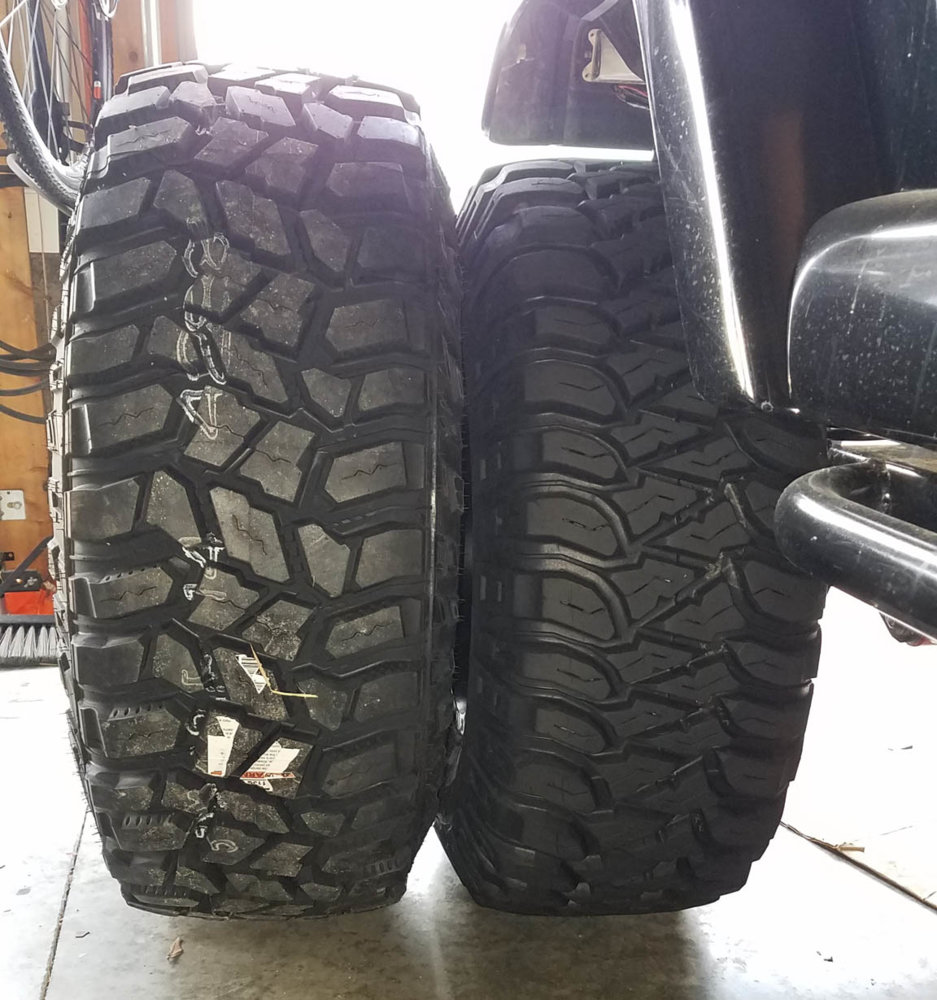

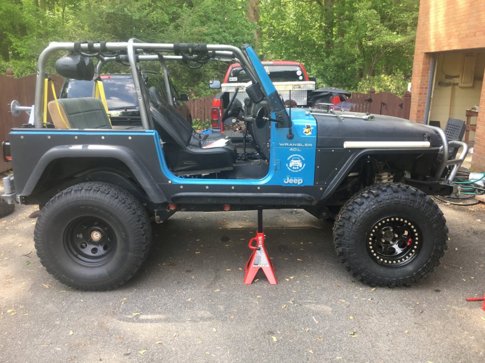

After mounting the 35" SX2s and getting them on the jeep, I have decided I need to do one of two things:
1) I need to go to 37" tires
2) i need shorter spring
Haha, these tires look small with the new fenders
What springs are you running?
Sent from my SAMSUNG-SM-G890A using Tapatalk
I honestly dont know, theu were on there when i bought the jeep. I am thinking they are 4", and I have out a 1" body lift on so I want to go down to 3" springs
I didn't think yours was that tall. Mine has that same tiny tire look with the metalcloak's.
They may be 3" springs but the 35s look so small with the new fenders. Are those metal cloak's high line?
It's basically flush with the bottom of the hood. Not a hi-line by definition but fairly close.

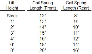

TJ coil spring lengths:
Sounds like you need to order yourself some 2.5" Rough Country springs.
I would wait to lower that thing. You may want to reserve all of the wheel well space. Rubbing/slicing tires fawking sucks.

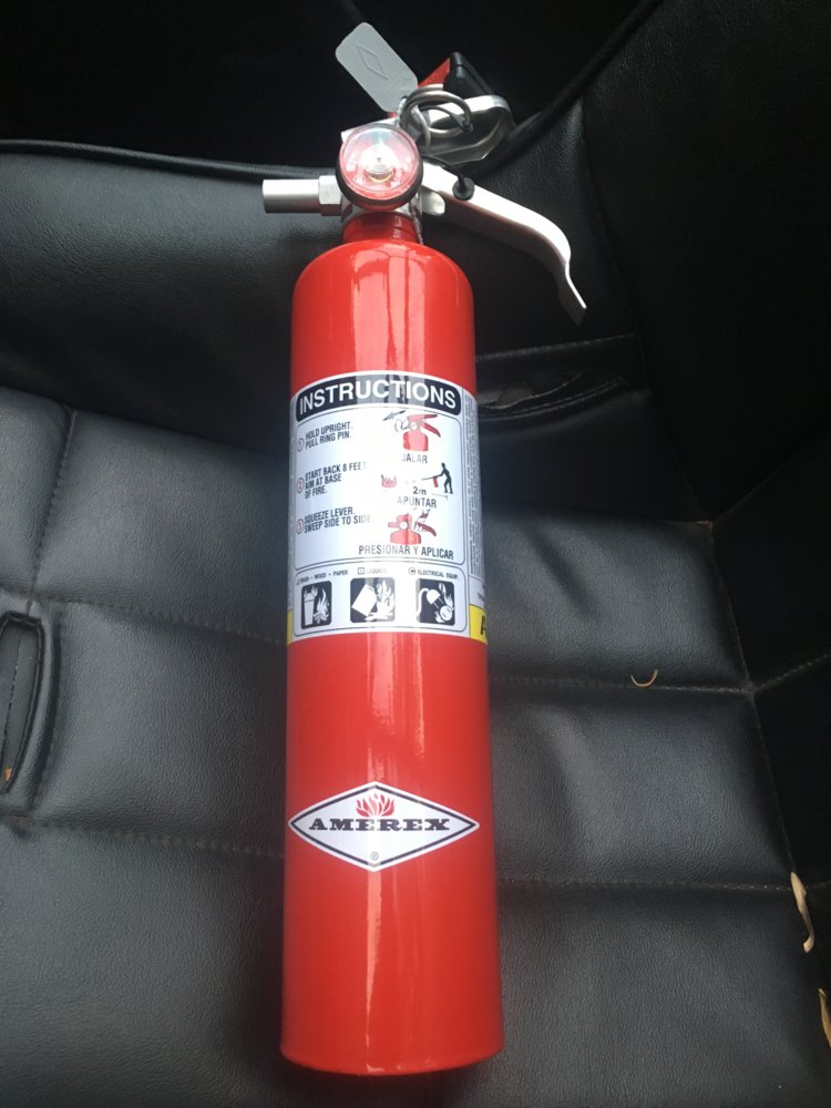

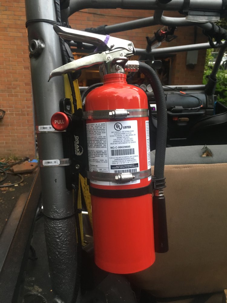

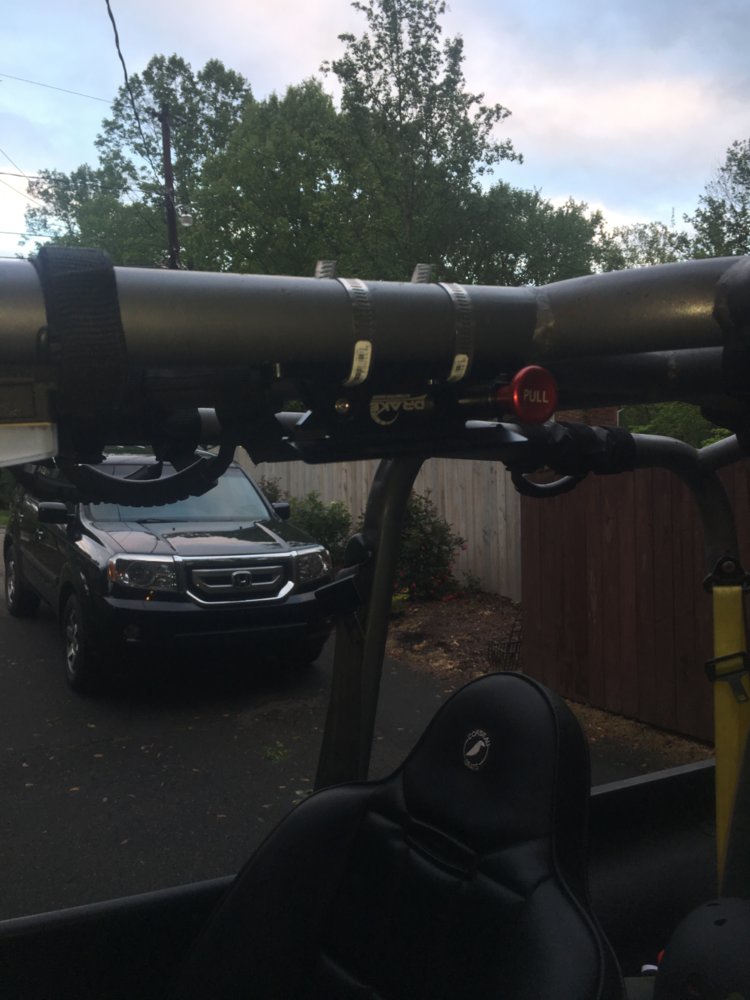

After recommendations from a few of you on here, picked up a 2.5lb and 5lb Amerex fire extinguisher for the jeep. 5lb mounted in the back and 2.5lb will be between driver and oassenger on the roof cage.

What's the actual height with the weight of the vehicle on them?

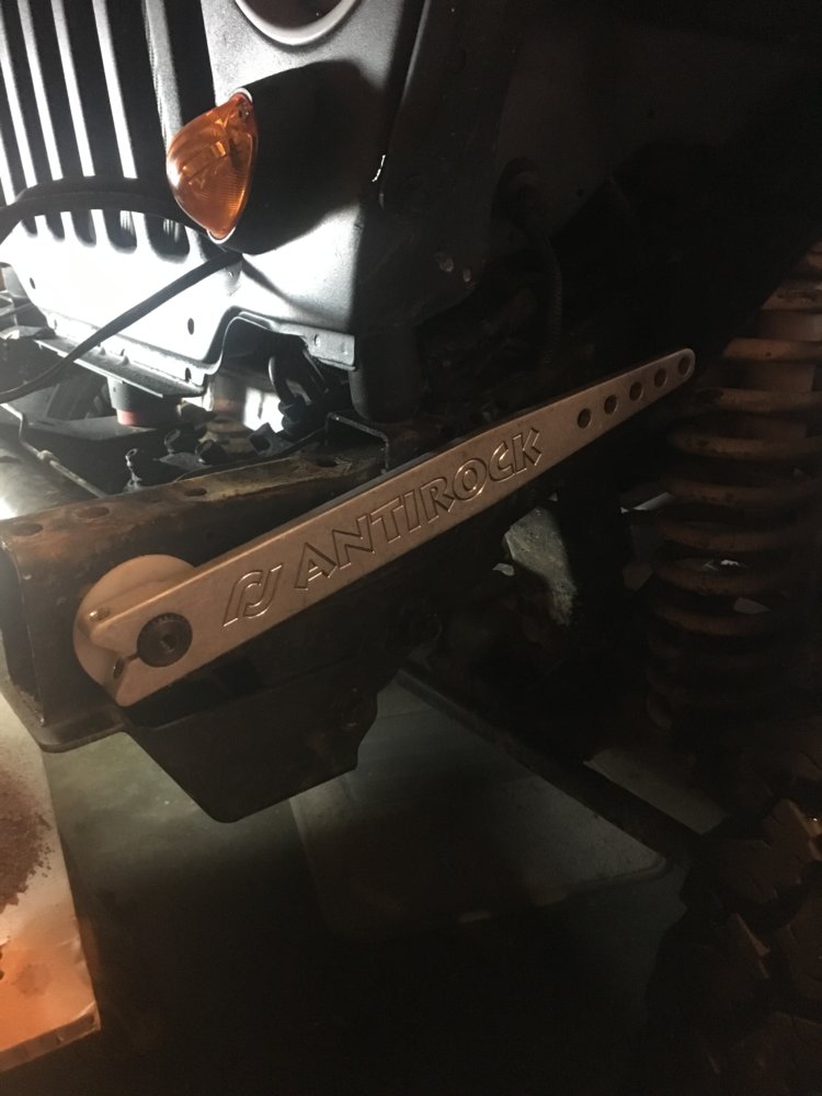

Small upgrade to the old girl

Great meeting you this evening, hope she works out well for you. Look forward to watching this thing crawl sometime in the future.
