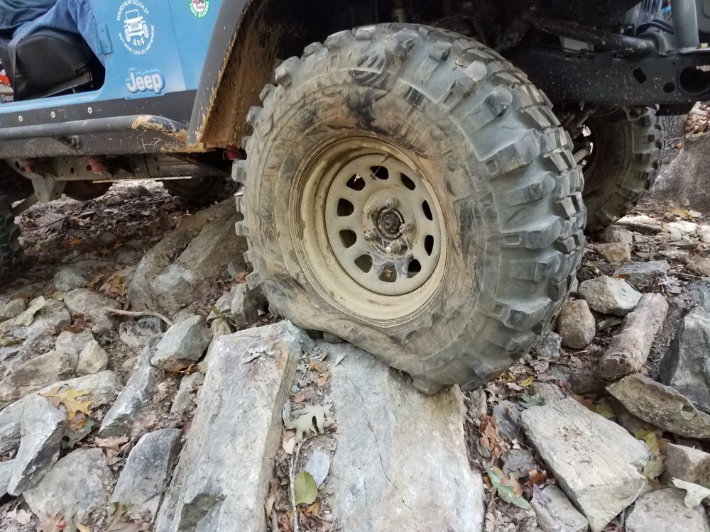

J/K man....that's awesome! Now you can run 8psi without fear of burping!
LOL! I actually bought a buy 3 get one free gift certificate off a guy on here, so in the end I ended up saving about $180 on the set, that was the main reason I decided to pull the trigger.
Thanks, I think that picture was right before we realized it had burped

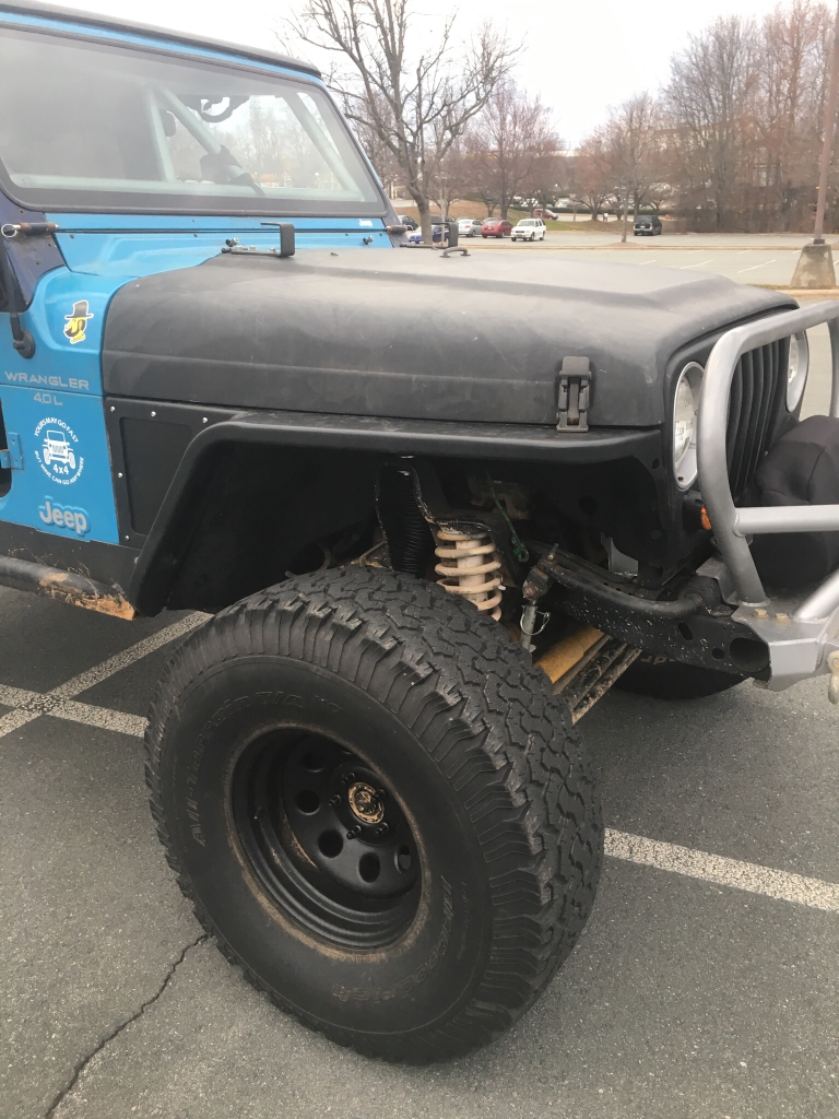

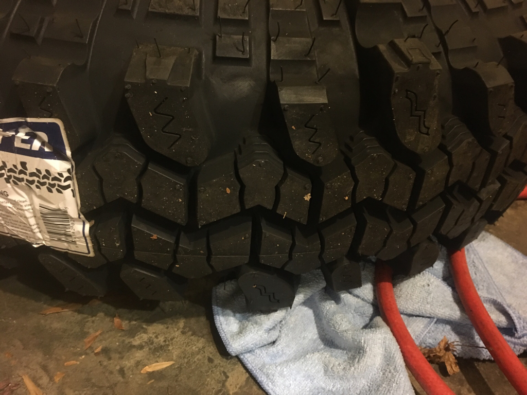

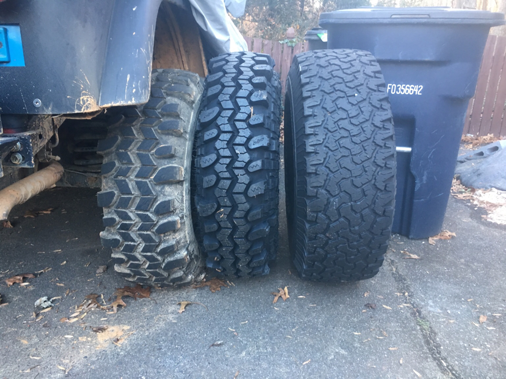

The jeep will be getting new shoes! 35x10 TSL SX IIs on 15x8 Allied steel bead locks
Three sets if tires: 33x12.5 TSL Bias, 35x10 TSL SX II, 35x12.5 BFG A/T. Granted the 33s are feeling the weight of the Jeep and the BFGs are at 30psi. Cant wait to get the SXIIs on the jeep and see how they do!

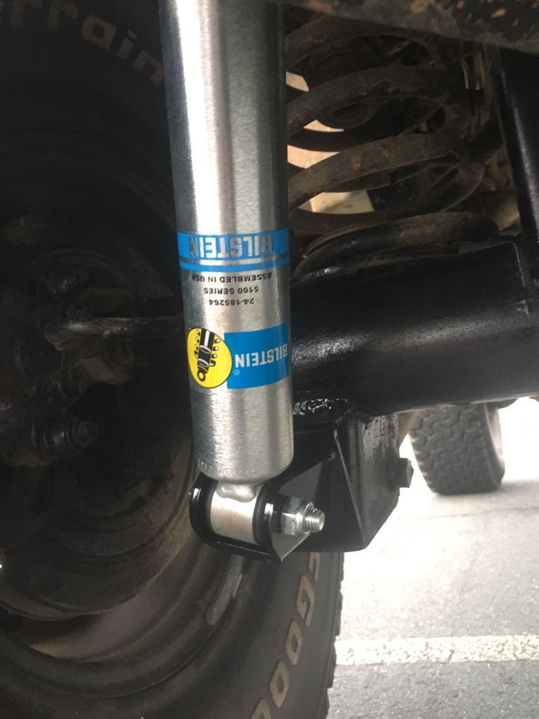

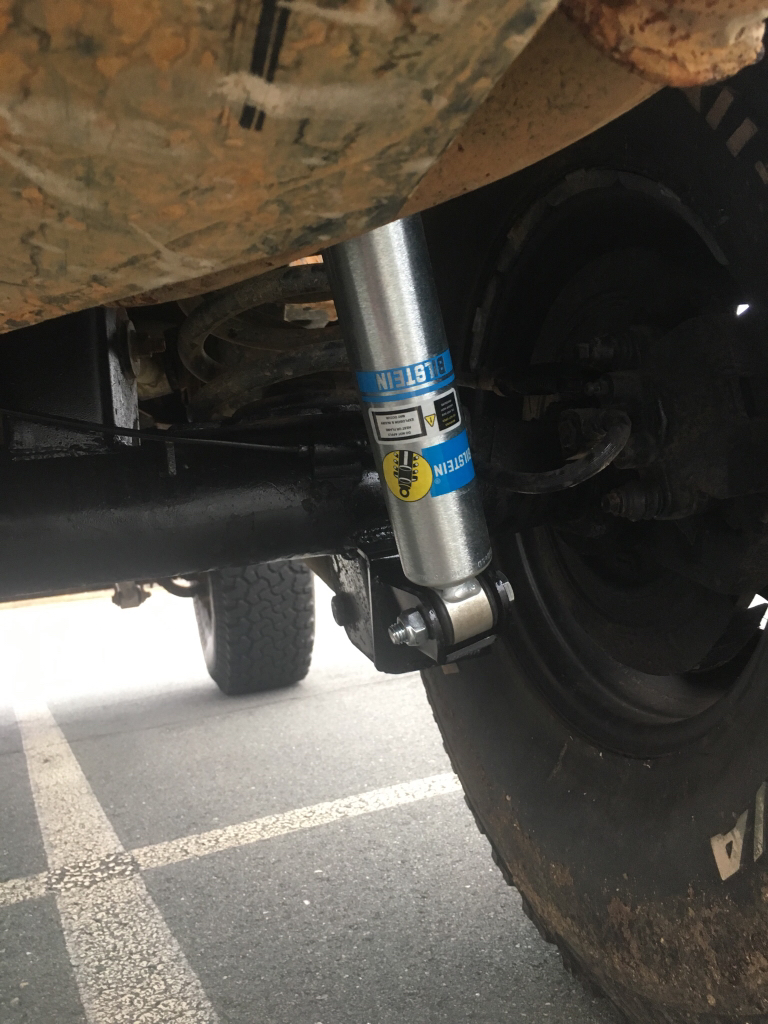

Also new shocks, wow, didn't know how busted the others were. Also relocated the lower shock mounts behind the control arms so hopefully I won't rip these off now.

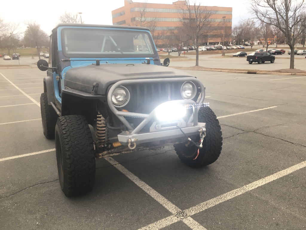

And let there be light!
Why did you mount them body-side down?
That is the same way I had the old ones on there, and that is the way the mounts came. Is there a difference in the way they perform based on orientation?
When you back into something and dent the can, they don't go in and out anymore.
They're monotube and have eyelets on both ends, so it shouldn't matter from a performance perspective. But they're more durable mounted the other way around.
Ahh, didn't think about that
What made you change to a 10" tire?
I had clearance to fit a 35" tire vertically, but even the 33" by 12.5" tires were rubbing the control arms, so it made sense to me to go skinnier. I also did some research and a smaller contact pattern actually gives you better grip in the rocks.
That and i got a killer deal on these tires haha
I'd flip the rear shocks, when they're body side down the shaft seal is more easily damaged from mud and dirt and shit.
Sent from my SAMSUNG-SM-G890A using Tapatalk
Yeah, I am gonna flip them before the next trail ride for sure.
