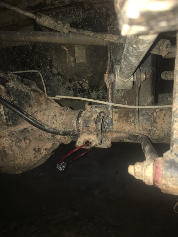

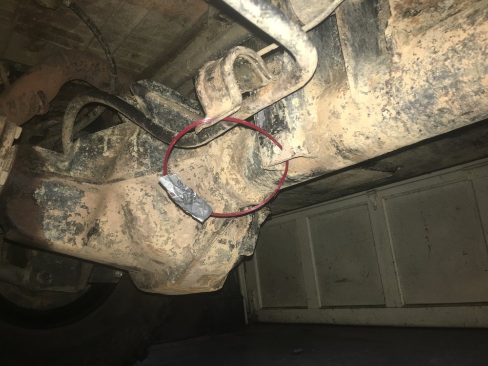

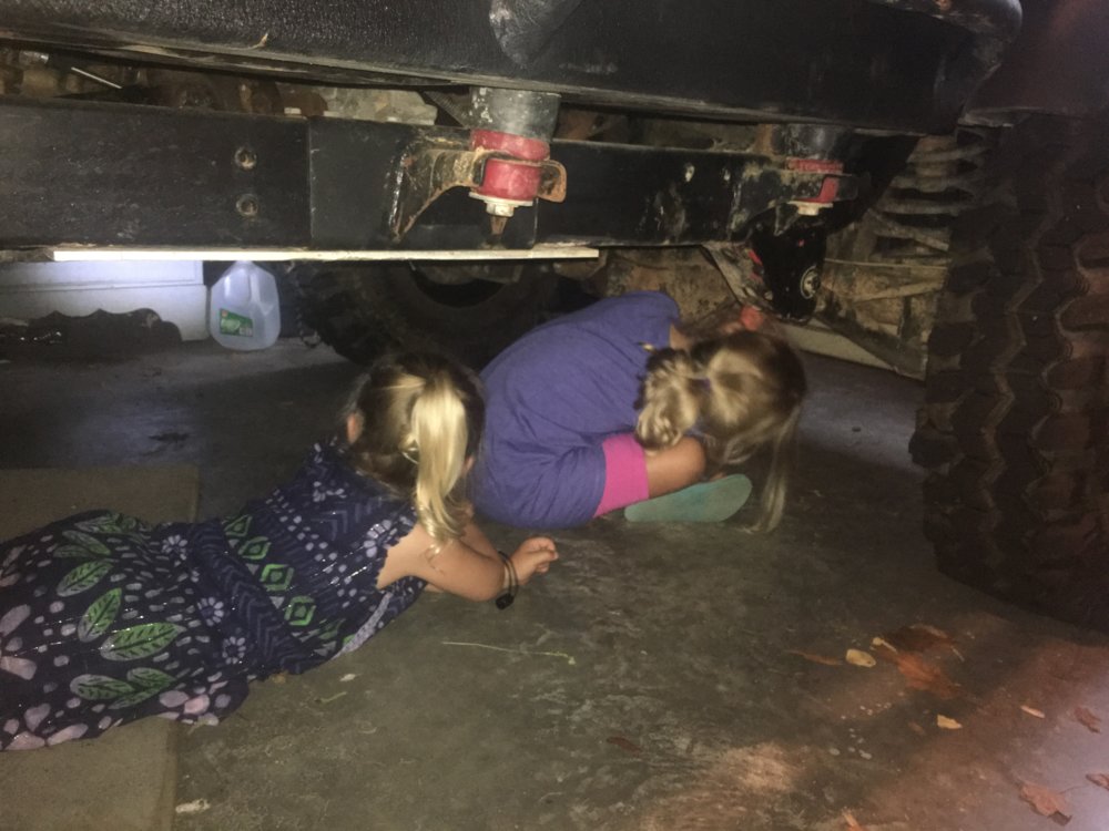

Parenting win (or maybe fail?). I broke one of the rear sway bar axle side mounts. I am under there surveying the situation. My six and three year old decide they can fix it. Weed eater string and ductape for the win!!

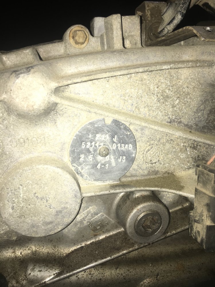

So this little goodie is now resting comfortably in the jeep
Yep, a little 241 4:1 Rubicon transfer case with a Novak cable shifter.
Went from a 50.838 crawl ratio to 74.762

How much of a PITA was it to get it to fit?
What all needed to be done?
It really wasn't that bad from what Dave said, a BFH in some areas, mainly because the flat belly I am running. I got new yokes from ECGS to retain the same U-joints, and the stock shafts were still the right length! The Novak cable shifter had to be persuaded a little to get it to stay in 4 low
