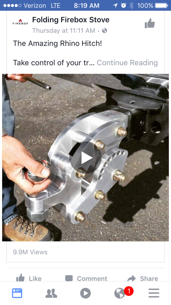

I had to go look this up out of curiosity.View attachment 246778 Coming soon to a brodozer near you! The hitch that will break if you actually use it, but makes you look like a hardcore hauler.
Worst idea ever
You know I would actually pay good money for the entertainment that would ensue if @Fabrik8 would go to youtube and start analyzing this product in the comments.
Someone in the comments suggested the pin should be titanium so it wouldnt shear. Im sure it would play great with that aluminum body.

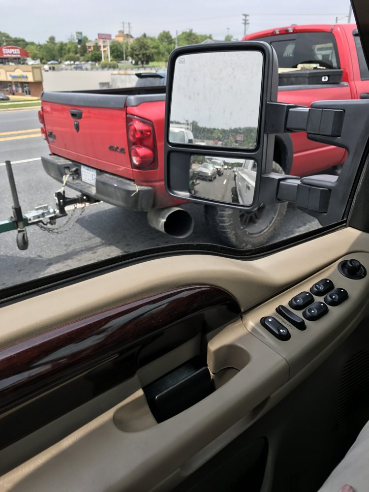

View attachment 246934 Douche was strong in bristol, va last week!

Yes, making the pin out of a weaker material that is magnitudes more expensive seems like a great idea. Good job internet!Someone in the comments suggested the pin should be titanium so it wouldnt shear. Im sure it would play great with that aluminum body.

Uhhh.... Hmm. I don't comment on YouTube, but that thing has me scratching my head.
Could be perfectly fine, who knows. The 2.5" model is rated for 14kip, so should be fine. Hope they did a lot of FEA.
- So all of the force (in any direction) is supported by at most two of those bolts in shear, and only if the load is distributed perfectly between them.
- I hope there are sleeves on those bolts to act as pivots and set bolt tension, and to increase the bearing area on the aluminum pieces.
- I hope the bolts don't have threads in the shear area.
- I don't see any kind of sleeve on those shear pin holes, which doesn't make me feel good. I guess there's no room to sleeve them though.
- Those shear pin holes are really closely spaced, and really close to the edge, both of which are not a good idea for high loads, but especially bad in soft materials.
- I'm not as concerned about the pin shearing as I am about the holes for the pin. The holes are about 1.5 diameter apart, which doesn't leave a lot of material left for wear/deformation/sectional area. Any rotational slop and those holes are getting beat to shit with cyclic loading.
- The pin is about the same size as the receiver pin, so that shouldn't be a problem.
- I don't like the length of the parallel linkage versus the length of the pivot to shear pin. That's not a good torque ratio, which loads the shear pin at whatever that ratio is.
- The load on the shear pin completely depends on what position it is in, as the hitch position changes the amount of torque about that pivot from tongue load vs pull load. Highest for pull weight when the hitch is at its highest/lowest points of adjustment. This goes back to damaging the shear pin holes, and not so much for failing the shear pin.
Interestingly, the Anderson Rapid Hitch is rated to 10kip, limited by ball capacity. That's a conspicuously omitted fact on Rhino's page.
I just don't see the need for this much complexity over something simple and adjustable like the Anderson or a Weigh Safe, etc.
