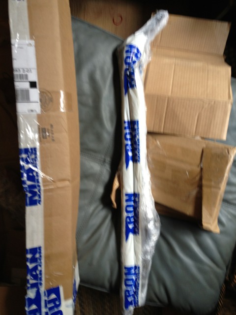

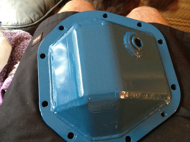

Got a sweet box of parts today from Ironman4x4fab!!! Yukon chromos and Yukon super joints and a ruff stuff diff cover powder coated ironman blue!

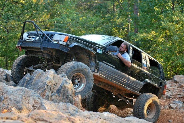

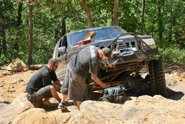

Met you this past sat at ure you got a nice rig and looks to be getting better. Thanks for taking some pics of John in the black 2dr xj climbing kodak, I was too busy spotting him to get any and it was deffinately a picture worthy time.

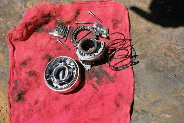

Went out this weekend with a few buddies and had a blast and broke another set of mile marker hubs. I switched over to warns so we shall see how they hold up.

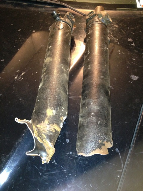

I got my new rear drive shaft yesterday and got it installed at about 8pm some buddies of mine called and wanted me to join them at uwharrie so I loaded up the jeep and headed out. We went to Kodak rock had fun for a bit while we waited on a few more to show up. After that I decided to do the hard line up Kodak before we kept going. That was a bad idea I came down on my brand new ds and broke it into 2 equal pieces. My brand new 4 hour old ds is now trash.

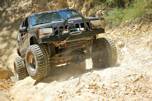

Damn that stinks, this pics look good though man. Maybe I can make it up there to ride with other ZJ guys soon.

Id be a little ticked about that. Time to step up the wall thickness.
For the record a .250 shaft was suggested and declined. A .250 wall shaft is really the only way to go when you know you have the possibility of coming in to contact with rocks wheeling.
Didn't have the funds at the time. Never once complained about y'all's products. The service has always been good.

No worries. Just didn't want folks to think otherwise.

The new ones are .188 wall Dom
