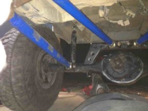

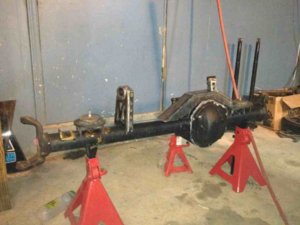

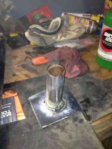

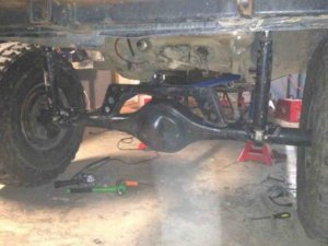

Did final assembly on the 9" tonight's and bolted it in!!! I'll be getting new grade 8 bolts for everything Monday so I just used the old stuff tonight. I have to make new upper coil buckets tomorrow then the rear springs can go in. I'm also going to be moving the upper shock mounts.

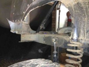

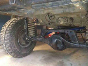

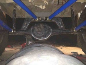

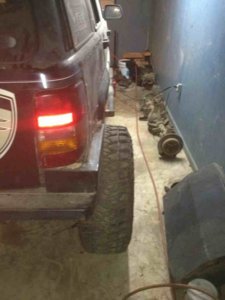

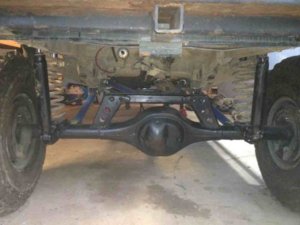

The rear is now under its own weight. I made my new upper coil buckets and then set in the coils.

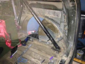

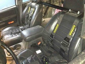

Didn't really get shit done this weekend but I picked up my hp44 from getting geared and hopefully I'll have it all installed this weekend. I started to install the 5 point harnesses tonight need to figure out lap belt mounts and anti sub mounts.

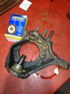

Sure are 79 f250 front and 9" rear

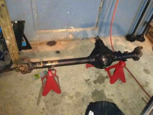

Getting the f250 knuckles freshened up and ready to go on. Hopefully have the front end done and on its own weight in about 2 weeks.

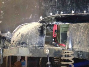

Comp cut started.

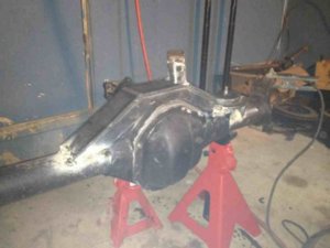

Tonight I finished up cleaning the tubes on the hp44 and began welding up the brackets!!! Won't be long now!!
