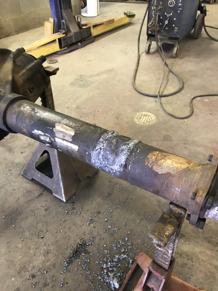

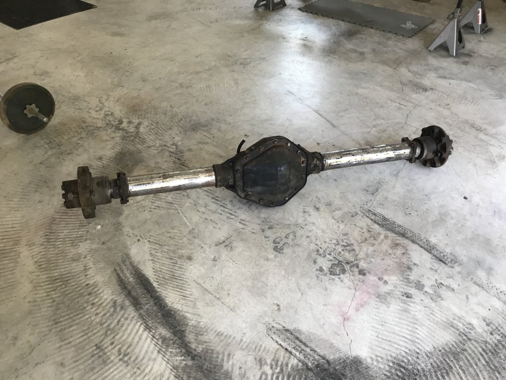

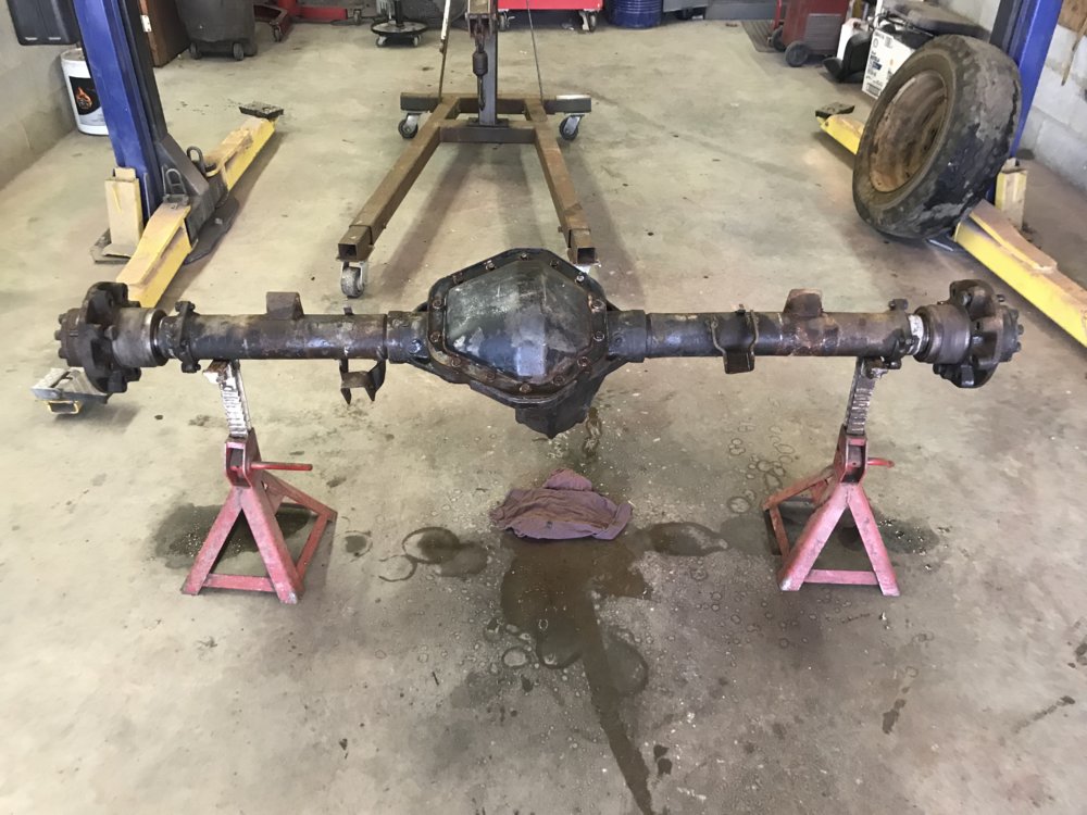

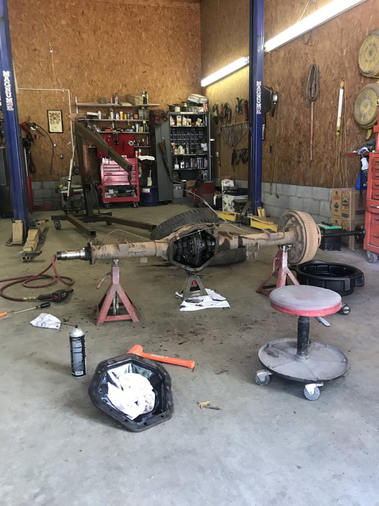

It’s been awhile since a build update.....let’s just say the drivetrain “plan”has changed!! Picked up a 14 bolt from Robbie this morning, got it to the shop and cleaned it up a little. Removed the drums and backing plate. I’ll be installing a disk brake conversion later. I’ll finish up cutting off brackets tomorrow. But now I have to take my oldest shoe shopping.....nothing like looking at shoes smelling like a rear end!!!:D:beer:

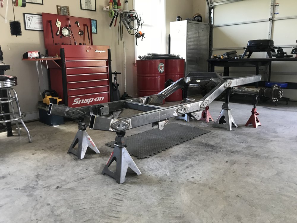

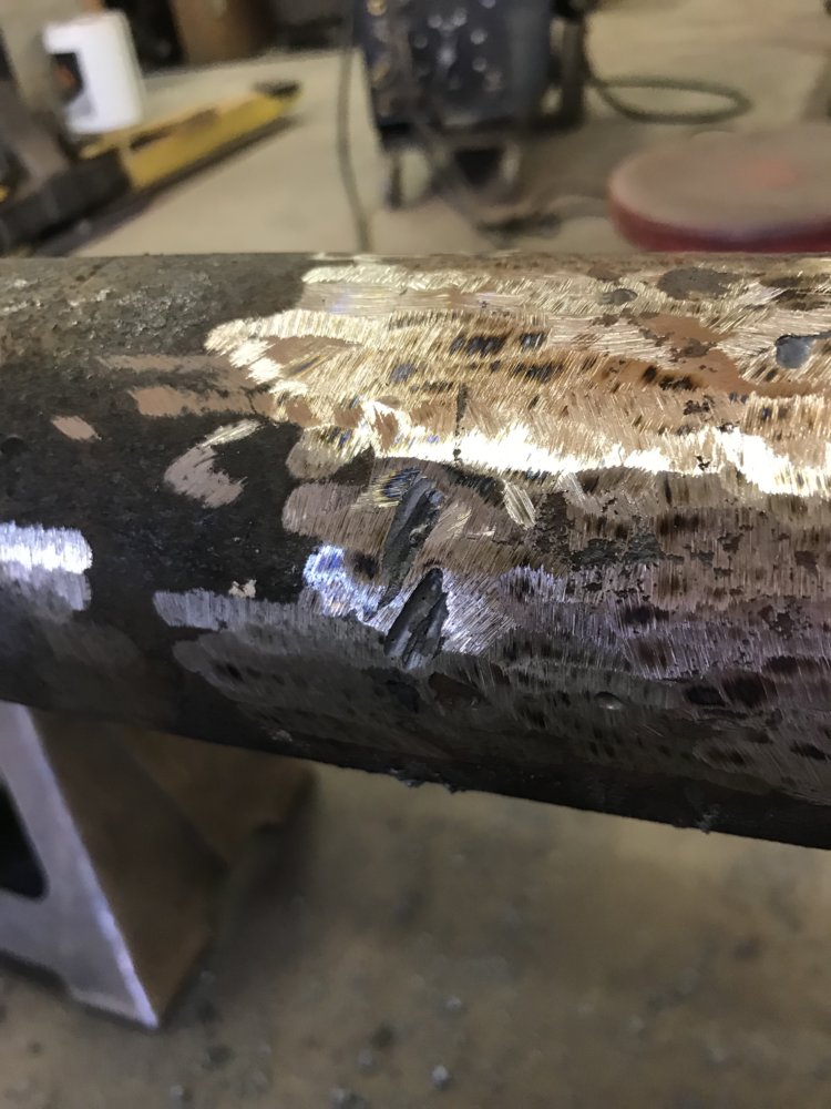

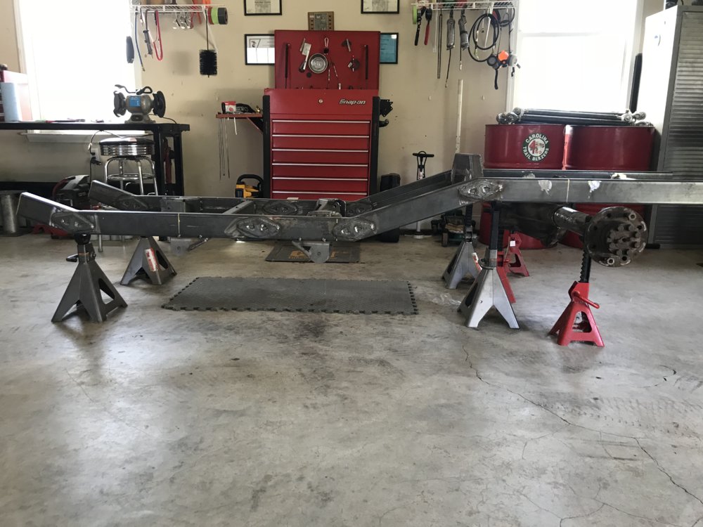

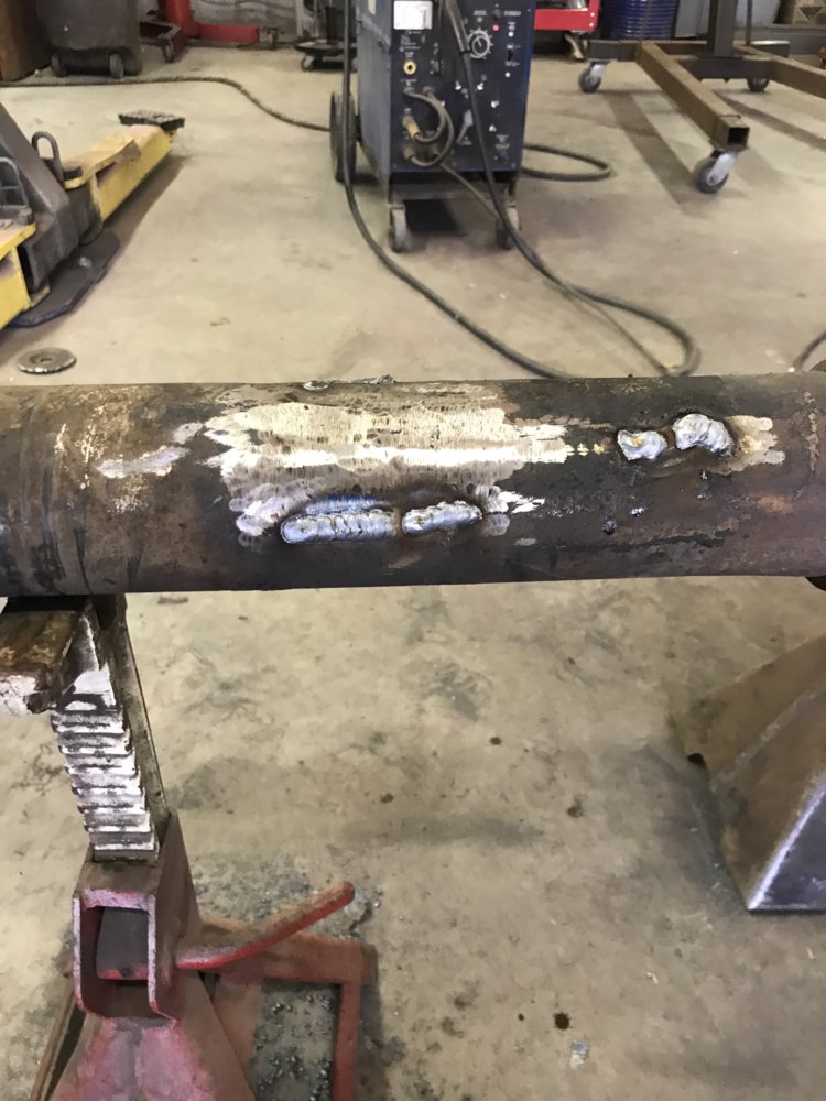

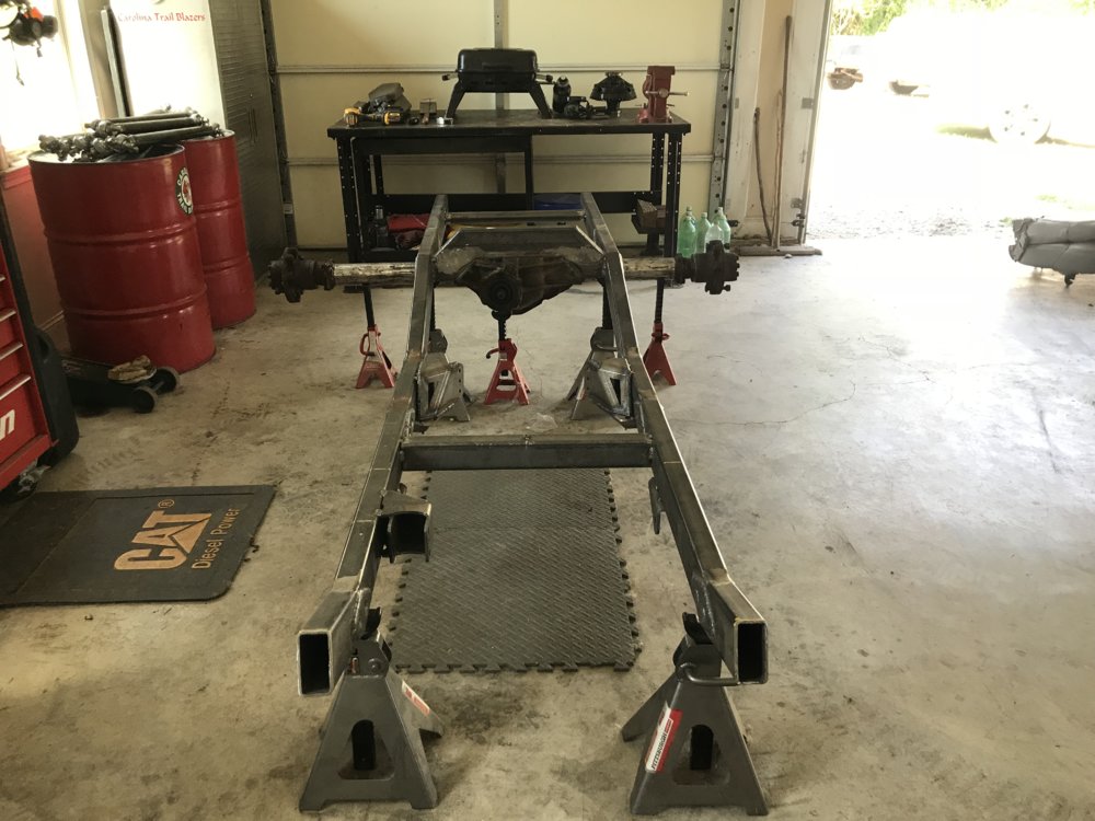

Well, version 2.0 is under way. The brackets are cut off the 14 bolt. Fixed the gouges I made with the torch. Cleaned it up a bit more. Removed the Toyota axles I had mocked up. Cut off brackets and front frame horns. I will have to widen the frame to 30” to accommodate the LS. I will have to make new front frame horns so I can move the axle forward 6 or 7”. To get a bit more clearance for up travel. Slid the 14 bolt under the frame for a visual. The middle section of frame is 14” off the ground in the pic and the axle center line is at 18”. I was told by someone that seems pretty smart to build it and make everything fit at full bump....seems like a good idea to me!! Thanks for the help @Jody Treadway !
