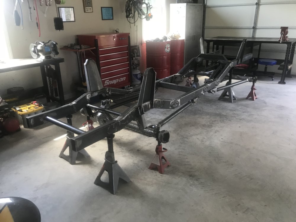

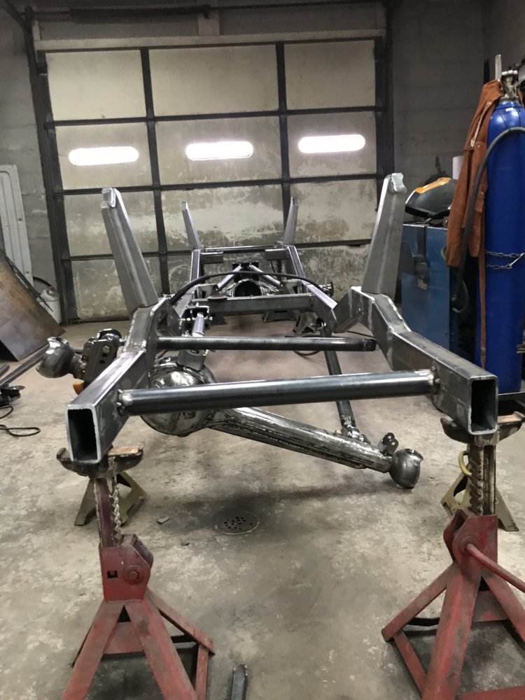

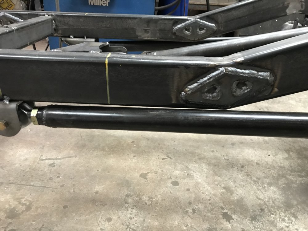

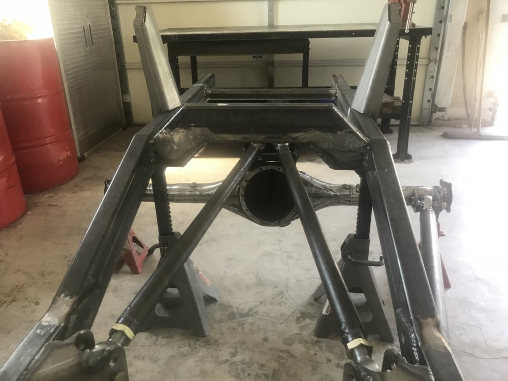

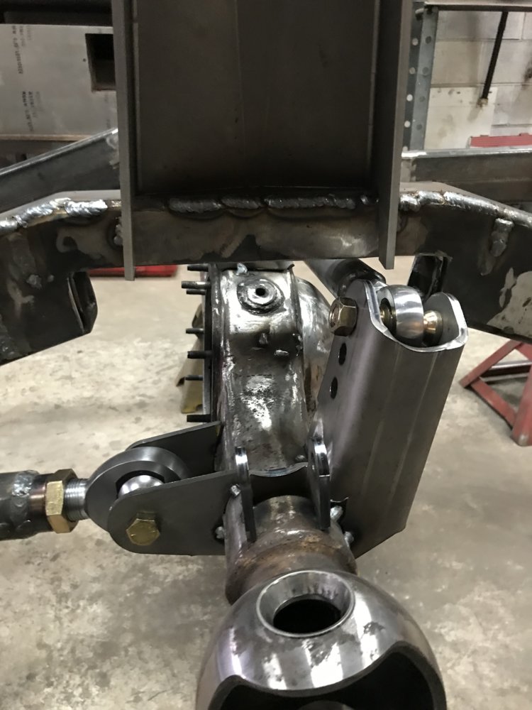

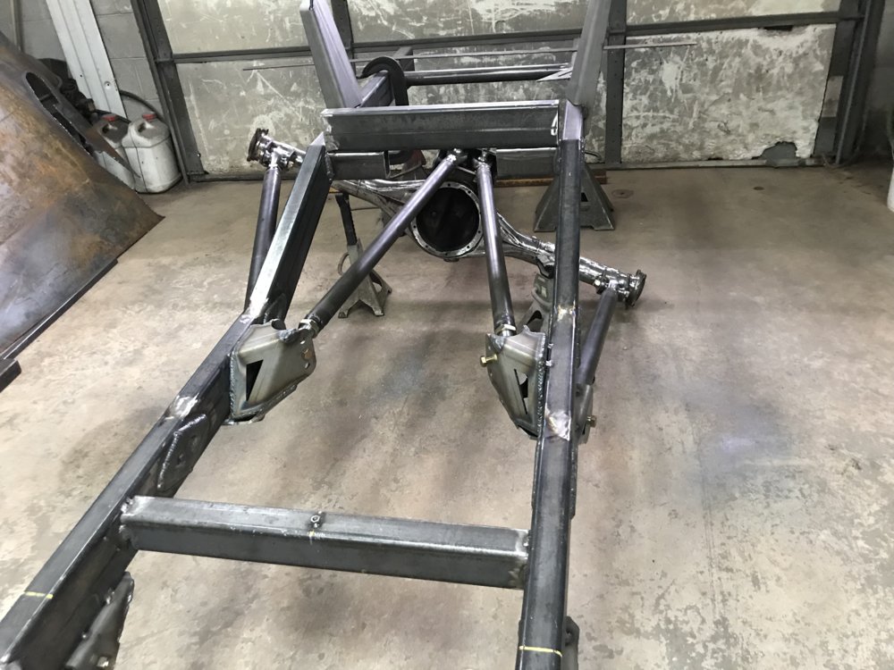

Finished up the frame, had to modify a crossmember for link clearance. I’m happy with the axle movement. Looks like I’ll have around 4-5 inches of uptravel and the rest droop. I plan to run 14” coilovers front and rear. The next stage will be building the drivetrain components. I’m not planning on starting this stage for a few months.
Wow!!!
Impressive!!!
