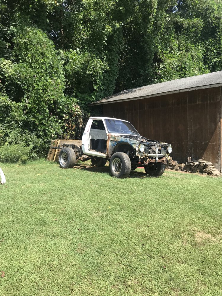

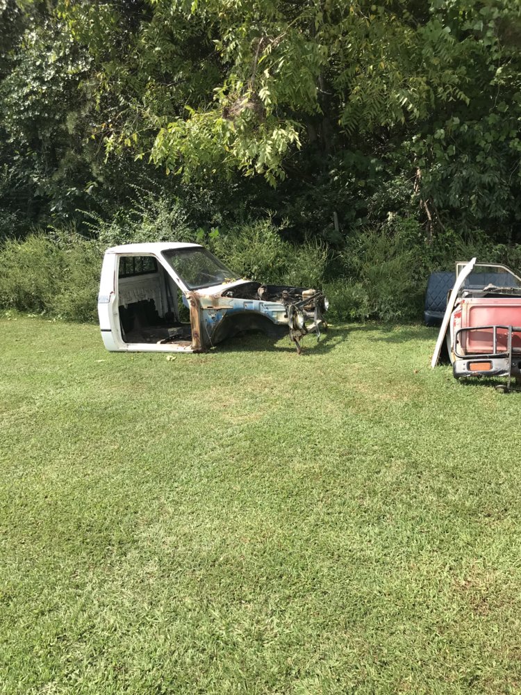

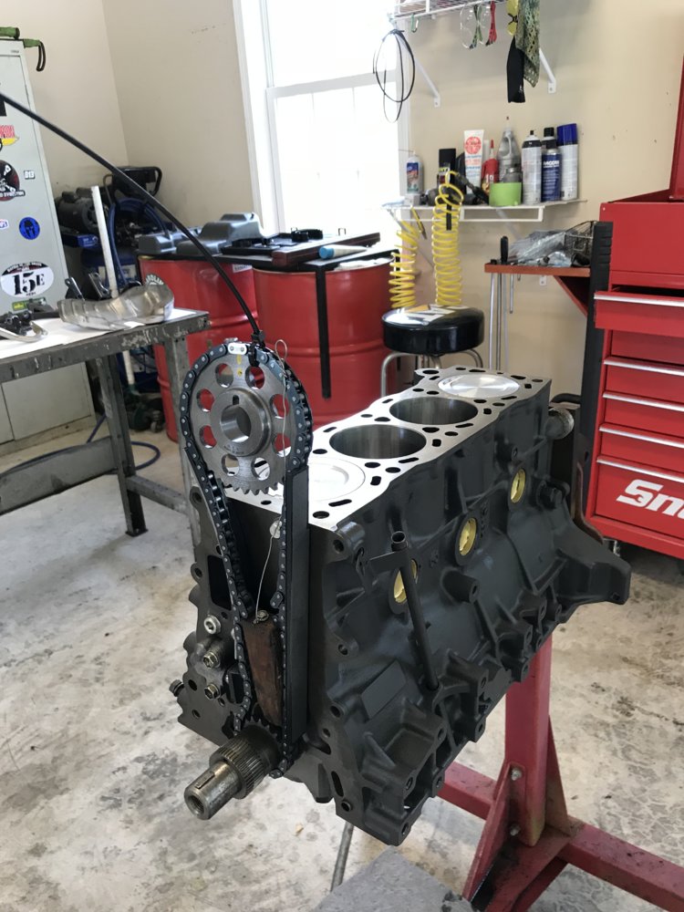

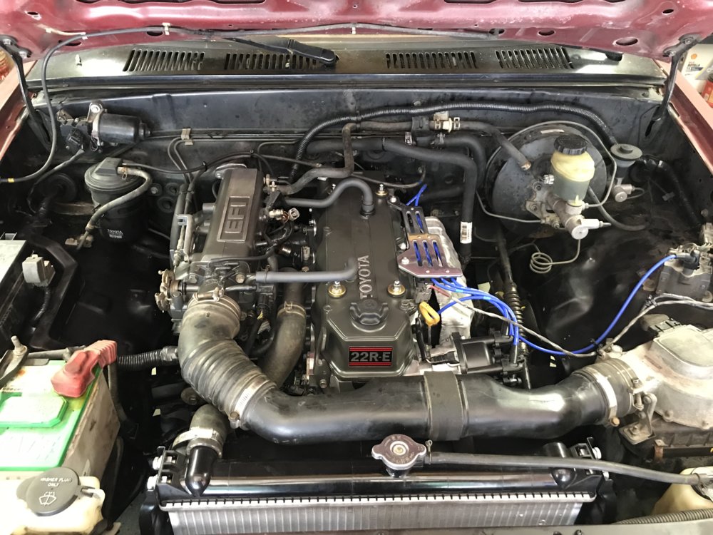

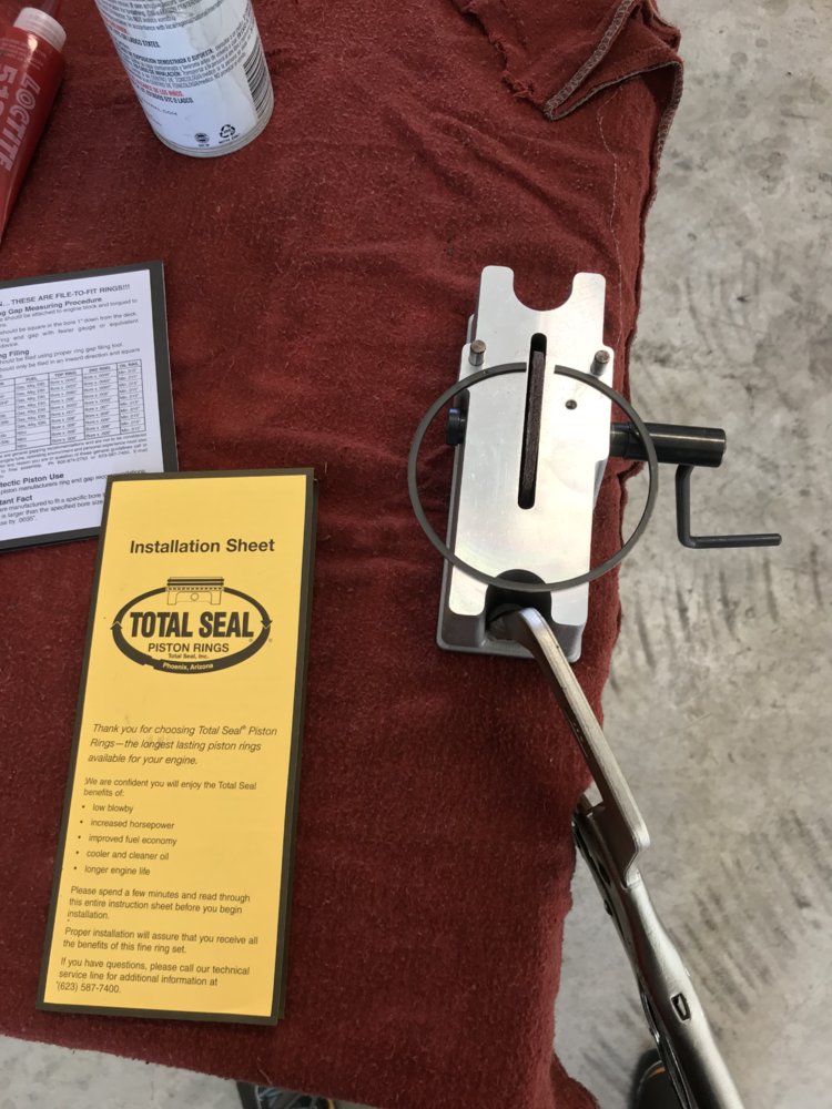

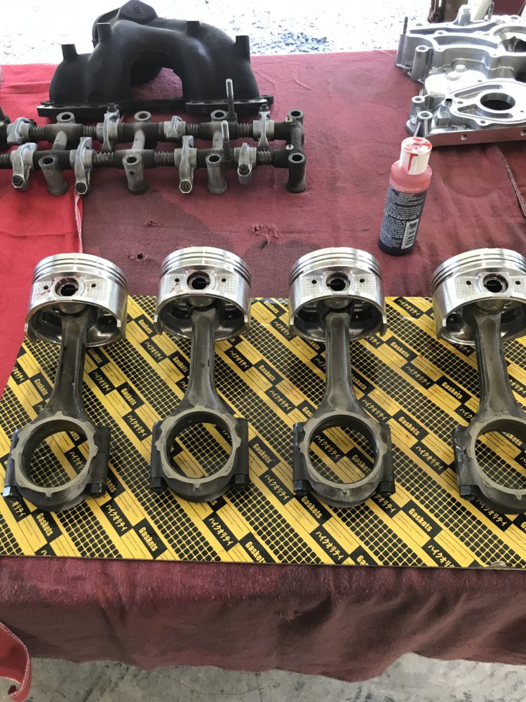

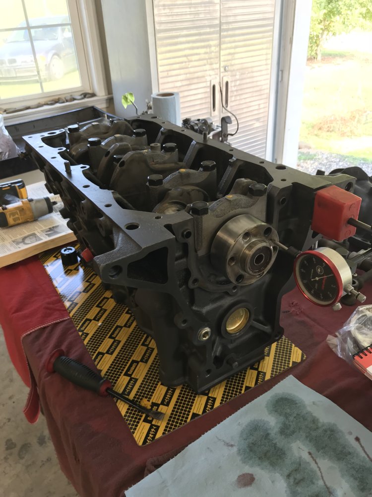

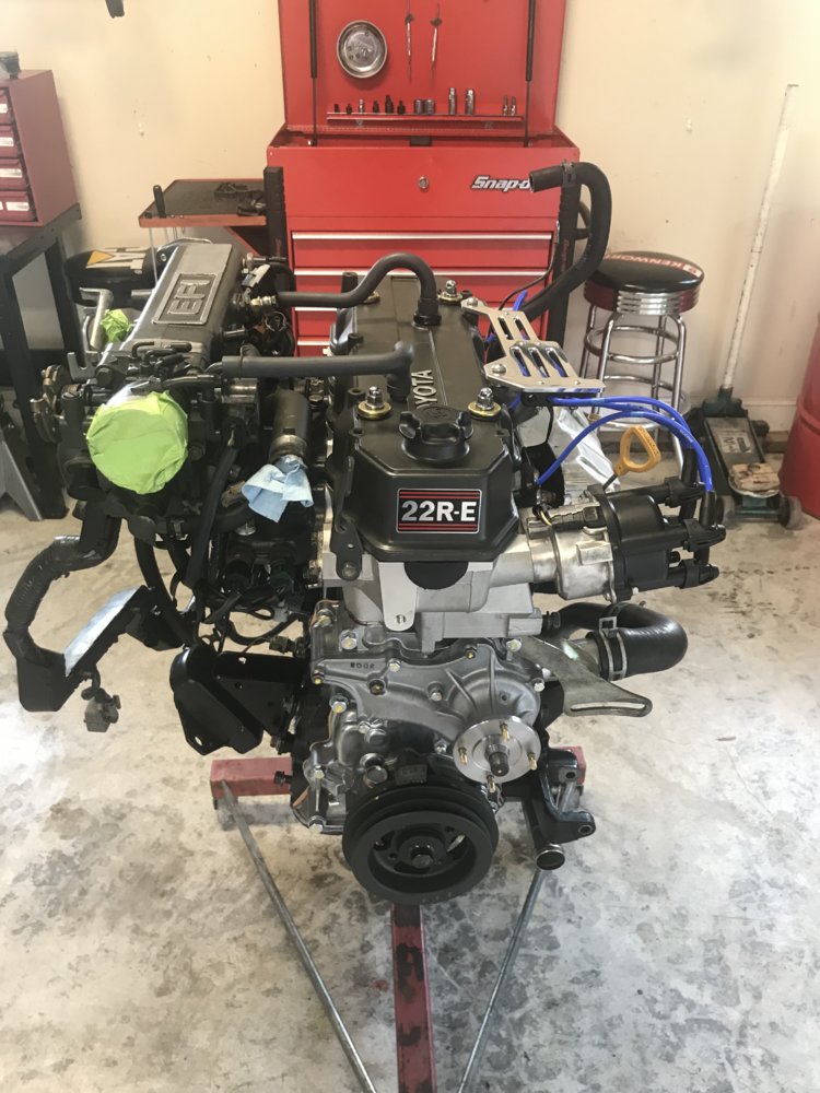

Hahahaha! I don’t have pics of Chris’s boobs, and I don’t have any progress pics of the trail rig.... but since we are talking Toyota in this thread, I can post up some pics of the 22re I built for my daily driver. Now that this is done maybe I can start tearing down the trail rig.

Looks like it'll getcha down the road nicely!
If there's Beer and good food on the grille.....I'm down to lend a hand or heckle from a fat boy approved chair
All missing in my shop....so the secrets of the brotherhood are slowly revealed.
And keeping the old lines....hope your successfull. My absolute favorite body style along with old Datsuns for some reason.
Looks like you've been hard at work.
Did you find out what that noise was in the engine you rebuilt?

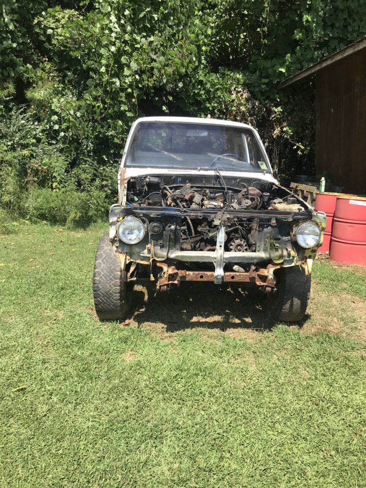

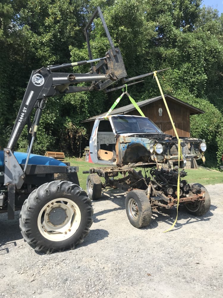

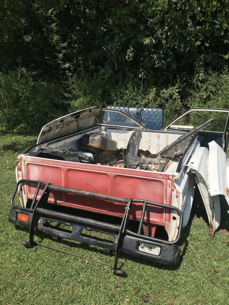

She nekid!!
Shame you had to send the girls to NYC in order to have the time to get r dun :lol:

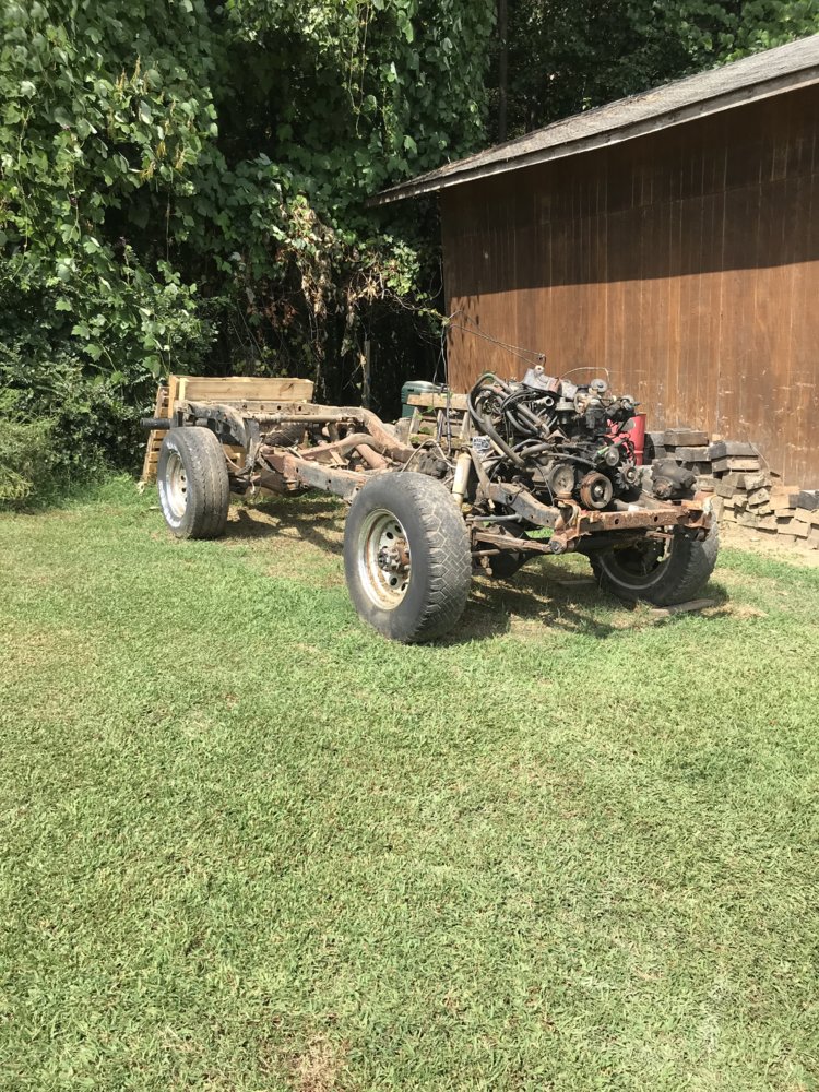

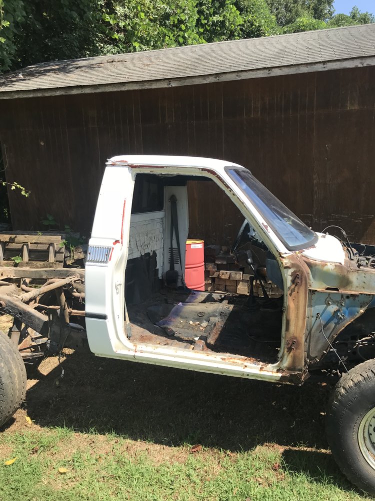

That’s a fact! Wendy and lainey are in NYC. Natalie is camping with the inlaws....I’m home alone...since last night at 7:00 I’ve installed the engine in the daily driver, tested it for a couple hours (it’s good this time), got the black sheep ready to pull the cab, mowed the yard, drank beer, took a nap, and I’m in the process of drinking more beer! I miss my girls, but when it’s just me and Corona we get stuff done!!!!
It was piston slap on #1 cylinder. Turns out it was a casting flaw with the piston. Once I got the engine back out and tore down and started measuring piston to bore clearances, I found #1 piston skirt was .007” smaller than it was when installed. Crazy. When the piston was exposed to heat and pressure the skirt collapsed. LC engineering was really great to deal with, they sent me 4 new pistons and a head set. But it still cost me a lot of time.

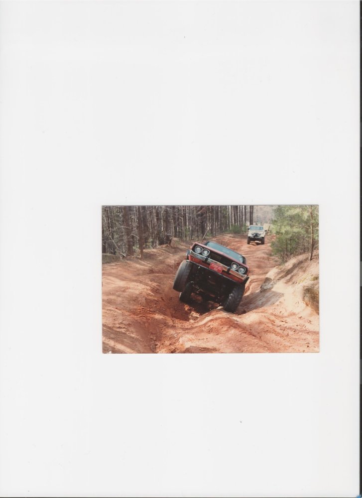

Like This? {Prior to the Golden Eagle} I kind of Miss that Crazy ol truck! :D
