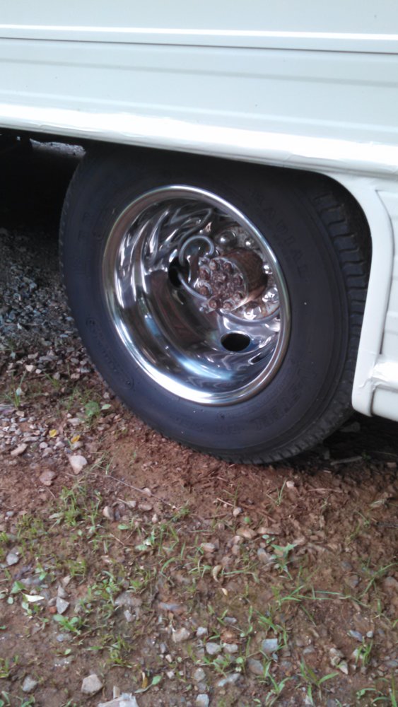

For those who would appreciate 37yr old hubcaps in mint condition lol. Ready to roll
They look much better in person.
