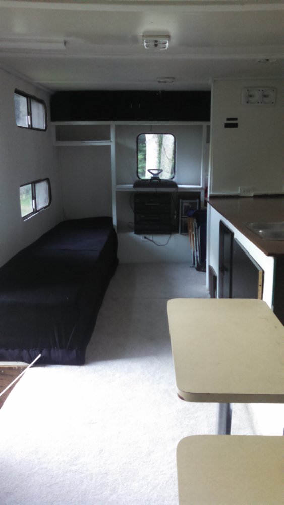

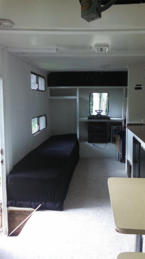

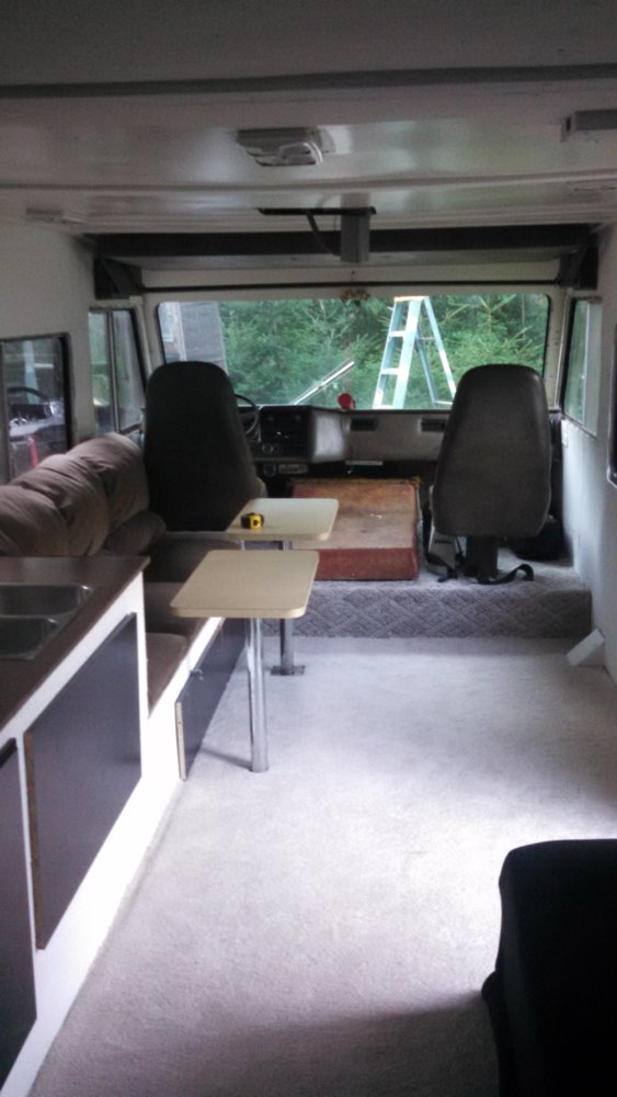

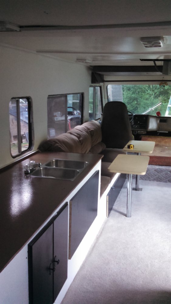

well I know it's been a while but I've been super busy and has taken lot longer to get this thing done/ready/usable BUT here it is.
It's not "All Complete" but it's ready for our next weekend fishing/camping trip so ........not bad for 37yr old clunker!!
I call it an "apartment on wheels" since it pretty much looks setup like a little efficiency apartment. It hasn't turned out the way I would want had I plenty of money to throw at it and wasn't focused on "weight" but I actually like this open simple setup and it's cozy.
Still have blinds/curtains to put up, seat covers, dog house carpet and little misc.
Thanks guys I really like it. Had I intentions of selling, it would be totally different as weight would not have been an issue and I would have really like to do some custom cabinetry and framing like I used to do but it's a cool little apartment on wheels to camp in, go fishing, probably going to be an awesome Tow Rig and gas mileage should be up around 10....I HOPE lol. Thanks for the support guys. I hope i can cook up some BBQ for you guys on the next trips sometime having a legit setup and such!!
This thing turned out damn nice!! :bounce:
Thank You Sir very much!!

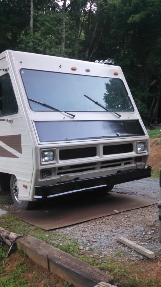

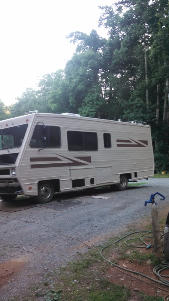

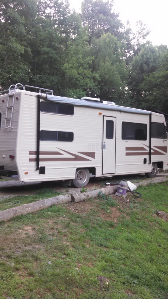

Today we brought a piece of history back to life...took a drive around town and down the highway a little ways and WOW, drove really good minus a few quirks. The thing got looks everywhere in town as I imagine people are amazed to see a old school motorhome looking vamped up driving down the road and sounding pretty good too lol.
