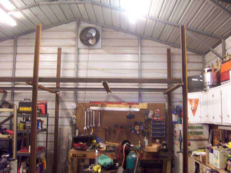

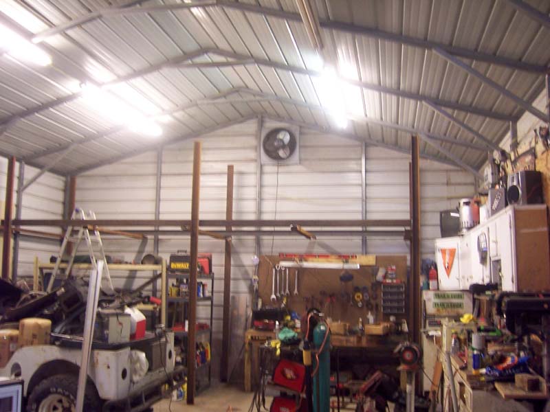

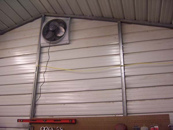

Well with the recent heat and me sweating my butt off I had to get some air flowing..
and since I was given a big fan with a bad motor.. I wondered if I could fix it and get it working.. well after some calling around and contacting Grainger they found me a new motor for $40..

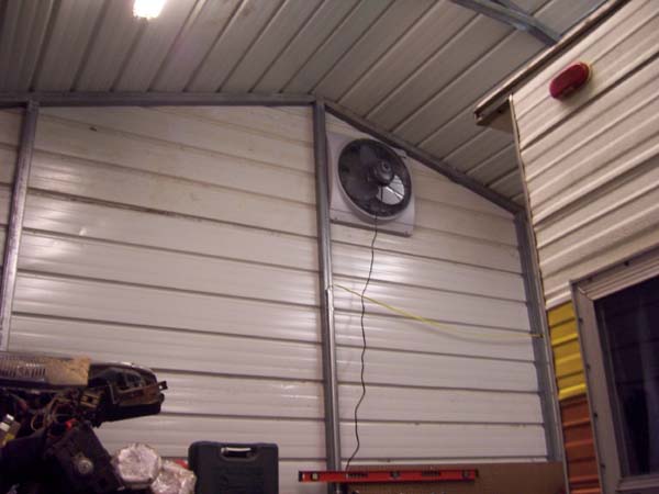

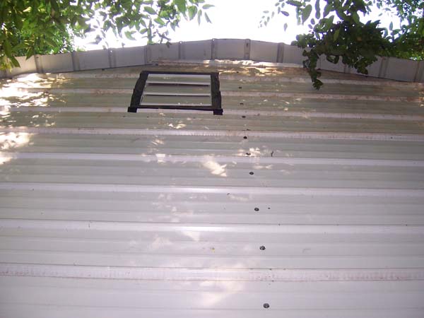

so today I cut the hole and installed the fan.. it really works well

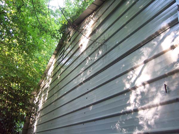

from back outside corner
looking up from outside
I put it up as high as possible
you can see I still need to run wires, but heck it does work :)
since some asked here is the fan:
http://www.grainger.com/Grainger/items/3C614
specs:
Whole House Fan, Window Mount, Reversible 3 Speed, Propeller Dia 20 In, CFM High 3560, CFM Medium 3120, CFM Low 2510, HP 1/4, Fan RPM 1600/1450/1100, Voltage 120, 60 Hz, Single Phase

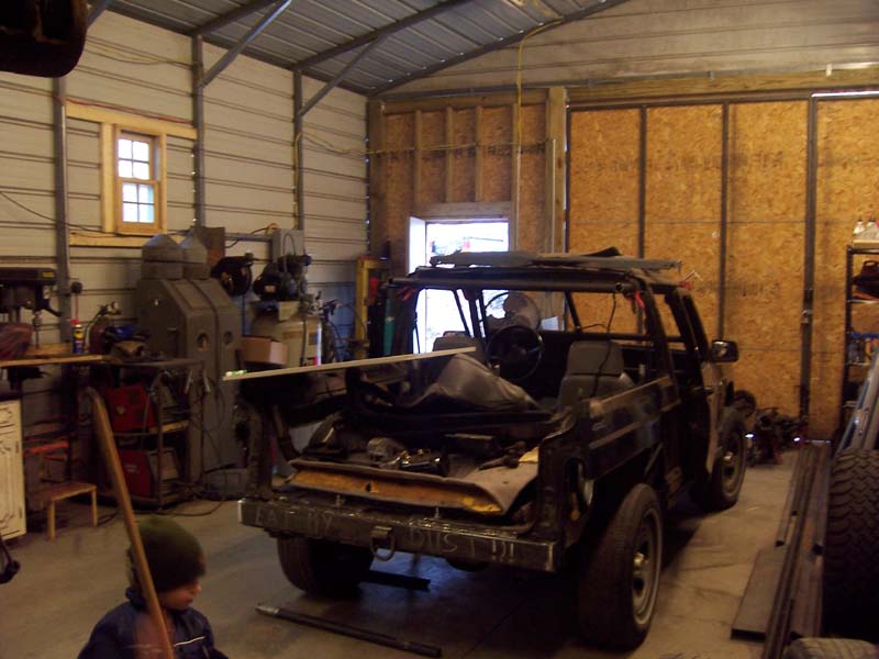

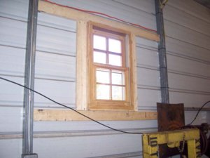

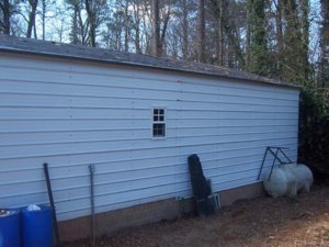

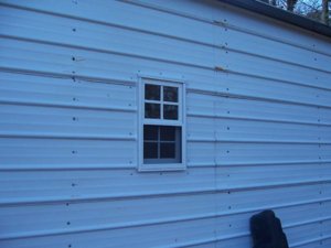

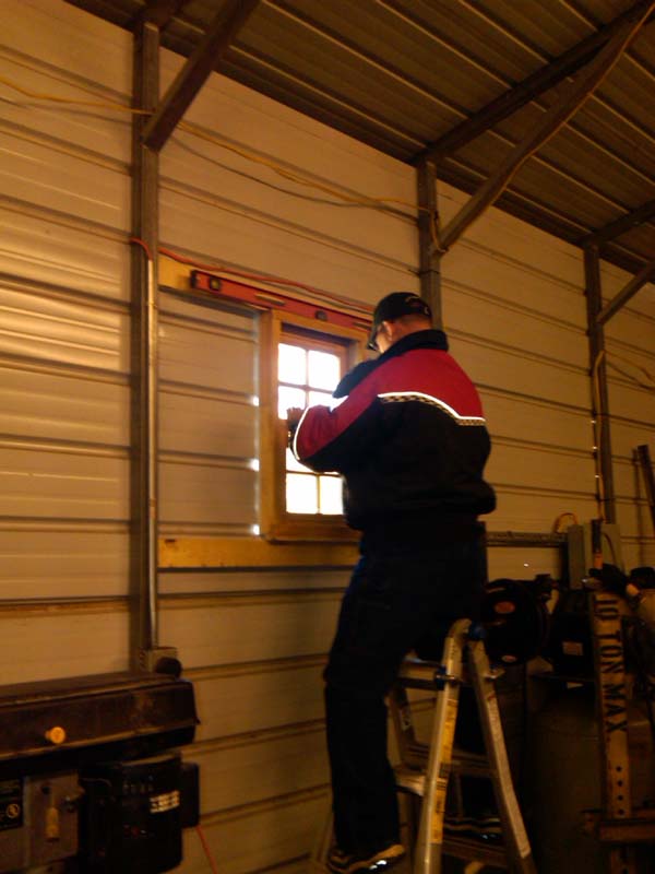

Well my brother was in town so we installed a window on one of the side walls. Plan to install 3 more on other side wall

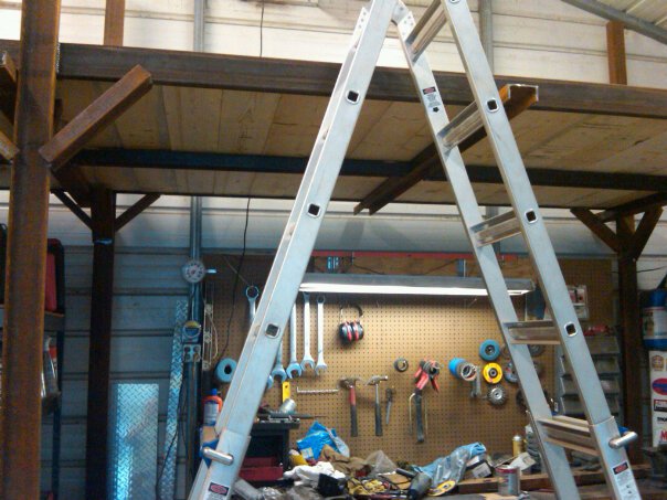

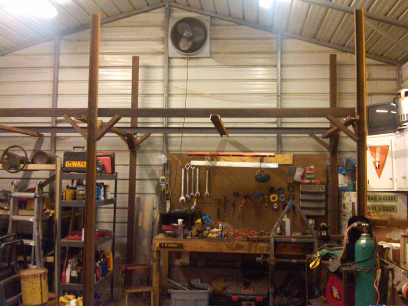

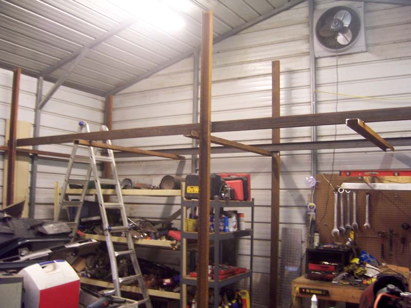

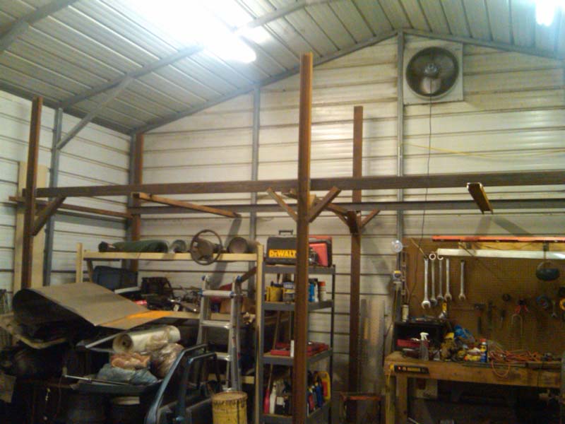

Well I am back at it again :)

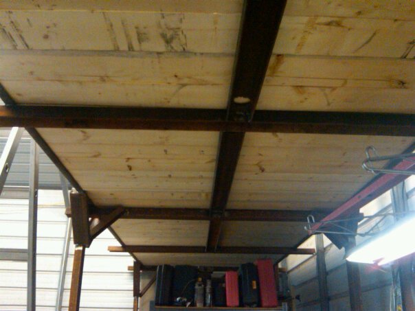

need more room so I am building a loft to store parts, etc up off the ground
the floor will be 8' off the ground. 20' long and 6.5' in depth
lots more metal to throw at it and brace corners, etc but hope to have it done in a month to get all my stuff up on it and of the floor

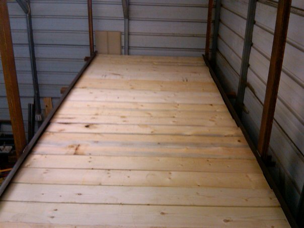

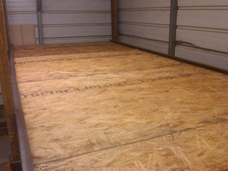

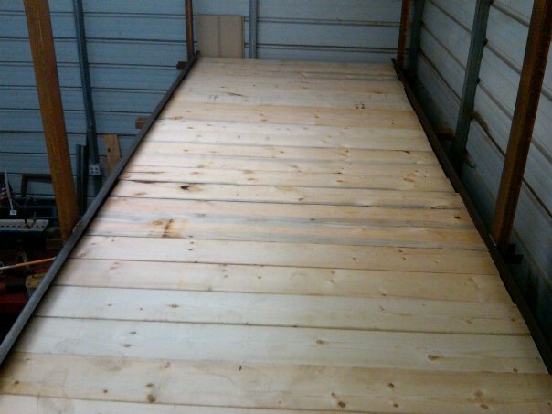

got the final layer of wood on..
3/4 plywood.. floor is super sturdy now..also got 1 brace done to building but I have some more to do before i start putting stuff up there.

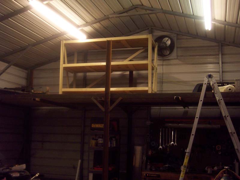

well today was probably pretty stupid but I got it done..
lifted the storage rack up onto the loft.. WOW that was heavy.
maybe I should have taken it apart before i moved it :)
looks great! and I must say that was a smart way to utilize some unused space!

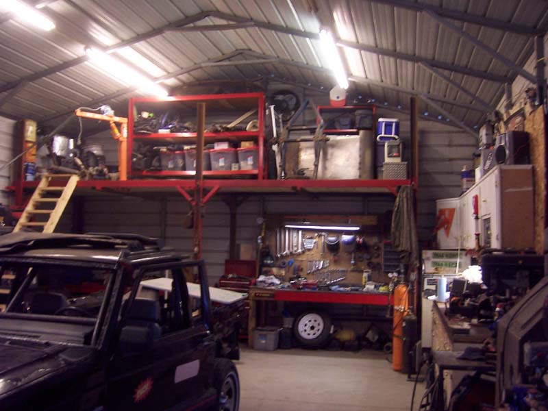

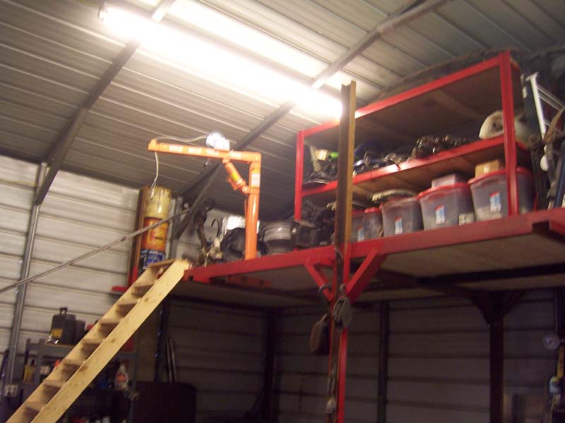

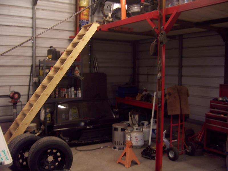

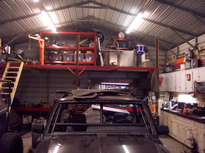

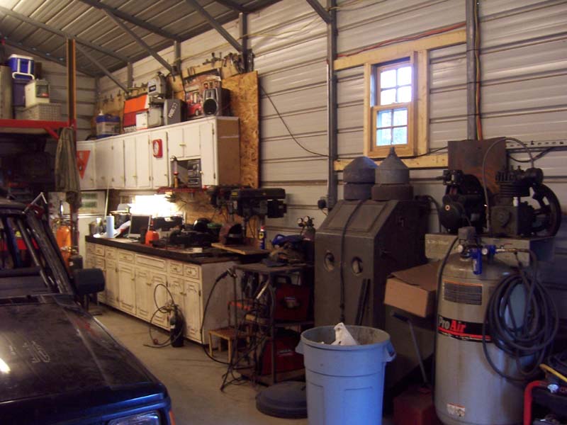

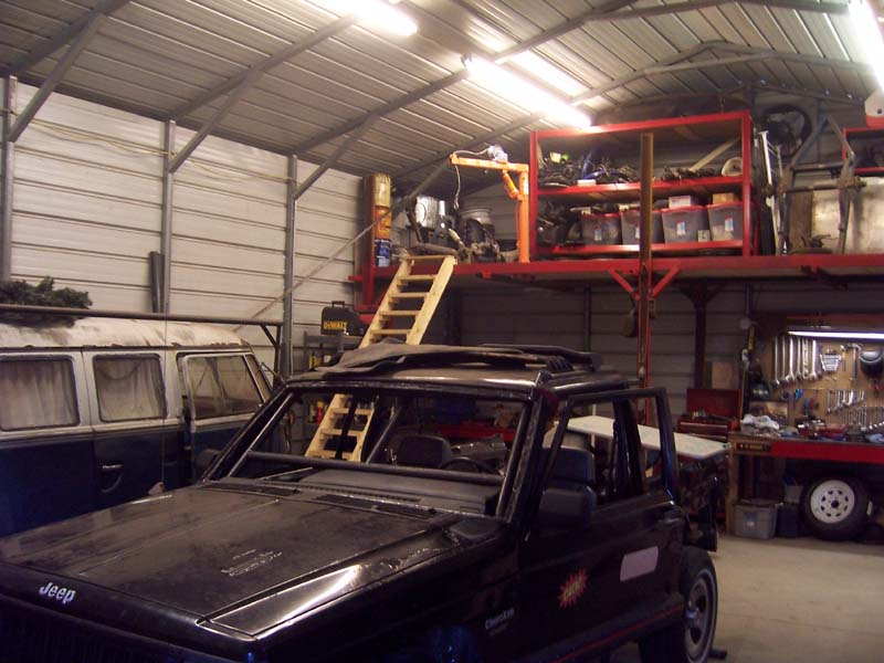

Well I finally got some pics of the loft and all the stuff up on it.. oh and do not mind the mess we are building another race rig :)
looking from the walk in door
right side
stairs that can be moved anywhere along front of loft ( they hook on )
crane I added to loft to get the heavy stuff up
looking from under loft out

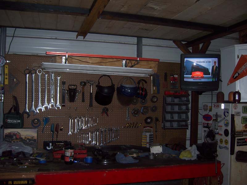

added a TV

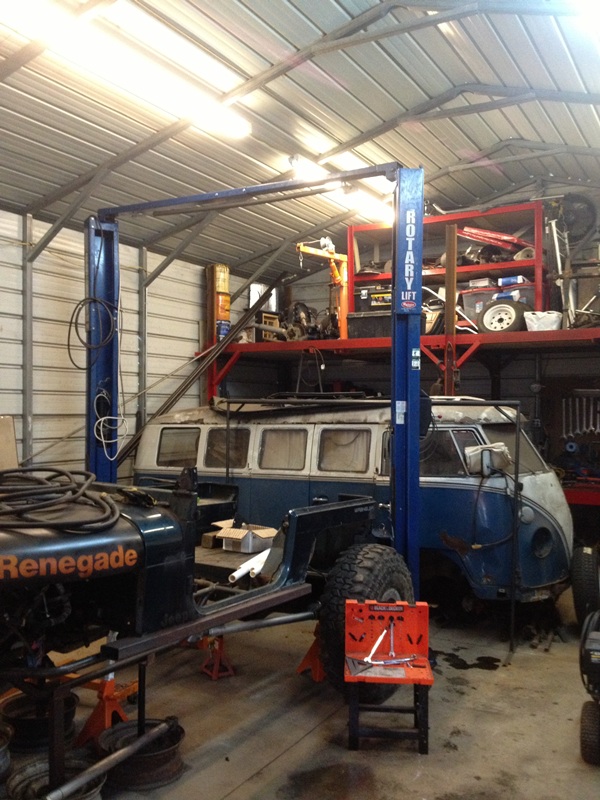

Man thanks for that Link.It's weird,I was just thinking today,I need to build something to store the new camper,and it would be nice if there was enough ceiling so I could finally install my two post lift.That's Perfect!!

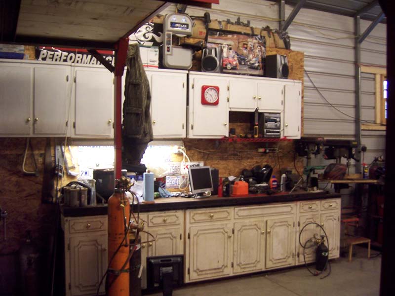

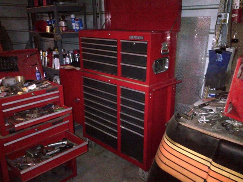

little update :)
been looking for a bigger box for a long time, now I just need to move all the tools into it and label the drawer

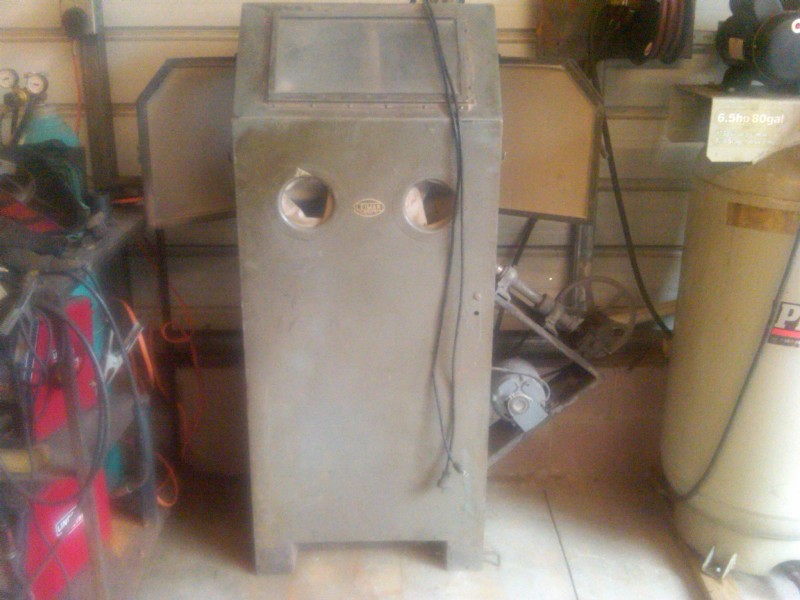

well just added a cool new tool to my shop :)
it will be a little while before I get it all wired up and functional but will be awesome to have and use ...
