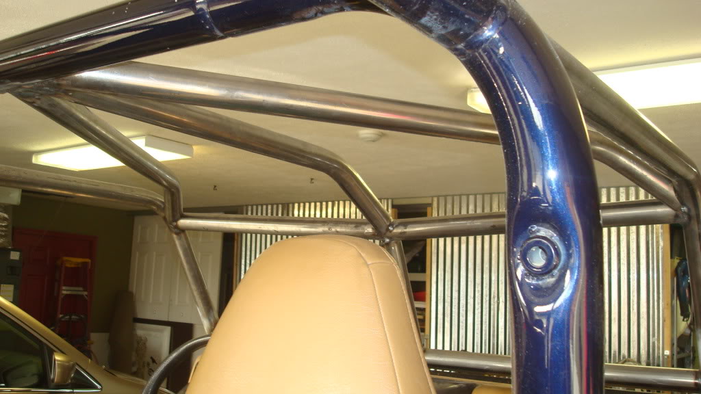

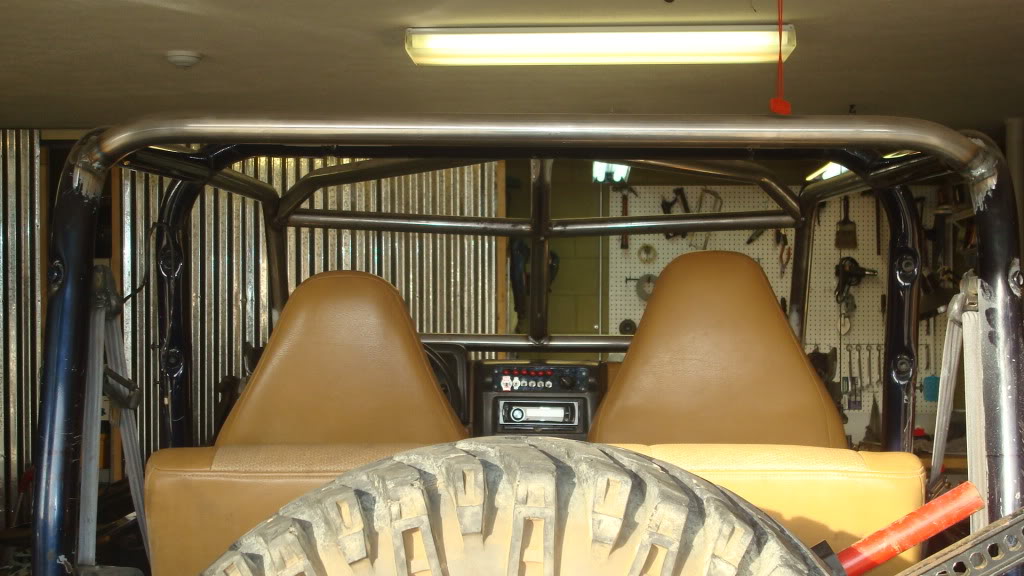

Lookin good man. Did you have any trouble clearing anything behind the dash. On Mikes we found out when we put a 5 deg. bend forward in the legs about 10 in. below the top of the dash everything seemed to fit a little better and made some more leg room.
Thanks for the advice, Mine cleared without issue, I have no air ducts in the way, but we are going to be doing Kyle's (wrangler00) next and he has to maintain the air ducts due to it being his DD

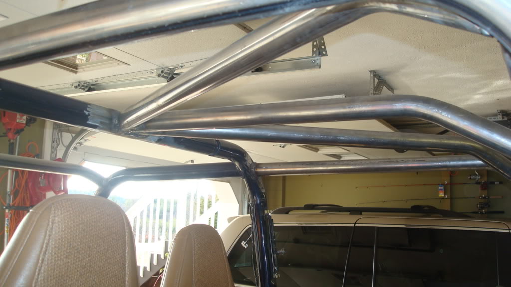

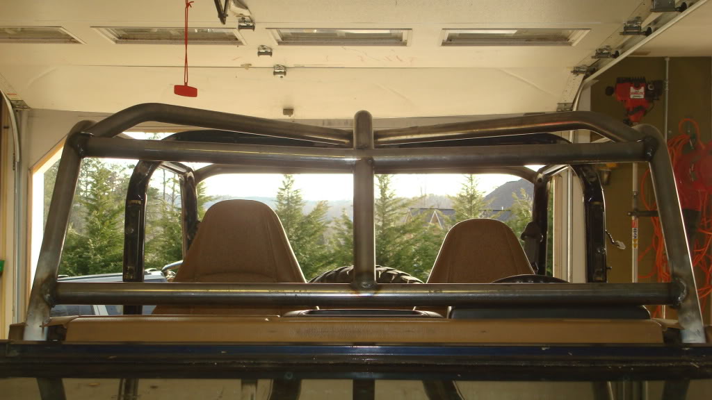

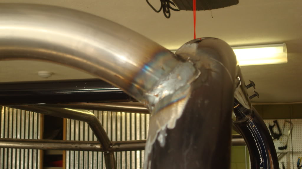

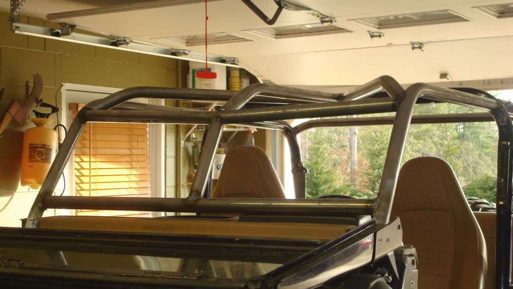

Well I was able to get the rest of the front of the cage bent up and fitted today, Half of it welded up, Just need to hit a few joints around the windshield. The front was slow going on the welding, I learned it is well worth the extra effort get a nice fit in a joint (Compound joints at that), I had some spots that were wider than I would have wanted so it took a little longer to fill the gap. I guess you live and learn and I am, But I am getting better at my welds. Got the rear upper cross bar bent and welded in. Just need to bend the rear spreaders and add some braces in the rear and It will be ready for some paint. I am really digging how it is turning out.
Here are some updated pictures.
One of my ugly welds, But there getting better :flipoff2:
Tell me what you think?
