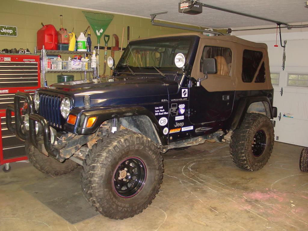

Moneys been tight so work on the jeep has been slowed. I did trade for some wheels, Finally got the chrome ones off it after eight years.

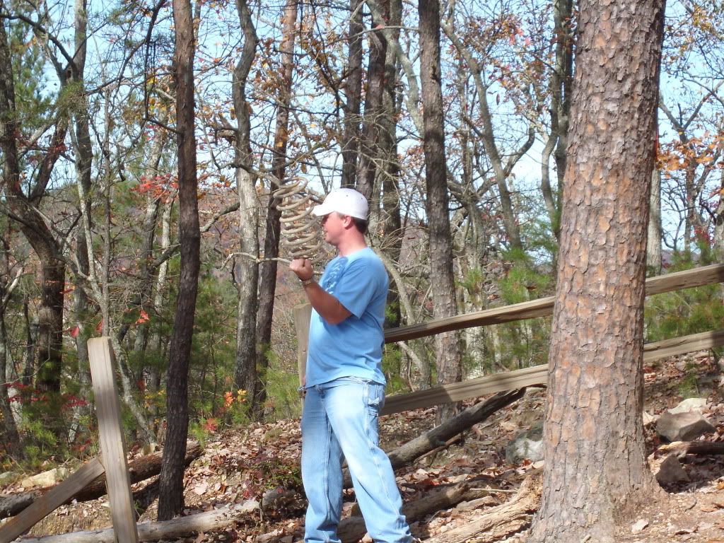

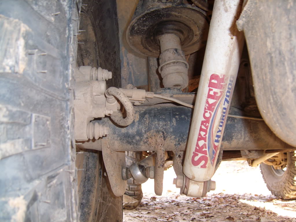

Lost my real coil coming up a rocky climb, The rear flexed and the spring poped out, made the climb :smokin:, put the spring back in at the top, time to install some retaining plates.

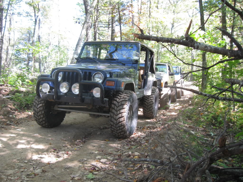

Well I think I took my last trip for the season, Went up to Callalantee yesterday.
ai298.photobucket.com_albums_mm279_burrellsjeep_TJC_068_1_1.jpg_25117d2fde657235efc4fd6205b66d31.jpg

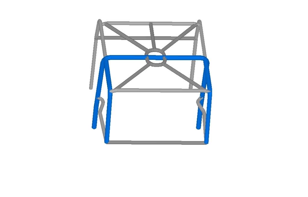

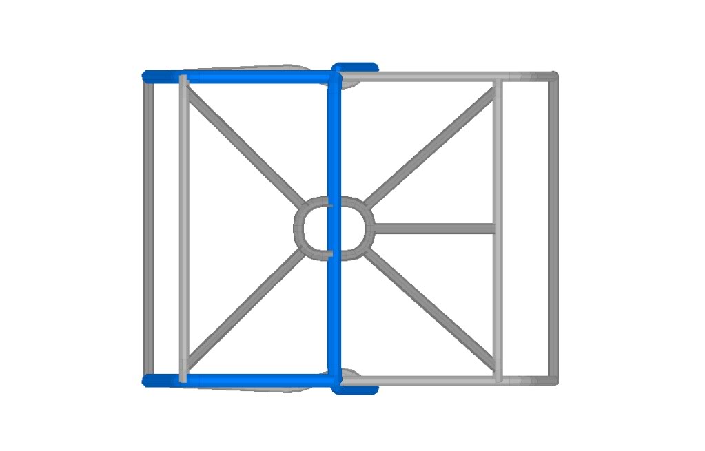

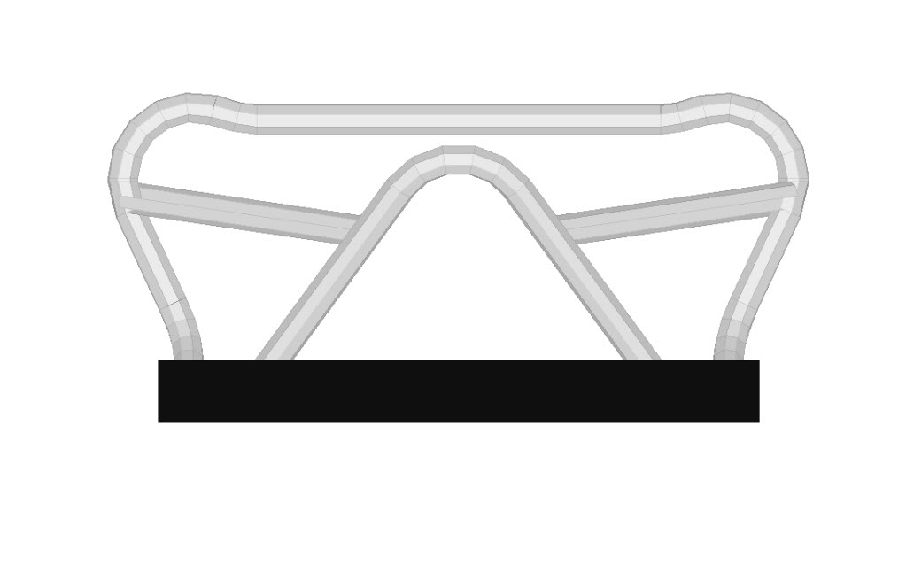

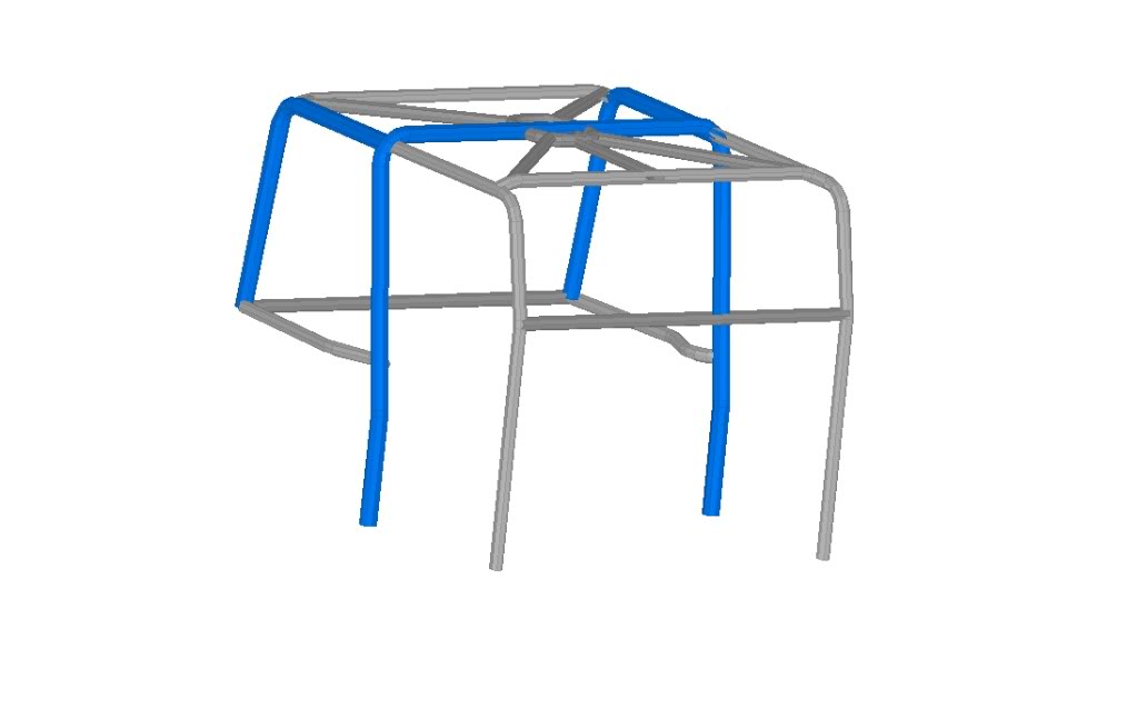

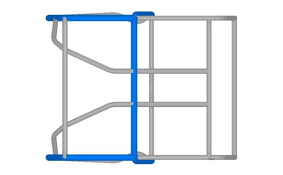

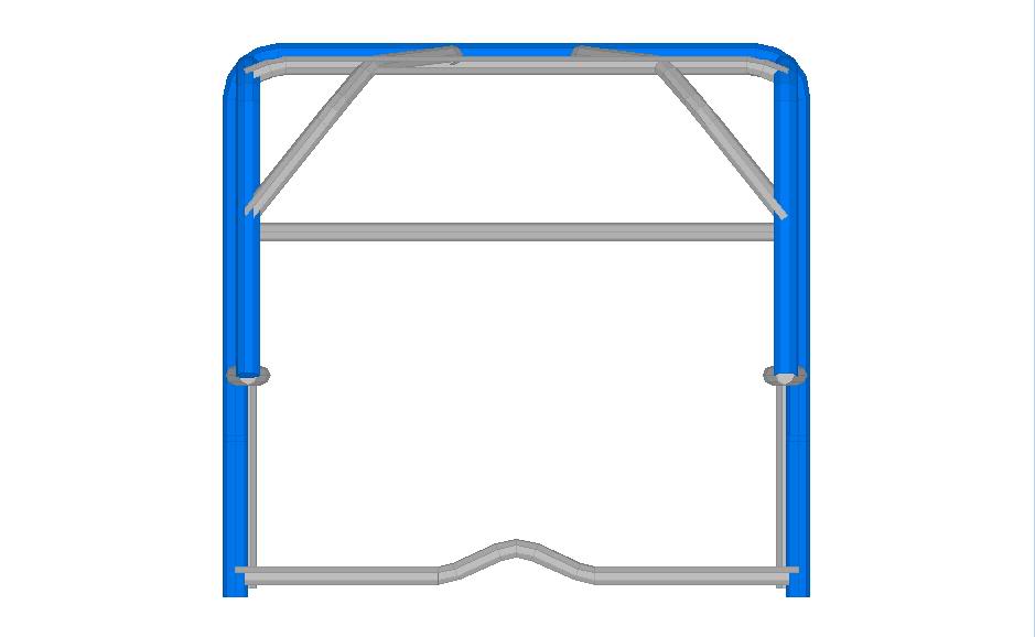

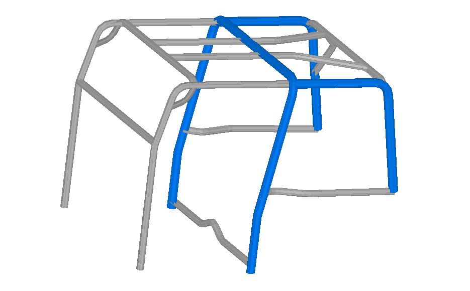

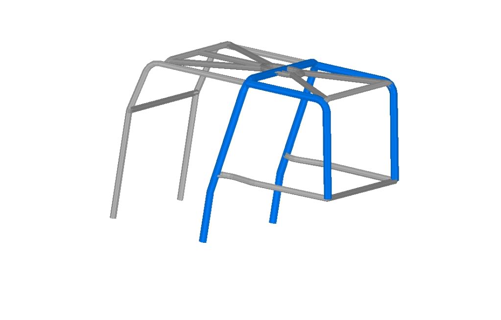

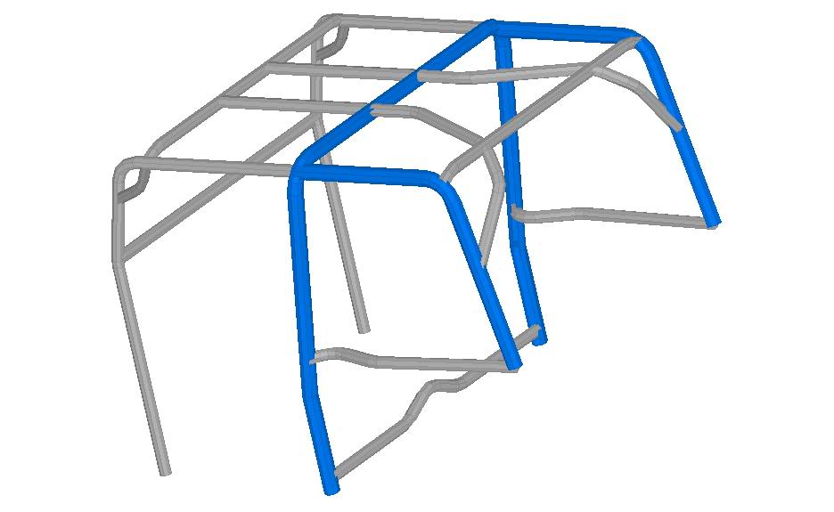

Been designing my cage in Bend Tech Pro.
Keep in mind this a family cage so I will have to keep the back seat accessible, I know cross bars behind the seat would be ideal but I can't give up the space. This is a "Just In Case" design, Not a "I know I am going to use it" design.
With the help of Braxton I might actually be able to make this happen.
The blue tube is the existing cage that I plan to build off of. The silver is 1.75
Those comments should be on a sticker. The cage looks good and thats a cool video. What kinda software are you using?
Bend Tech Pro, Still getting the hang of it.
