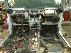

The cage needs to come down through the dash for the driver's convenience. It's pretty easy to go through a TJ's dash but not a JK as you can see. The dash "frame" is aluminum and its all over the place making it difficult for tube placement, not to mention all the cooling ducts, 2 speakers per side and the dash harness.
Thanks! It's what has to happen to build a strong cage in this thing. I've never been a big fan of the cages that use 3/16 and 1/4 and wrap around the dash to the floor, I don't trust them. The cage will actually be rather simple, just clean looking. The hard top gives us limited options due to its 4 mounting points to the cage which should be fun to deal with.......

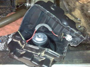

Looks great. One thing I learned moding the vents is to turn on the blower fan before you put it back together to be sure they don't whistle. We use to modify them form stereo stuff and had one or two sets that whistled and it sucked tearing it all back apart to fix.
