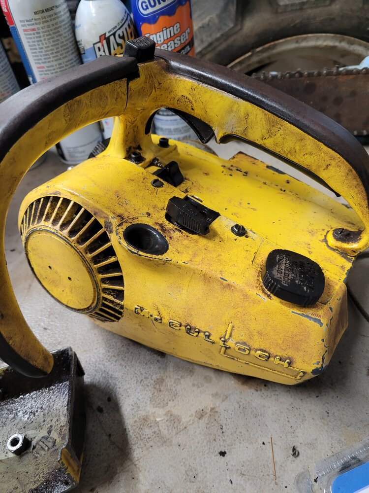

Well got this power mac 6 and the mini max 35 to start on starting fluid. Power mac needs a new pull cord, bar and chain air filter and spark plug and should be good to go.
The mini max needs air filter and housing, bar and chain, spark plug and I'll probably get a pull cord for it to. And then I gotta figure out what is missing from the manual oiler

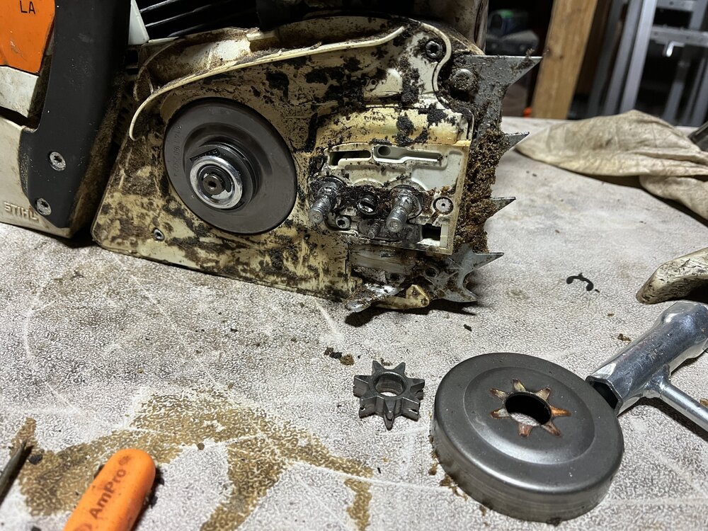

My 261 ripped the drive sprocket apart. So I replaced it with a proper Stihl one.

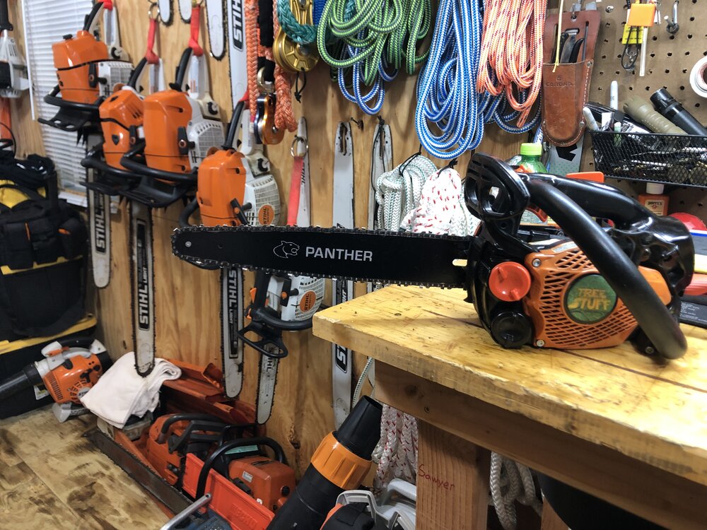

That echo 2511T is my favorite saw. Friend that sent it to me did some exhaust work on it and it puts a smile on my face every time I use it. Sounds just as good to me as my stihl 460 with a bark box. Have you swapped over to the stihl bar and chain on yours? It’s something I need to do.
Oh yea. I probably use that saw more than anything I have! The exhaust and some tuning really wakes them up for sure. As far as the bar I run the panther kit from monkey beaver. It converted it to 1/4” pitch and I went with a 14” bar. It made a world of difference too. About as much as exhaust and tuning

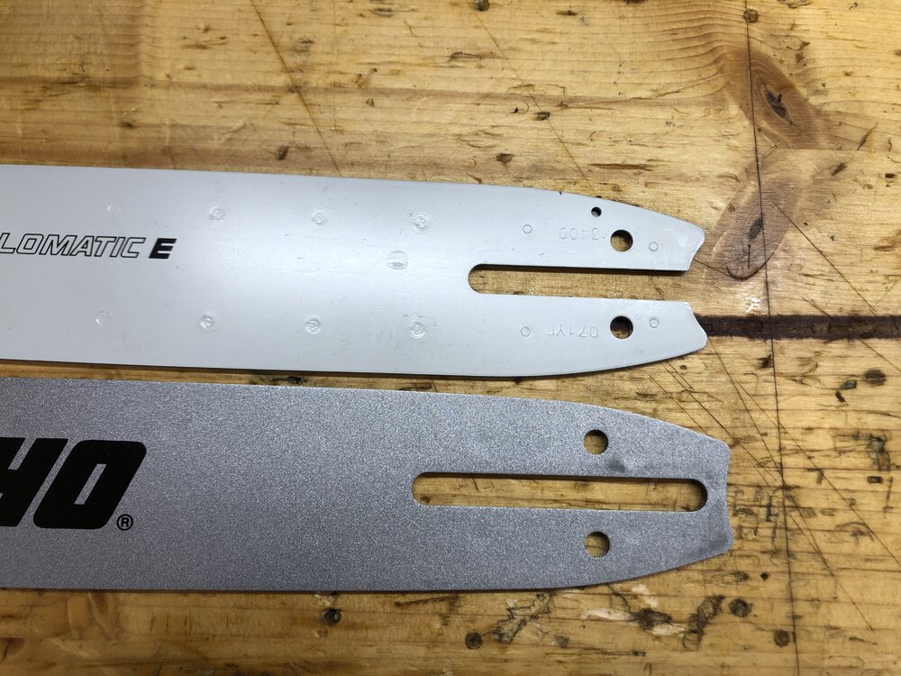

If you go the route of the stihl bar you have to either weld up the oil holes or make a little blocker plate or the oil just leaks out the little hole. The oil ports are in different locations on stihl vs echo. Bar mount is the same however.
And this is the part number for the 1/4 pitch clutch drum for the echo
