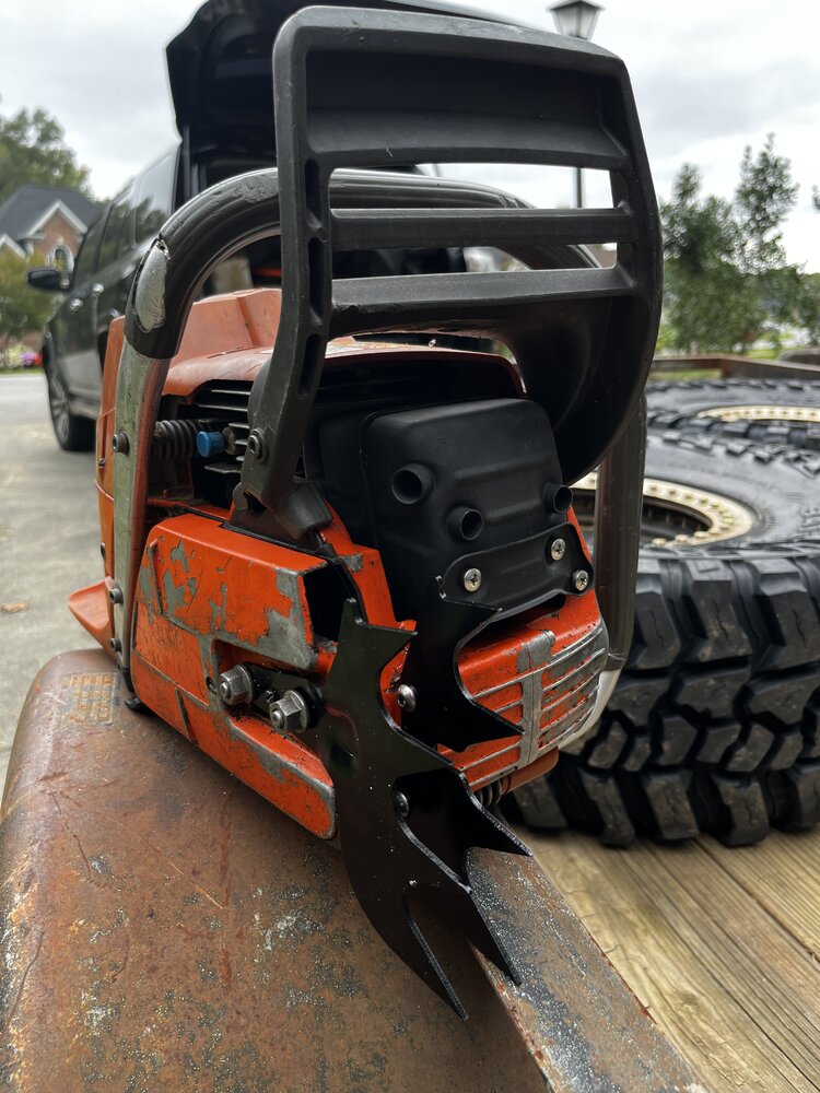

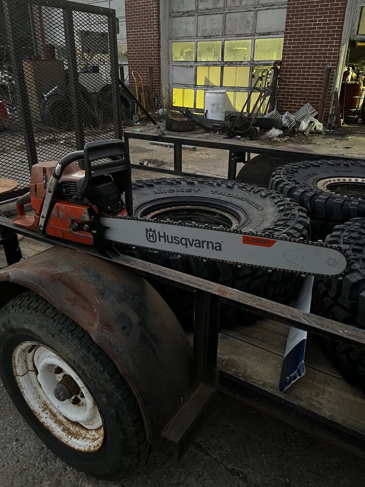

Finally put the 385 back together tonight.
New brake, “ported” muffler, a few bearings, dogs, tapped the dog mounts out to 1/4-20 since they were stripped and a fresh 28” bar and chain.
