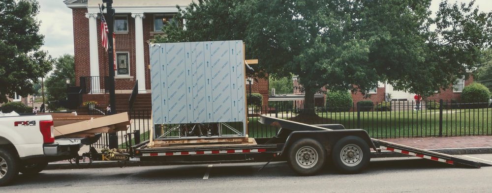

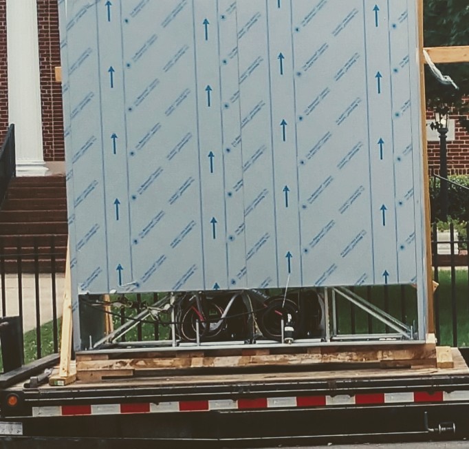

Don't know Which trailer thread had a recent discussion on tilt trailers, so I'll just put it here. Saw today; look like a church is getting some type of refrigeration unit. There's 2 fair sized compressors, under the unit. I'd have to Try out This tilt, to have an opinion on it! I'm sure it has pros & cons. Powered or gravity? Sorry, I didn't check.

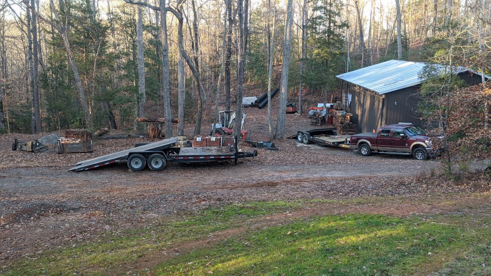

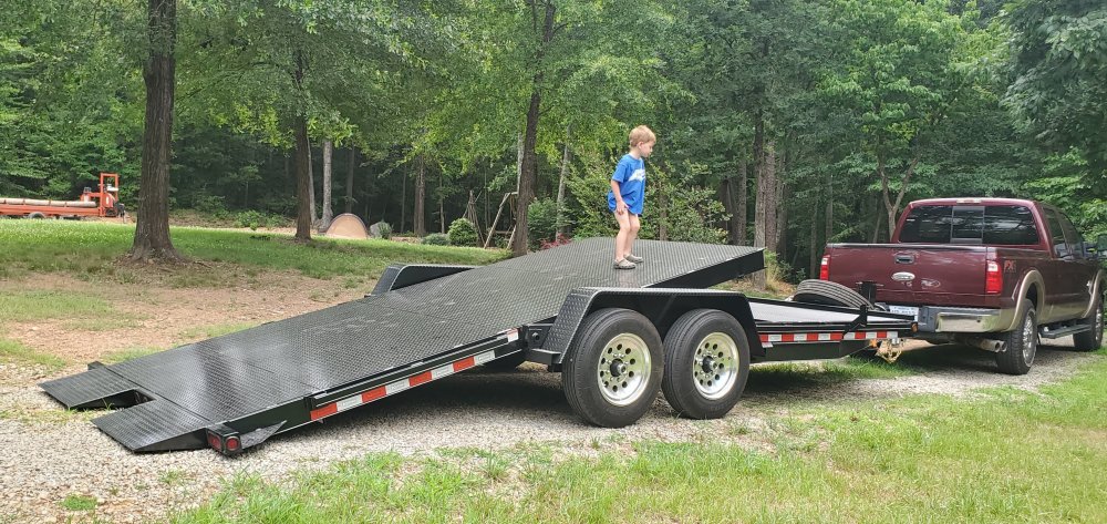

Kaufman 22ft partial tilt with dual 7k axles, gravity tilt with hydraulic damping cylinder. The one in the picture is the newest generation in the 15k "deluxe" version. What you wanna know about them? I've had 3 different generations, steel and wood deck, 14k and 15k, pin latch and lever latch, 20ft and 22ft, new, used, and abused. :D

And I saw 2 more of them on the Interstate today! Guess I started looking. Just seems odd, as I've only used a full bed tilt. I'd hate to start backing up, & it tip, high centering me. All depends on length & area of weight, I assume?
They are made for short wheelbase stuff like skidsteers and mini-excavators. The tilt portion is 15ft9in, and they recommend a 94" wheelbase limit. But with a cylinder lockout, you could certainly handle a lot longer.
