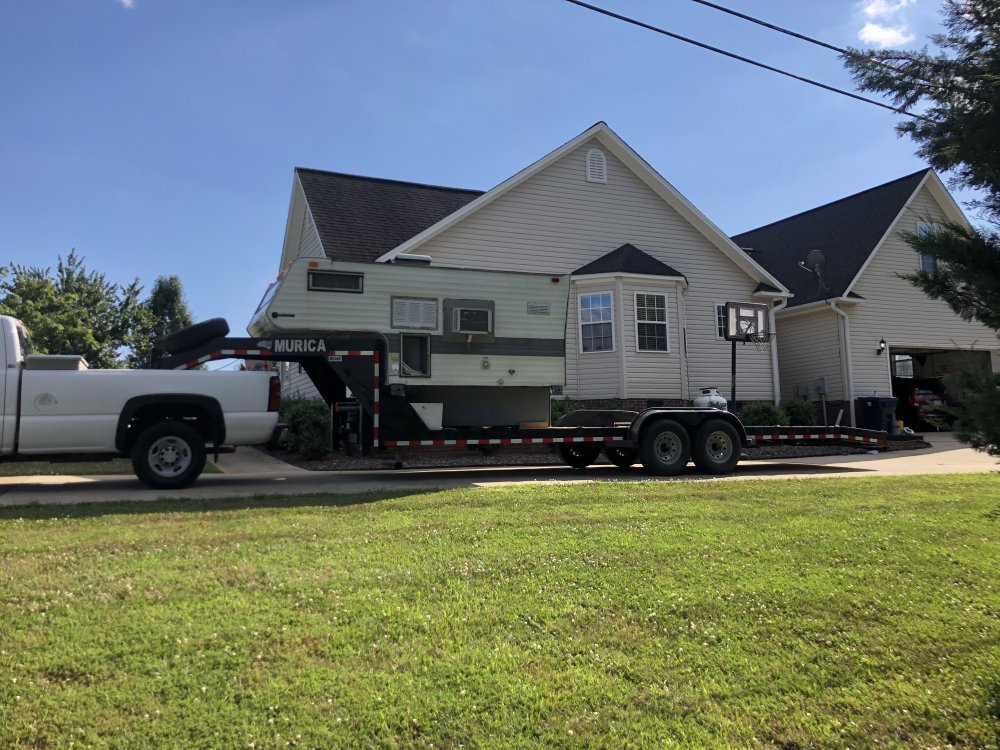

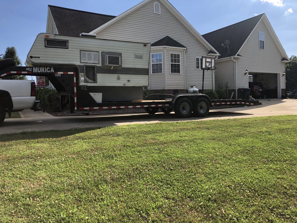

Well that seems to have been just what I needed. Trailer is much higher in the back now, level, and doesn’t scrub on my driveway anymore. It actually has plenty of clearance. I’m very happy.

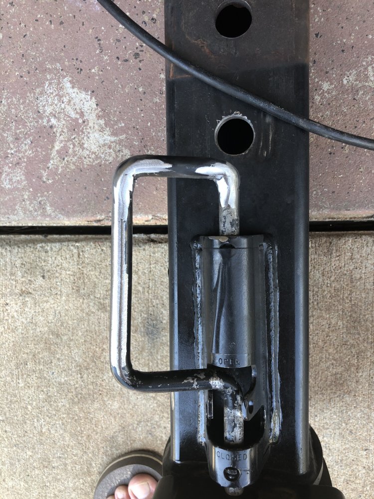

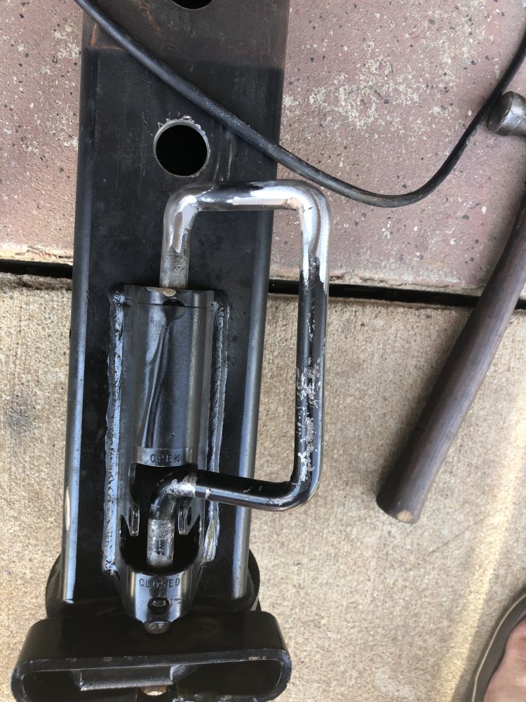

I had to cut a little more than an inch out of the handle to release to coupler cause it was hitting the neck. I cut a section out and welded if back together, now everything clears.
Looks good! If you buy a Kaufman equipment goose like that, you'll go from dragging the tail to dragging the jack feet. They really need to work on that. That's my only complaint.
I did not load either Jeep. I know that will settle it a little, but I had plenty of clearance. I’ll know soon as I’ll probably get loaded here soon.

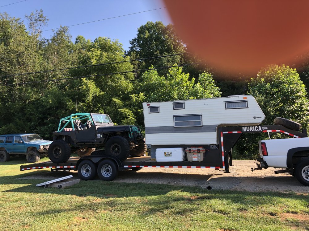

Test fit the YJ yesterday. I have it pulled as far forward as I can where I can still open the door on the camper. In this pic, the truck is uphill from the trailer axles a little. I still have plenty of clearance at the rear of the trailer.

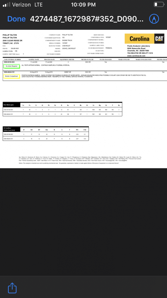

The truck also has a fresh oil change, and I sent off for another oil analysis. I have been using the same oil and filter since the last one, only change is I’m changing it at 3k now instead of 5k. If you remeber last time I had some copper and bearing material (to be expected) but also an elevated amount of silicate which is found in antifreeze. Could be a weak head gasket, not sure. But also back then my radiator was leaking on the driver side where the oil cooler lines go so who knows.

Pretty great set up with enough space clearances!

I also got my oil results back. All is well! I will keep changing at 3k and roll on.

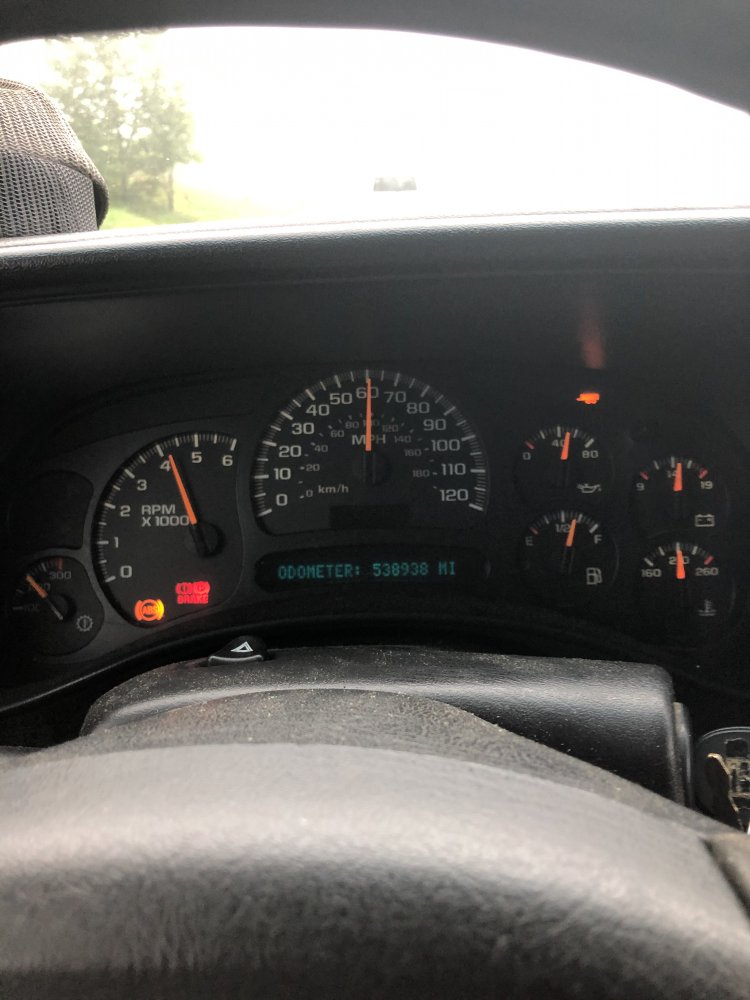

I don't remember from the start of the thread but is this truck still rocking the original engine and trans? Either way I love it but if all original I'm even more impressed with its ability to get it done after half a million miles on the road.
I wanna say it had a motor at 300k and it's been through a few trans rebuilds.
This motor has 190k on it roughly. The first motor went to 350k. The transmission has been replaced twice. I can’t remember the mileage on this one, I’d need to look back at my folder but I believe it’s has less than 100k on it. I may look tonight out of curiosity.
Just think how much better it would do, if the Parking Brake was Off? :lol:
So I got curious and dug thru the folder that came with this truck. I was wrong about the how long the first motor went.
The first motor went to 418k
Replaced with a motor from another truck with 80K
The first trans went to 317k
2nd went to 335k
3rd went to 453k
The mileage between the first and 2nd is strange. Something went wrong for sure. Also there may have been some before that, however I have every single thing since new on record.
Nevertheless, my current one has less than 100k on it, and my current motor has right at 200k
