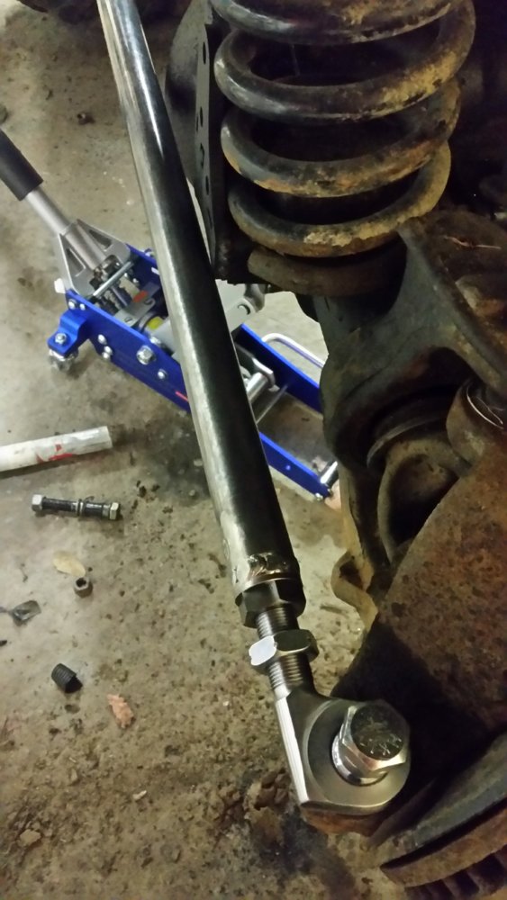

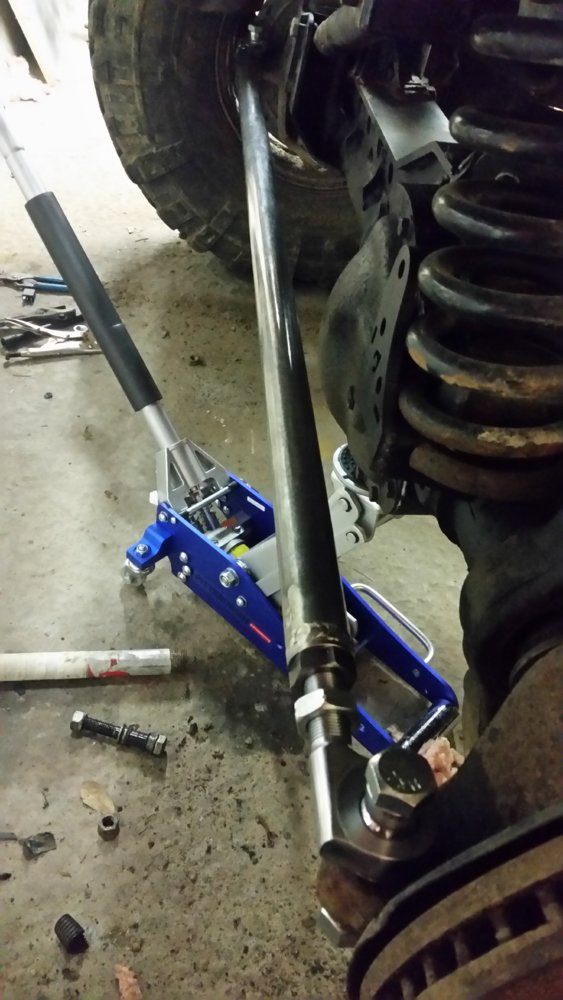

@Loganwayne it's close. I'm gonna have to grind some of the sway bar mounts off.

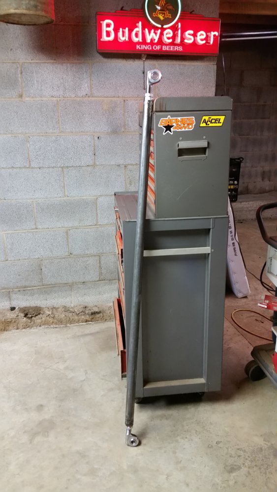

Dayum. Me gusta. That's 1.5" OD tube? Drill the knuckles to 3/4" or 7/8"?
Sway bars on this whip? o_O
no sway bars on this turd.
I drilled the drivers side knuckle to 3/4. The hole in the pass knuckle is huge...I'm going to put 3/4 weld washers on both knuckles. It's 1.5 .25 wall tube for the tie rod.

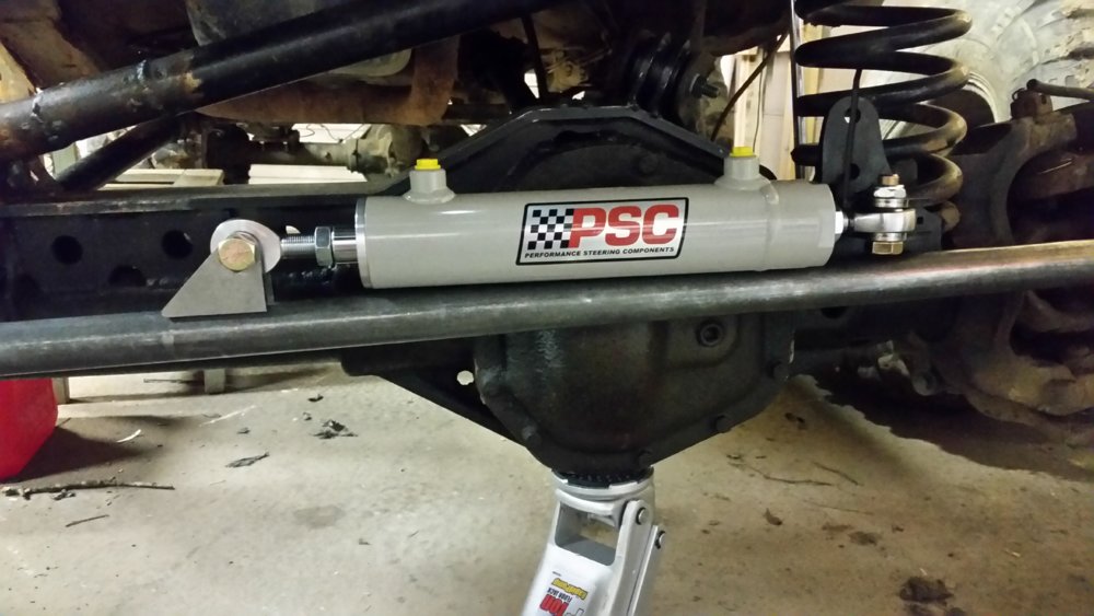

Not sure on the ram location yet
Weaver fab makes tapered inserts for the passenger side knuckle I believe to solve the giant hole issue if you are looking for a more solid fix.
I'm interested to see how the reservoir is going to work out. That is the main reason I went from a single ended ram to a double ended.

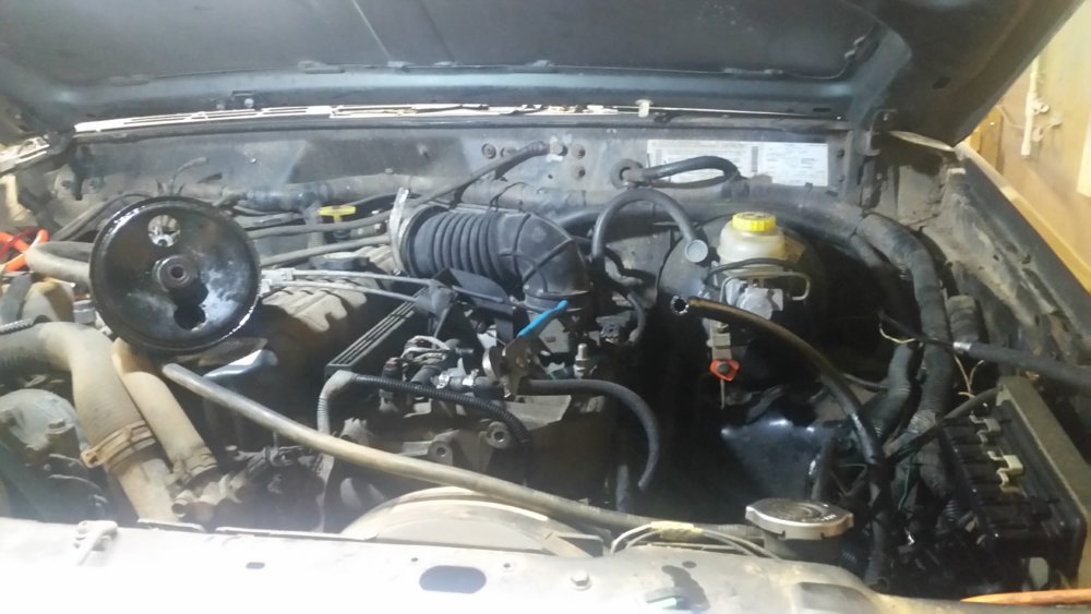

I removed the steering box last night and cut all the extra bracketry off the new column. My goal by Friday night is to get the column/orbital mounted so I can measure for the hoses.
So are you doing a single ram full hydro?

When I was going to run a stock pump I was just going to pick up a late 80's 4 cyl s10 power steering pump. It bolts in and has a factory remote reservoir.
That said, I just ponied up and bought the 180 buck psc pump.
From what I've read. The v8 WJ has the best stock TC style pump
The main diffrenence between the wj pumps and others is the intake fitting. You can drill any tc power steering pump to the same flow...
So what you're saying is....All TC pumps are created equal the fitting on the high pressure side dictates flow and pressure? What year s-10 pump?
Basically... but the intake is a big difference. That is where the aftermarket pumps vary bigtime with stock pumps. The WJ pump has a much larger intake fitting.
I'm going to O Riley's this afternoon. I'll compare a few of them.
