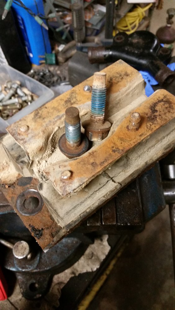

A decade of sending it put a hurting on this trans mount. The rubber part is still in tack but 3 studs were broken off and the other was loose.
Both bolts that held the mount to the trans had roughly a gallon of blue locktite on them. The half in drive breaker bar was flexing.
I found one in a Dodge 1500 for $76 at my local pull a part. Bolted right up to the AX15.

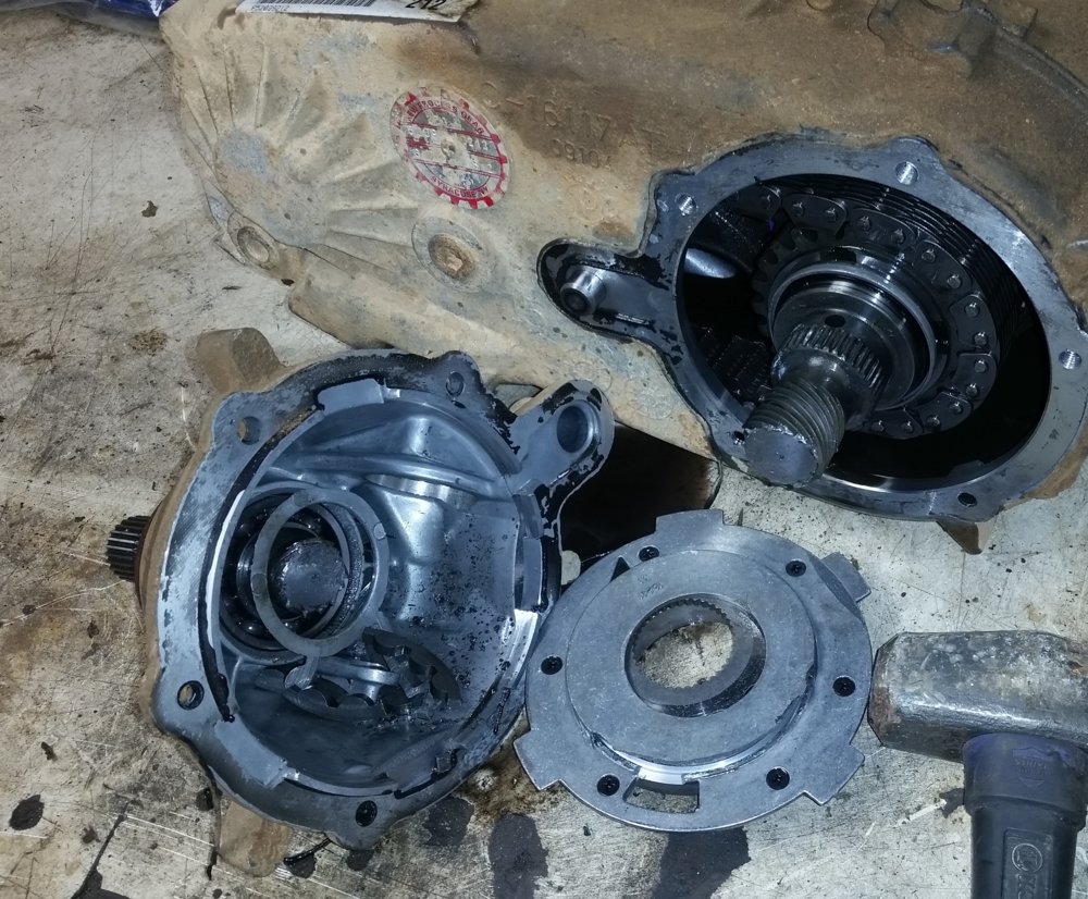

I pulled the t case today to inspect the damage. Broken output, tail housing, gear inside the tail section.
Nice! Did you swap in a 241 or just put a new tail shaft in?

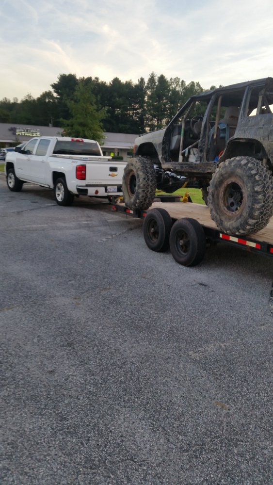

Jeep took a solid hit at the shop a few weeks ago. I forgot about this
