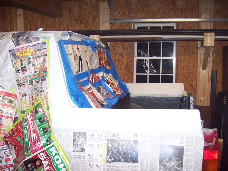

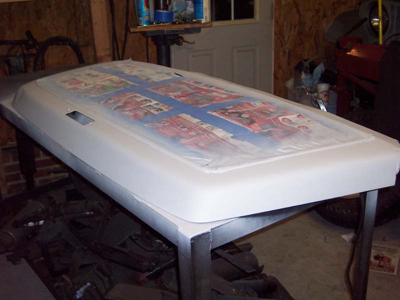

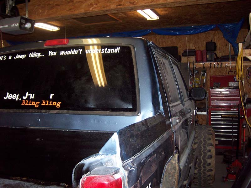

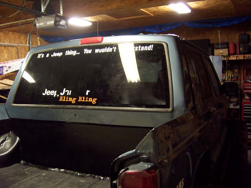

Well here are some updates :)
Great news is we got it DONE in 7 days

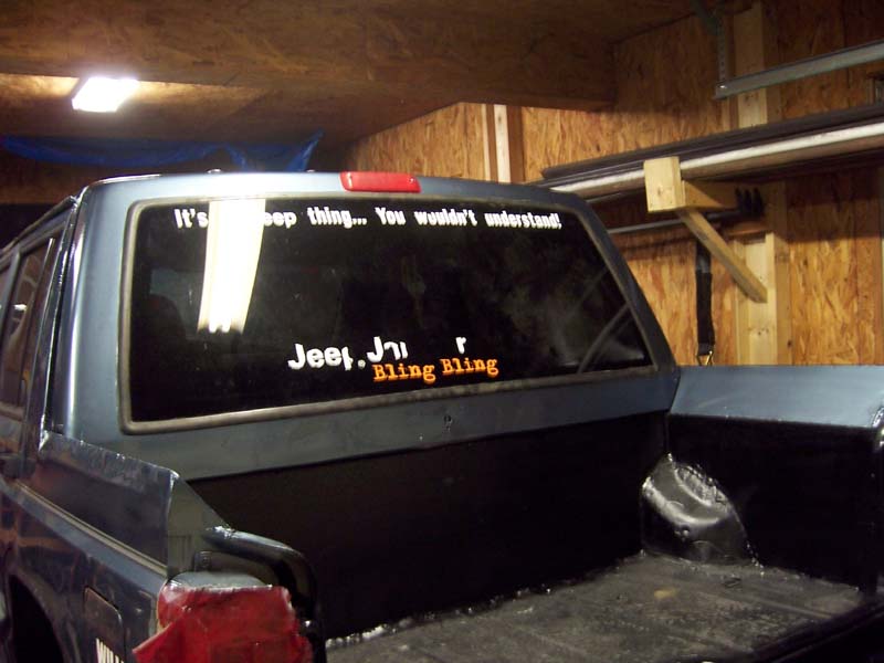

yup it is all back together..

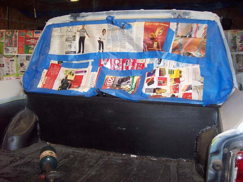

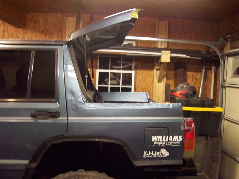

Back hatch opens, closes, locks, has struts to hold it open..
it came out very well and I am very happy with a 7 day deadline..
here is a shot video showing how it works..

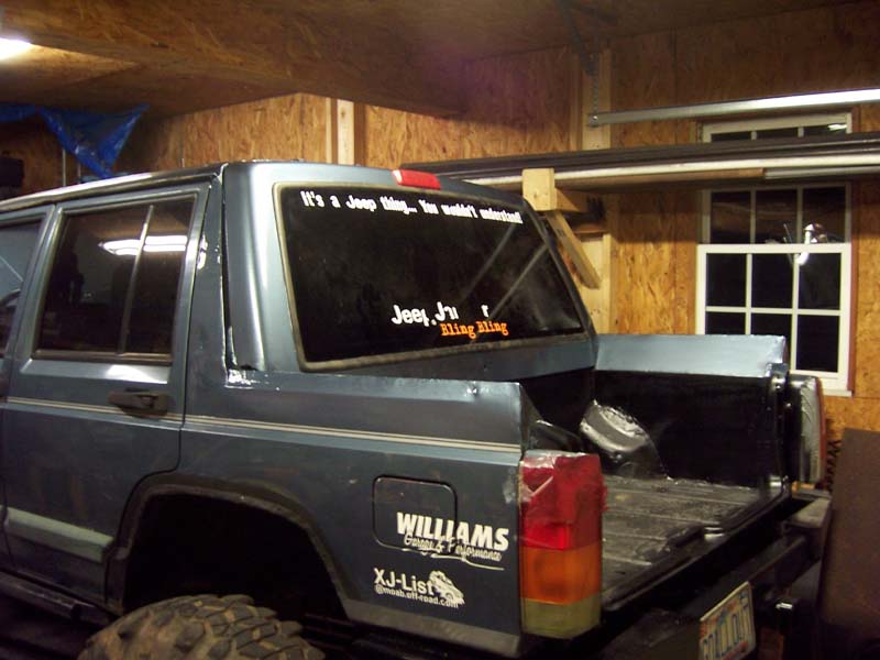

we reused the original latch and lock from the tailgate so it locks and unlocks..
I still need to get unlock mechanism to work.. but atleast for now I can reach inside and just unlock it by hand

Awesome Work. What lift gates did you use? Were they the factory ones?
I reused all the stock stuff to save money..
it was alot of work making the original lock/latch, struts, etc to work.. but in the long run I think it is well worth it.
I still need to get a better spring to help release the rear hatch.. but what I have will work for now.

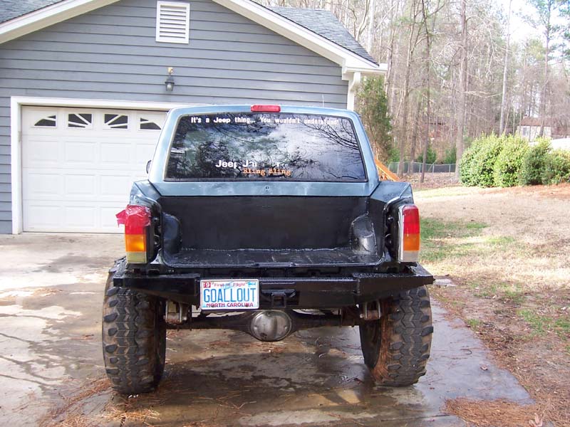

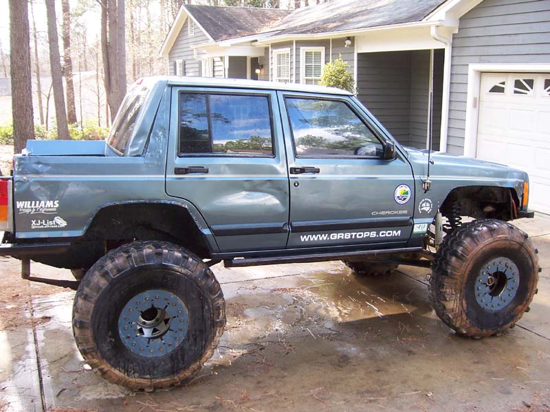

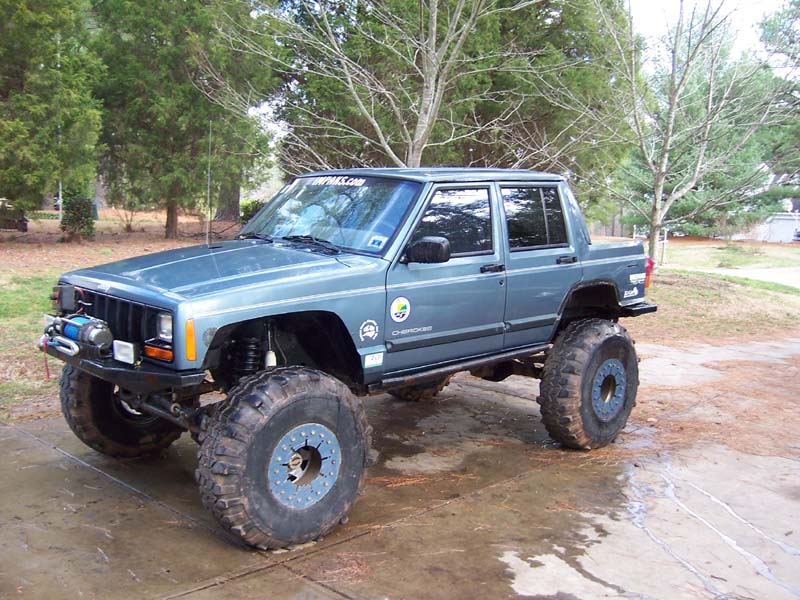

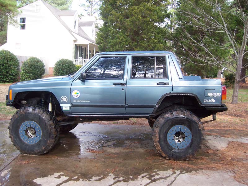

Well Drove it out of shop today
Here are finished " for now" pics
you can see I did not fix all the dents on passenger side..i figured they would probably get smashed again
I normally don't like te cjop tops on these but for some reason I really like this one. Did you fab that front bumper up yourself? It's alot like what I am thinking about making.
looks awesome Ken... have you thought bout kinda openin the rear wheelwell up and flippin the rear springs, to be a better departure angle?
ya know I have had folks suggest that to me and also suggest to fix my shackle angle on the rear springs.. but my setup works.. so i figured why mess up a good thing
so for now it all stays

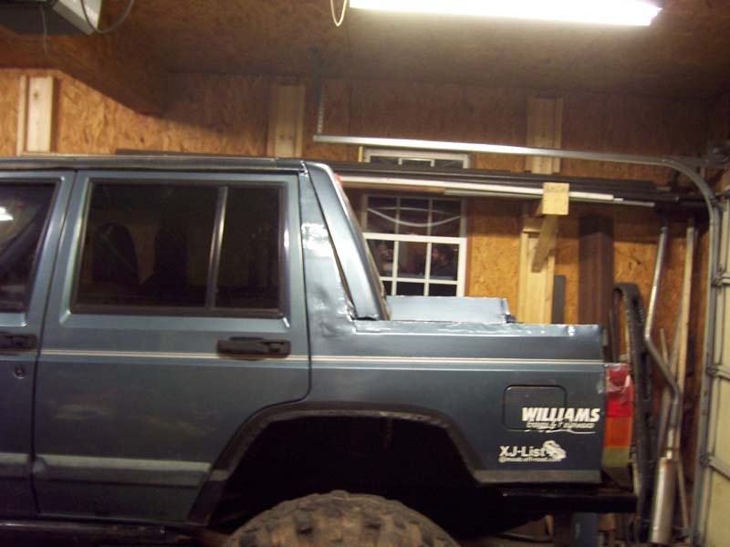

we took the part that normally bolts to the uni-body, and welded it to the hatch. the latch was moved inside to the half wall, we made some tabs for it to bolt to.
Most of the factory trim can be reused, with some modification. With the seat up it will look stock.
I will try to get some inside pics this weekend.. I get home to late during the week to get any decent pics
