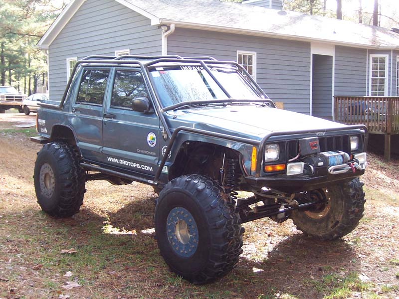

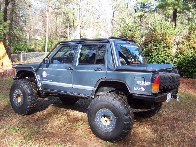

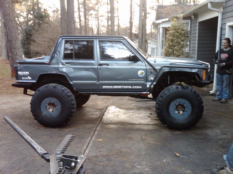

Chop top XJ..with Exo cage... End to an Era..

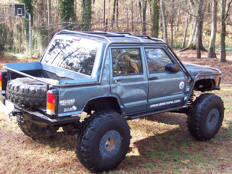

Always liked the chopped out rear. Been wanting to do that to the ZJ, but I doubt I'll ever get to that project.
I had thoughts of trying to fit the whole lift gate in the back like you did with your half lift gate.
Very nice!

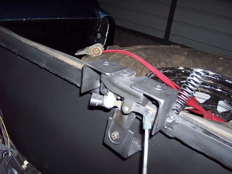

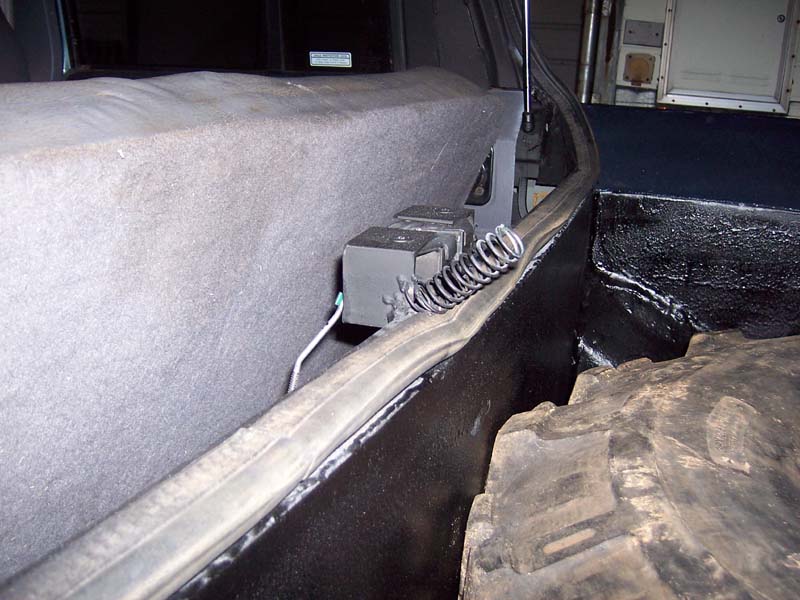

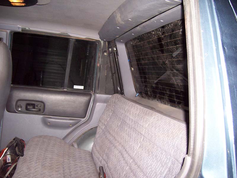

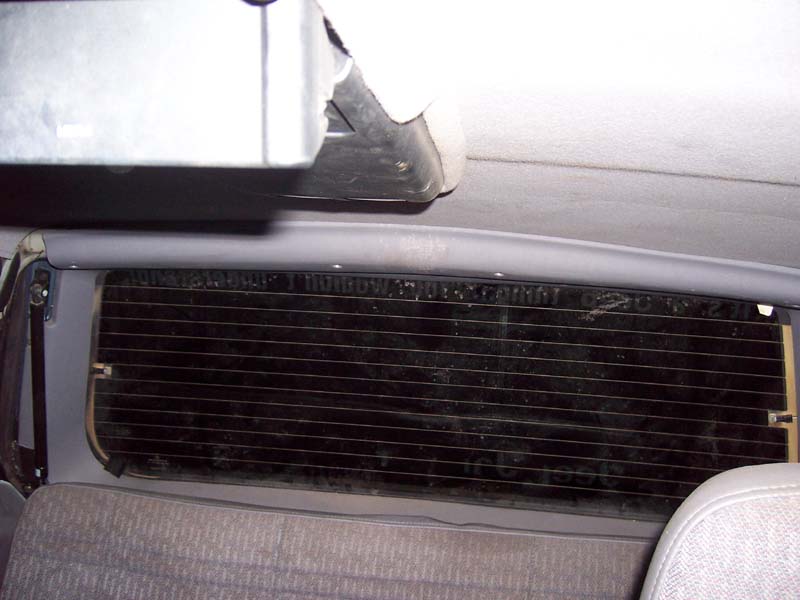

here are 2 pics showing the lock inside the tailgate
and her are 2 pics of the inside.. you can see I did not get all the inside panels screwed back in, but they all fit except for 2..
Hmm.... i can't remember... aren't the shoulder seatbelt mounts on that C-pillar? Did you have to take tthem out?
It looks good. Now let's see some action shots. :)
oh trust me I want to go.. but I guess I will be a responsible dad for a little while :)
well they actually mounted to the roof behind the c pillar.. when i put the cage in I will be attaching them to the cage with tabs.. so they will go back in and work.. but for now the center one still works :)
maybe a fold down tailgate with integrated tailights? might not be enough room if you plan on keeping a full spare though..
or a swing away samurai style and put the spare on that.
just an idea...looks great as is

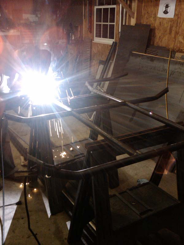

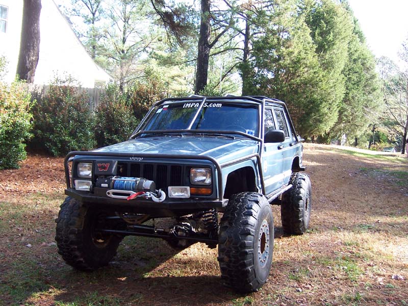

Well I am back at it.. :)

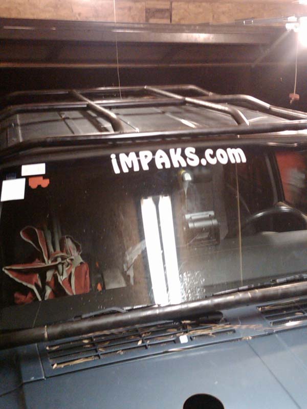

Jph0913 and myself spent 3 hrs thursday, and then today jph0913, thegriz, thecarman, bsrober, and myself spent about 9 hrs and we got almost my entire exo cage done..
we need to finish weld the top cross bars in, the bottom windsheild bar, and then make a bar for windshielf from top to bottom.. then after I get some new suspension seats I will be adding the B pillar support inside the cab.
I will get better pics once I get my camera over there.. but here are a few from my cell phone.
nice. looks really good. keep the pics coming!:beer:

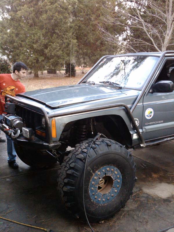

well I hope to get it all painted up tomorrow.. so if I get the time I will get some better pics also..
getting ready to do mine but I dont think the gf will get me dom tube for xmas. hopfully will get enough money to do it. i really like the roof design!!:beer:

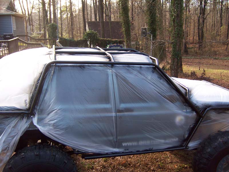

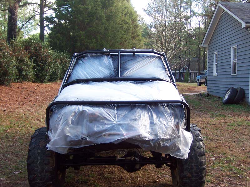

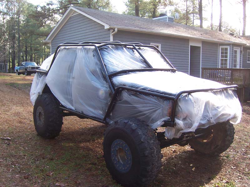

Well today we got everything welded up and then painted it.. no pics of it without plastic, as it got to dark
here are a few pics:
me welding on hood
before paint
we rapped the jeep in plastic and then painted it.. I still need to do a little touch up in a few areas..
next is to get some suspension seats and make a "B" pillar support bar inside the cab
Looks great, how do you plan on mounting the new seats.
not 100% sure yet..
1st is to try to get concrete floor done in shop, then buy seats and figure all that out :)
Looking great man.
Just a thought. Do you think there is enough support for the corner above the rear wheels. Thought about running a bar around the rear wheel well to help with bracing?
