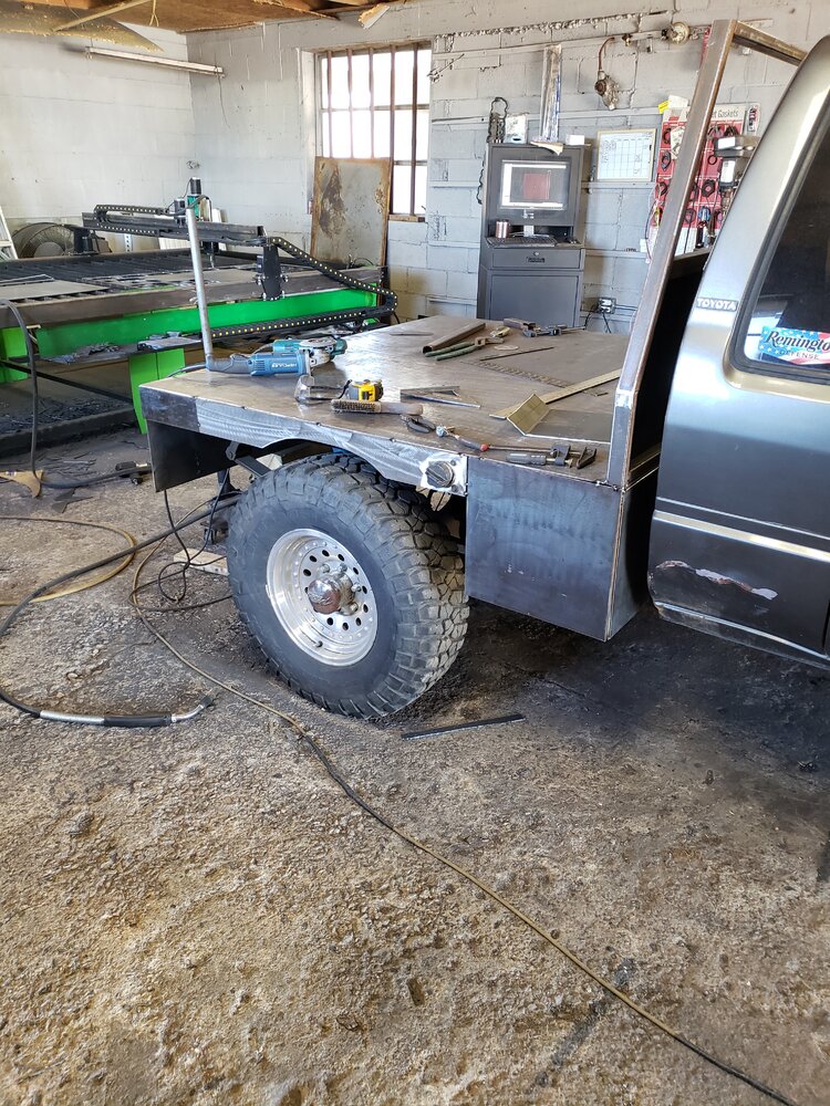

Just thought about this Friday when i went back to get material to build this toyota flatbed.

Toyota flatbed coming along..most peace and joy I've had in days

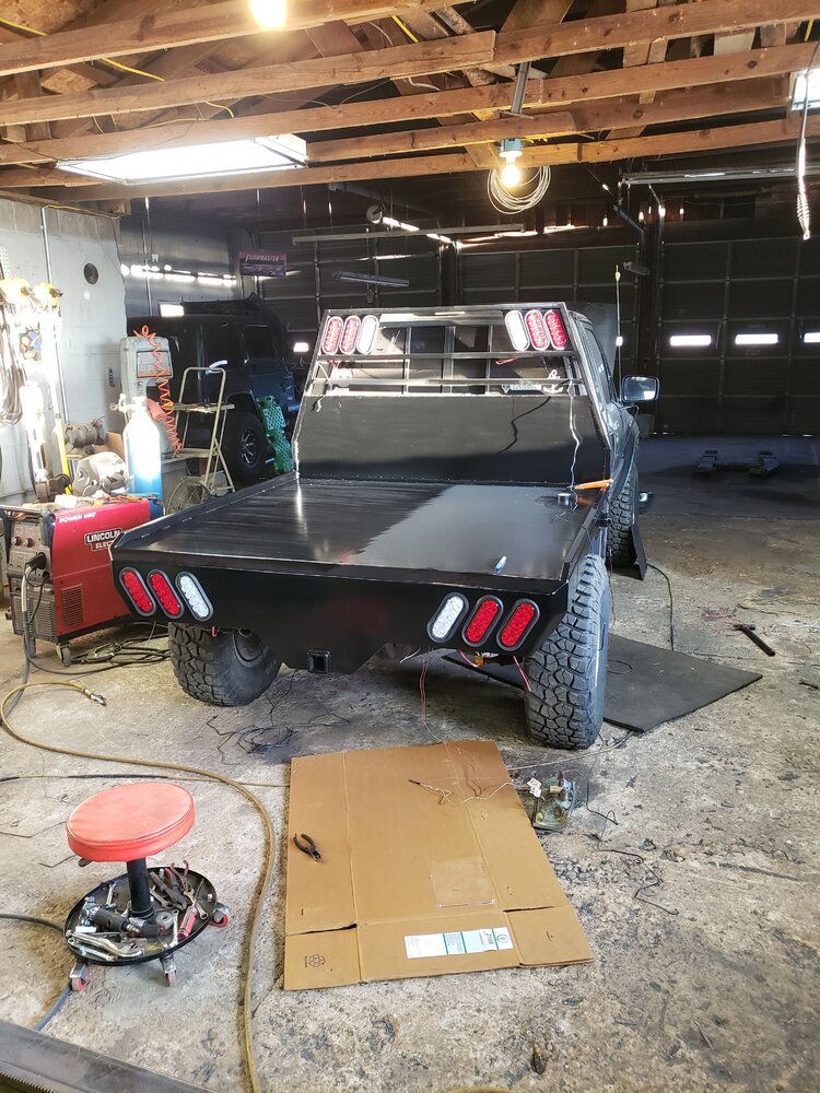

Almost done
Curious on the gauge of material and amount of frame work under the bed? No usable tie down points or stake pockets? Is the head ache rack through to the frame or surface mounted to the skin of the floor? Sprayed with rattle cans?
2" square galvanized tubing for box frame. 10g for the bed and bumper. Tool boxes 14g, headache rack 14g tying down to the frame of bed with 1x1.5 14g tubing. It's just for looks he wanted. Rattle can for now, he's getting the entire truck repainted soon so bed will get sprayed as well professionally
