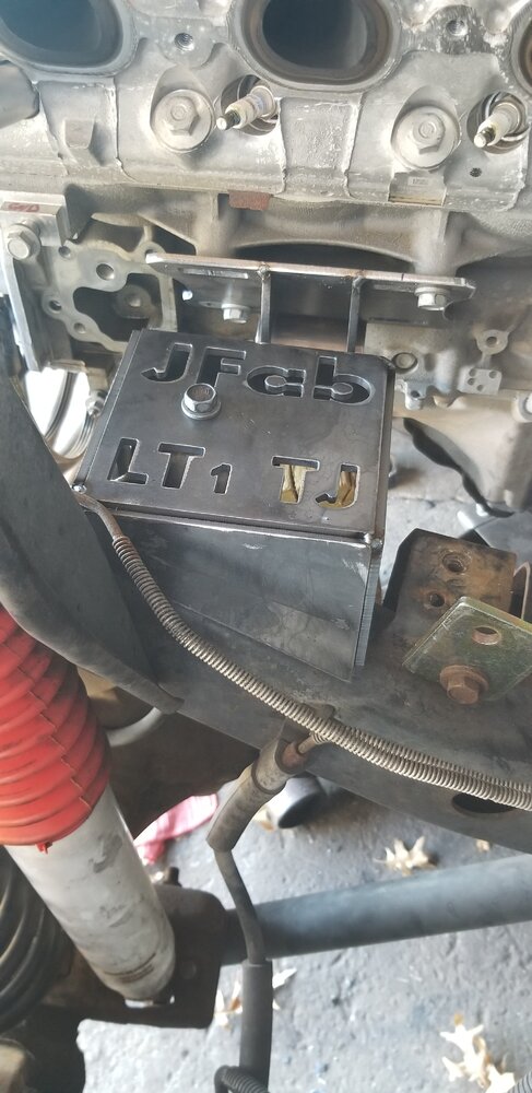

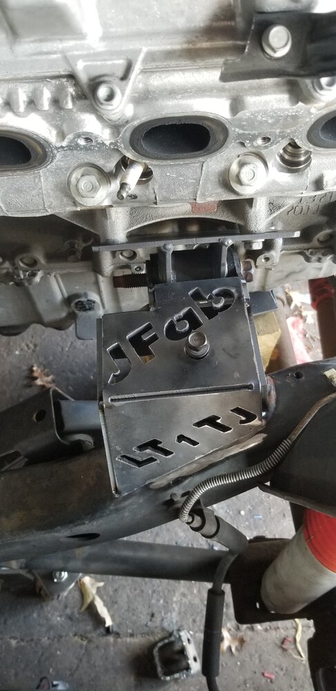

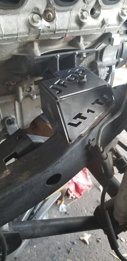

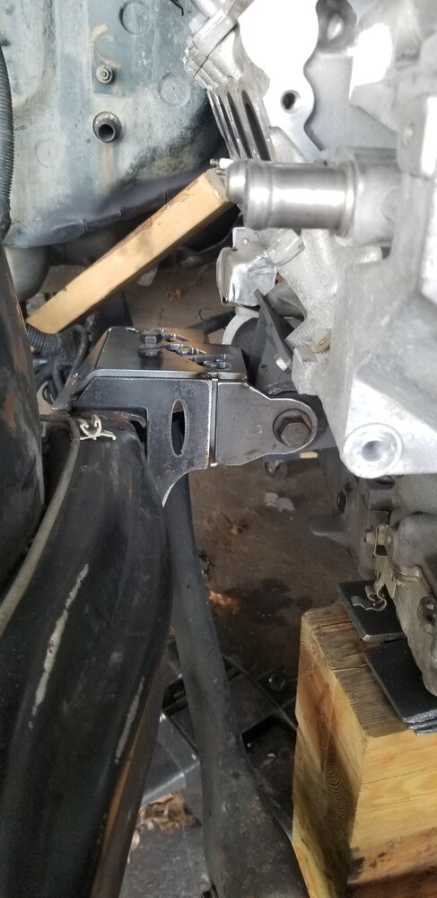

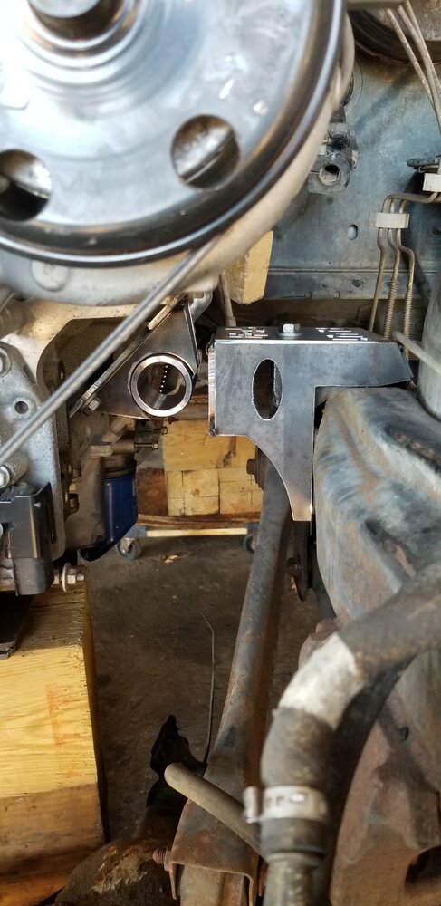

I don't know if they are the same. i will do some research to see i have several lt1 and ls motors sitting around to check.
Cool let me know, tomorrow I could draw up the LS block plate if its differentI don't know if they are the same. i will do some research to see i have several lt1 and ls motors sitting around to check.
Pretty sure it's just the block bolt holes orientation but might be wrong. (Thought I've read this somewhere awhile back)Quick look on advance adapters they are differn't mounts for the lt1 and ls engines. Will do some more research.
That is what i am reading to.Pretty sure it's just the block bolt holes orientation but might be wrong. (Thought I've read this somewhere awhile back)
I think 1 hole is off lol been a few months since I did the first LS swap but I swear I remember 1 hole being off like .5" or somethingThat is what i am reading to.

Oh yeah 6cyl frame but I need to get measurements for the 4cyl frame and find out the LS 5.3 block dimensions tooAre those made to fit over a 4 cylinder frame or 6 cylinder frame motor mounts?
They're very obvious though of what side is which..no way they fit any other way. They look similar but are totally differentFor grins and giggles (and because the general population is lazy and a little...stupid) I'd either cut a D/P or L/R in each mount to make sure they know which one goes where. You can never assume they know what they're doing![]()
5.3ls or L83? I need to find out the difference in the LS 5.3 block holes and any other difference. (Pretty sure only 2 holes are off but I believe the 5.3 blocks are same otherwise)Pm me a price on the mounts that will work on the 5.3 motors.
I am very aware of that and you're aware of that, but I've seen people cut up brand new parts and try to install them backwards. If nothing else, just take a paint pen and write on them and type up/print out some quick and simple instructions. It's that kind of attention to detail that make people tell other people about stuff they bought...and keeps them from contacting you to bitch about things because they're stupidThey're very obvious though of what side is which..no way they fit any other way. They look similar but are totally different
Sounds like a Gen IV LS to me. To the best of my knowledge, the mounting holes are the same as a Gen III. Gen V is where things change up.The one i am using is in a 2010 chevy pu 4x4 if that helps i can get the vin tomorrow and run it to see wich motor is has in it.
correct but I'm pretty certain all I need to do is change the mounting holes on the block plate and everything else will line up since I've read (if I understood properly) that the blocks themselves are same length and such, just different holes.Just did a quick search seem like the l83 started in 2014 to 2019 so i would say mine isn;t a l83.
