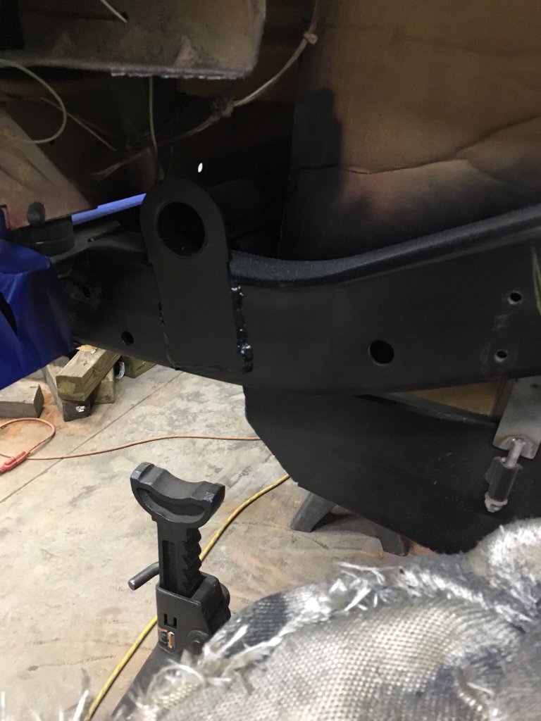

I have run and many others have run this exact same setup for years with no issues.. Maybe the ones having issues cant weld very well..
It takes five minutes to plug weld them. It's a no-brainer for a fail-safe joint. It's best practice, and it results in a joint that's an order of magnitude stronger than without.
And yes, I have seen them tear out, and it breaks all kinds of shit when it goes. The driveshaft and the coilover shaft are the first to go.
Don't be a bitch about it. Just toss them in the drill press and fix it.

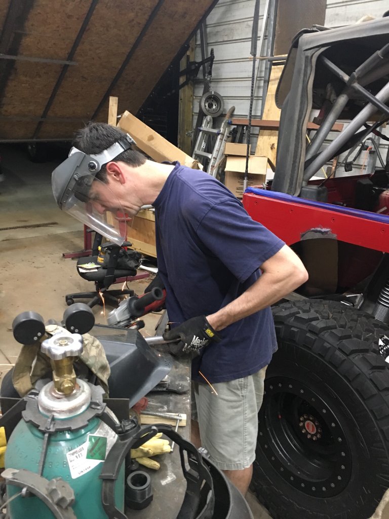

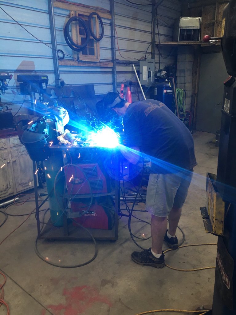

Do y'all always grind and weld in shorts and t-sleeve shirts? Do you put sunscreen on? Etc....

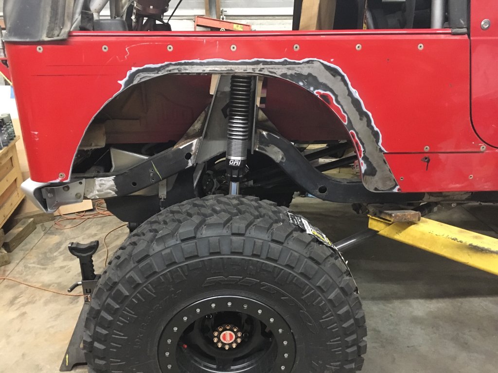

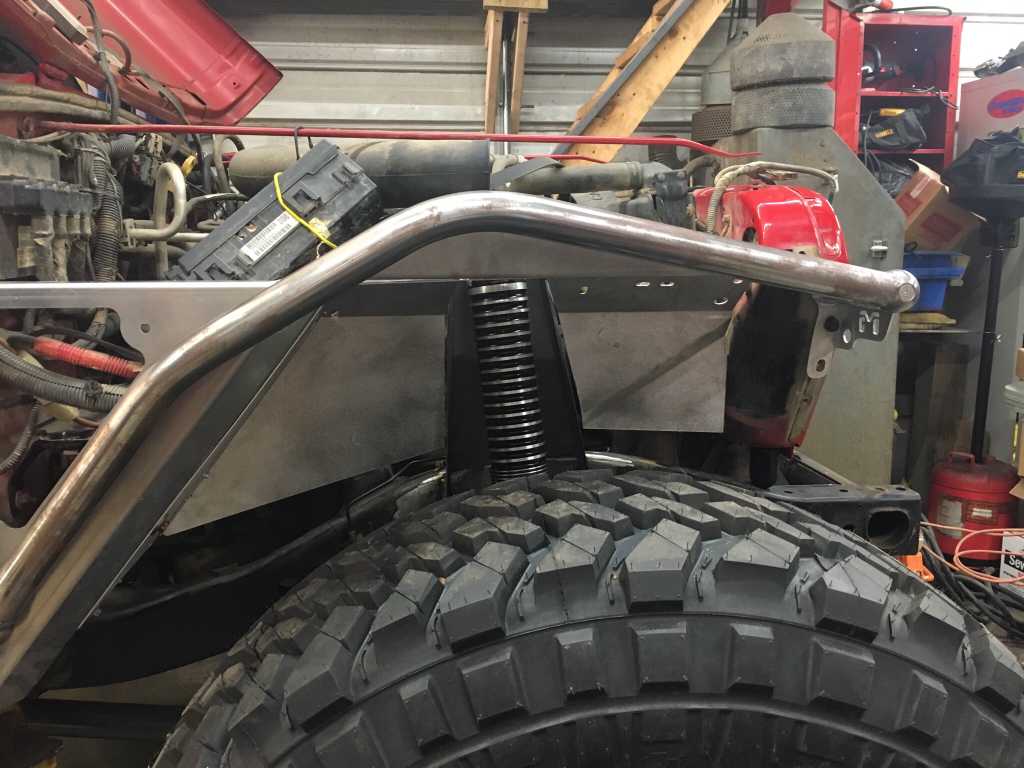

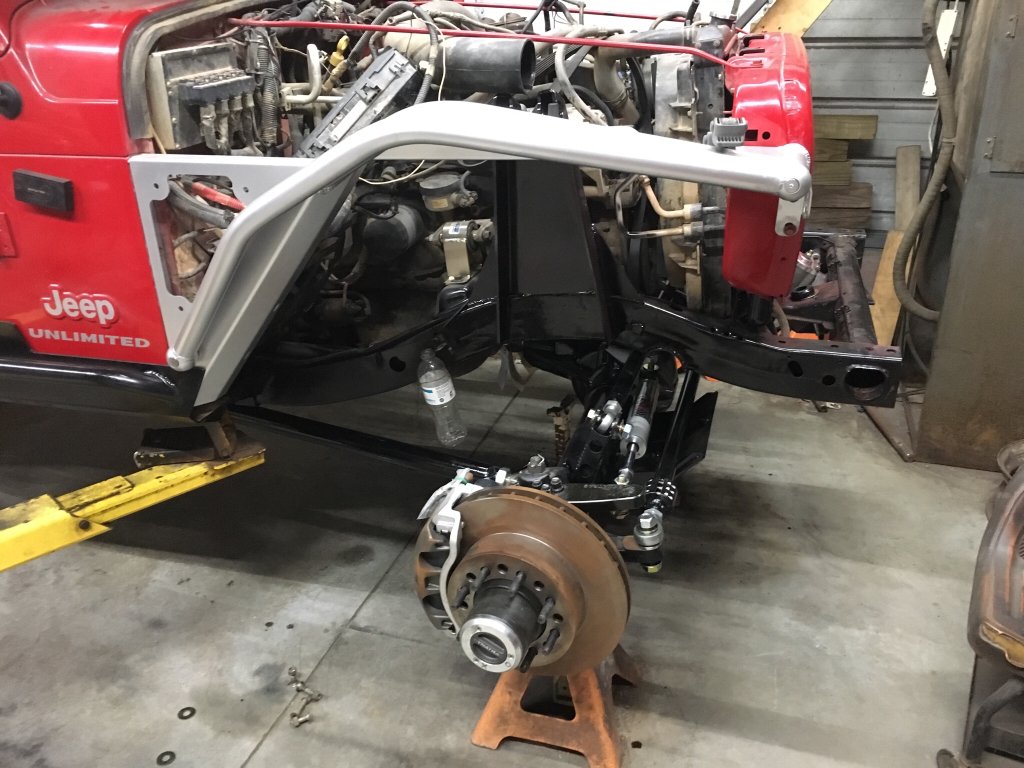

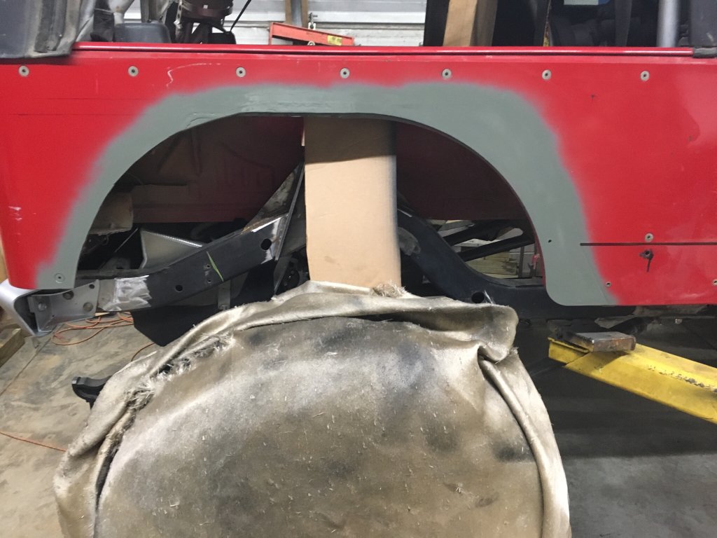

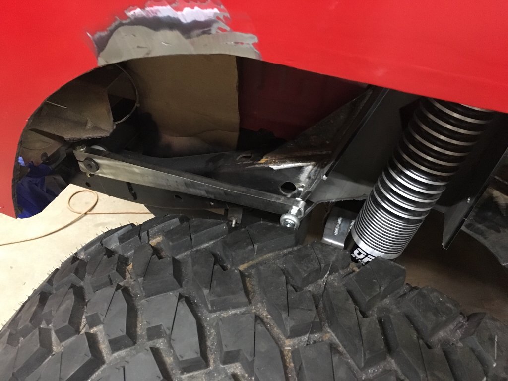

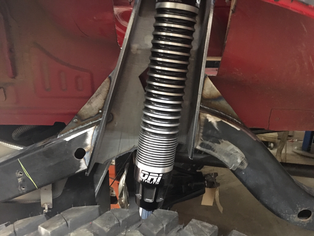

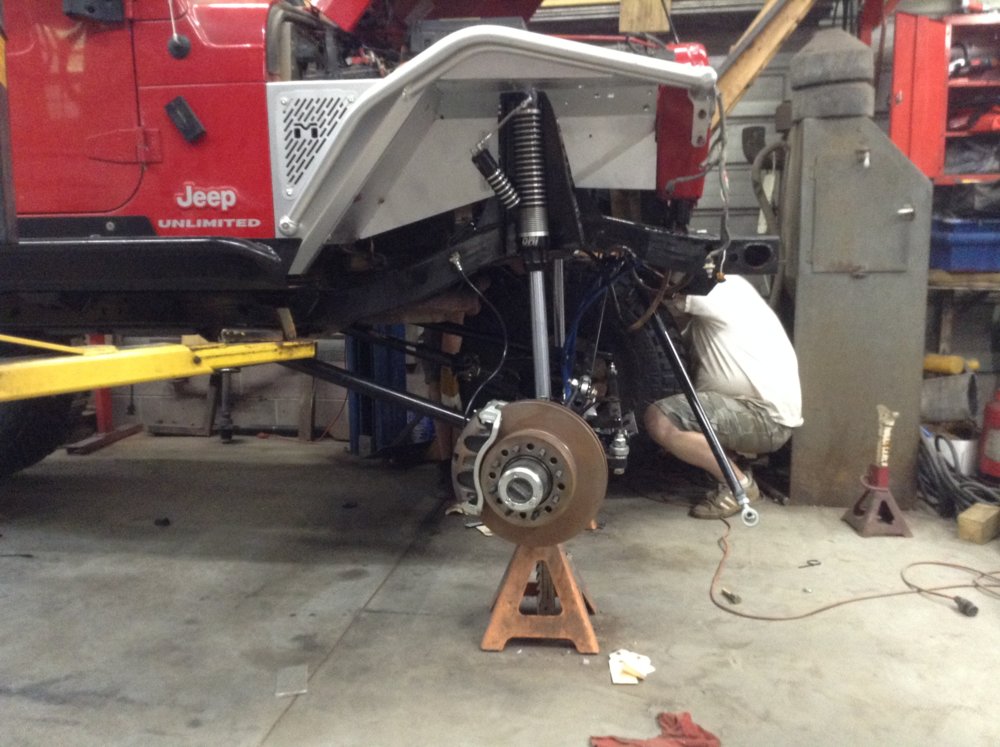

Front inner fenders done. Rear crusher corners done. Shock towers braced. ORI front reservoir mounted. And much more. It was a long very hot day.
Starting to get to all the smaller stuff. Little more fab and then we tear it apart paint it all

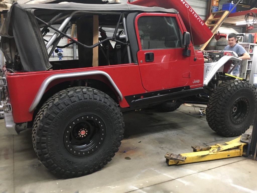

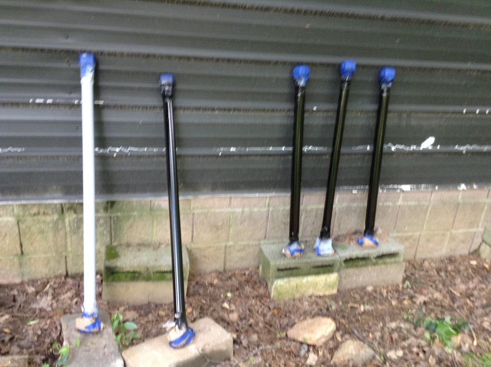

Progress continues. 95% welding done. Links painted and axles primed. Rock rails in.

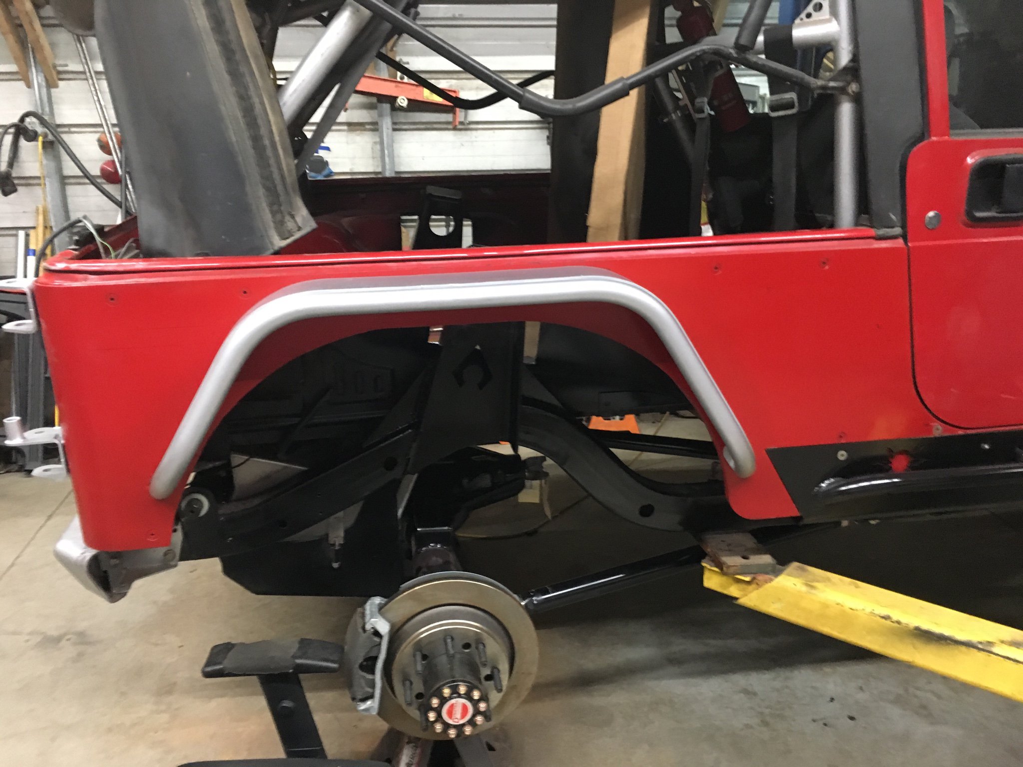

Final body work on rear fenders GenRight 4" aluminum bolt-on flares coming soon.

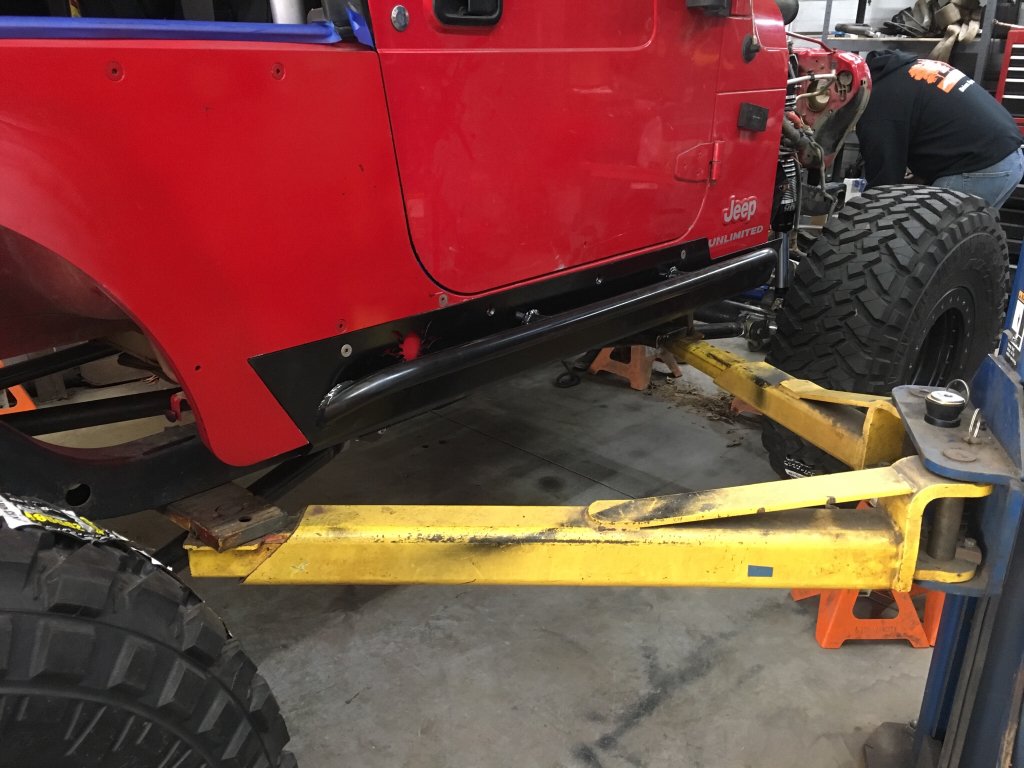

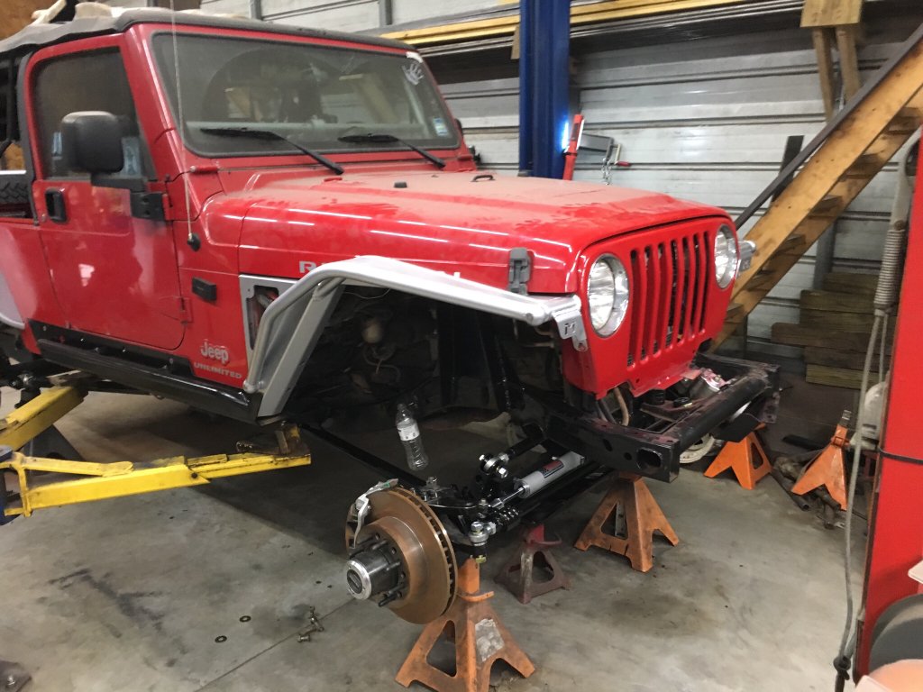

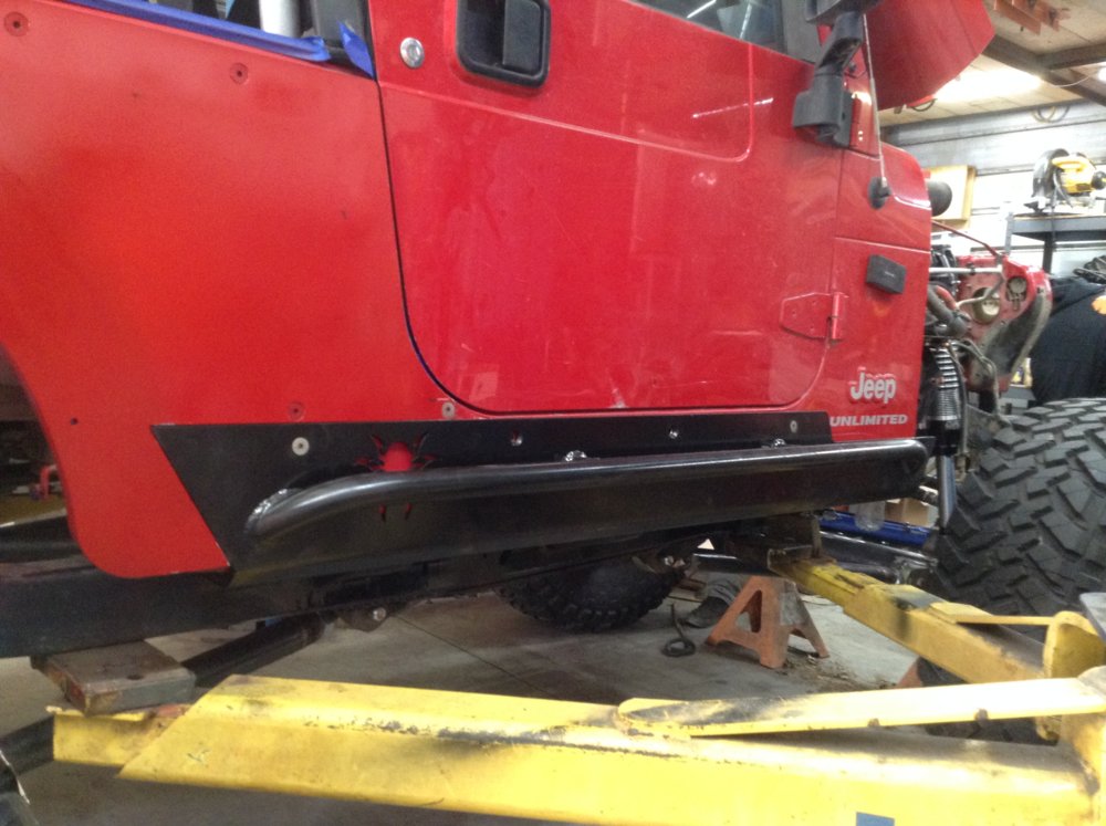

Ron making the final mods on the Poison Spyder Rock Sliders. The Metal Cloak front fenders required cutting the sliders.
Sliders installed.

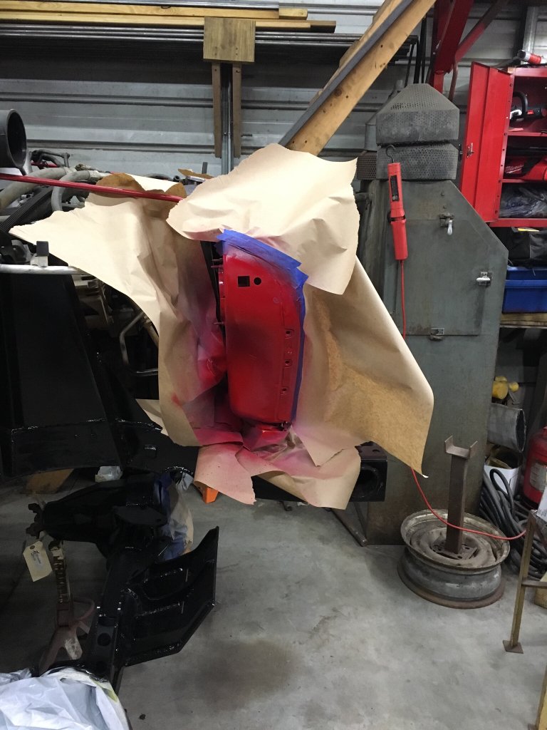

Stripping down the Jeep for final paint and install.

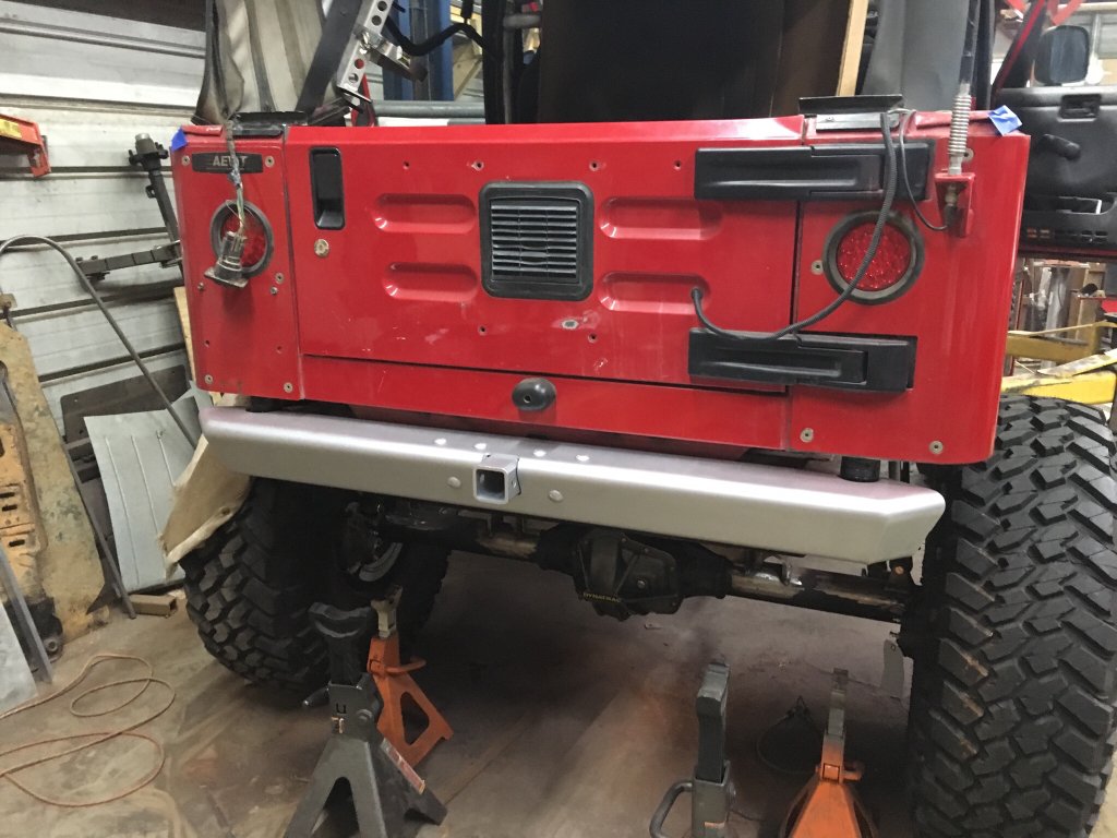

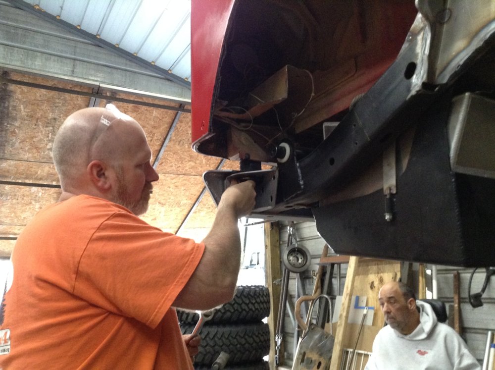

Ken installing the Savvy rear bumper braces.

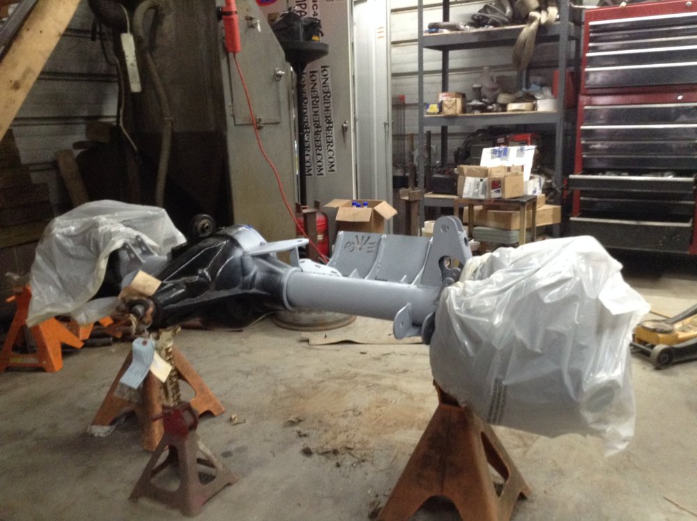

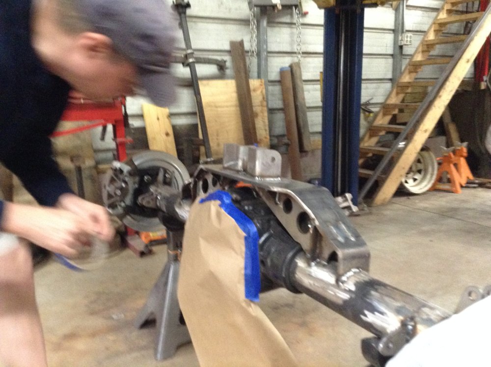

John prepping the rear DYNATRAC axle for paint.

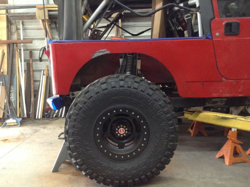

Rear fenders are aluminum and we had then stretched 2" so they fit the opening better.

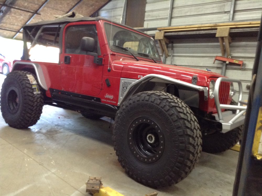

After a few long night and a full day today. We have a full roller.
If all goes well Jack will be taking this home next weekend.

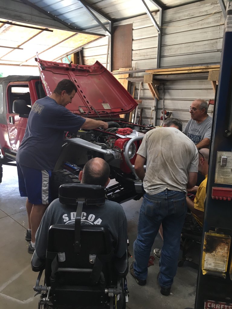

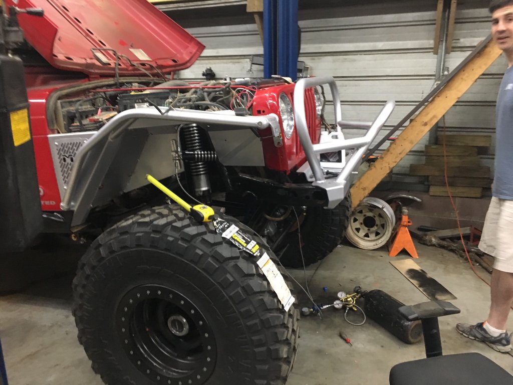

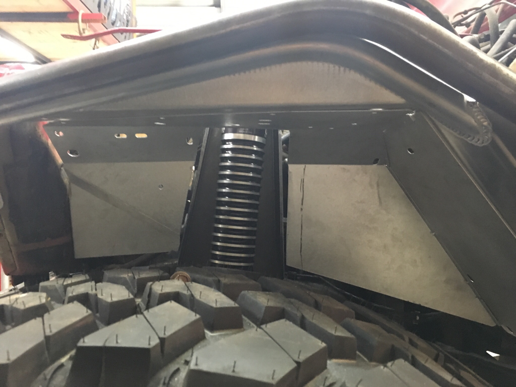

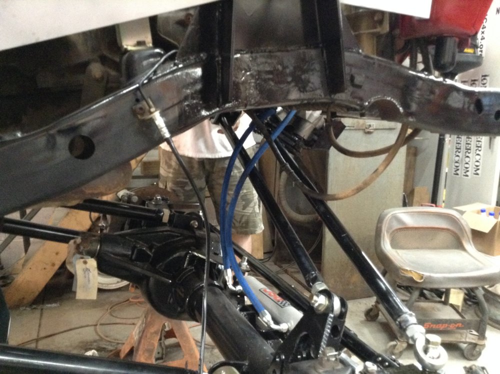

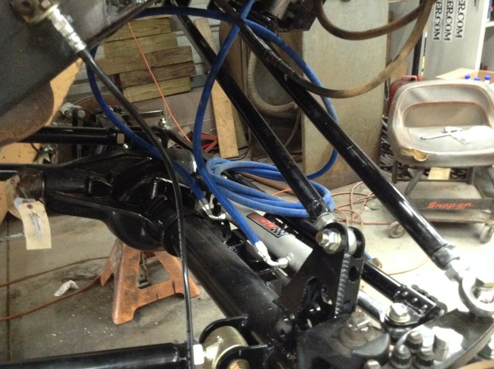

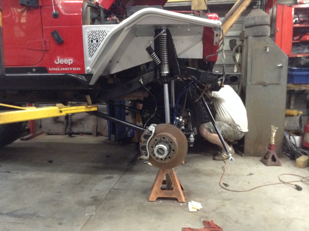

As Ken noted, last week and weekend were very productive. Several of the final parts were installed. The MetalCloak inner fenders and all the engine accessories were bolted in place. ECGS made the brake lines. The rear J.E. Reel 1350 driveshaft was installed along with some of the hydro-assist lines.
Here you can see the brake lines and ram-assist lines.
Lucas swapping front yokes and installing new driveshaft.
Lucas wiring the front blinker/running lights.

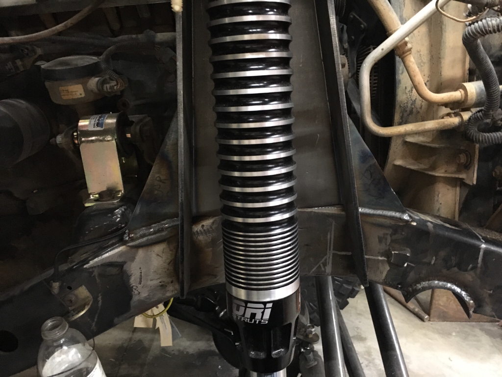

ORI installed, hopefully, for the last time!

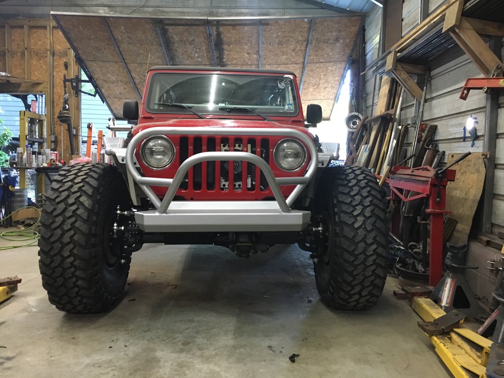

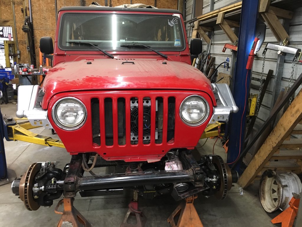

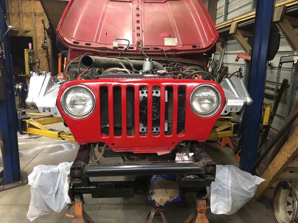

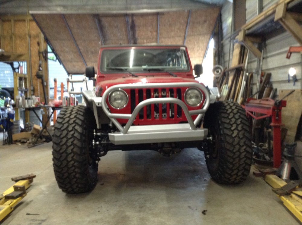

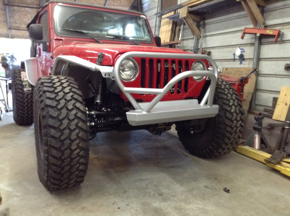

Tires and front bumper. Rolling once again. Not before John R. Reworked the evap canister in its new home.
Not visible in the pic, but Ken was able to mount the stock gas filler. Looks completely stock.

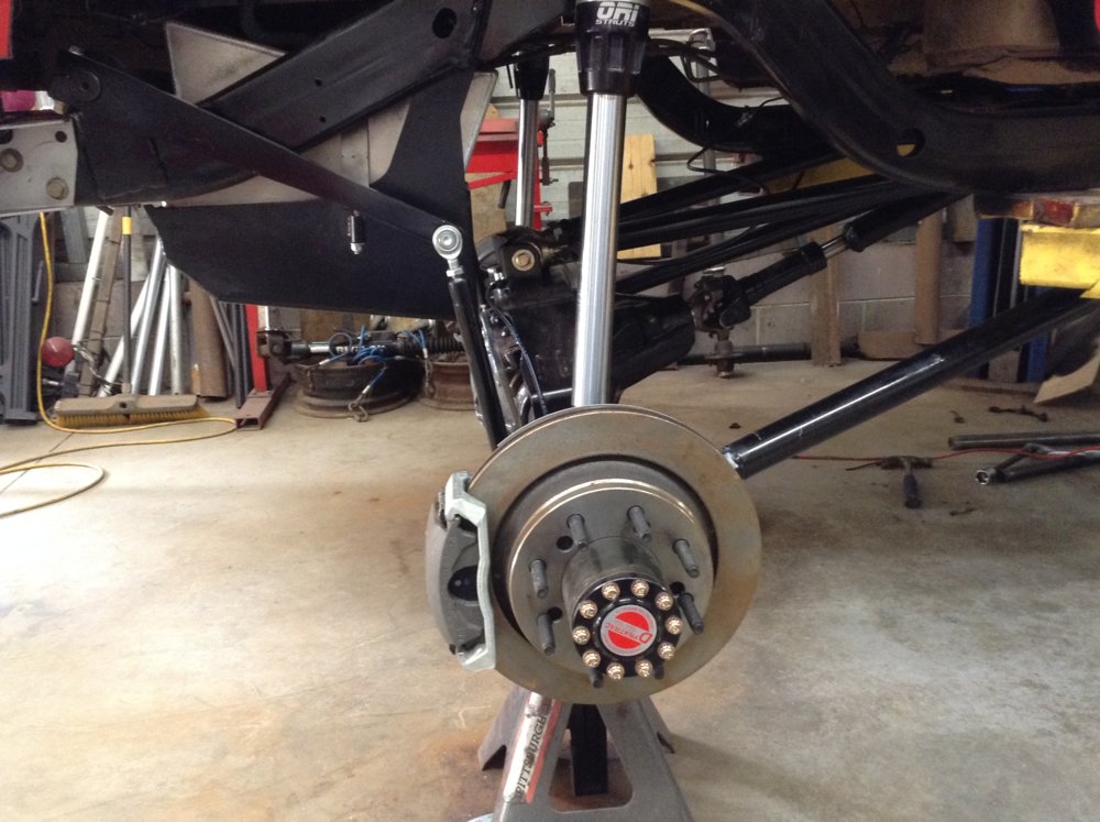

Sitting and rolling smoothly at full bump

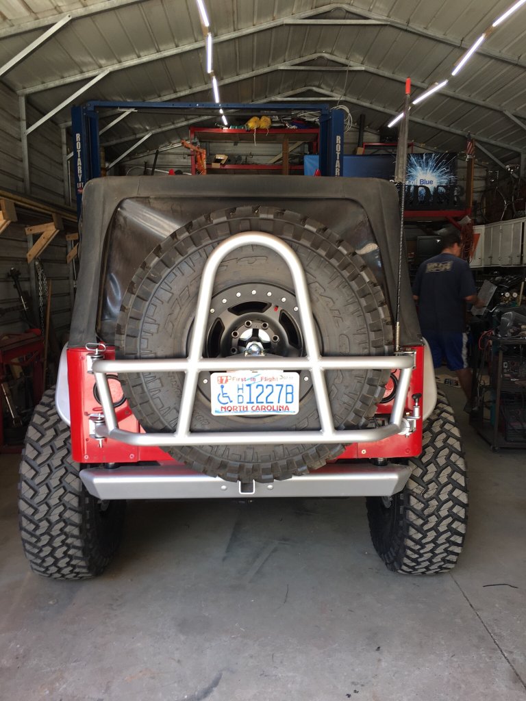

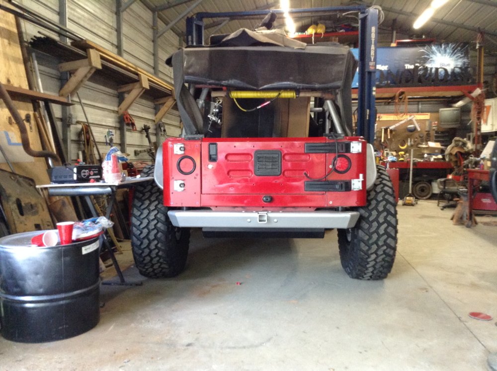

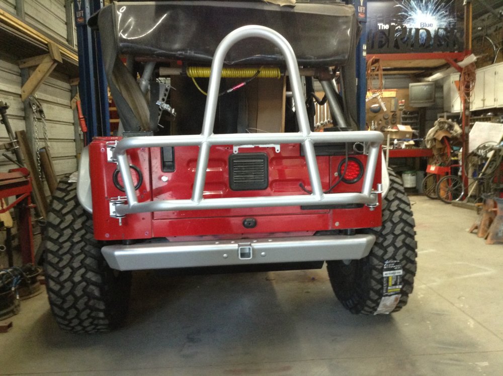

Rear GenRight tire carrier installed.

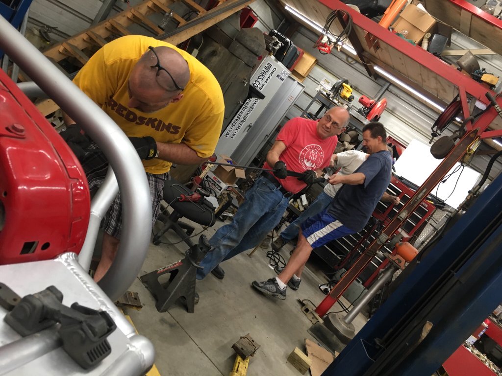

Last night was a long night. Craig aka:superman spent almost 5 hrs rewiring the metalcloak lights that were installed wrong. It was a complete pain in the rear but he got it done. (Please always read the directions)

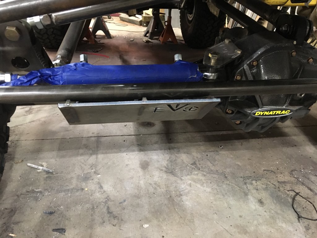

scott and myself got all steering lines made and installed and did the first run of bleeding the lines. And we put nitrogen in the ORI so it is at ride height.

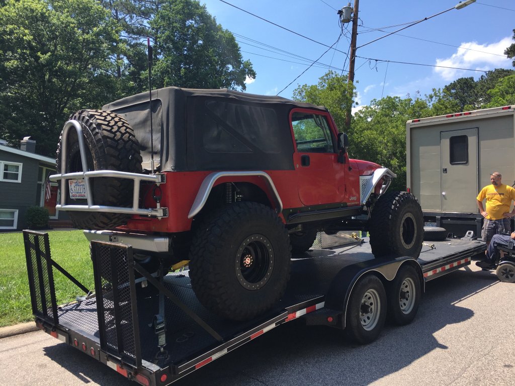

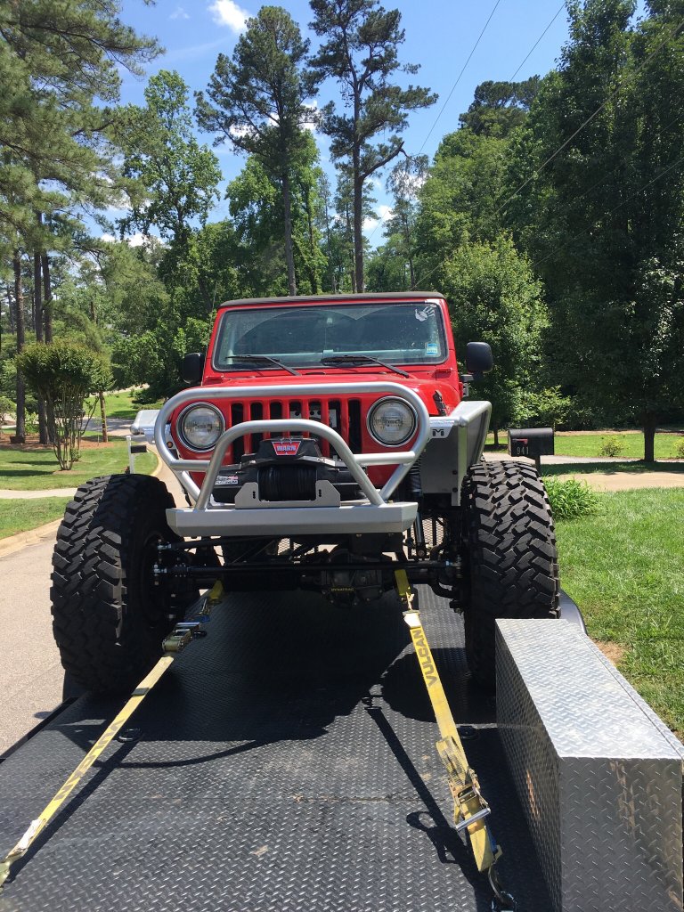

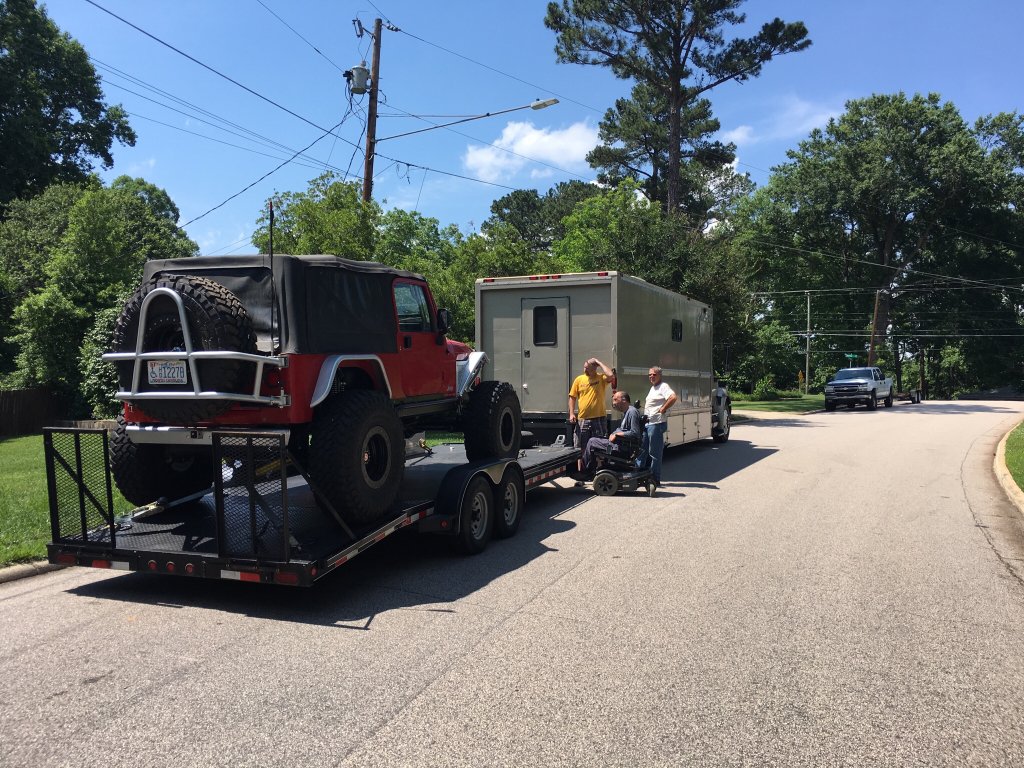

I am so proud to say the jeep is done and Jack took the jeep home today

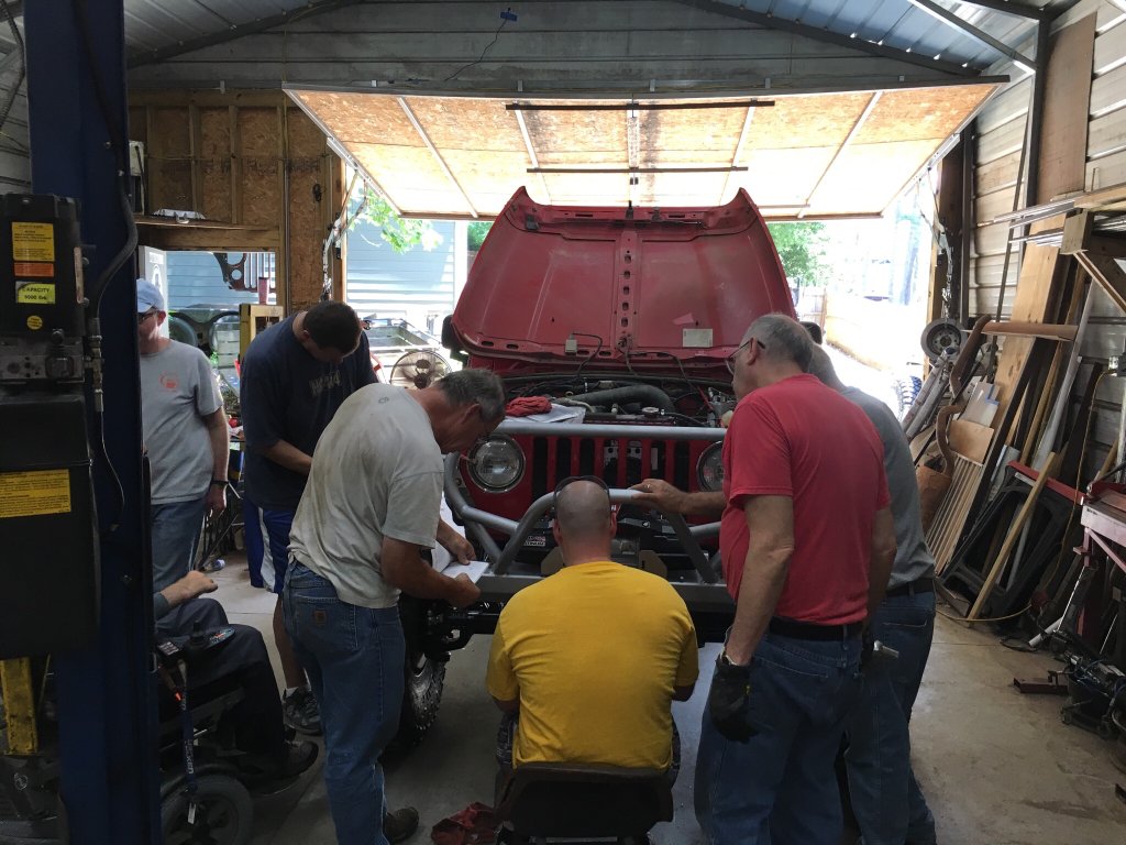

We got all brakes done , emergency brakes done , rear tire on, front bumper and winch on, and steering all working perfect. I was able to take the jeep around the neighborhood with no issues.
Thanks to all of those that helped make this possible.

Me driving it

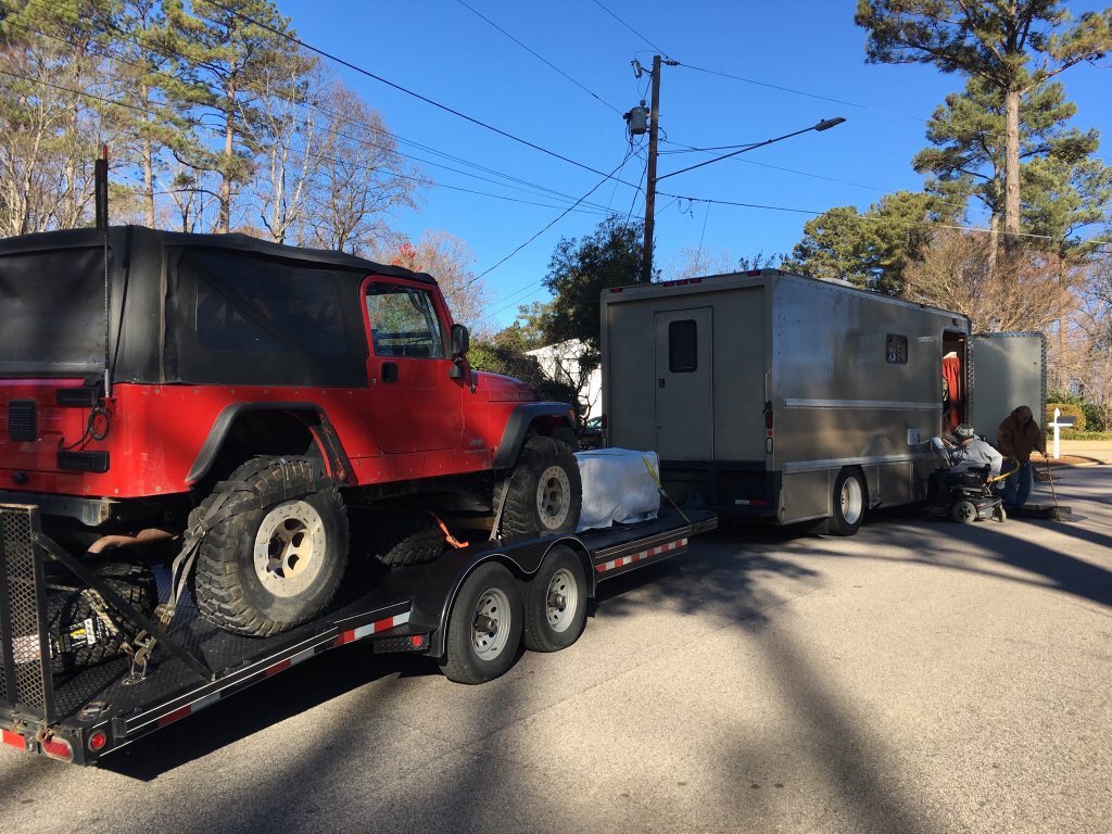

The day it arrived
They day it left
