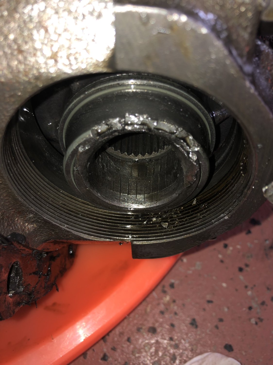

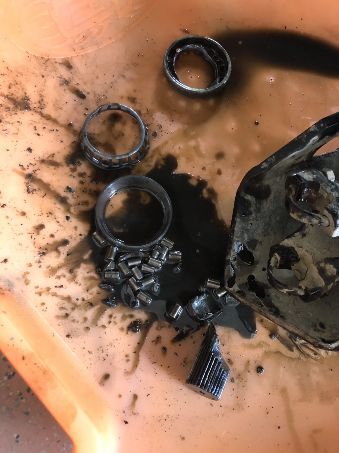

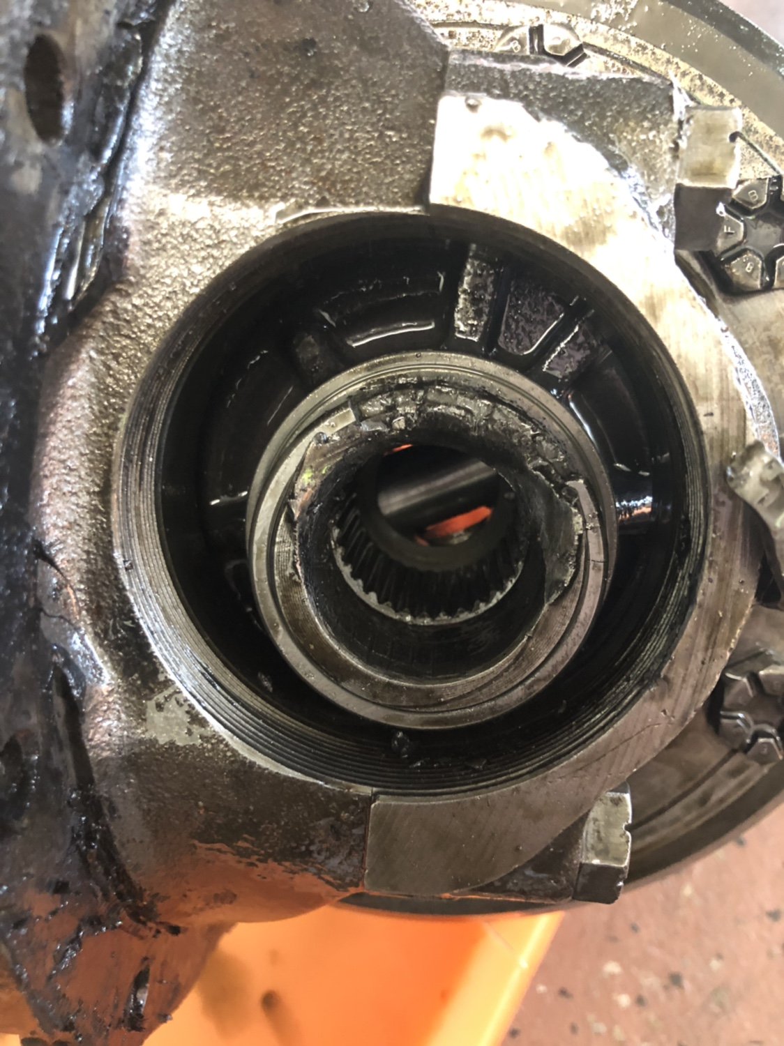

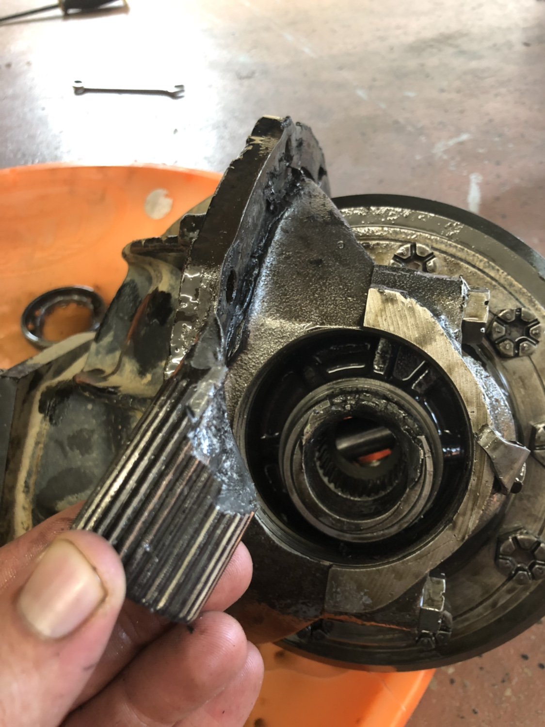

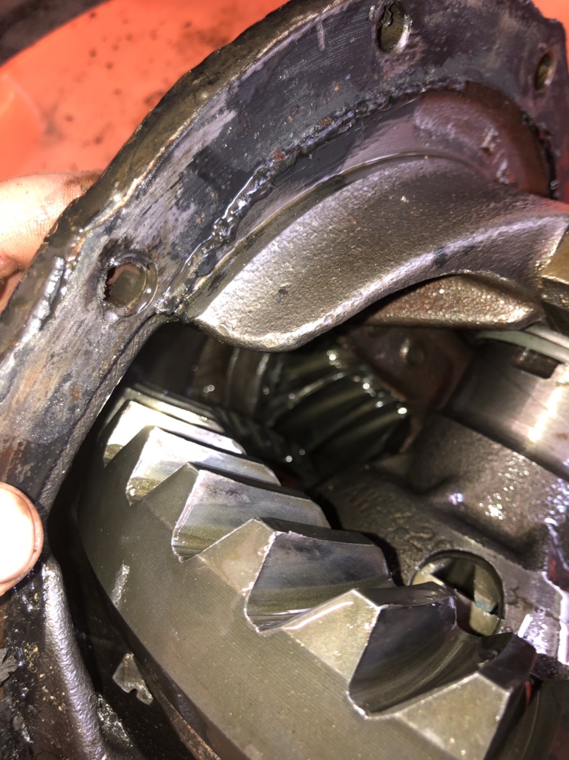

The 3rd member was not broken after all! When the shaft let go it took all of the bearings on the drivers side with it (not convinced that wasn’t an issue already). The bearing cage and adjuster got trashed along with the carrier. The carrier has some major scaring where it sits in the bearing so I doubt it can be saved. May need a new carrier.

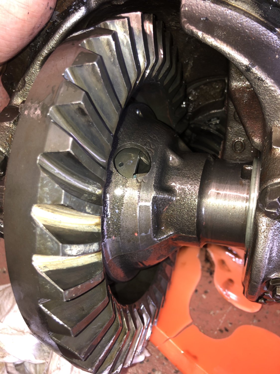

The pinion gear has some light, very minimal damage that literally happened backing into my garage. I’m just gonna send it with these gears (Treadway approved)
So you are saying your rear end survived after a shaft was broken off in it? It is still time for 1 tons...
