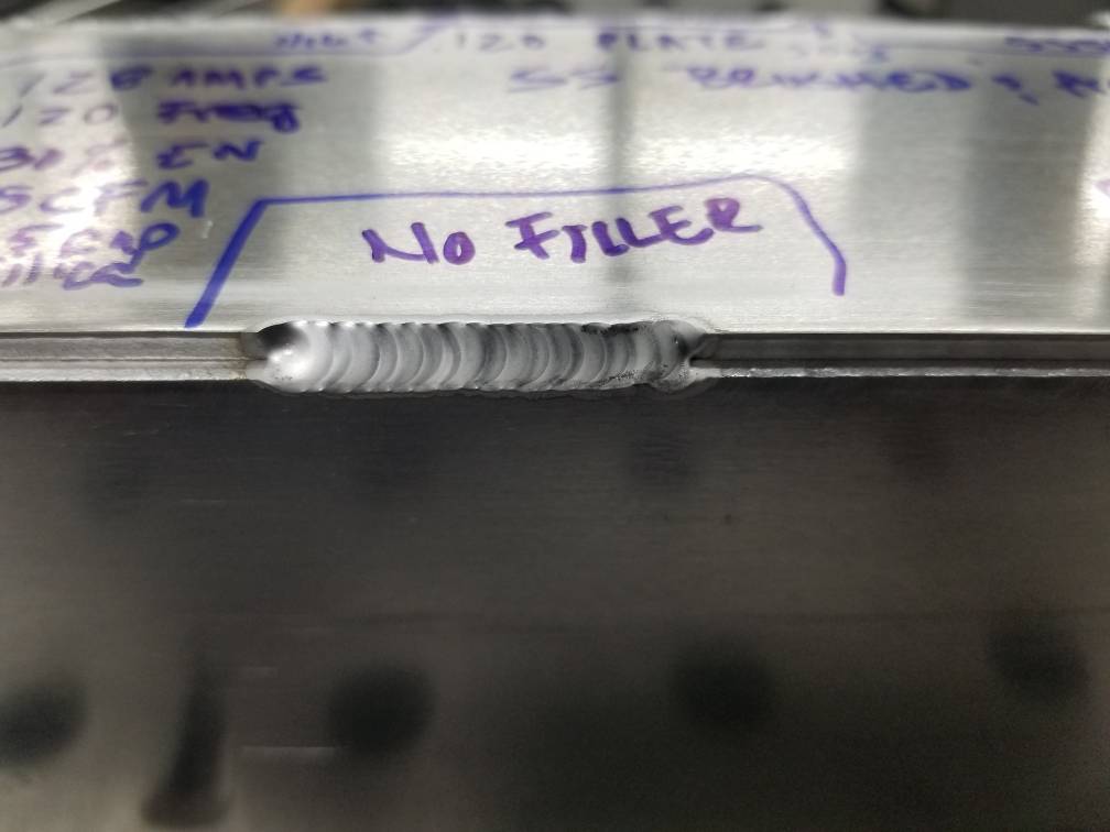

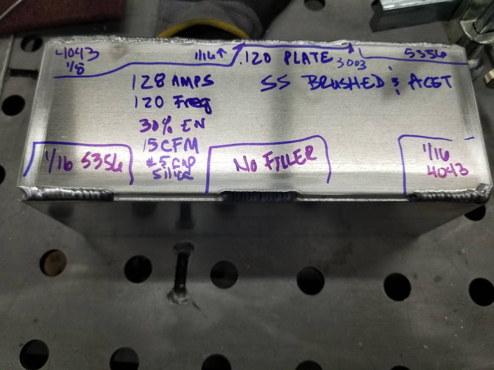

Been going along on aluminum for Sam's buggy.

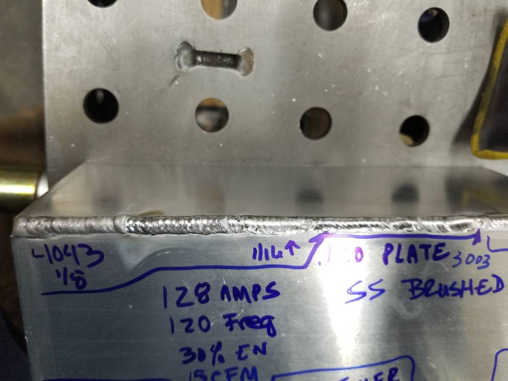

Getting the Everlast 250ex, tuned in to weld up the fuel cell.
Constantly learning and making steps towards being an all around proficient metal melter.

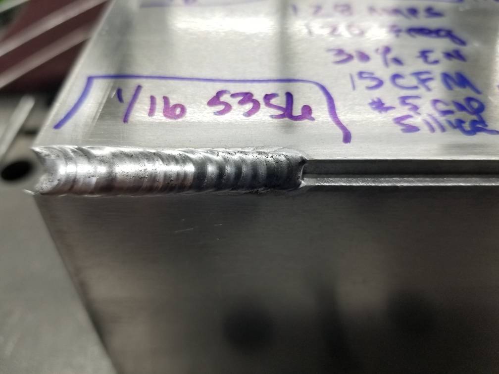

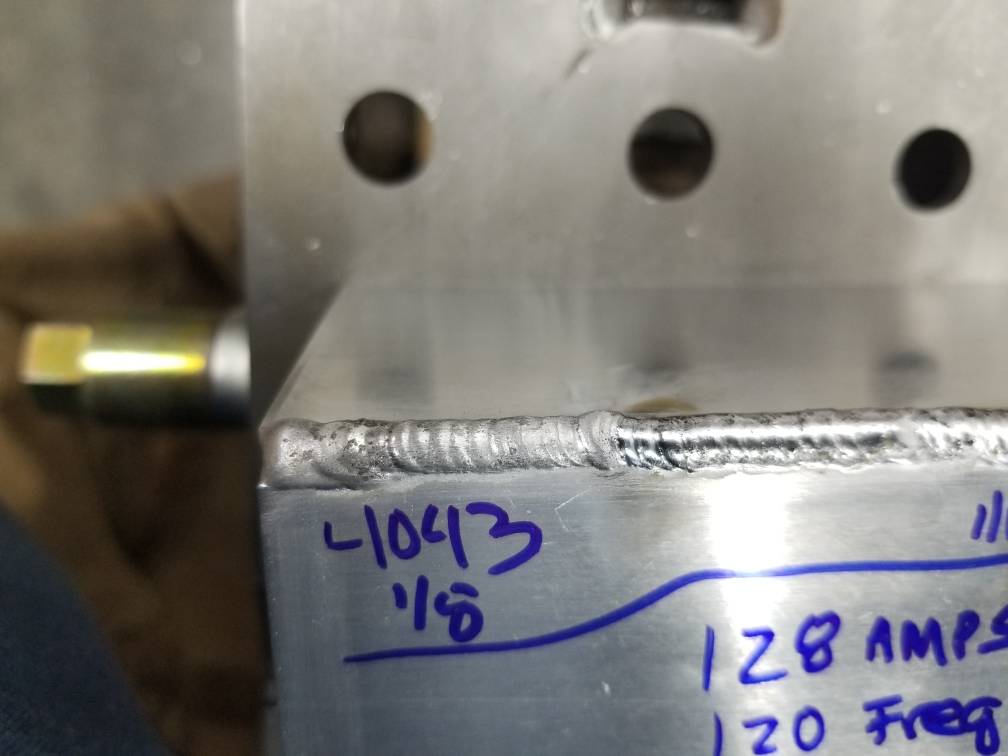

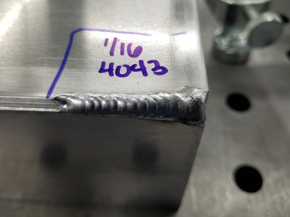

I was having some contamination and peppering issues... but got those worked out.
You can see the trash in the starts...

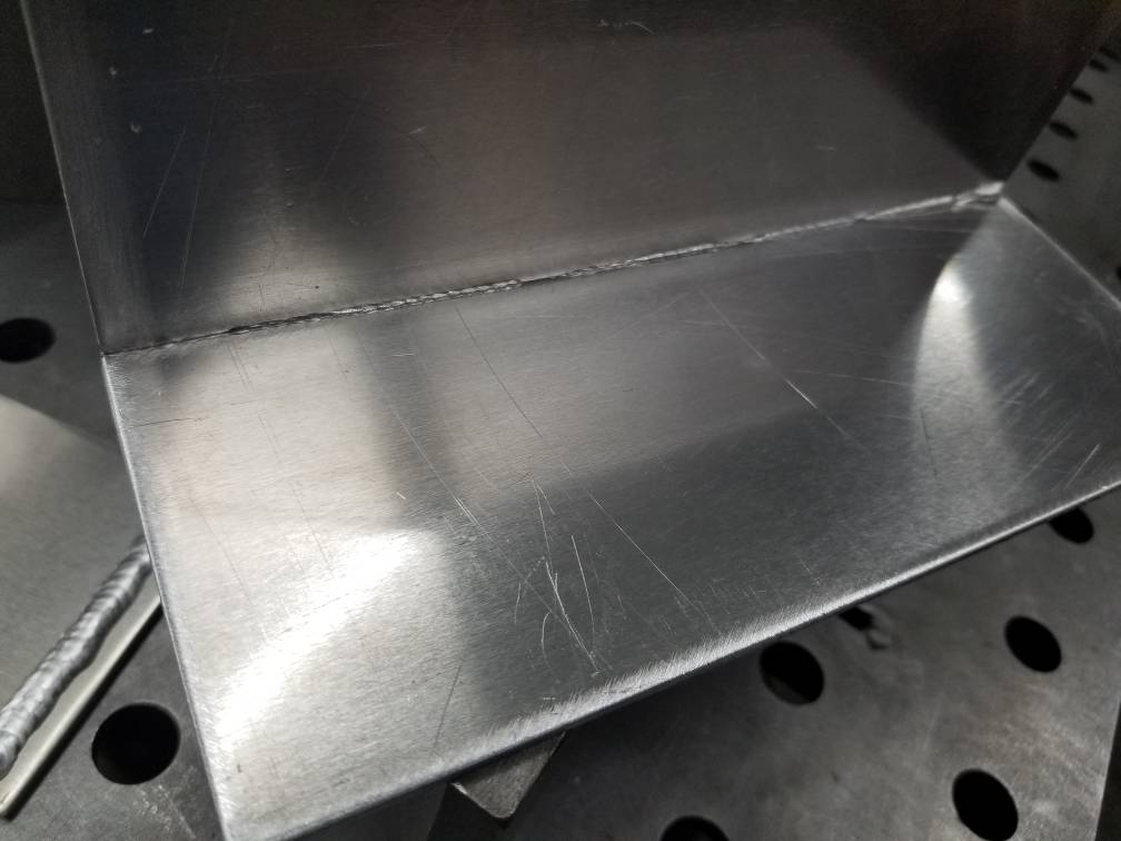

So I tried just a fusion weld to eliminate the factor of the material, as you can see, good clean fusion... which tells me the material is clean and left me with contaminated filler.
Still peppering in the starts after doing additional cleaning of filler...

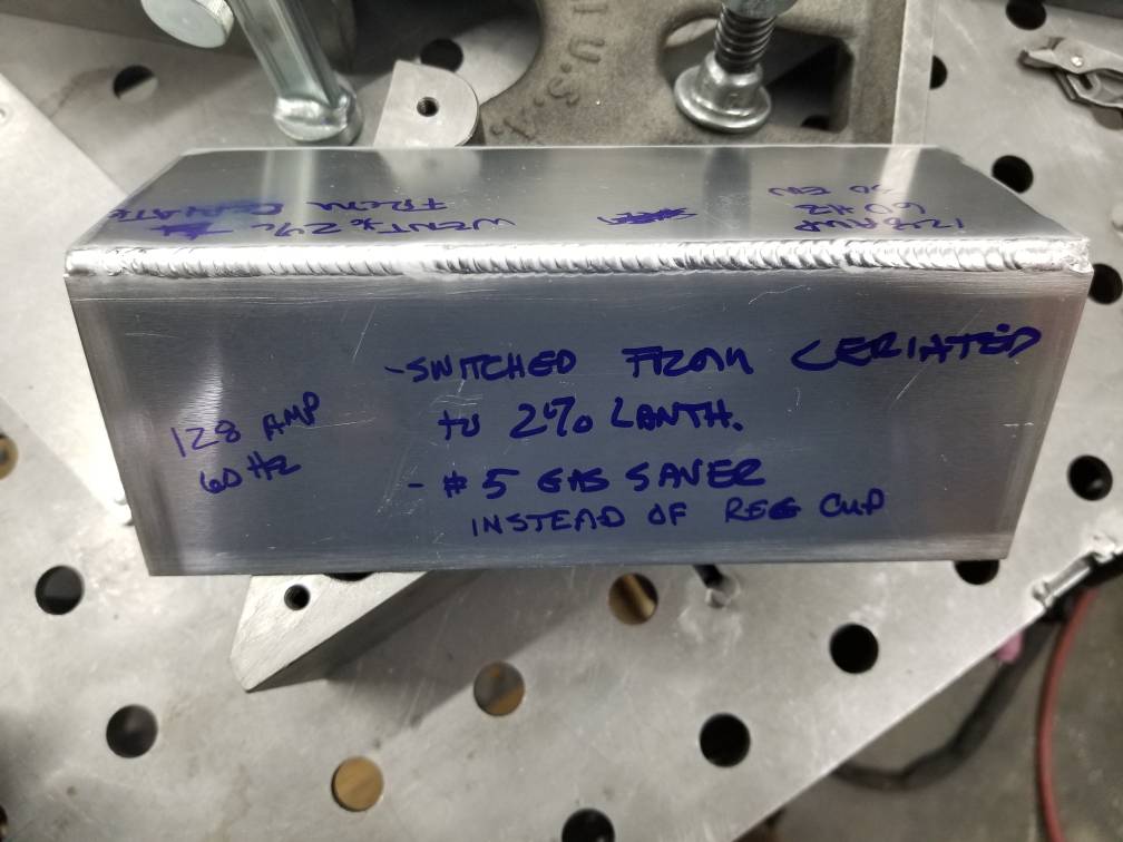

So, I did some more cleaning of filler, and switched up from ceriated and a regular collet and #5 ceramics , to a #5 gas saver and 2% lanthanated. All the while maintaining 128 amps, 30% en, 75 hz and 15 cfh.

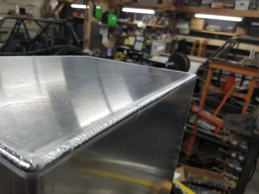

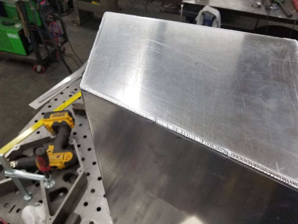

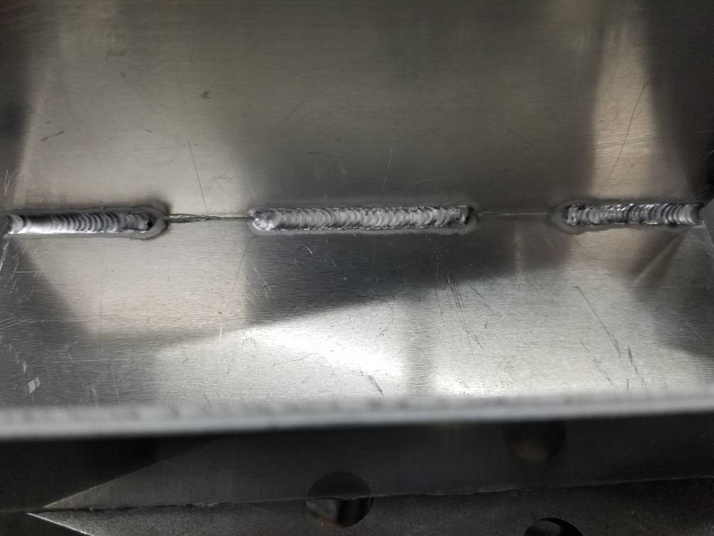

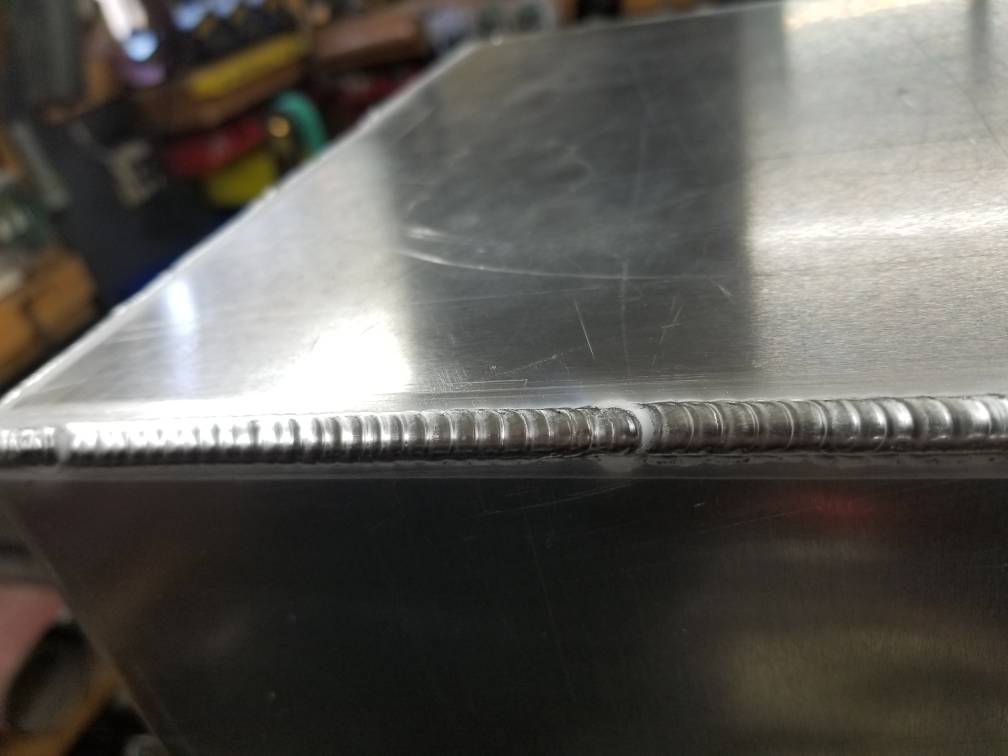

I think it's ironed out now and ready to lay some dimes on the 1/8 aluminum, open corner joints of the fuel cell.

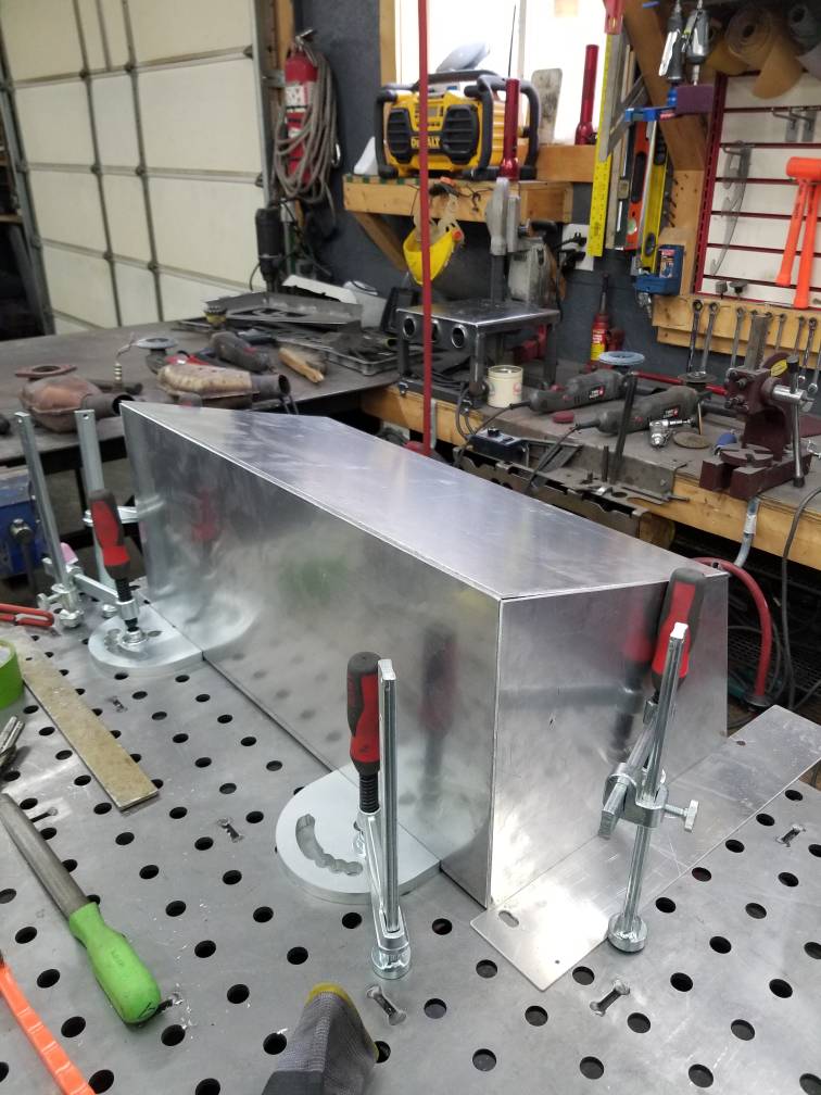

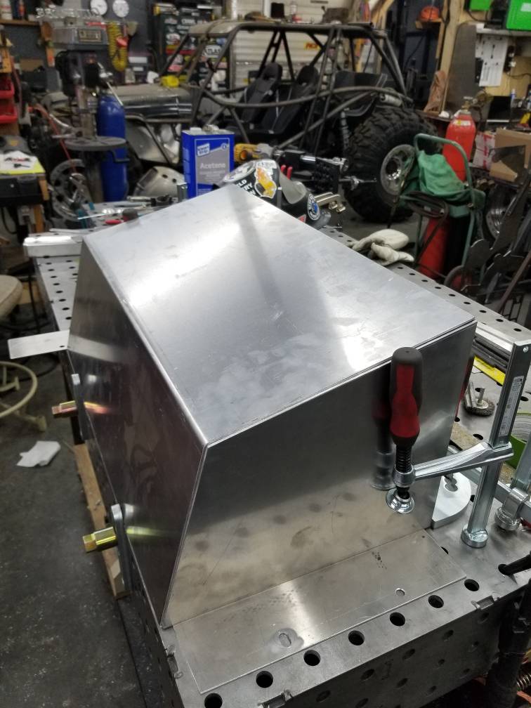

Edges prepped, mocked up, ready to lay out weld in bungs, filler neck, fuel sump, vent/roll over, and mounting pucks. Ended up being just over 12 gallons capacity.
Btw; I had my material sheared and bent locally, my machines won't handle 1/8 aluminum. But I mis-labled the bend angle....
So I said wth, loaded the material in the baliegh magnetic brake..25" long mind you, and it worked effortlessly. Also used it as a work holder and skill saw guide to re-trim the piece!

good research on the peppering....cleaning action helps carry that away in the cathotic etching. The really picky folks (cough, cough maybe you do this) store everything consumable, torch, and material separate and isolated from anything steel related. I've been known to wipe down my filler. Higher hertz seems to cause faster freezing trapping some contaminates. I have found that welding on say used radiators or cast aluminum car parts I use a low hertz, clean sheet and relatively thinner gauge work(except dirty radiators) i use an average of 120 Hertz. Hertz really helps focus the pool but also effects the cleaning to a point. I see it as fast agitation vs. slow steady stirring. Cathotic etching actually latches onto the trash and oxidation in the AC wave. The polarity switch literally lifts it away from the pool and brings it into the cup. In this part of the arc it is either burned away or resides in the cup......all that powdery residue in a ceramic cup after much use: oxidation and trash. Adjusting the cleaning action is directly adjusting the percent and sometimes the direct value of DCEN vs DCEP current in the sine wave form we call AC. Some machines are set to adjust penetration, some cleaning but this balance is exactly what is being tweaked.

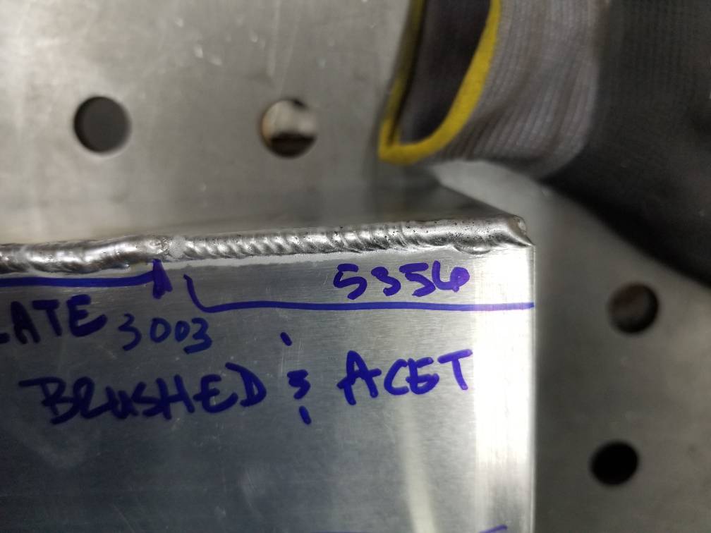

Yes. I keep everything separate, and I have designated tungsten for aluminum and steel (tip from Michael Furick I learned in his class) of course ss brushes for aluminum only. Everything gets an acetone bath. All my filler is alcotec brand. My box of 1/8 is dated 2014, so it gets scrubbed with red scotchbrite and acetone.
I was having much better luck in the lower frequency range. I was getting concerned as I was playing with balance, as I was seeing no etching on the outside corners in any range. But once I started practicing the insides, it was showing up.
Everything seemed to work better on warm material. All the cold starts were a little crusty. Which is just the opposite when I'm welding .063 at 125 hz.
On a regular basis I could not tell you what I run a lot of my .120 aluminum at......or relatively any of it unless its really a thick and thin or picky piece.
180 amps on my Dynasty, when it was available 220 on a 300 AMP MACHINE. About 120 hertz and 60 percent on the cleaning.
My philosophy has always been smack it hard with the go pedal to get it going and clean then settle out and travel. Great starts, less heat soak, better travel speed. Steel was always a polar opposite....creep up to puddle size maintain and go.
Stainless is still my weakness, therefor I pull out all the tricks and usually end up with a specific pulse set up.

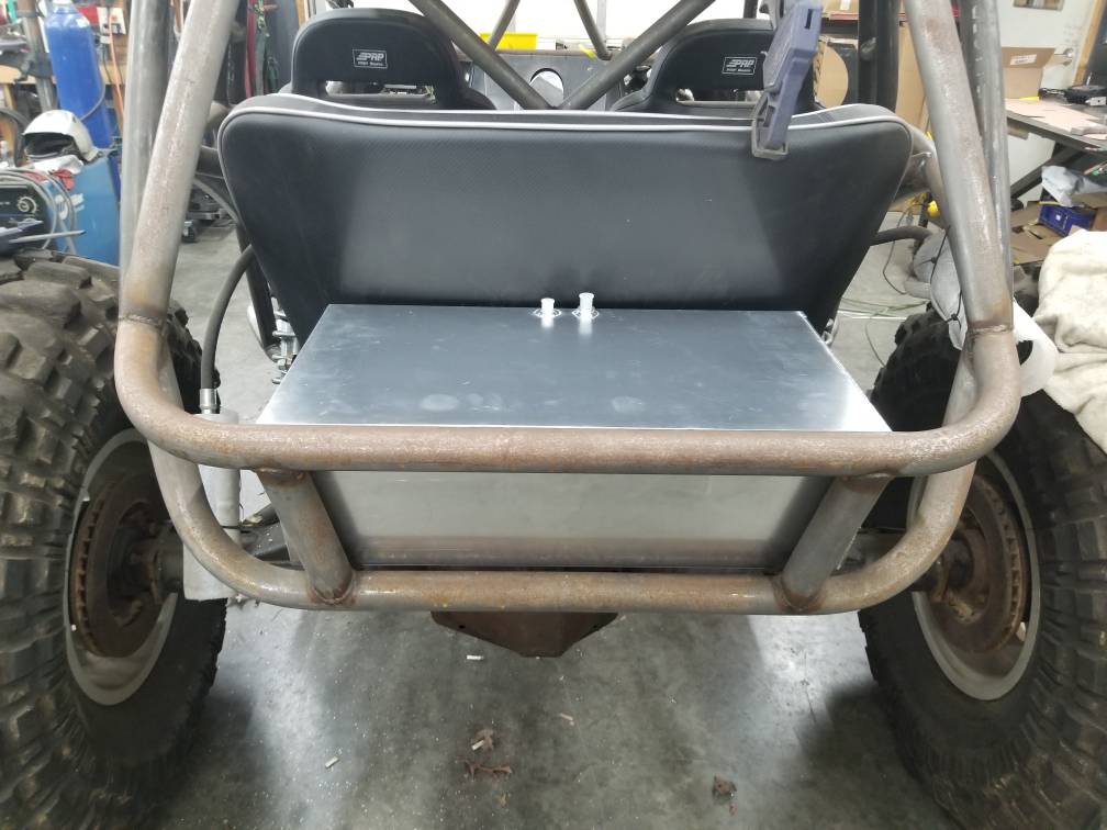

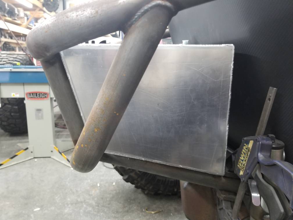

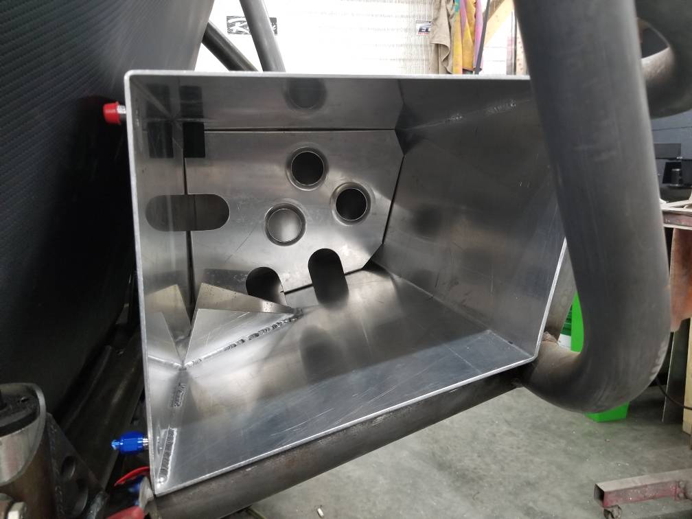

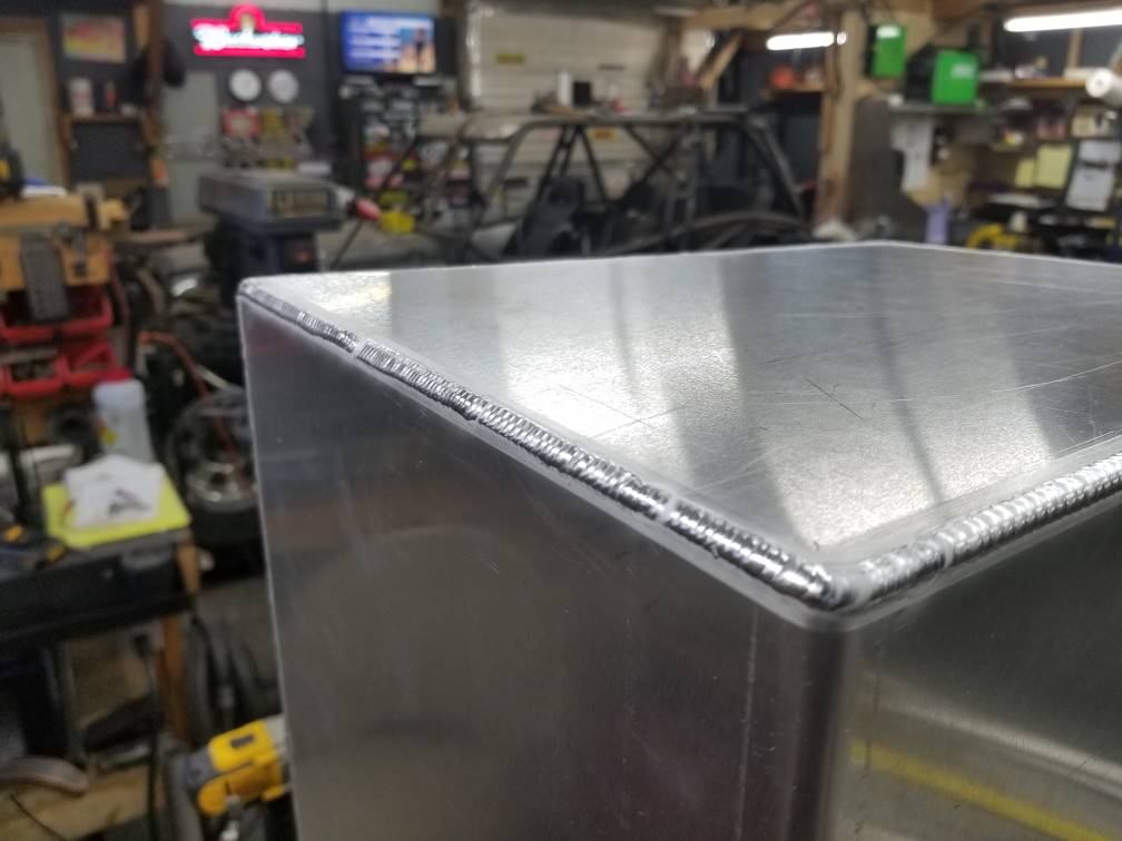

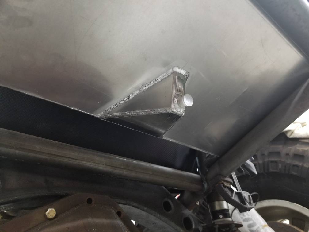

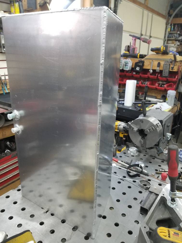

Putting down some drops of alloy love on the Winget buggy fuel cell. Bottom sump, rearward facing, baffled, return and rollover valve top center. Neck goes on tomorrow.
Just a tick over 12 gallons.
