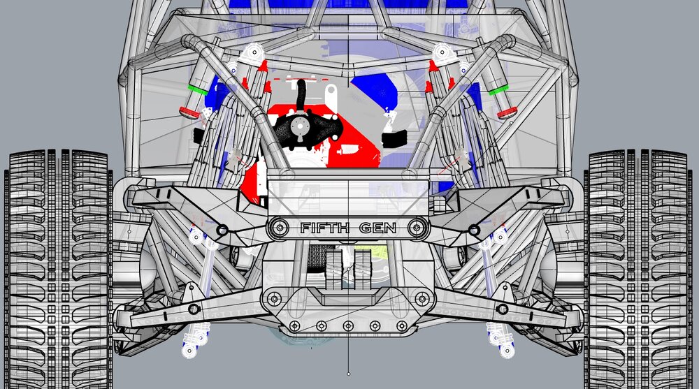

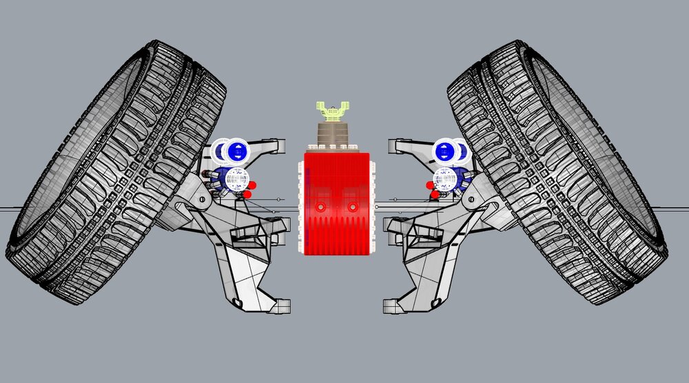

Except the engine model isn't the same as the picture?? Or did you change the model to show a carb and distributor setup?
Right, your right. The CAD file is carbureted big block 572. It's the same block. I'm just going to have to account for the valve covers. Valve covers on the 632 look about an inch or so further outward.

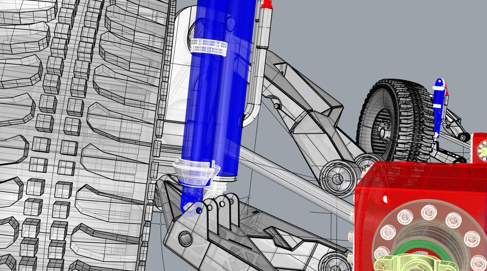

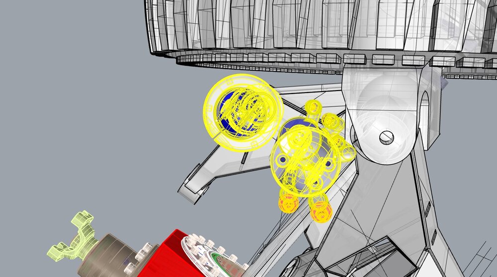

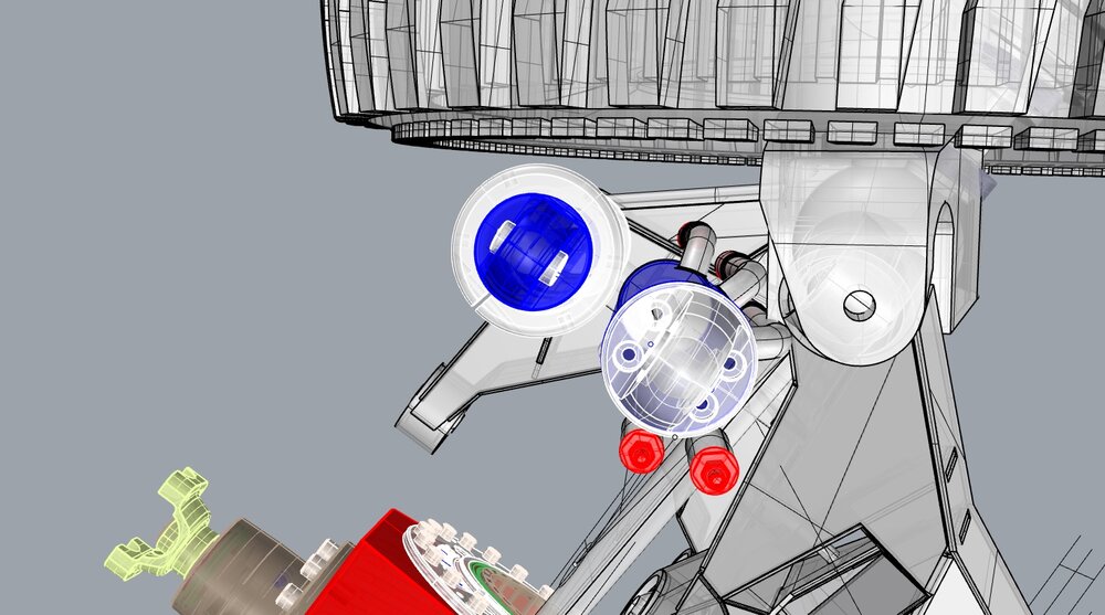

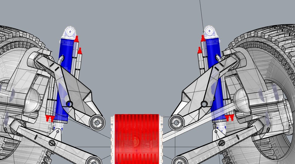

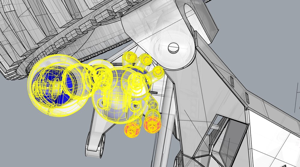

Not going to mess with the scrub radius. Although it looks like I should do the work to grab lighter spring rate by upgrading the front shocks from 12" to 14" because I've got the room. I'll have to figure the geometry to lean them in some. Might make the coilover thinner, and the bypass thicker while I'm at it.
going all out with the custom one-off coilovers and bypasses..dope!
Thanks. Actually, all these shocks are on the shelf at King. Unless I end up landing in a situation where I have to rotate some of the bypass tubes, but I don't think I will run into that. Guess we'll find out soon.
This is what the difference in shock placement looks like upgrading from 12" to 14". The thinner 2 inch coil-overs will make room for 4 inch King-Kong bypass shocks.
