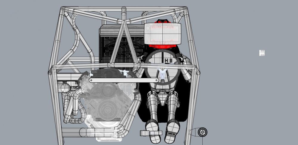

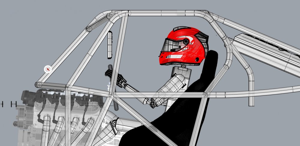

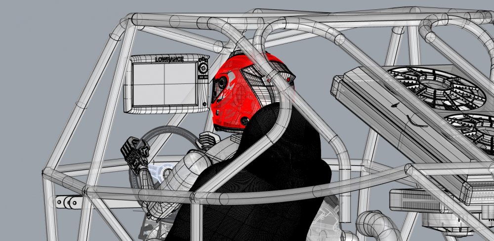

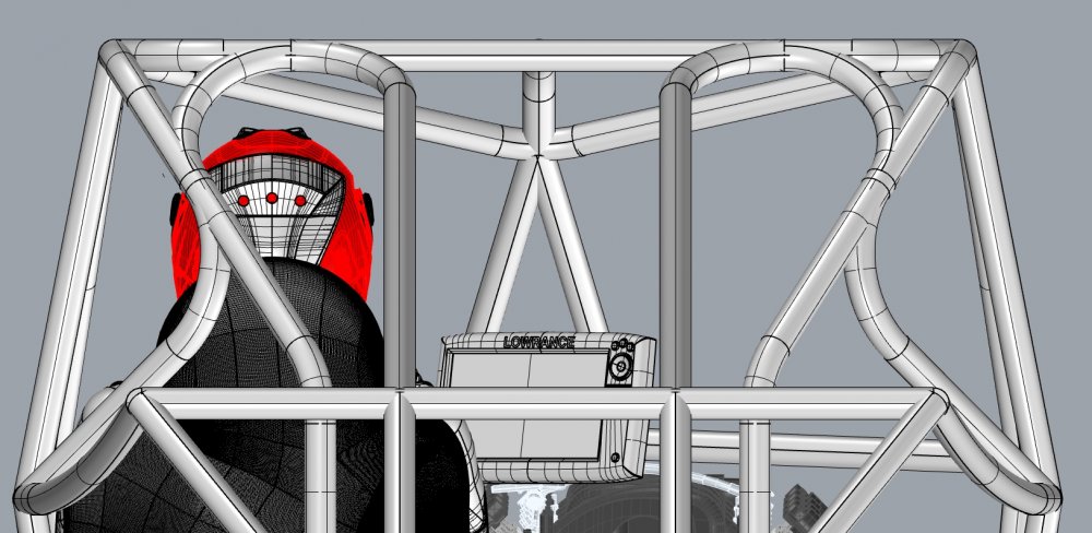

Finally got Doc's navigation system mounted so he doesn't get lost. LOL

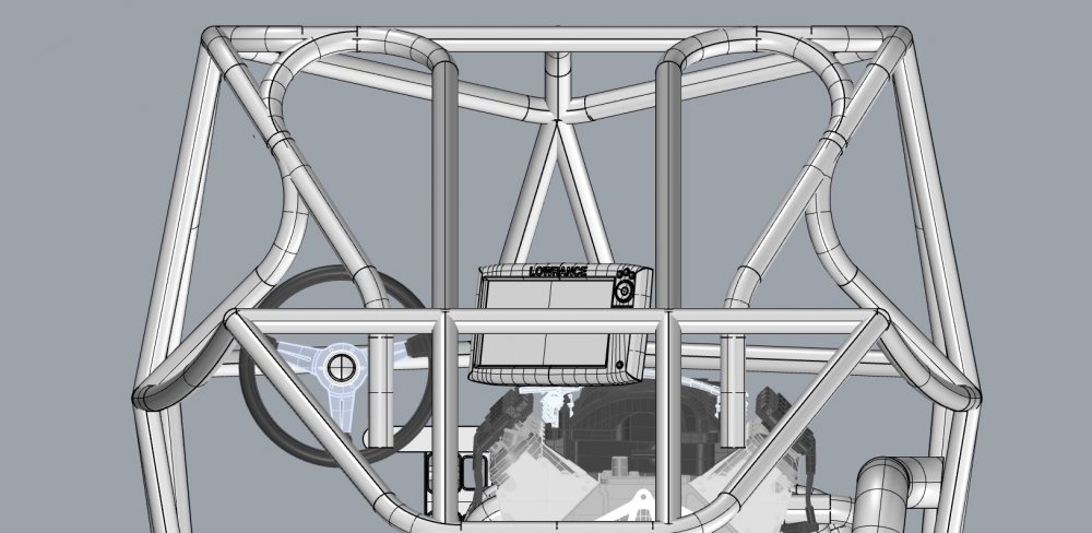

Is it me or is it mounted directly in front of him?
It was just an inside joke.

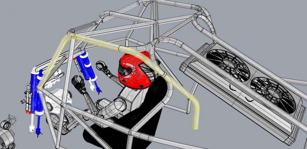

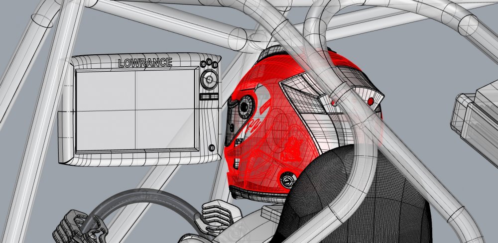

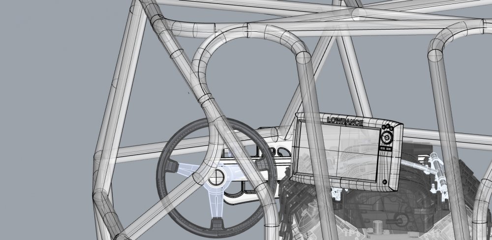

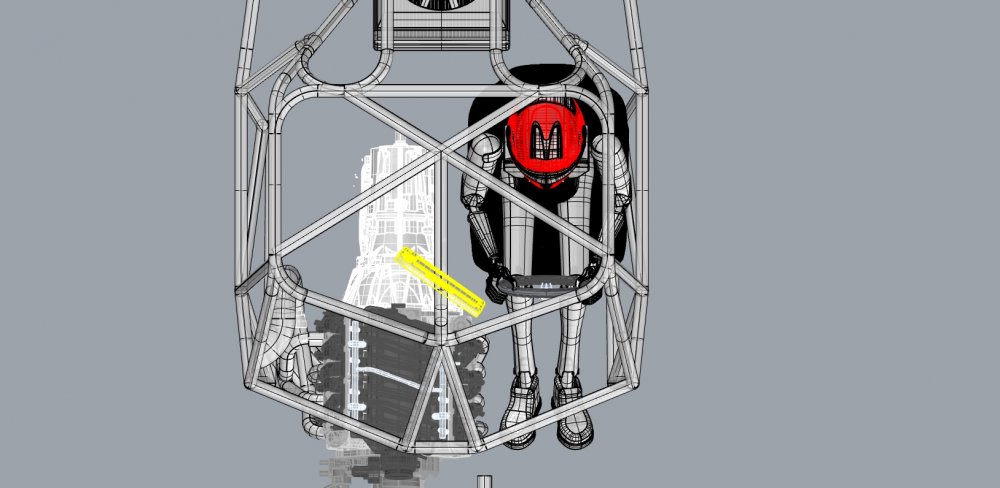

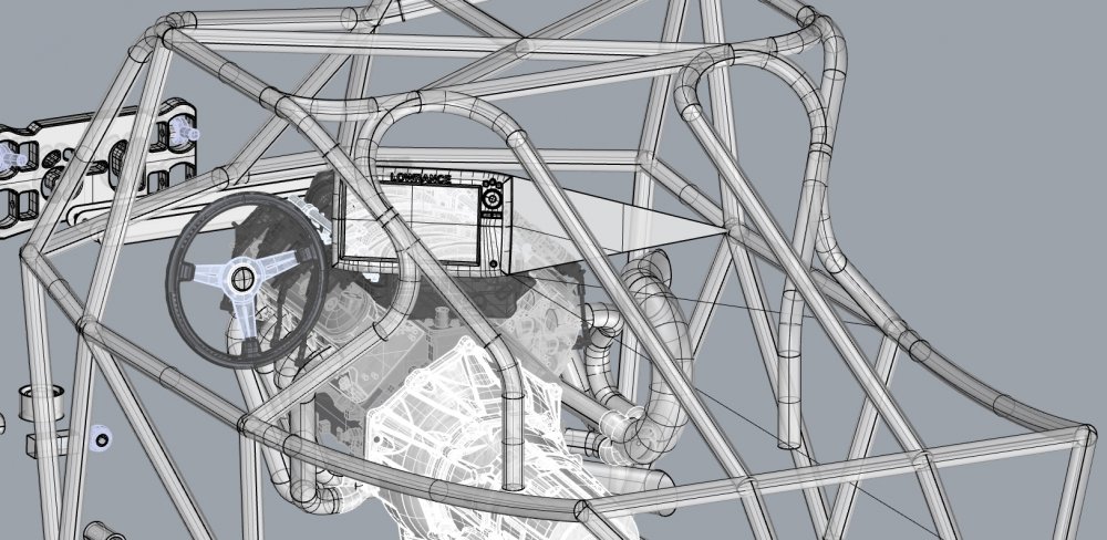

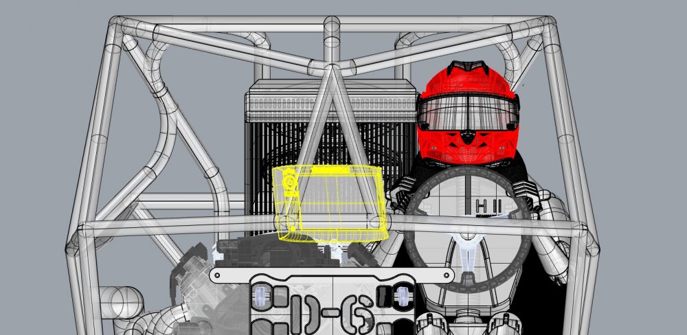

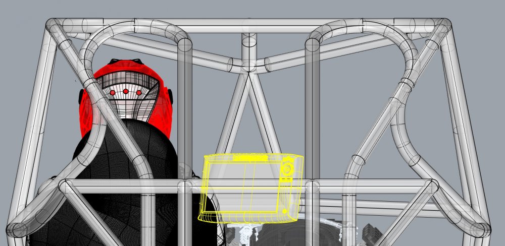

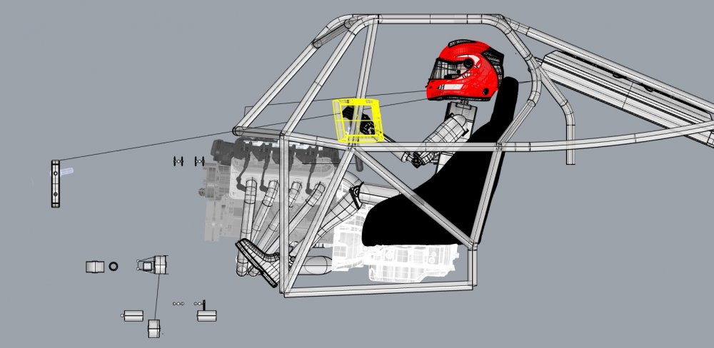

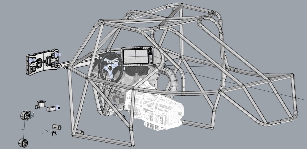

OK..... First things first..... CAN'T GET LOST..... Luckily Doc is great with computer screens, and we are going to give him a BIG ASS NAVIGATION SCREEN to keep him on track. First thing I want to mount in the drivers cock pit is the navigation screen. Nothing else on the dash board is more important than this piece of equipment. Most all of Doc's connections with the car become muscle memory, but not the connection with the navigation screen. It's an ever learning visual connection he will have to become one with. Looking at the eye sight lines, I located his navigation screen within the vision blind spot that we encountered with the supercharger. Basically I used the supercharger blind spot to raise the navigation screen as high as possible. Honestly, I don't think I would have raised the GPS this high if it was causing loss of vision around the car.
Looking at what I'm seeing now, I'm getting first thoughts towards putting the transmission shifter somewhere on the lower - driver side of the steering wheel, because I'm going to need a substantial amount of space on the passenger side of the seat to mount the transfer case shifter's in a position where they aren't knocking the elbow.
