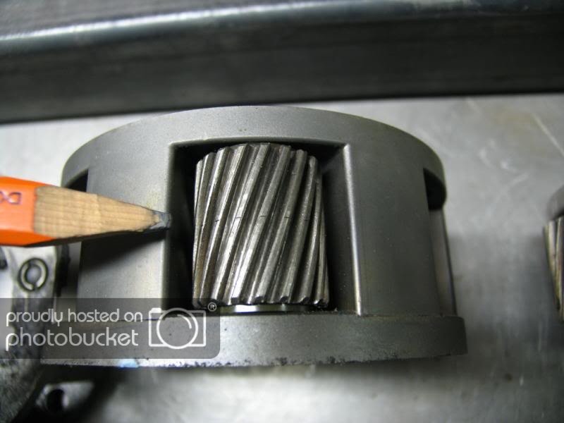

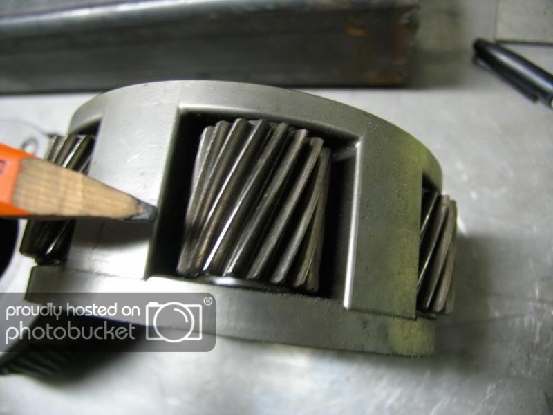

I'm almost positive the cases are all the same. You can swap the 6 pinion planetary unit in place of a 3. Plus a the inputs are swappable too so all you really need is the case.
There was a gear cut modification on the planetary sometime around 95. I’ve researched that this is definite for the np241C. First picture is like 88-94. Second picture is 95 and on. Jeep tcase uses the gears cut like the 95 and on.

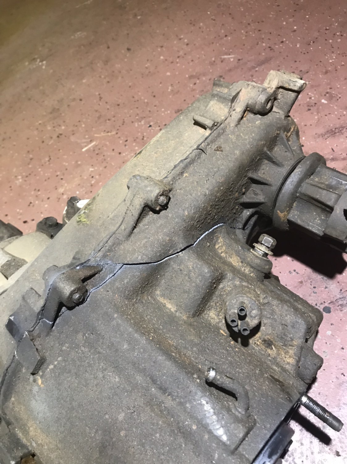

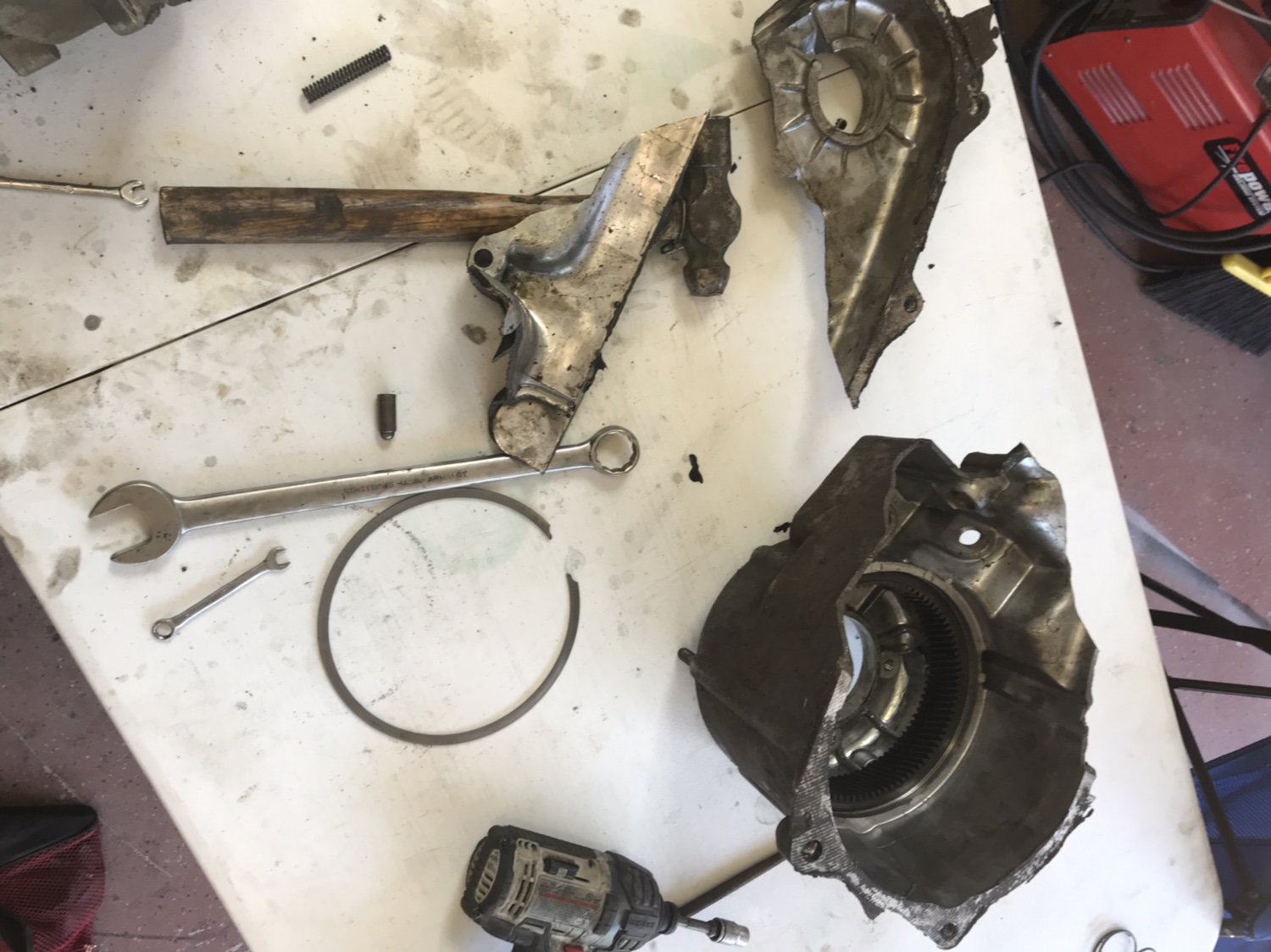

After Chocco in AL, I had a split transfer case, janky trail fixed fuel lines and one of the caps had pushed out of my Yukon Super Joint.

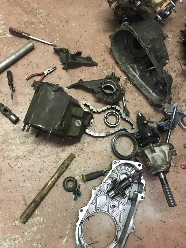

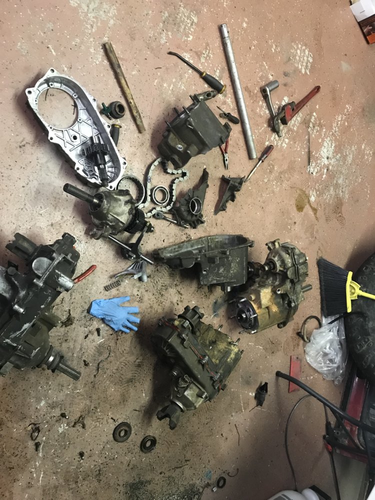

I finally removed the transfer case. I had given a buddy what I thought was a 231 years ago and he never used it so he gave it back but it turned out to be a 242. It’s for sale. Cheap.

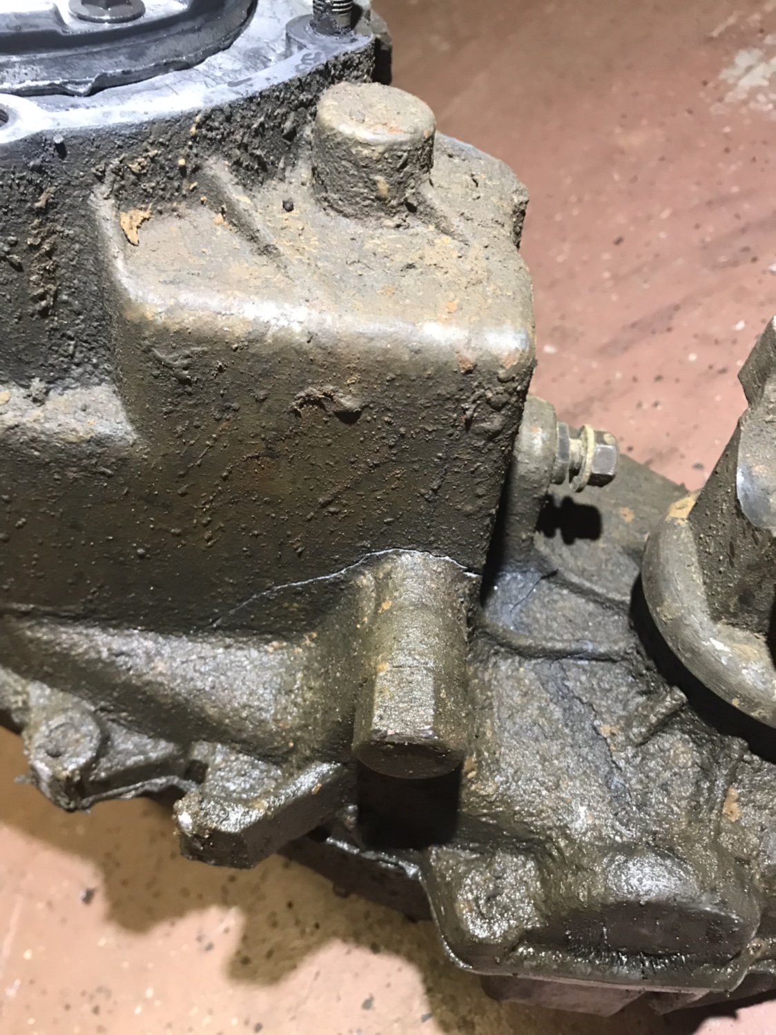

So only the front half cracked, not the rear. I scored a blank front half of a 231 from @amcjeepman to swap things.

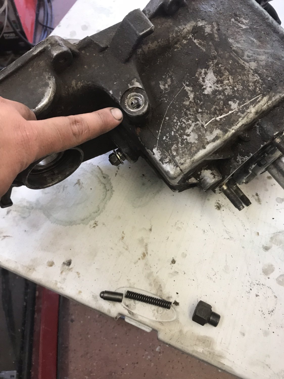

Apparently the older cases have a different size detent assembly, or it’s because mine is from a Dodge but I’m now waiting to get a detent spring, pin, and plug, along with a new seal for the front output and I’ll have a transfer case again.

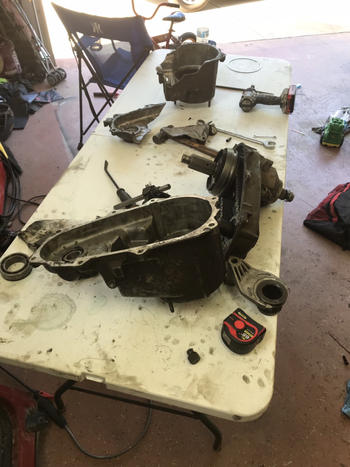

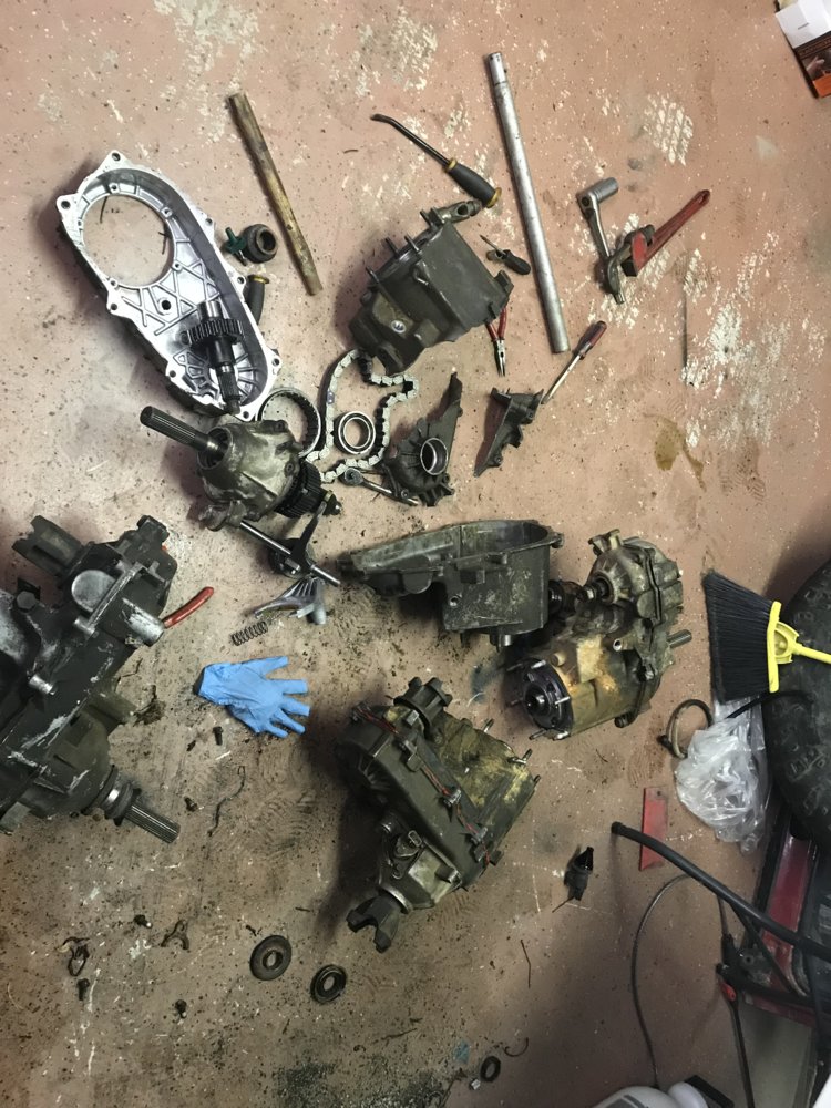

So I now have 3 transfer cases in my garage all split apart and it’s a huge mess. One thing I can confirm for sure... a 231D does not have 6 planetary gears. It does have a wider chain though.

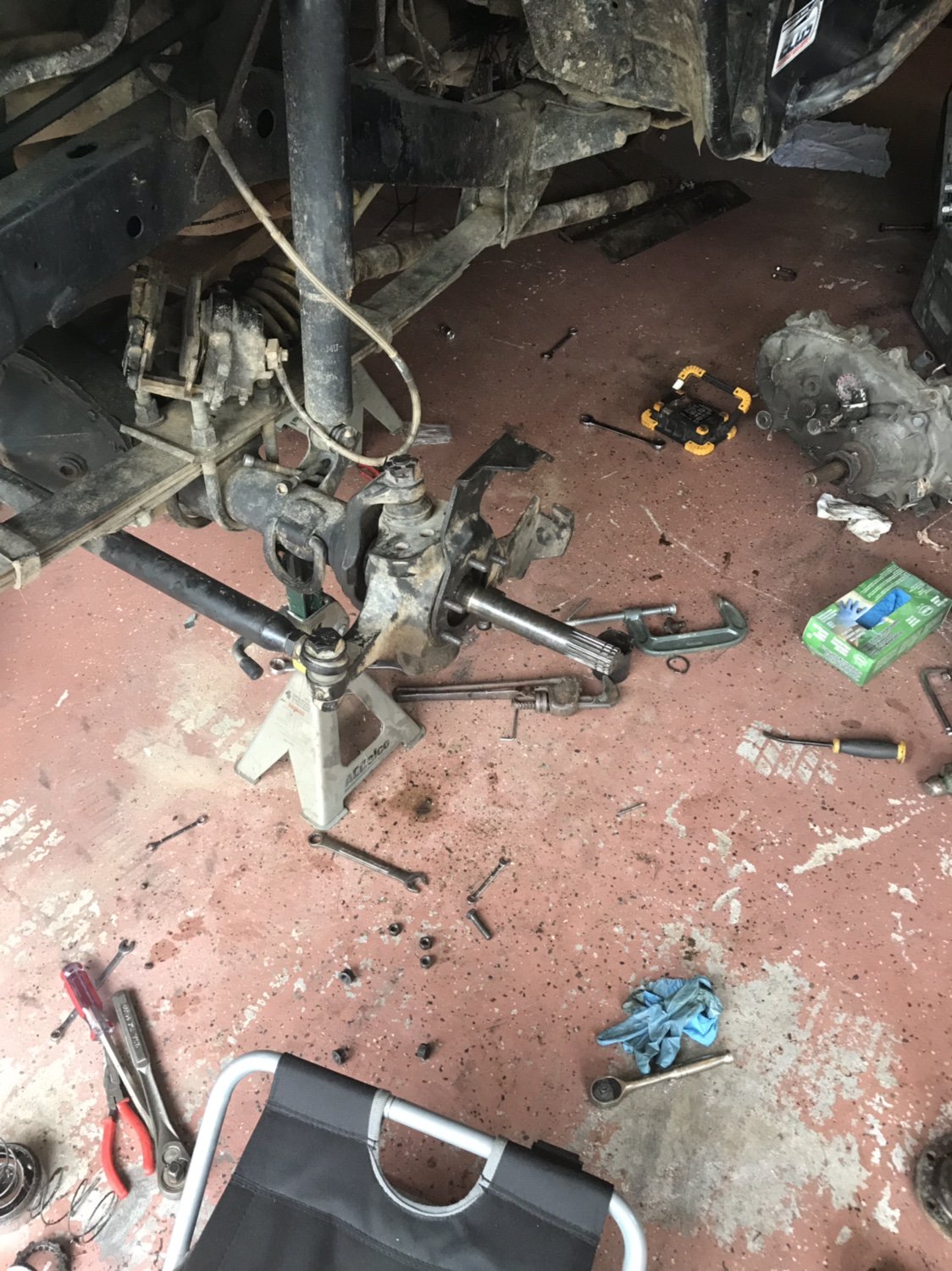

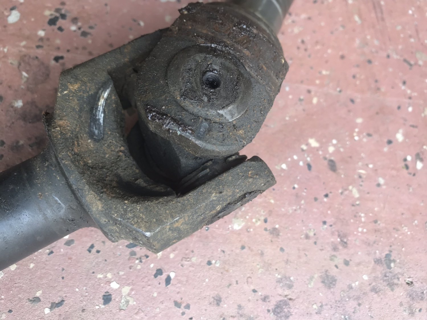

I also pulled the axle shaft to check the U joint. I was really hoping I was going to get by with just a $120 rebuild kit for the joint, but it got even better as it turned out it was just the snap ring was never seated all they way or something.
I knocked it back in, joint felt good and tight and I seated the snap ring. All is well, but I do need new grease fittings. Think I can get those at tractor supply, or will I need to order them from ECGS?
Finally got the transfer case fixed. 4 transfer cases later.
I could not find the right detent spring assembly for the front half of the case I was given. So 2 other friends each had some 231s laying around. One was cracked and one was good but didn’t have a SYE. So I once again tore things apart and combined my rear half with e new front half and a better set of planetary gear from one since mine were fried. I got it all back together tonight and hopefully I’ll have it back in tomorrow night.
I’ve taken some transfer cases apart before, twice to replace a chain. But not I’ve really been acquainted with a 231 and could take it apart and put it back together with my eyes closed!

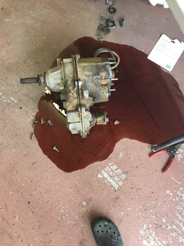

I opened this case just totally assuming it was not full of fluid like a dummy.

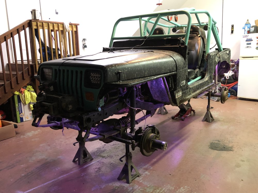

Got it all back together, went around the neighborhood and shifted thru hi and low, everything works as it should. I did find that my skid plate is cracked right where the anti-wrap bar mounts to it. It is starting to rip away! Luckily I’ve seen it now and I plan to drop the skid again and weld it up and possibly add some bracing before I head to Harlan.
Also, when I bought the Jeep the front hubs didn’t unlock, at least the driver side didn’t. I took the hub apart and quickly discovered why, there was an extra spring in there and one of the plastic pieces was turned around backward and would not engage or disengage like it was supposed to. All works as it should again. And the garage is clean again!

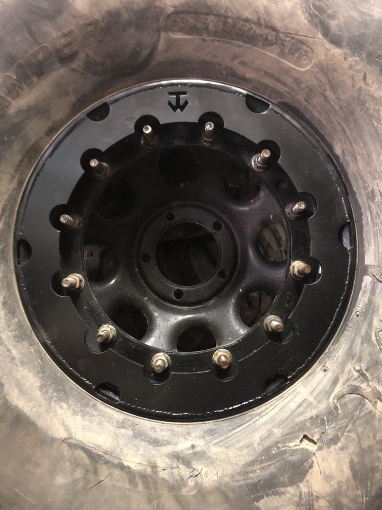

Back at home, headed to Harlan in 2 weeks so I’m trying to go over everything. Currently I have the H1s broken down, waiting on my rock rings from Trail Worthy Fab to arrive. Can’t brag on Andy at TWF enough, super nice and helpful guy.
I have the large rubber valve stems recommended from my other thread. Gonna drill the square hole out with a step but to accept the new valve stems. I’ll add a little RTV as I pull them in just for insurance. Hopefully the end of the my broken valve cores! Although I’m not excited to add 10lbs extra per wheel, as they are already super heavy.

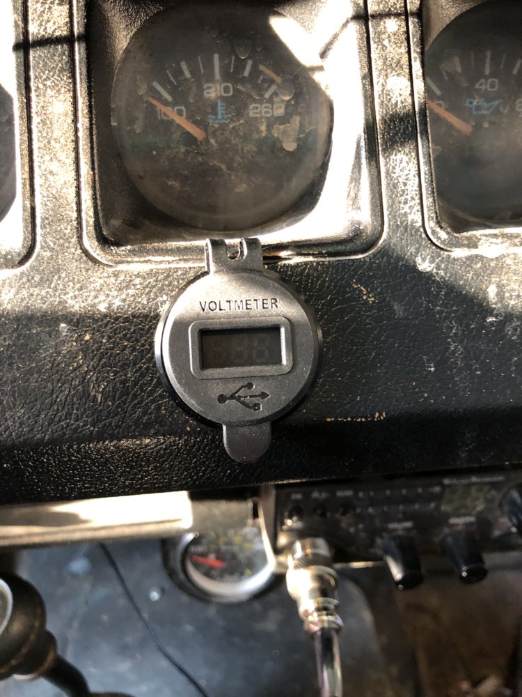

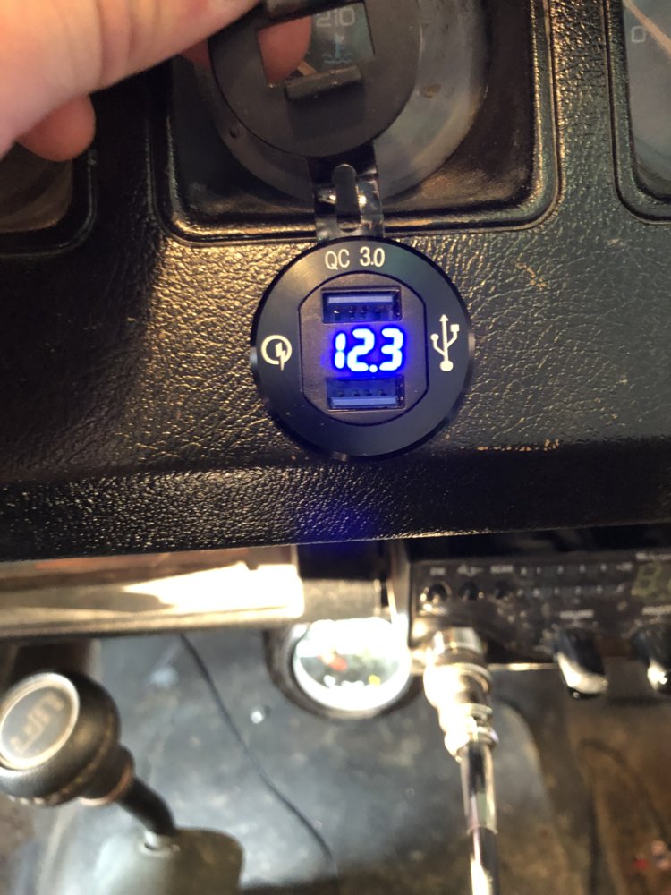

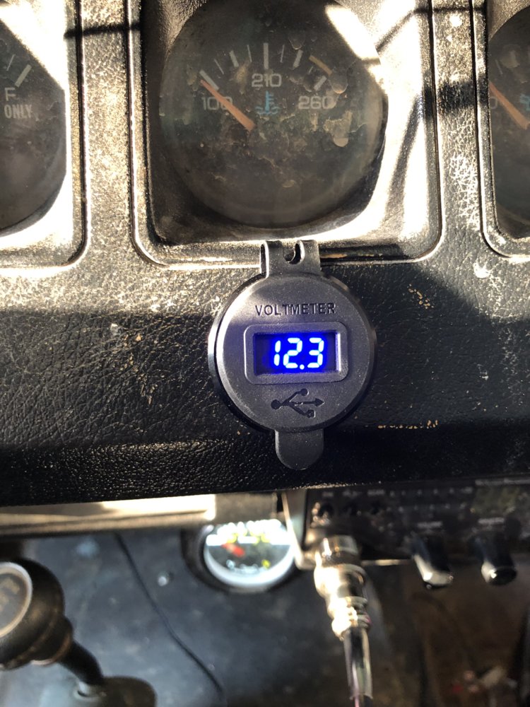

While I wait, I finally got my latest gadget installed. Picked this up on Amazon for $15. Now I can charge my phone, as can my passenger, keeping my tunes cranked on the trail!

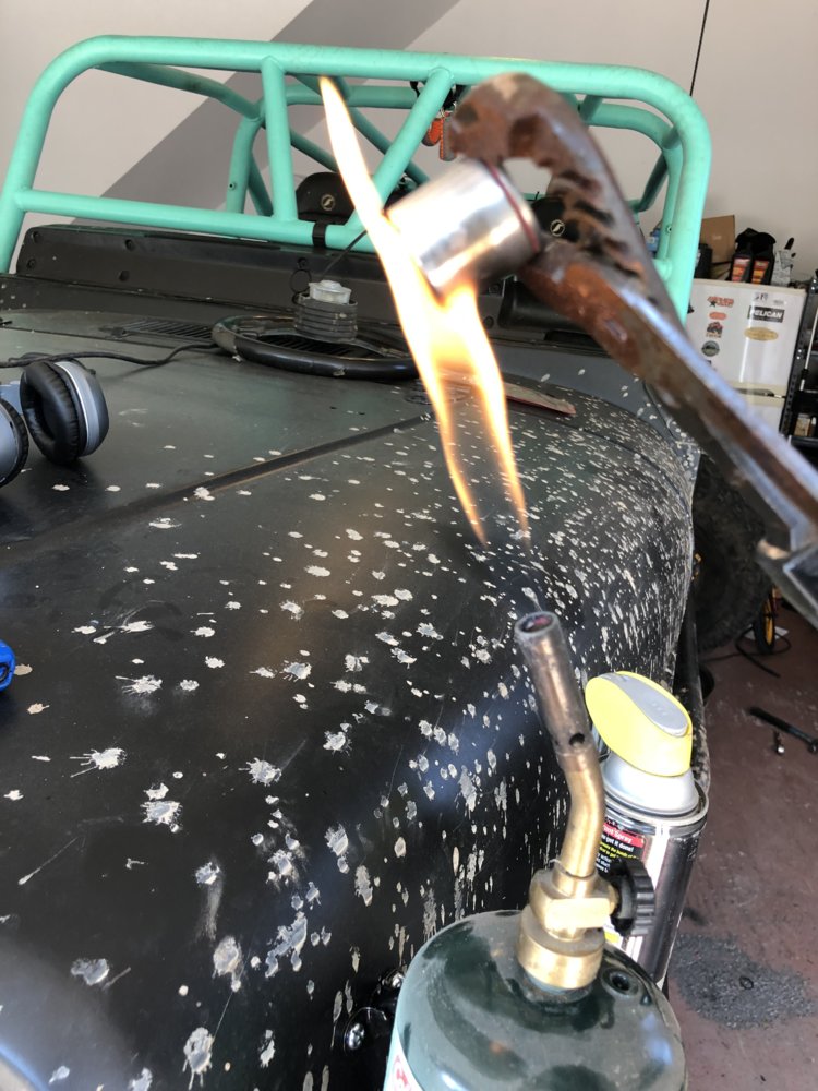

I did not have a hole saw for the this thing, and wasn’t able to run to the hardware store so I scarified my 7/8 socket. Got it good and hot and just melted a hole. It’s not stupid if it works...

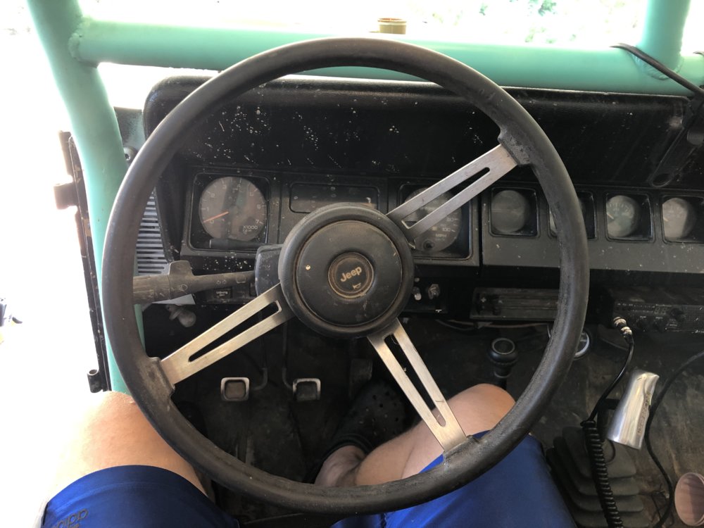

Also, I did not like the small Grant steering wheel on the Jeep. It was too small, and it wasn’t in good shape. @Van-go had given me a stock wheel, and I finally got around to putting that on. Should make the steering feel a lot better!

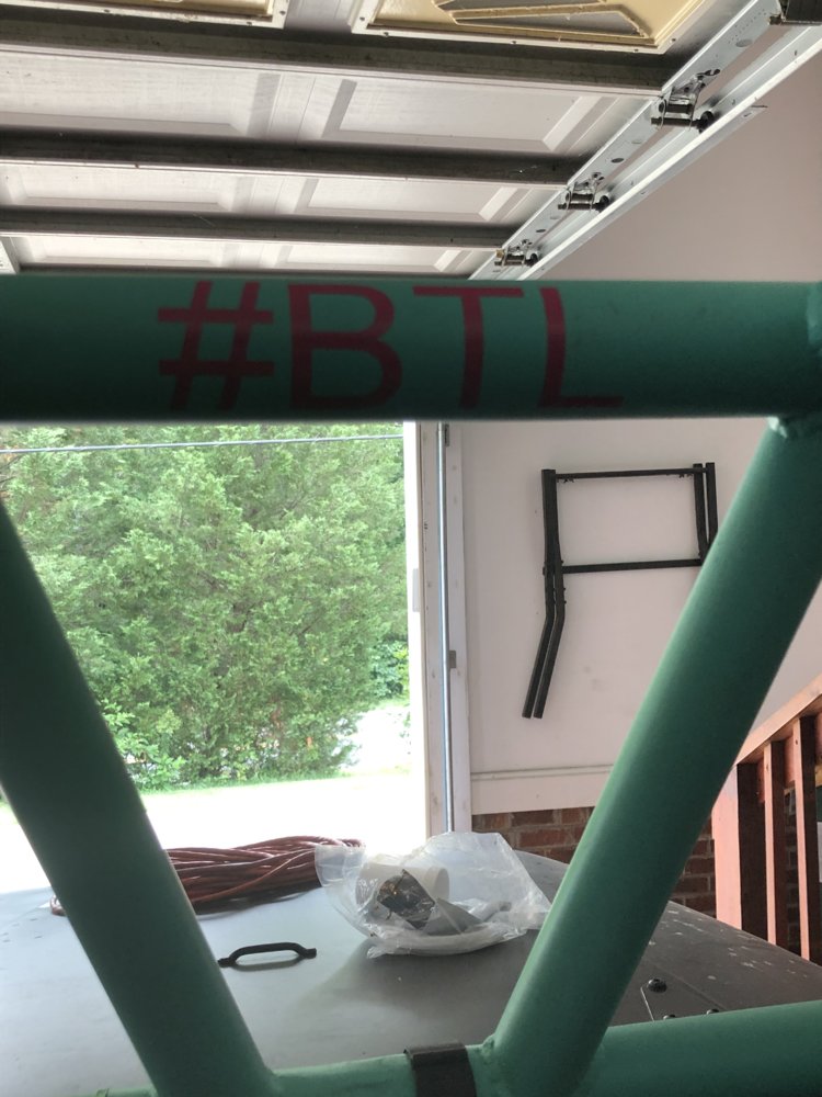

And I had to represent for @Loganwayne. I’ve had one on my cooler since last year, but Jody hooked me up with some swag and included another one.
#BTL is my internet wheeling buddy who I’ve actually never met. But we are best friends now.
Btw, first drive since putting the stock steering wheel back on and holy cow what a difference! It is soooo much better now!

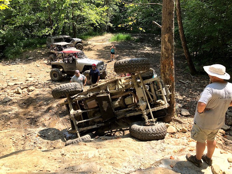

Haven’t updated since Harlan. Most know I flipped it over and blew up the rear axle while there. Good times. @CasterTroy can post a YouTube link if he’d be so kind.
Tire dropped in the hole on the waterfall while I was on the rev limiter. Bad driving on my part, should have hit it harder. Oh well, fun was had.

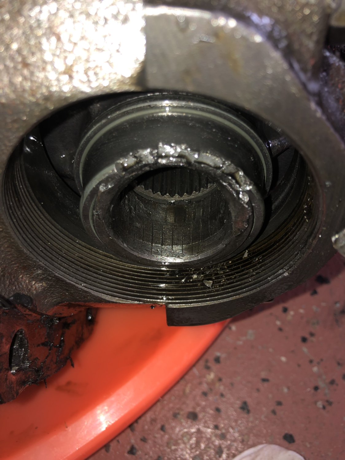

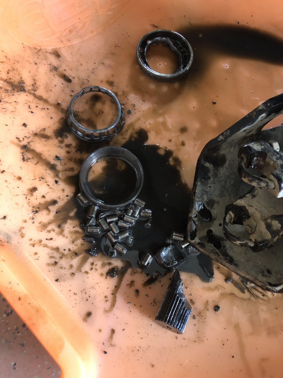

When the shaft broke it blew out the bearings and cracked the carrier. But it did not break the 3rd luckily.
