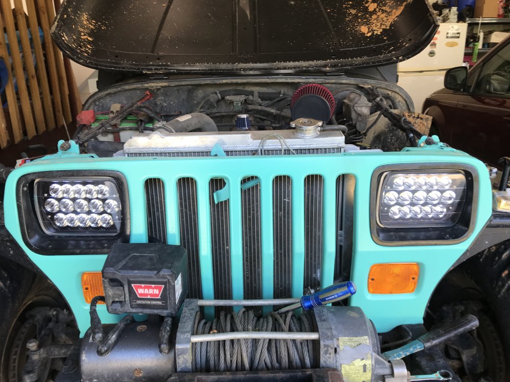

I originally thought this was gonna take less than an hour. Before I got frustrated and walked away I decided to put my new head lights in to make me feel like I’d done something at least.

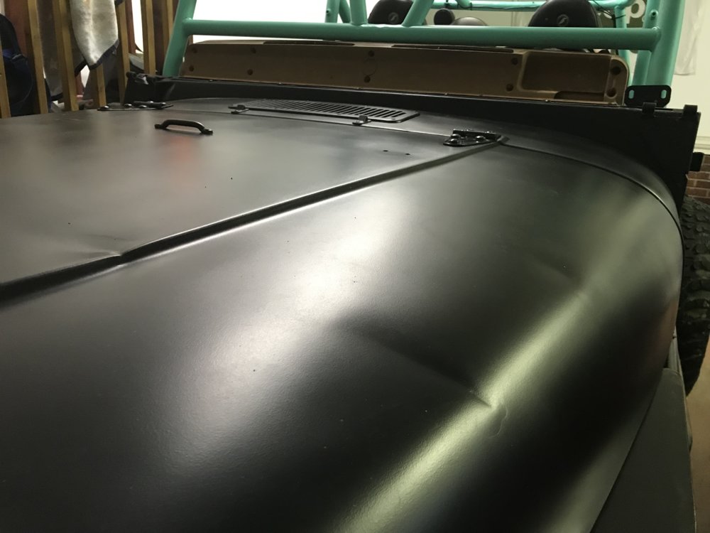

Also, just an update, I’m pretty happy with the paint. I came home from AOP and gave it a wash with soap and water. It doesn’t seem to stain like flat black rattle can paint does. I’m happy with it, but would recommend at least 3 coats to anyone else doing this as it doesn’t take much to nick the paint. But remeber, I screwed up the first coat and then did another coat 45 minutes later. 3 proper coats wiuld probably do really good.
Got a link to those headlights? I've been looking for some for mine, but most of the squares look horrible in my opinion. Those I think I could live with.
Yeah I thought they looked good too, I like the black housing. They have hi and low beam as well, and super affordable. Haven’t had a chance to pull it out and see how bright they are.
Bear Claw LED BC-7x6-blk... https://www.amazon.com/dp/B01LXL1QRY?ref=ppx_pop_mob_ap_share
