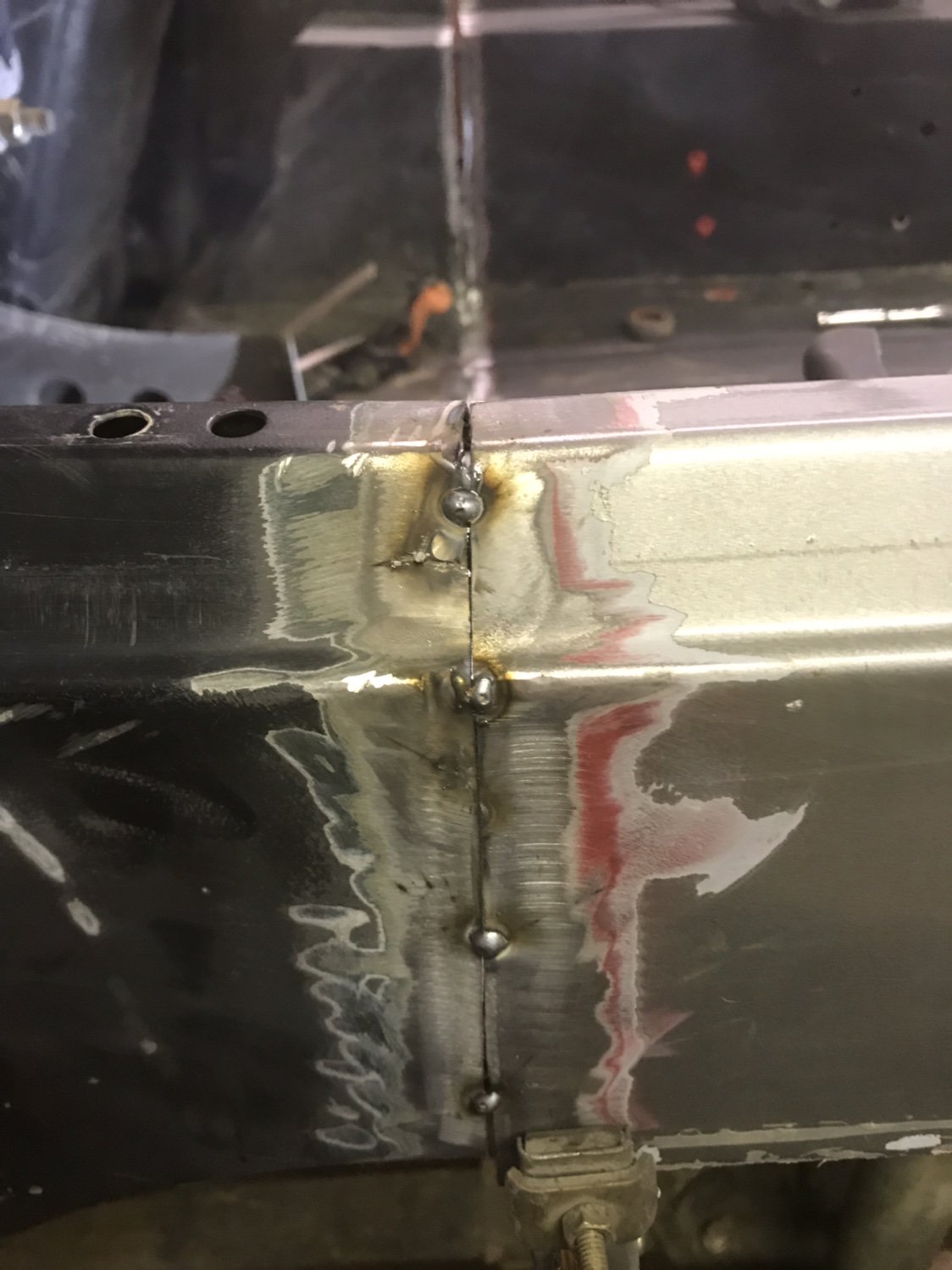

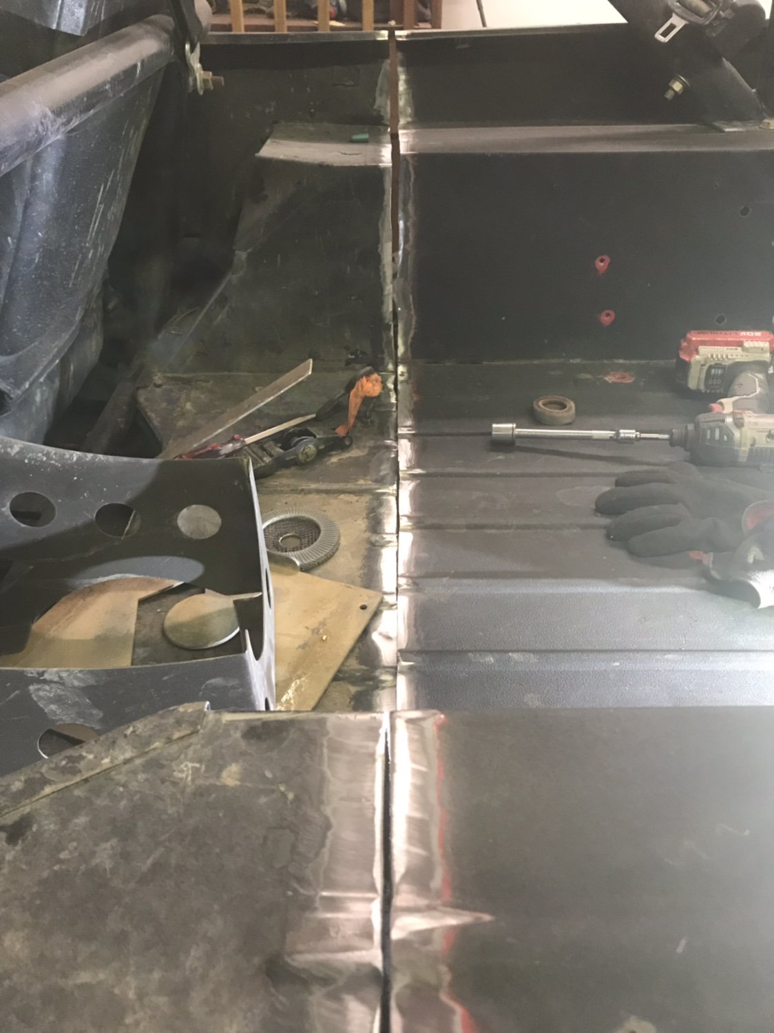

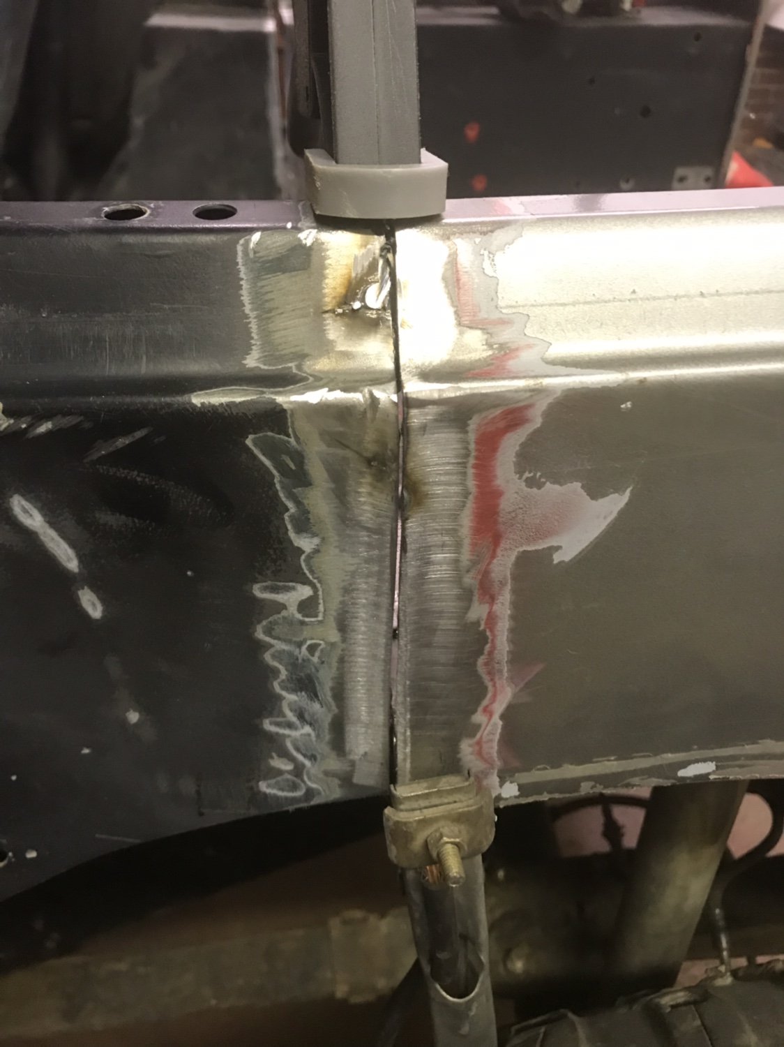

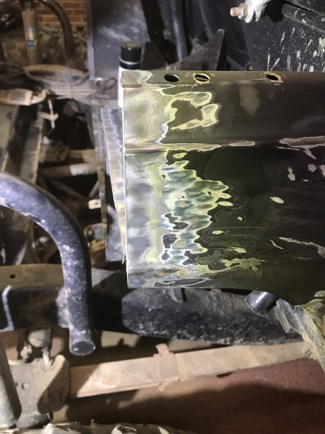

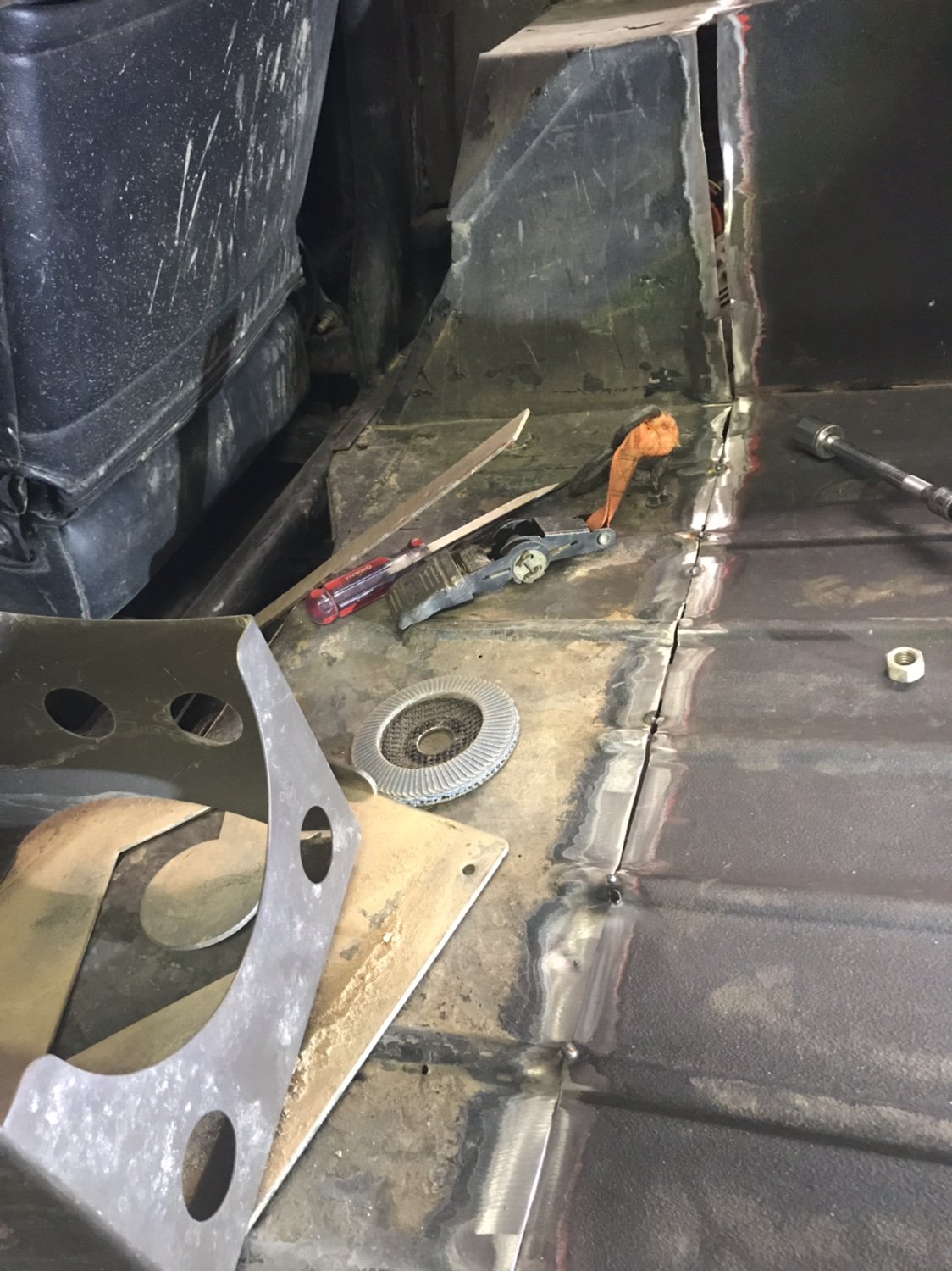

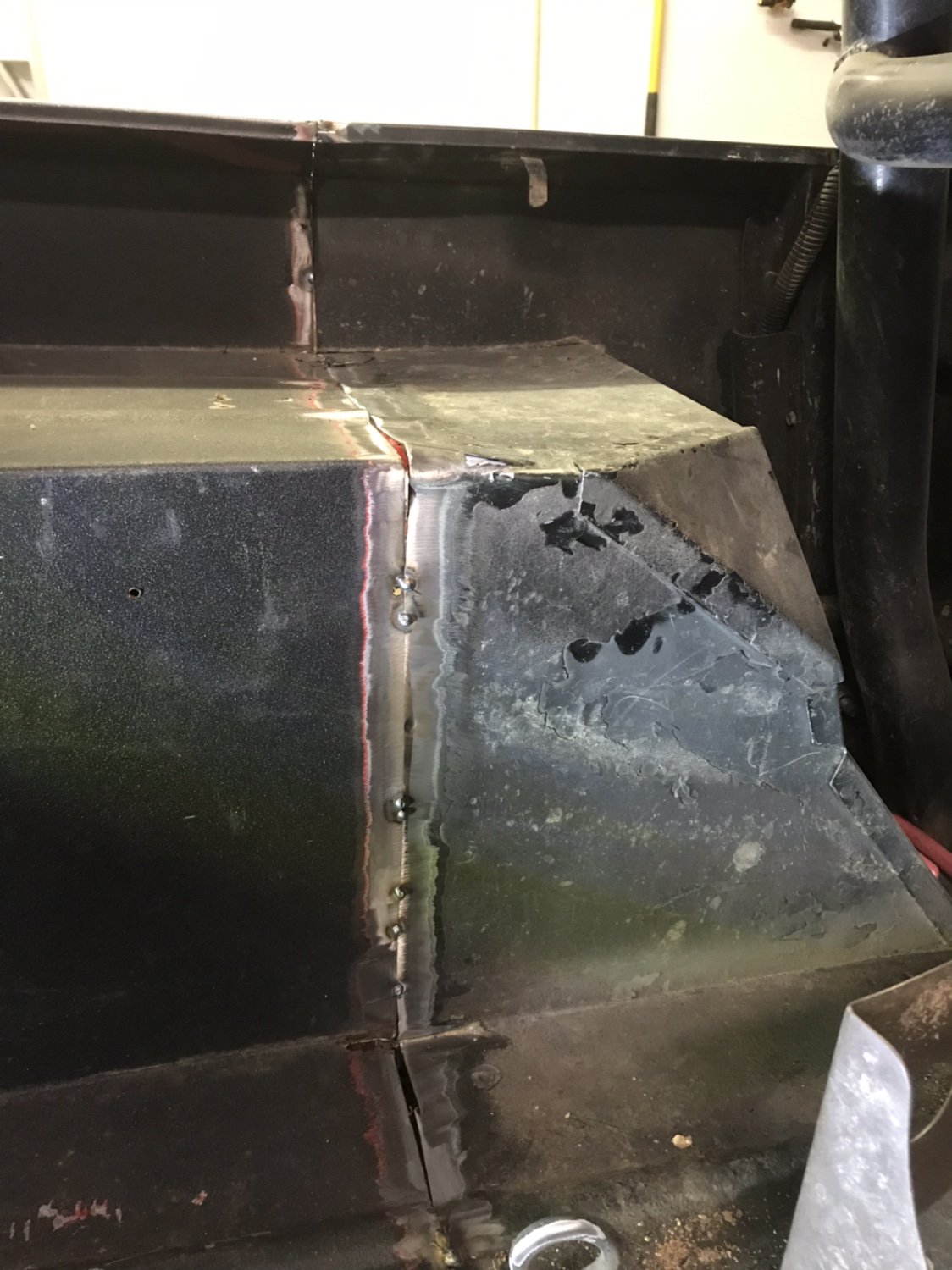

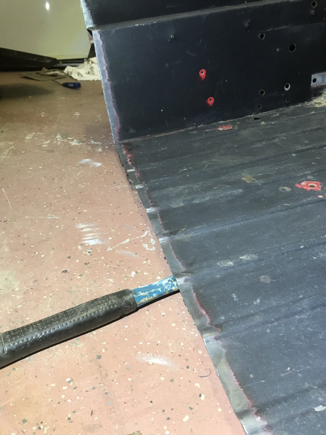

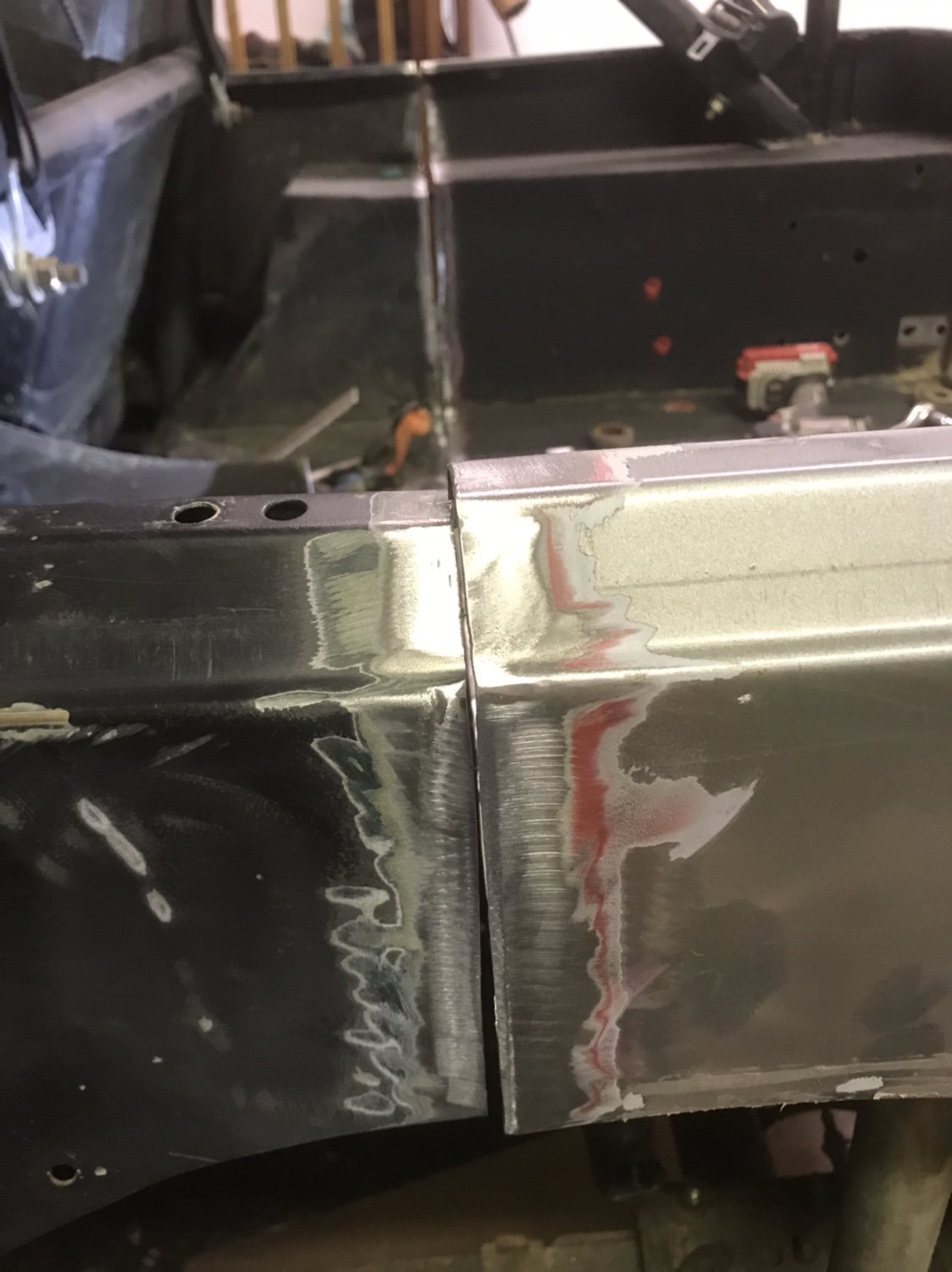

Wire wheeled the edges of the seam, while surviving the little death missiles that shoot out!
After I wire wheeled everything I went back with a flap disk.

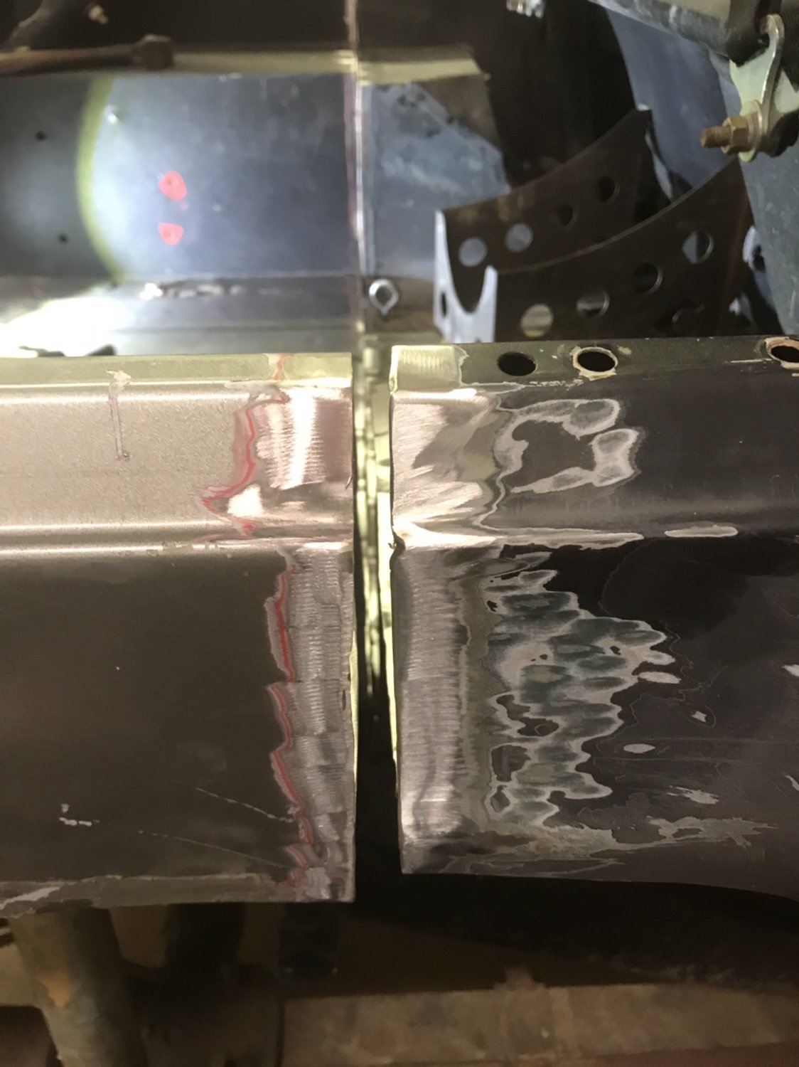

Driver side needed about the width of a cutoff wheel to like up perfect.
The passenger side is a different story with almost a 3/4” Gap...
Guess I’ll be doing some booty fab filler/patch with a piece of the old tub. I’ll probably just fish it in behind to make the outside look ok and use some bondi.

Again I have no clue what I’m doing. I am no body guy, and I get lazy, impatient and rush things like this that take attention to detail. I figure if I can make it look half way ok then it will be better than it was. I can hide my booty fab with some bondo, but honestly I’ll be putting my own dents in it before long.
Another crazy thought, I can see the multiple colors this Jeep has been thru. I thought of putting the seam together, bondo it smooth and sand it. Put that area in primer, and half way straighten out a few other things. Then leave the hood red, the rear tub silver, some of the green sanded out and coming thru, some of the red on the tub coming thru, purposely exposing the previous colors and then just clear over all these multiple colors. It’s not like I couldn’t black it all out later.

Also, in true trashy form, I can barley see to type all this because I don’t have a welding helmet. Are these spots normal??? :rockon:
You could put a backing strap of metal on the backside of the welds so you don’t burn through so easily. Better than doing a ton of tack welds perhaps.
Edit: backing bar weld instead of an open root weld (couldn’t remember the terms in my head)
